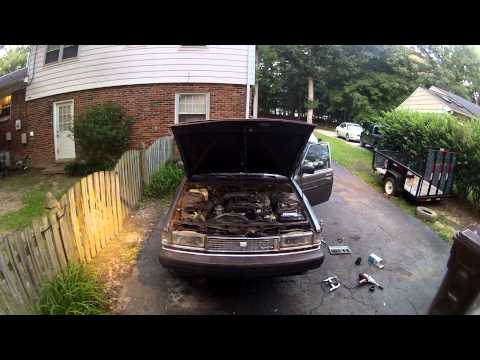

    Anyways, I got everything else disconnected and the engine is basically 4 bolts away from being ready to come out. Since I don't have a hoist, I decided to clean up some of the more visible bits of the engine. This thing is probably the dirtiest engine I've ever seen.
    So I took a tupperware container and threw in some water and simple green and some friends and I scrubbed the two intake manifold bits, valve covers, throttle brackets, and fuel rail until they were thoroughly degreased.
    So then later this evening I got all the paint off the valve covers and prepped them for paint. Here's how they turned out:
    And here's how the engine sits right now.
