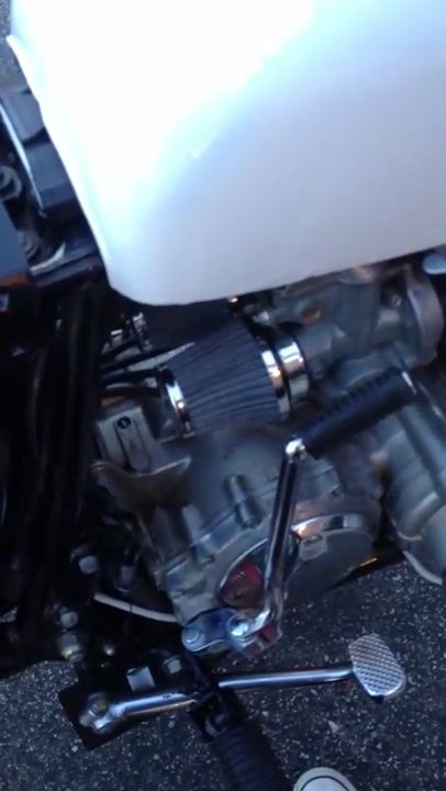

So back to those old carbs. Here they are. I removed the float bowls and found sand and gunk so I knew a full rebuild was gonna have to happen. And since I needed to jet it a bit due to the exhaust that was fine.
Yea those slides were so bad haha but they cleaned up really well.

The bike had a Dyna ignition which I was excited about until I got the bike running and learned it was junk. I guess a production run they had went bad and half would fire and the other half wouldn't. And since I was trying to save cash and didn't need fancy ignition I went back to the old Honda points. Worked like a charm after I timed it with an old turn signal bc I didn't have a timing light!
I ordered a carb sync tool since I plan on building more bikes. I was surprised how close I bench synced them.
