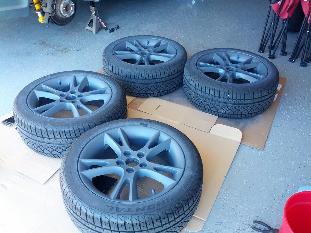

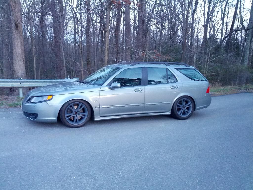

        So I **** the stock 17's. The white eh, but the car wasn't as low. The black just made them disappear. Which leads to something in between.... I had to adjust the rear Koni's, as I had them too firm and the car rode like shit. The rear wheels were already off. 10 bolts and 4 can's of grey later.
        Don't worry, the dip peals off the tire as long as you lay down enough.
        Then, at dusk.
        And they look blue to me... Someone trade me something, anything else. I just can't make myself spend money on real wheels till it's on air.

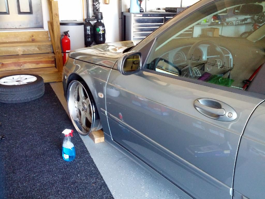

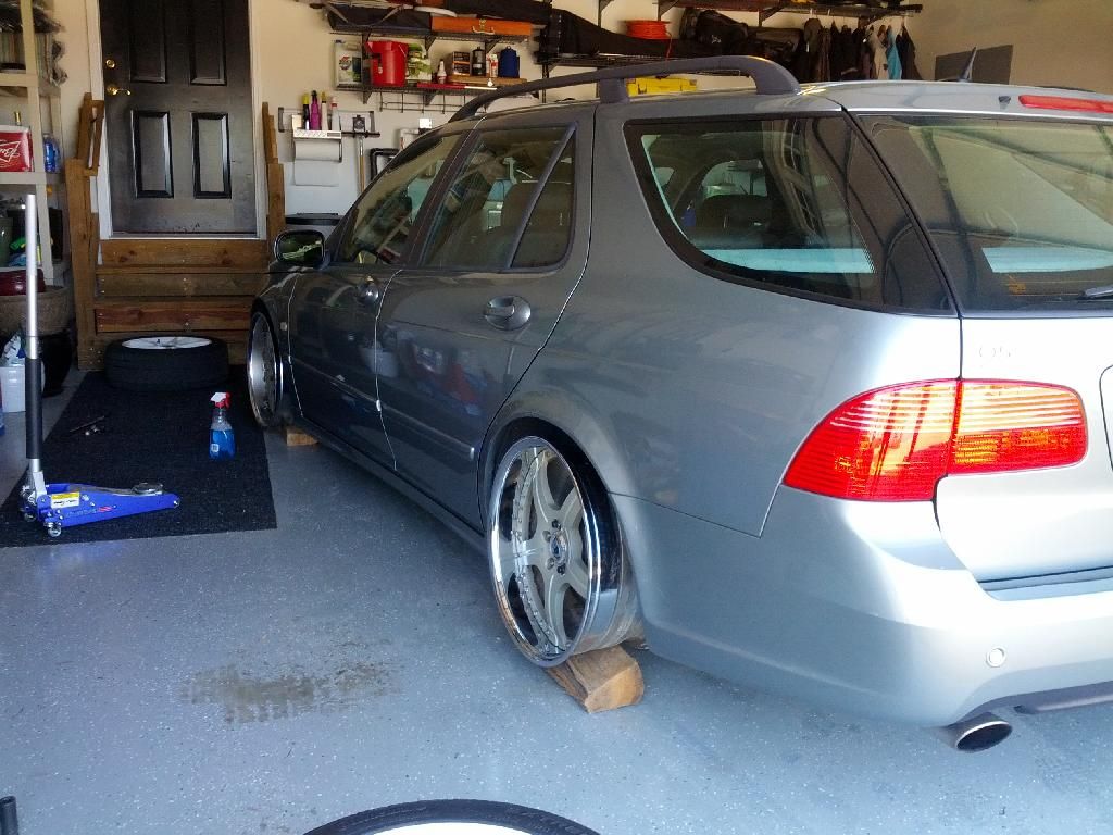

              So I've found and purchased some wheels. Craigslist of course 3 piece Asanti's in 19x8f and 19x9.5r. One had a bend which I straightened. Then found out after straightening and pulling the tires that one of the rears was a 9" with the other being 9.5".
              So what I am working with actually is 2 1.5" lips, 2 3" lips, 3 6.5" barrels, and 1 6" barrel. The plan is to do 9's up front with 6" barrels and 3" lips, and 9.5's out back with 6.5" barrels and 3" lips. Already ordered the spare barrel and working with a vendor on here for a pair of 3" lips. They need some refinishing of course, but all in all I am happy with the sub $800 tag with everything said and done. Here's the test fit pics with a 9" in front and a 9.5" out back on top of a 9mm spacer to clear the inner strut.

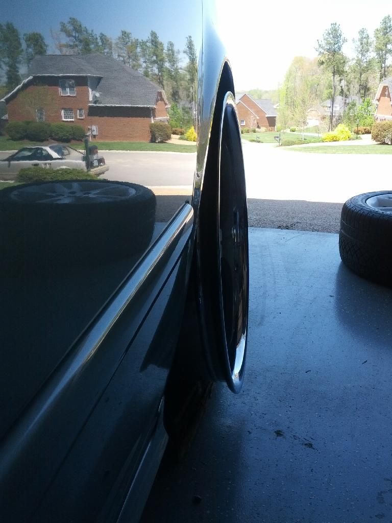

                  Haha! 9.5 fits just right, flush, no spacer for strut clearance at about 40et. If u wanna do a little pulling and some good stretch a 10 should fit too. We will see how much real world clearance I have once I get tires.

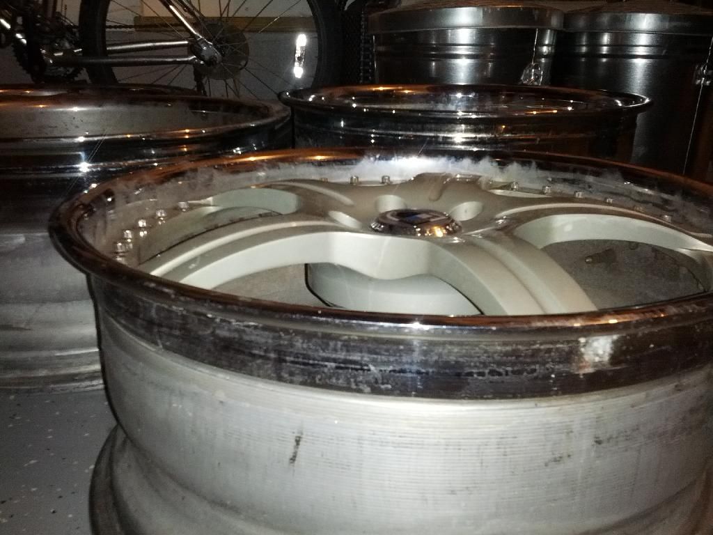

                    Ordered the replacement barrel for the front, and ordered a pair of lips for the rear. New plan=
                    6" barrel and 3" lip front for 9" overall
                    6.5" barrel and 3.5" lips rear for 10" overall
                    I'll post pics as soon as the parts arrive. Still haven't decided on colors yet.
