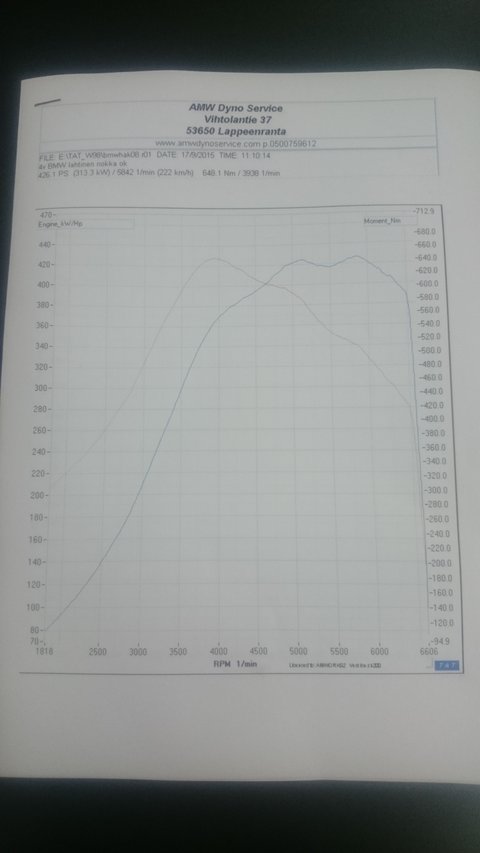

                            • Got the damn thing working after couple of set-backs!!
                              It gave 426HP/648Nm(thats 478lb ft) @0,8bar on dyno yesterday.. (flywheel power)
                              Few minor jobs to do before the car is finished, also the sound system needs head unit, amplifier and sub to be installed.
                              -Timo

                              • Fantastic!! You must be super happy.
