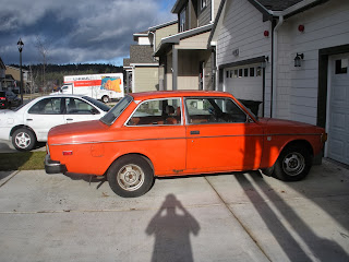

    So, decided to pull the trigger on a car project. Never had one before, so why not now.
    I've always fancied Toyota Coronas and Datsun 510s so when I saw this...
    I picked it up.
    Well, I UHaul'ed it. As it doesn't run.
    Got it home and opened up the hood.
    WTF is that!?!
    So it turns out this is the last year of the 142 model and the only year with the k-tronic mechanical fuel injection system.
    As it sounded like a fuel issue I replaced the fuel pump and fuel filter. Didn't work.
    So, now it chills in the driveway. While I figure my next move...maybe I'll wash it.
    Do we Carb the low compression B20F head? or use the low compression to our advantage for a Megasquirt/Turbo combination? These things don't get low too easy, so fast may be the only option.

          Dual webers maybe? EFI and ITBs? >
          I have a '73 144 and went with a Mikuni carb swap, and it's good, but DO NOT be tempted to buy anything from John Parker at V-Performance- it took like 4 months for him to ship anything to me and I'm one of the lucky ones.

              Damn, I was looking at his T5 Tranny swap. I'd do most the work myself. If I go to carb I'm looking to do a fiberglass/carbon fiber air manifold.
              I might pick up a weber cheap and get it running on carb while I find all the parts for the megasquirt.
