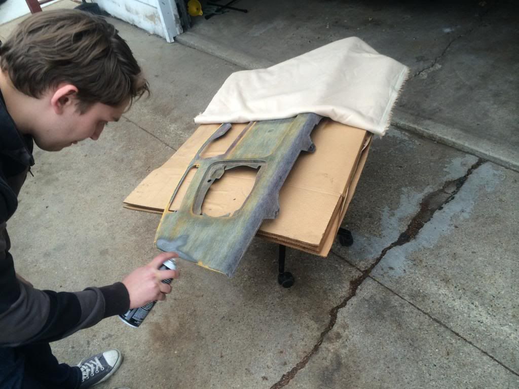

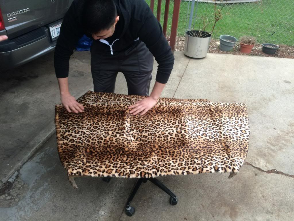

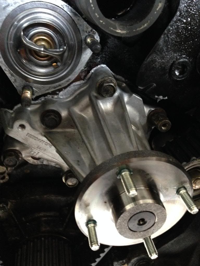

                  added a new nissan h20 pump, much better than Autozone
                  Also added some Leopard Skin shit.
                  Also did the rear coilovers

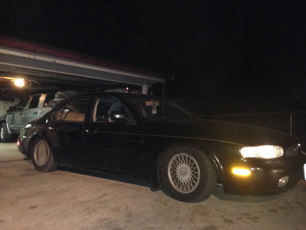

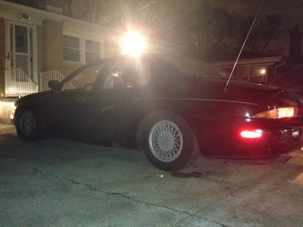

                          • #28
                            not sure about that z32 question brotha sorry.
                            but then...
                            tuckin 15s :P
                            bad side
                            please excuse iphone5 photo quality
                            cant wait for my enkei rims to come in. ill keep ya posted
