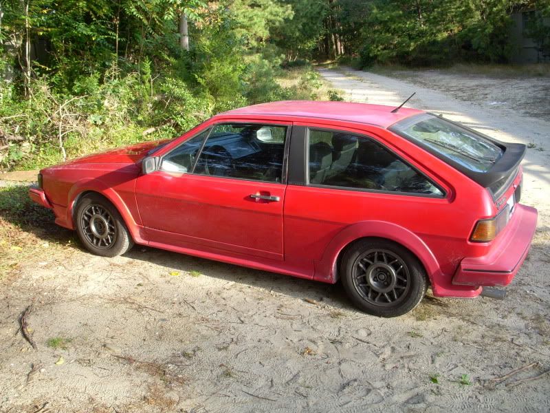

    Insight. I bought this crap box in 2008. I drove it around as a daily for a while, I got stranded, put a new motor in it.... and then it died again. I always had a dream of restoring it, and making it into PVW. I started slowly gathering parts, and funds over the course of a few years, and the past two years I've worked pretty hard on this car. I built this entire car by myself, tuned it myself and painted it myself. I run an Autobody shop, and just had my first child 8 months ago, when I'm not at work or playing dad... I've spent 1-2 hours a week trying to accomplish something on the car.
    Look how ugly these Recaros were... the kid who owned the car before me ruined a nice set of Tropheys.
    This is what the car looked like when I first got it...
    First thing I did was lower it.
    After about a year of dailying it, I polished the faded paint it looked okay, previous owner burned through all over the car, I just didn't care enough to do anything... then the CIS started giving me troubles... I couldn't for the life of me figure out what was causing my hot start problems.
