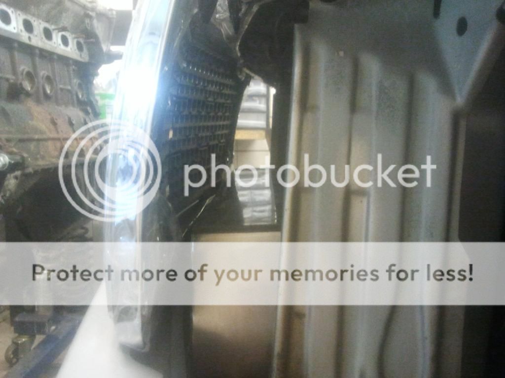

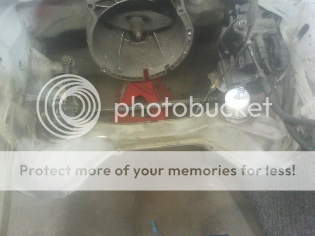

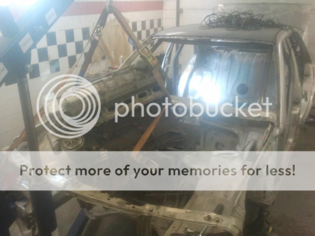

    Started with some choppin..

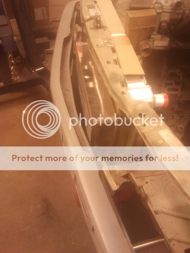

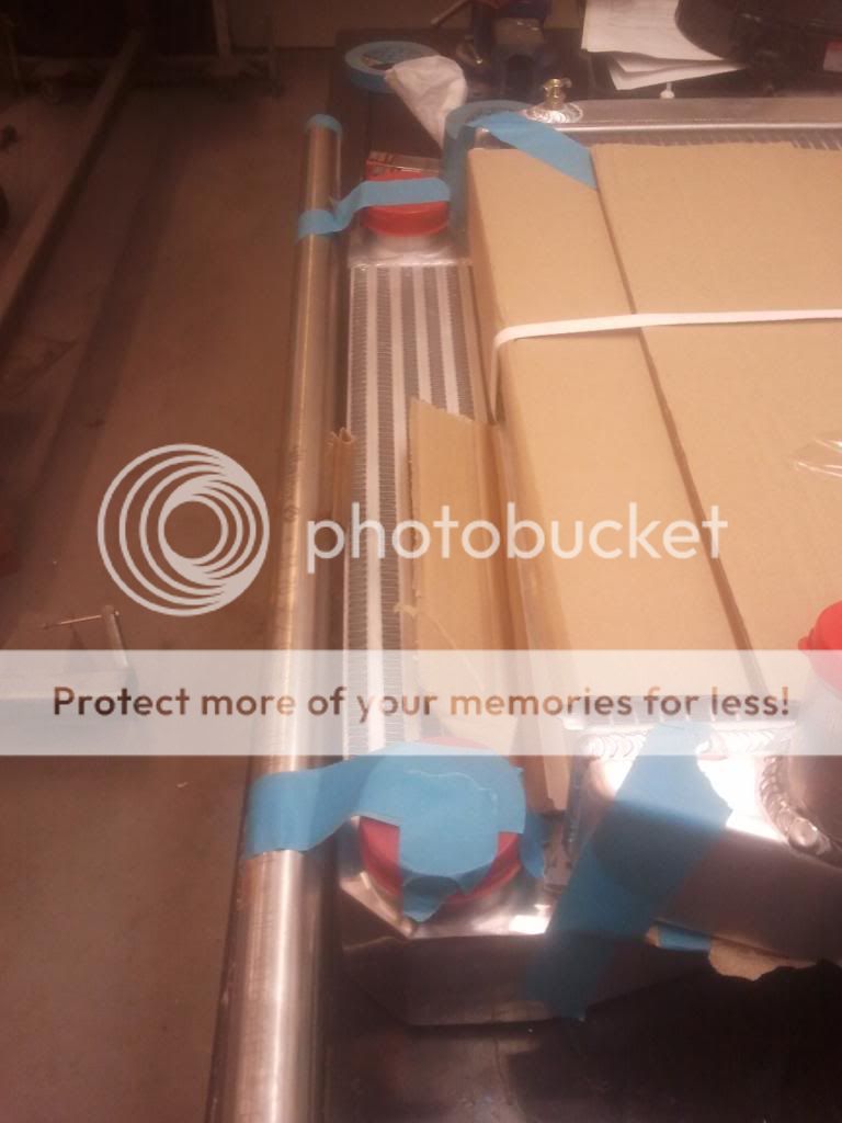

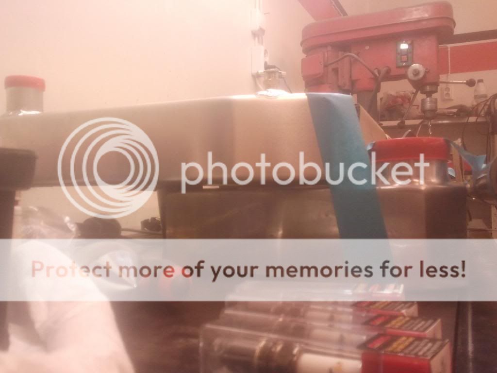

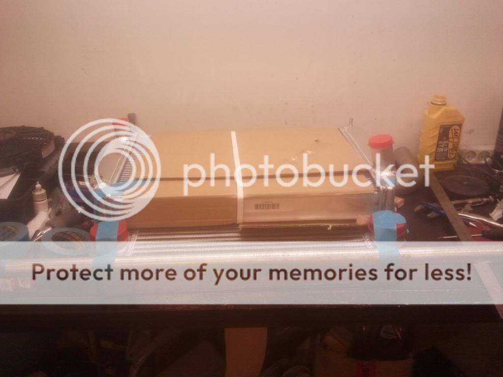

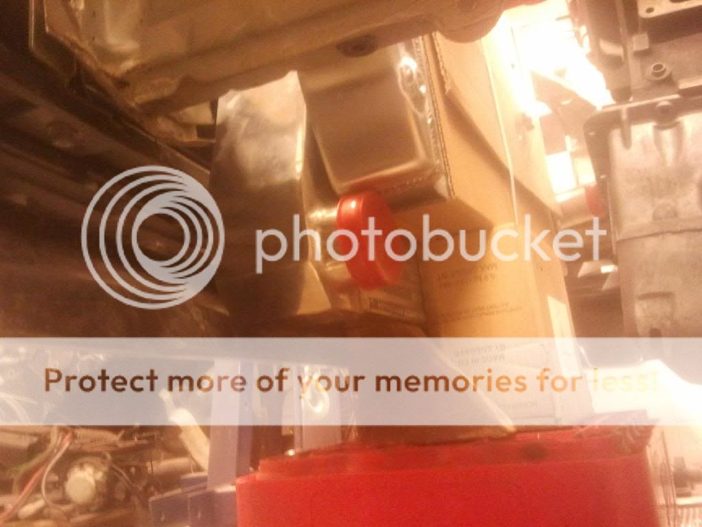

    Bumber, radiator, intercooler test fitting..
    Then fan fitted as well..
    Its going to be tight fit if even possible. i might need to order new narrower fan or maybe 2 small ones.

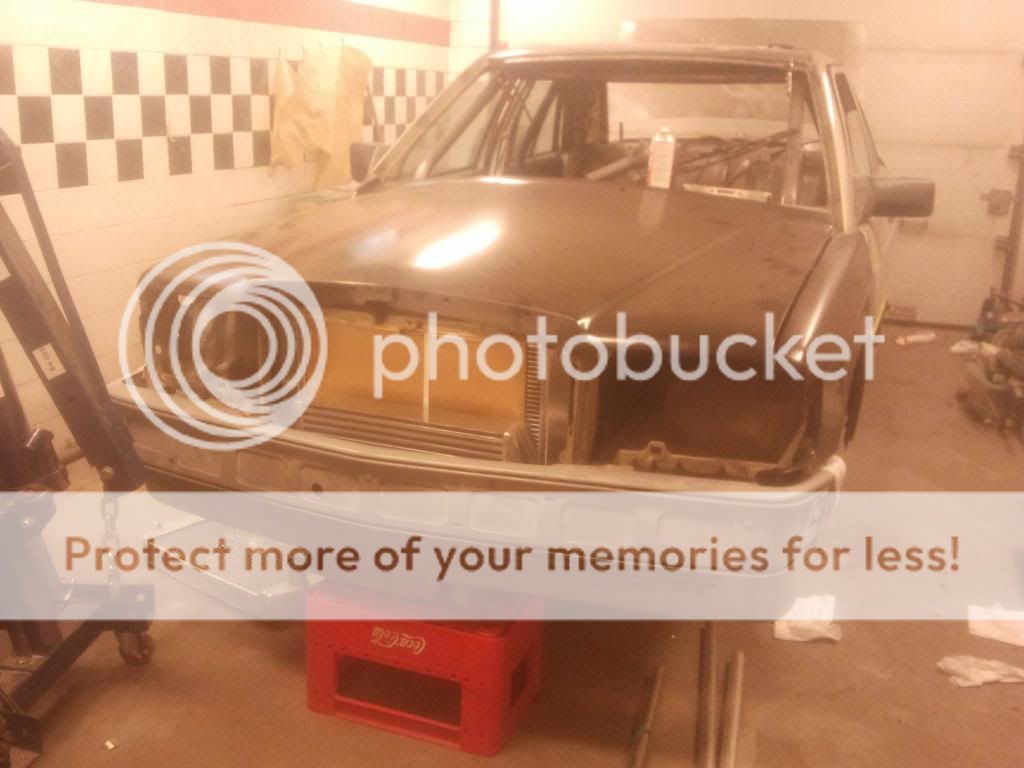

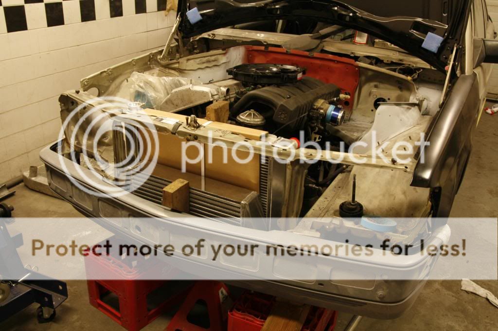

    And to endup the update with picture where it seems it almost looks like a car again :P

    • Could the radiator come 1/2" or so more forward?
      BMW M5 V8 1993
      Slowtoys CC
      • Originally posted by herrakani View Post

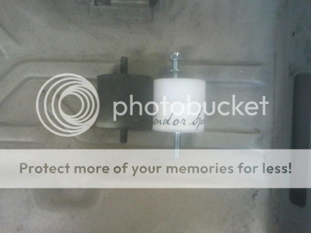

        it might, but in order todo that, intercooler needs some modifications as that would need to come up and forward as well.. now its about 0.5cm or something like that how much i need more room to fit them in there.. going to change engine mounts + gearbox mounts to solid ones so i dont need to worry about clearances while its runing.

        • Solids are good, just make sure the IC pipes and exhaust got some flexjoints.

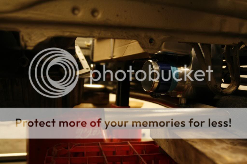

            2.5" Pegasus clamps just cleared from customs and AN20 connectors ordered for radiator.. should be cool.
            Also started designing bottom mount for IC and radiator..

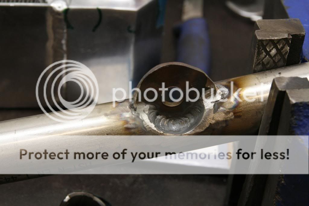

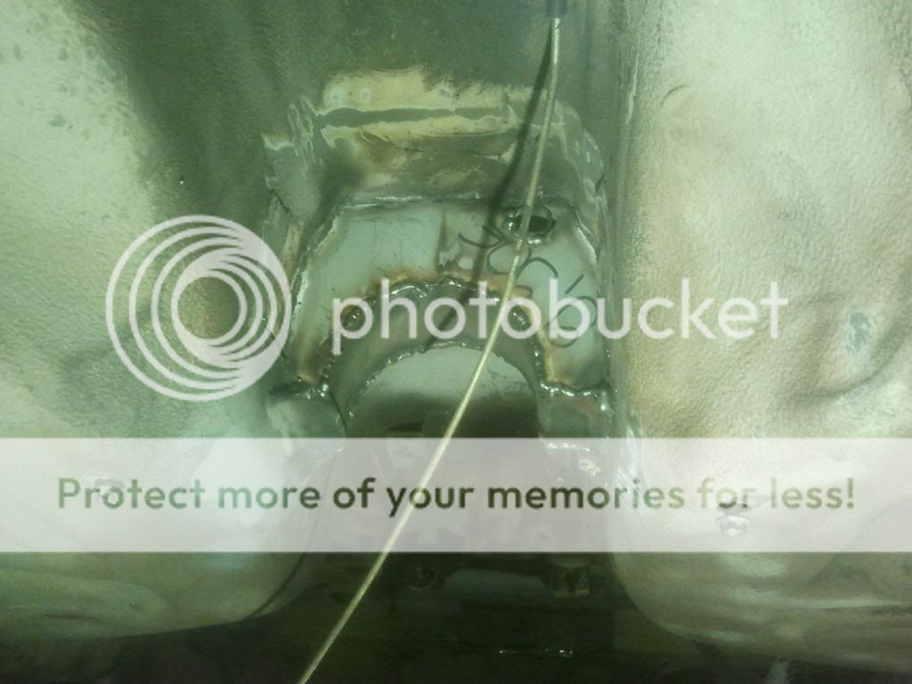

            • Ok here is some progress on the front clip..
              Couple weld shots, not a perfect Tigwelds yet but i think they will stick..
              More of test fittings.

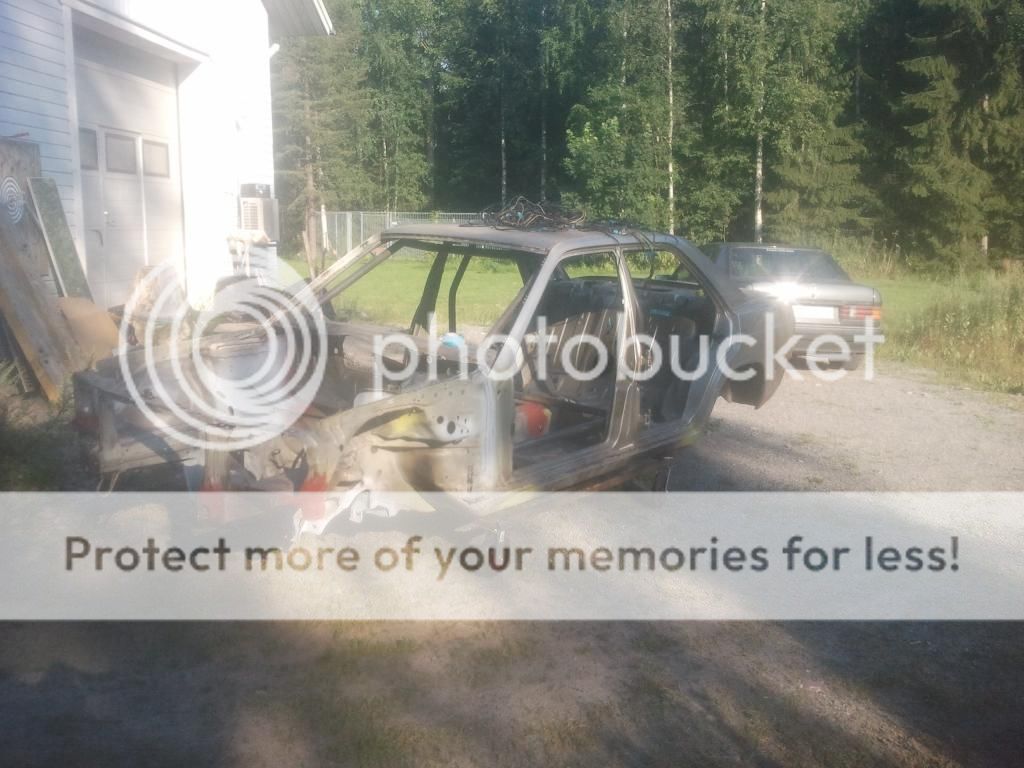

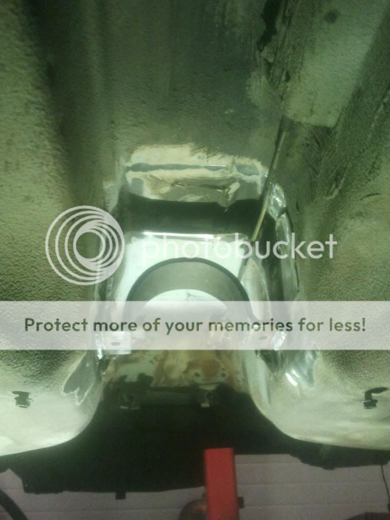

              • Hello hello, chassis modifications is almost done..
                Cardan center support had to be moved... so..
                Also got some brake calipers.. not sure if im going to use these or the ATE Version of the big 4pot calipers..
                These are from W124 500E... Oem Brembos..
                If everything goes according to plans chassis will get some paint on it in couple weeks.. after that new parts after new parts..

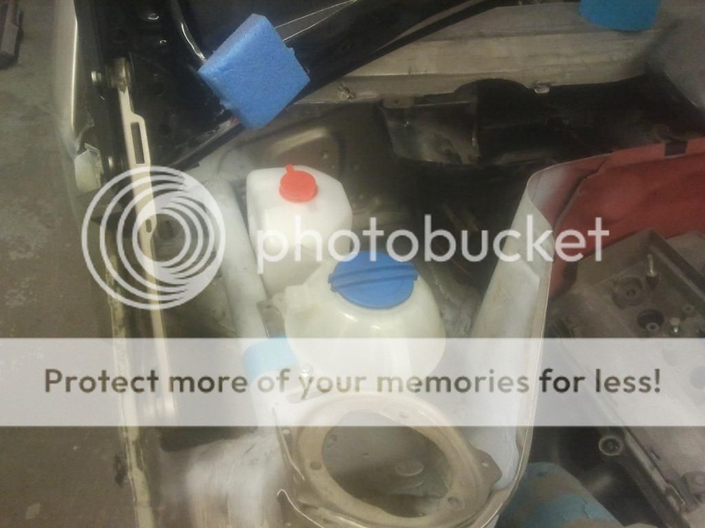

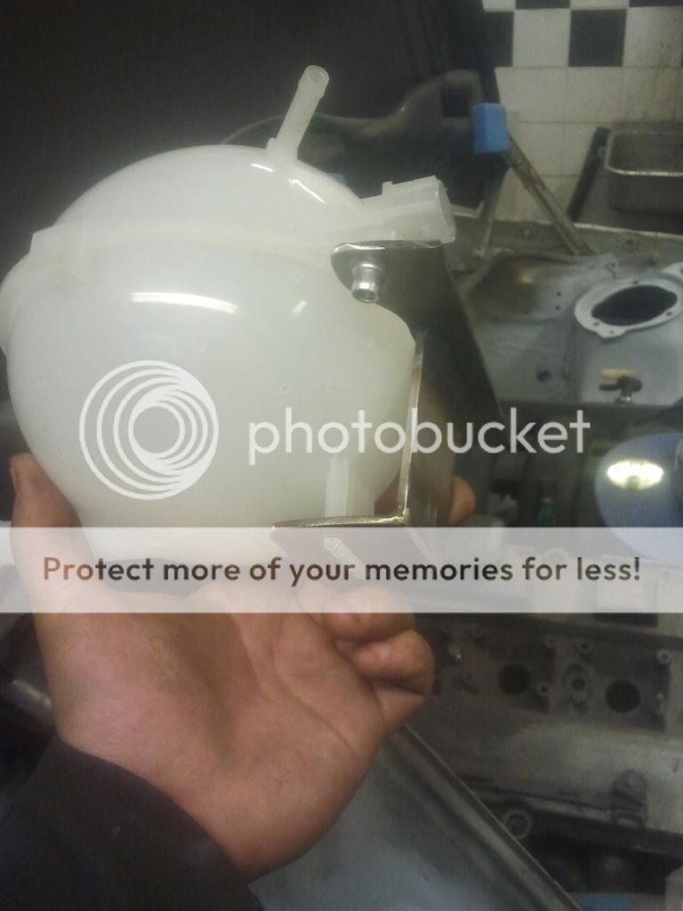

                  Again things didnt go as planned.. painting on hold still.. but.. i got expansion tank for cooland + washer fluid tank...
                  Pics will explain the position..

                            • Finally getting closer to painting the chassis...
                              Place for expansion tank + washer fuild tank.
                              Now these are ready. so no more modifications into engine bay...
