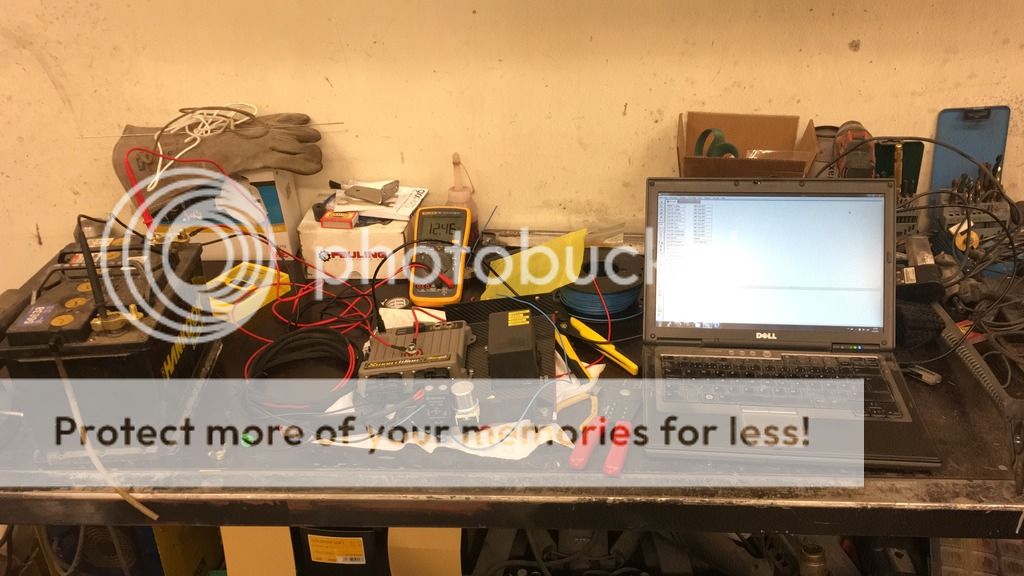

        • Wiring continues...
          Testing rig... had todo some before hand testing to get the timer relays work as intended (20min shutoff delay on ecu and PDM) (to control fans with ecu ...)
          This set contains 100% all the power needed in the car. actually 1 extra power as well(just in case)
