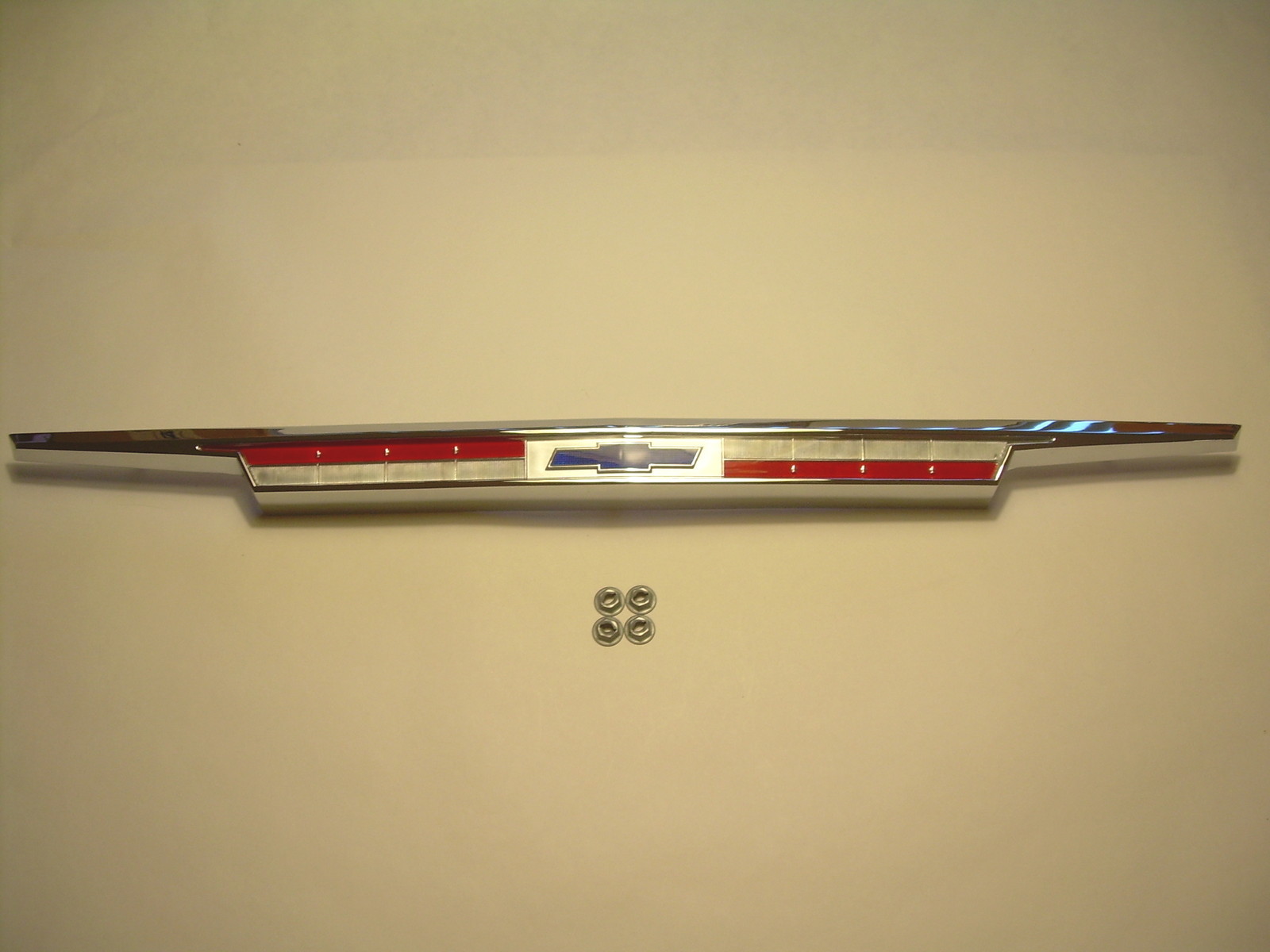

    i then ordered a pile of interiorior restoration pieces, and exterior too. lots of chevy made in north america parts.
    (small pics...)
    hood lip molding with emblem:

    front license plate panel:
