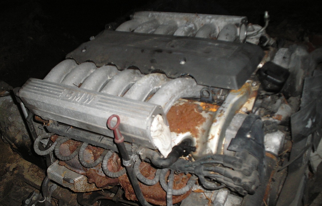

                        the M70 engine is and bmw made V12 5.0 litre engine, i have always liked it, but the problem is that should i to it automatic or swap some r6 transmission to it and made it to manual.

                          and i must now get my V12 engine as well.

                              and now i have engine that is going under my Calibras hood
