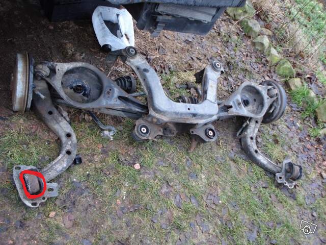

        To correct the toe, you will need to take the rear lower control arm holder off, elongate the holes then remount it, the stock adjustment is not enough.
        Here is a picture i found on the internet. This is not a M3 subframe, but its built almost the same way. anyways in the picture, the lower left you see a red circle, right next to it, there are three elongated holes, that is were you adjust the toe on the car. those holes must be longer to have enough adjustment, to get the toe under control.

          we are working on it, the toe is MAXXED out on stock adjustment. holes need to be slotted further and the carrier needs to be modified to get it into spec. but as me and wes are hard working folks we haven't had a chance to address it yet. o well its just tires.

                  Sounds good, slot the carriers and you are good to go.
