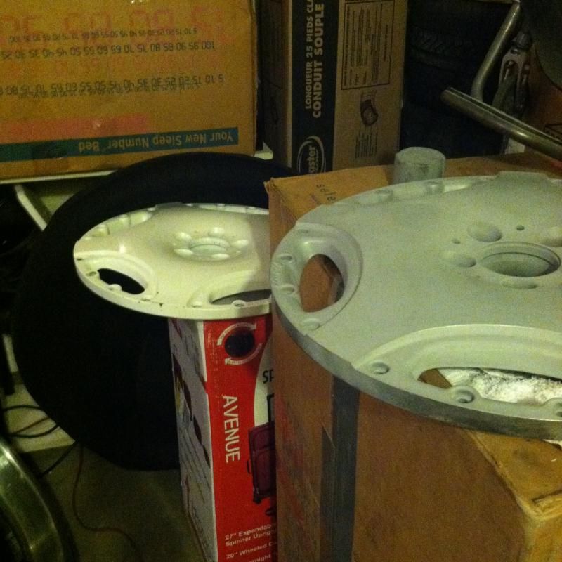

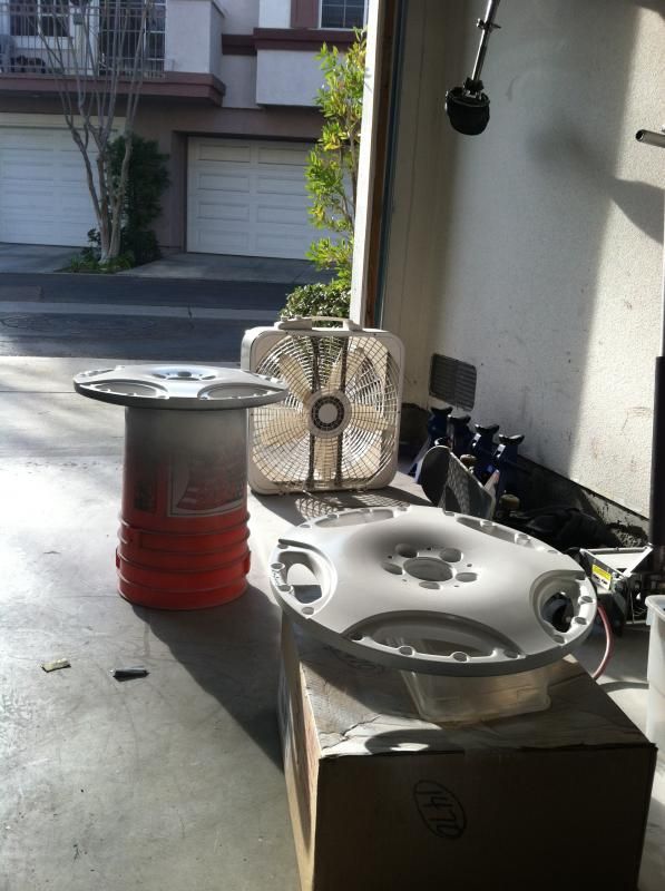

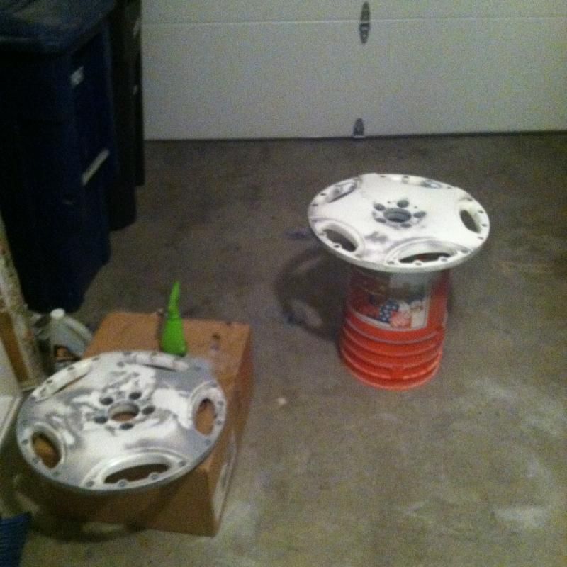

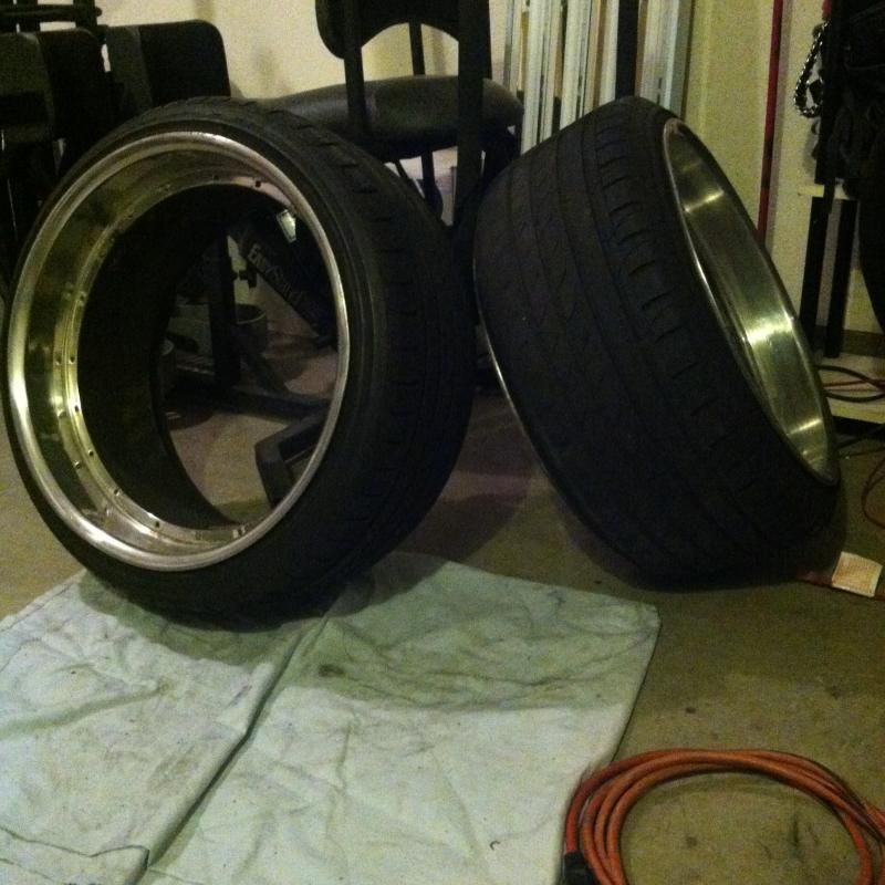

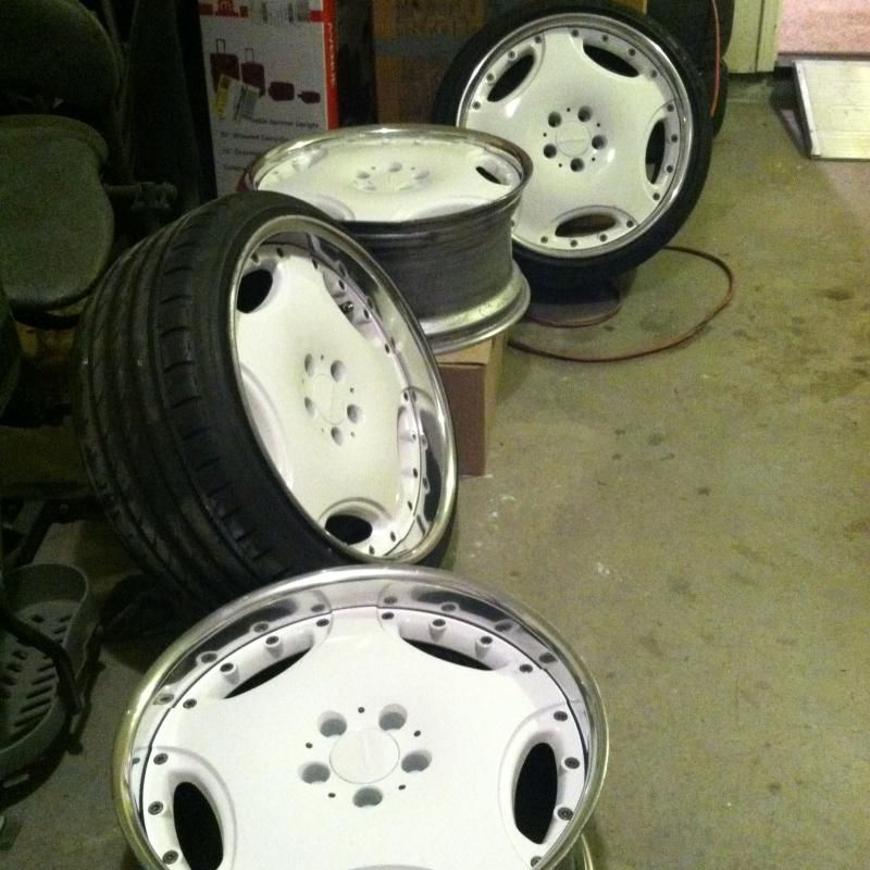

    Did a little refinish on the lorinsers. Running em on and off for now because the tires are pretty shot but for a refresh they are 19x9 19x10 two piece lorinser LM1 wheels made by Ronal wheels of Germany. The offsets are +44 front and +38 rear Im running 20mm front spacers and 17mm rear spacers. so final offset is +24et 19x9 front. And +21et 19x10 Rear. I dropped the faces out and simply re-painted them white. And gave the lips a fresh polishing. I was debating changing up the color of the faces. but something about the white wheels i cant say no to.
    decided to have a little photoshoot while the paint was fresh and clean !

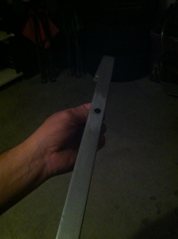

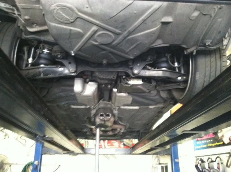

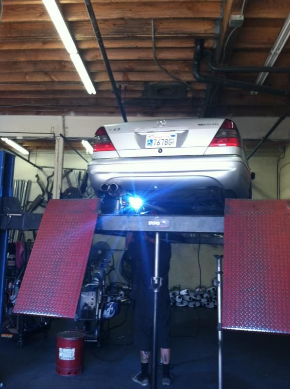

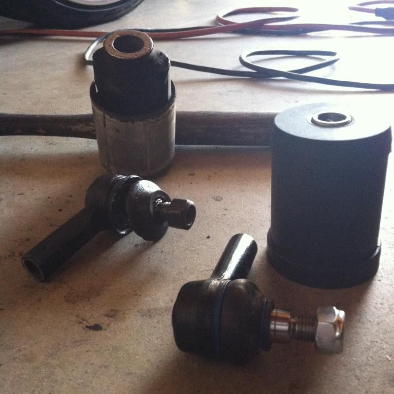

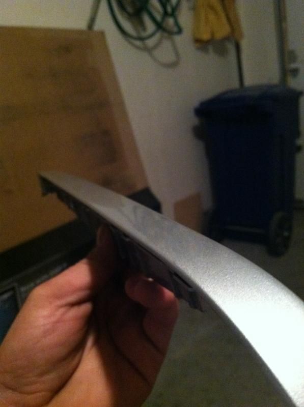

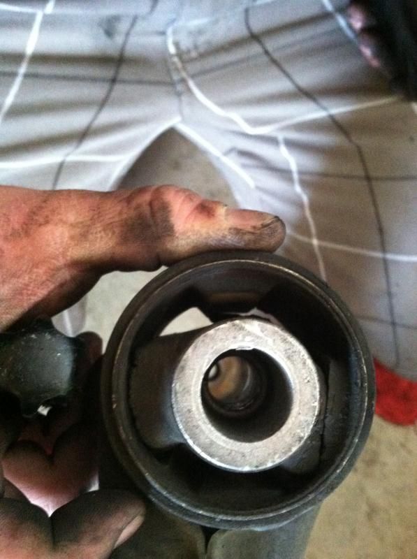

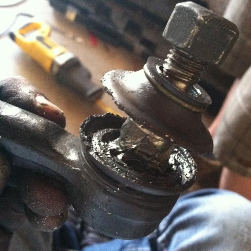

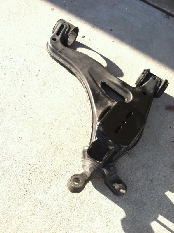

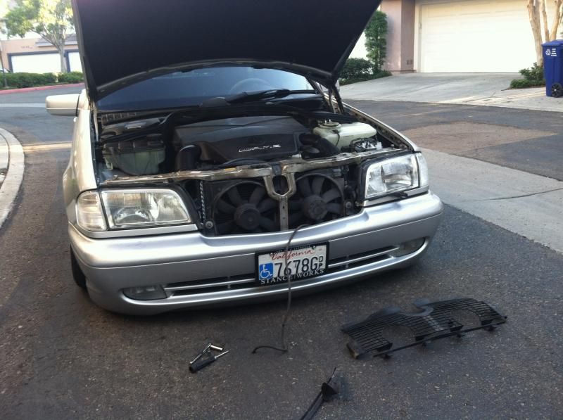

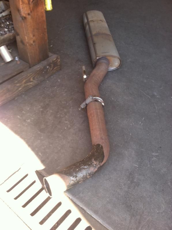

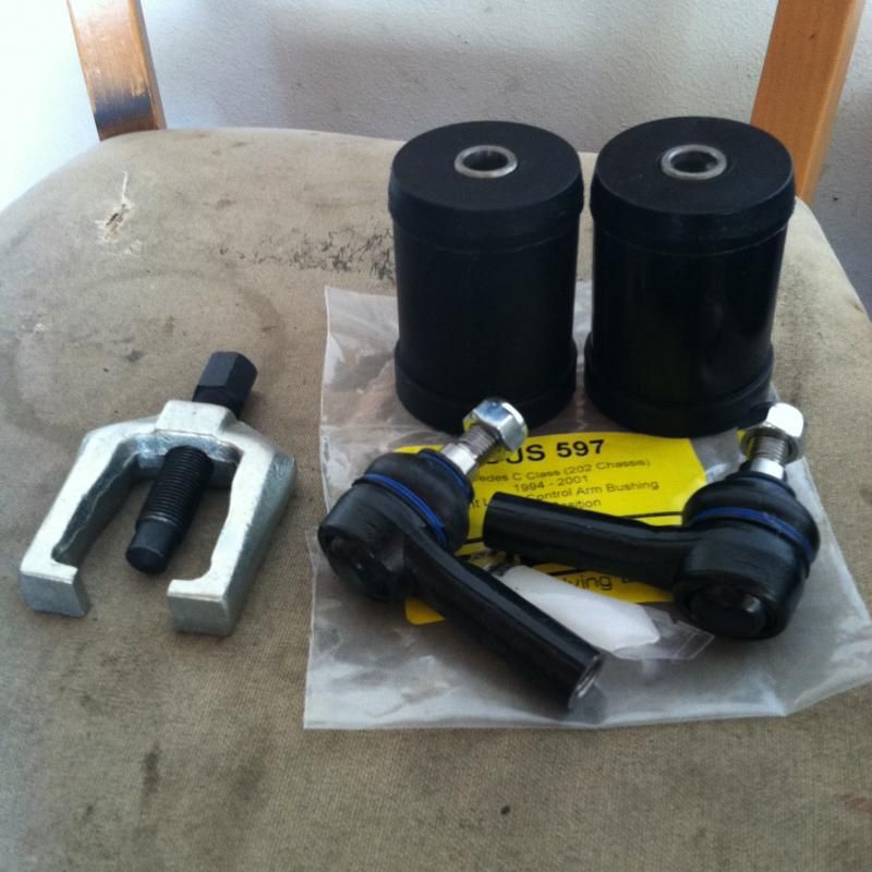

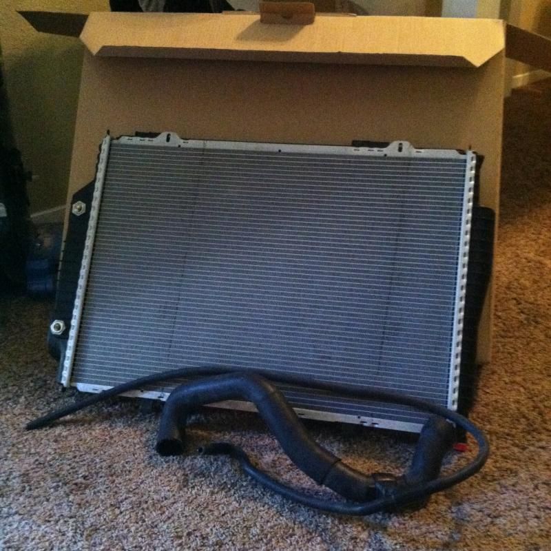

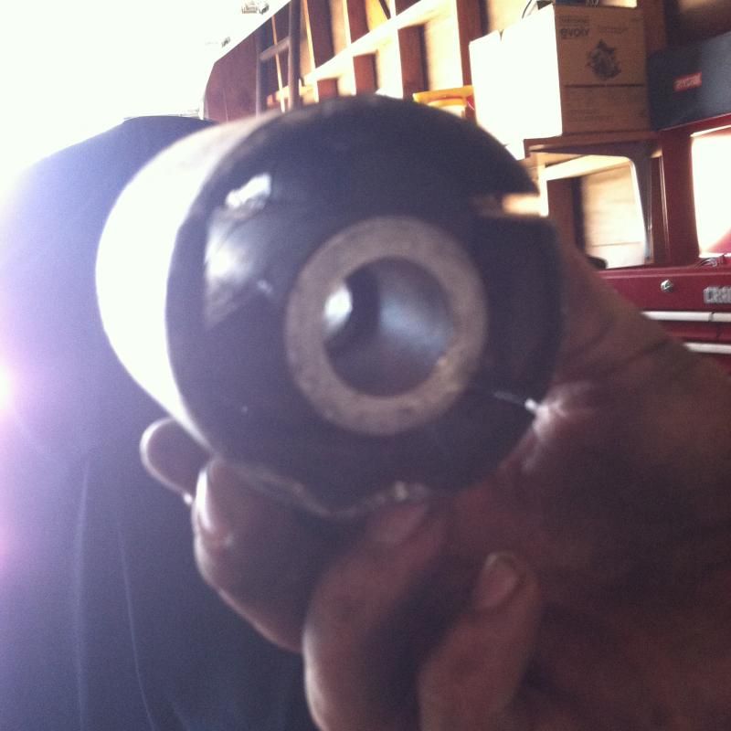

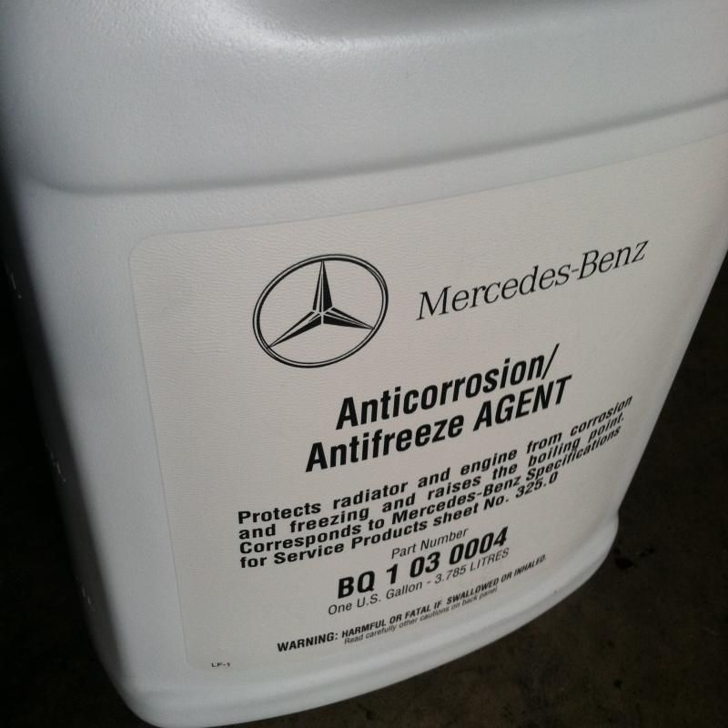

    Havent posted an update in a while that isnt on Instagram ! Just had to do mostly maintenance related things. so far. Since i got the car , Ive changed out the Oil, Radiator, and Upper hose, New coolant,Changed the completely shot and shredded Lower Control arm bushings out for Poly Bushings, While I was at it I went ahead and changed out the Tie rod ends, They were split in half..... This should have been done when I swapped the control arms over from the old car the first time but i didnt have any parts compiled. And wasnt sure what it exactly needed, These C43's and W202 mercedes that came with factory xenon and the AMG option had headlight wipers I never liked how these looked and since i live in Southern California there will be no use for them. I will never deal with snow on my lens. Unfortunately they are also headlight sprayers so i had to do a lil modification to the headlight washer system to plug those lines and keep functionality of the upper ones for the windshield. I have also had the resonator deleted and some shotty exhaust work ( holes ) patched up and she sounds and runs much better now ! The welding on the exhaust was the only job I did not do myself. Finally after all this I had a Little cash left over to fix another issue a dead fog light. decided to tint the lens yellow and added 3000k HID DDM slim ballast to em. The car is currently sitting on stocks for the "winter look" and i am refinishing my Lorinsers
    Plastic trash bag wrapped around the pipe. That explains a lot
    Tips all straight. They were sittin sidewayzzz when i got the car and held on with plumbers tape

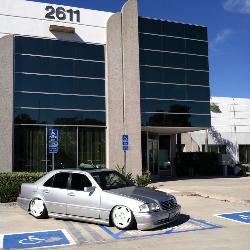

    random shot from Autofashions 7th annual VIP fest hosted at HRE wheels
    a little bit of plastic filler for the holes.
    Headlight Wiper holes deleted. fresh paint + clear
    out with the old in with the new.
    the Bag brackets were never painted just welded in raw. decided to throw down some flat black on em while the bushings were out and everything was unbuttoned.
    Old and Worn VS the Brand New
    Time to put it all back together with the poly bushings in

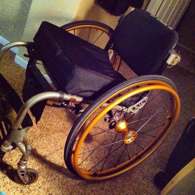

    This is totally unrelated but many of you know that im a paraplegic ( confined to a wheelchair & paralyzed from the waist down) I had been building a carbon kevlar straight spoke radial laced wheel set that comes in at a lil under 18 lbs as a pair, I believe. Thats with push rims and tires. They feel super light weight and i absolutely love them. I had the wheels media blasted & type 1 gold anodized. Well got them all built up and grabbed a new Jay brand J2 deep countour seat cushion and adjusted my seat dump forward and down 1 degree each and set the axles to 4 degrees negative camber
