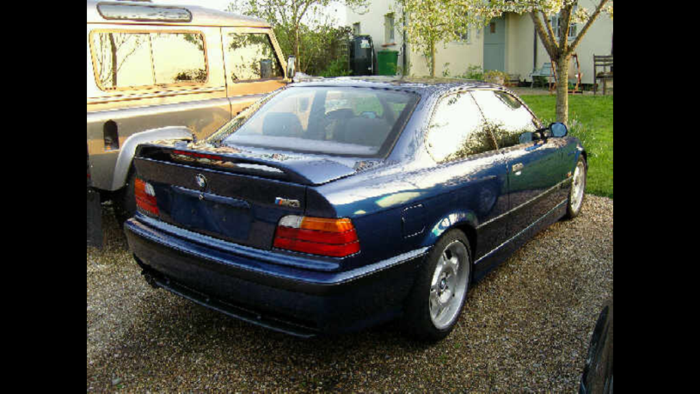

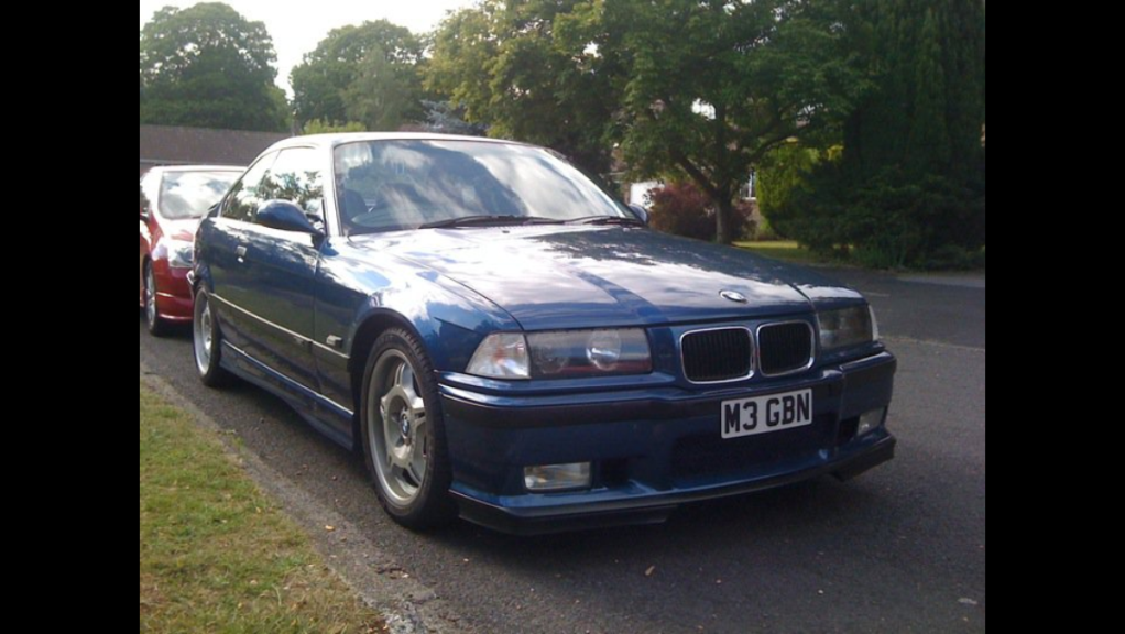

    Having the privilege of a BMW dealership at my fingertips and a wealth of knowledge from technicians I set about looking for cars. I knew what I wanted, either a 3.0 or 3.2 Coupe for £4000. How hard could it be? Very hard actually, but I eventually found an original 3.0 Coupe in Avus Blue with the Anthracite Alcantara seats, air con, cd changer, wider rear wheels and rear spoiler. It was about 100miles away from me so I went and took a look. It was owned by an elderly gentleman who had it for 10years and used it at weekends. There was no rust on the arches but the lacquer was peeling on front bumper and there was a bit of rust on the roof where it had a replacement windscreen and not been fitted properly. The car drove great, had a full service history, an M3 plate and only 79,000miles. A deal was struck (for slightly more than I wanted to spend) and I was driving home in my own M-Car.
    This was in April 2009.....3months to the Nurburgring trip
    Sorry for the bad pics, 2009 camera phones were rubbish.

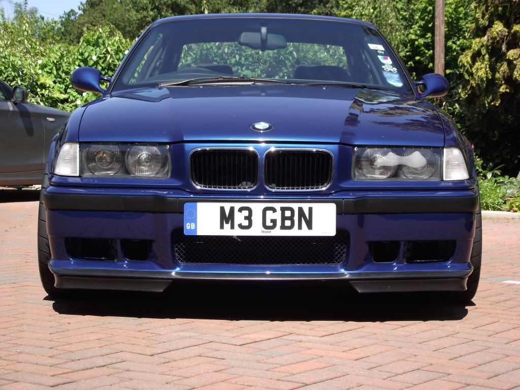

    The first upgrade for the car was to change to the clear indicators all round, it just freshened the car up nicely. I also fitted some GT corner splitters and short plates.
    Everything else was kept standard for the trip.

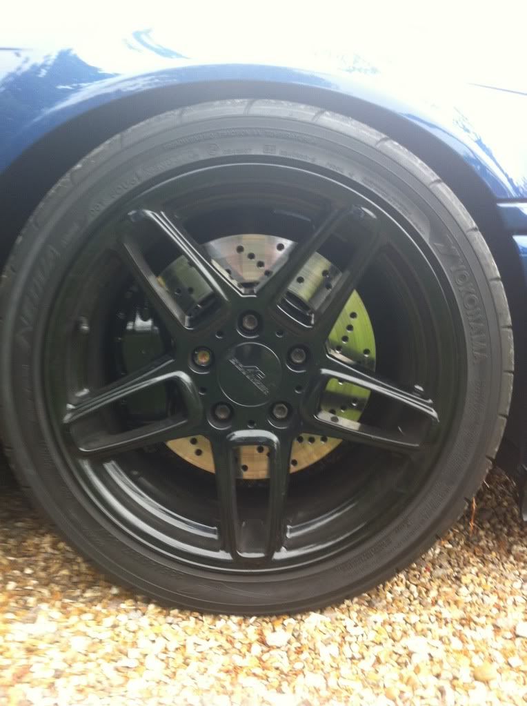

    The biggest problem I found was with the tyres. The E36 3.0 runs 235tyres all round, which is fine but the quality of the tyre is important. I decided I needed something a bit more track focussed and decided to change the wheels at the same time. I have always been a fan of the AC Schnitzer wheels and I sourced a set on line. They are very period for the age of car coupled with some Yokahama AD08 tyres would make a great set up for fast road use and the odd track day.

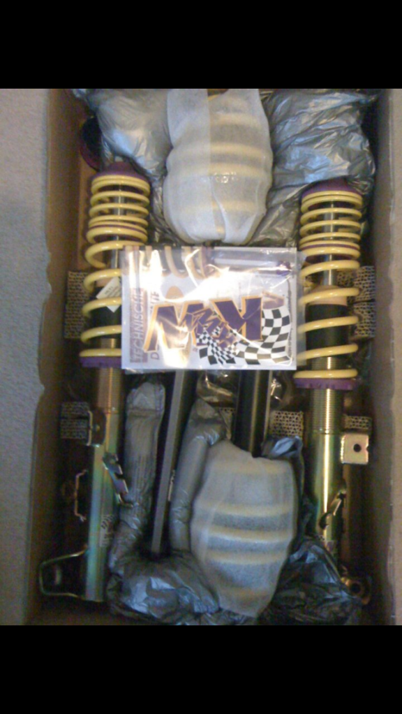

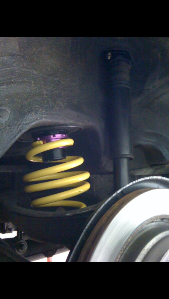

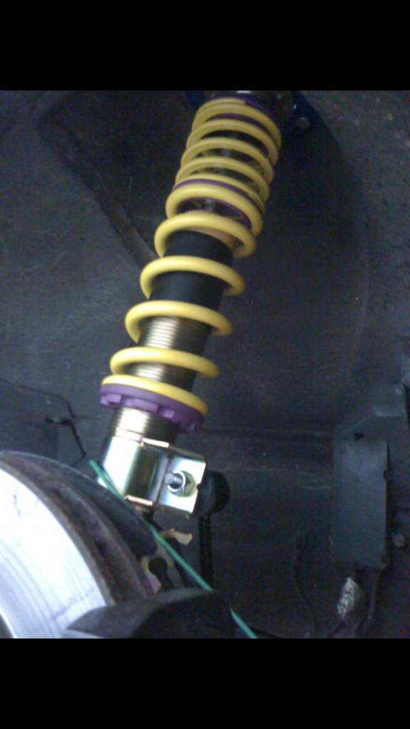

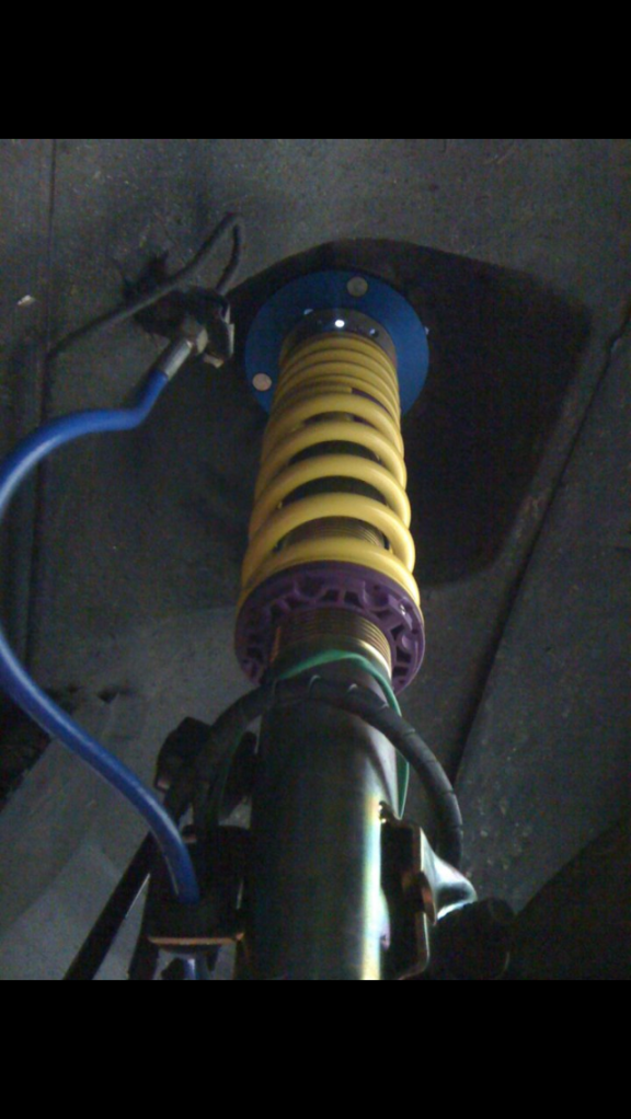

      I ordered up a set of KW V1 coilovers and got them fitted. I'm still playing around with the height to this day as I cant decided to drop the car right down or keep it at a bit more of an OEM height.
      At the same time a set of Powerflex bushes were fitted along with Rogue Engineering rear trailing arm bushes and rear top mounts.

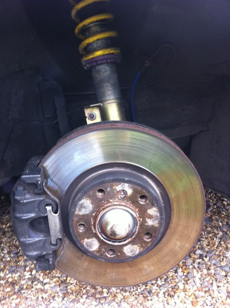

        The car now handled well but I managed to cook my brakes on a track day at Silverstone so I set about looking into brake upgrades. The braided hoses had already firmed up the pedal feel nicely but the standard discs and pads were past it.

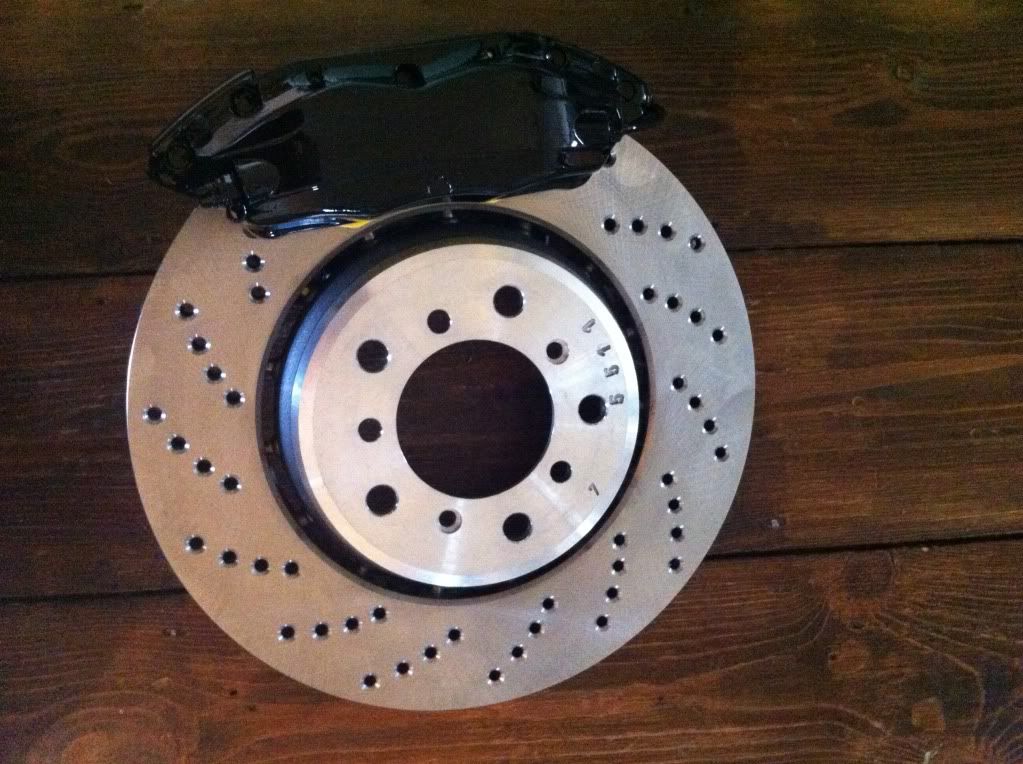

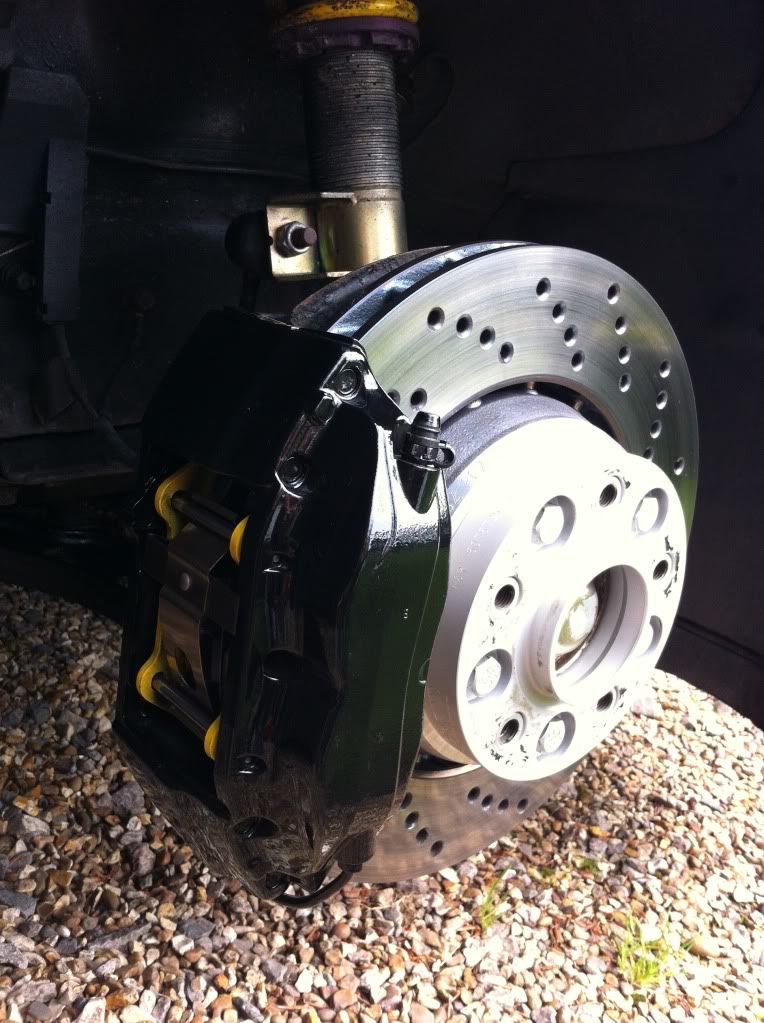

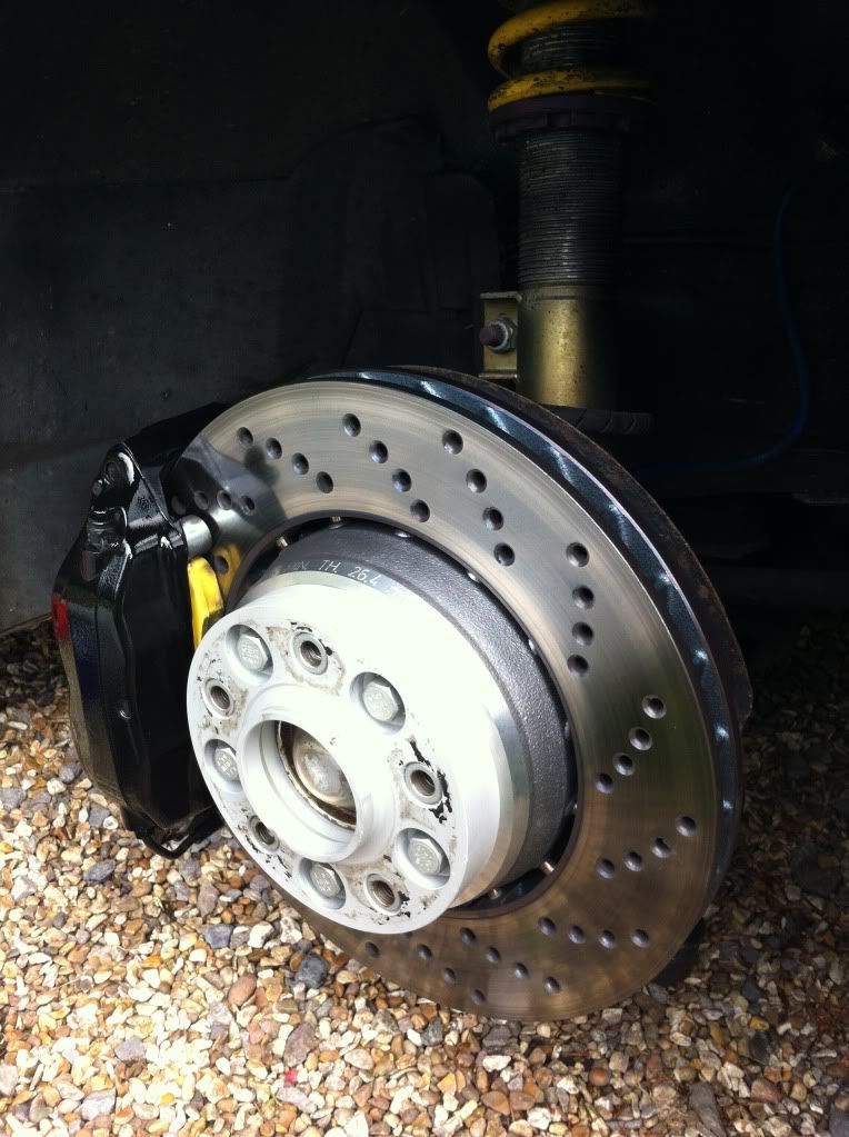

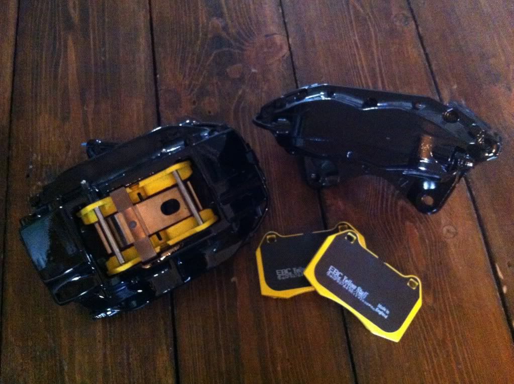

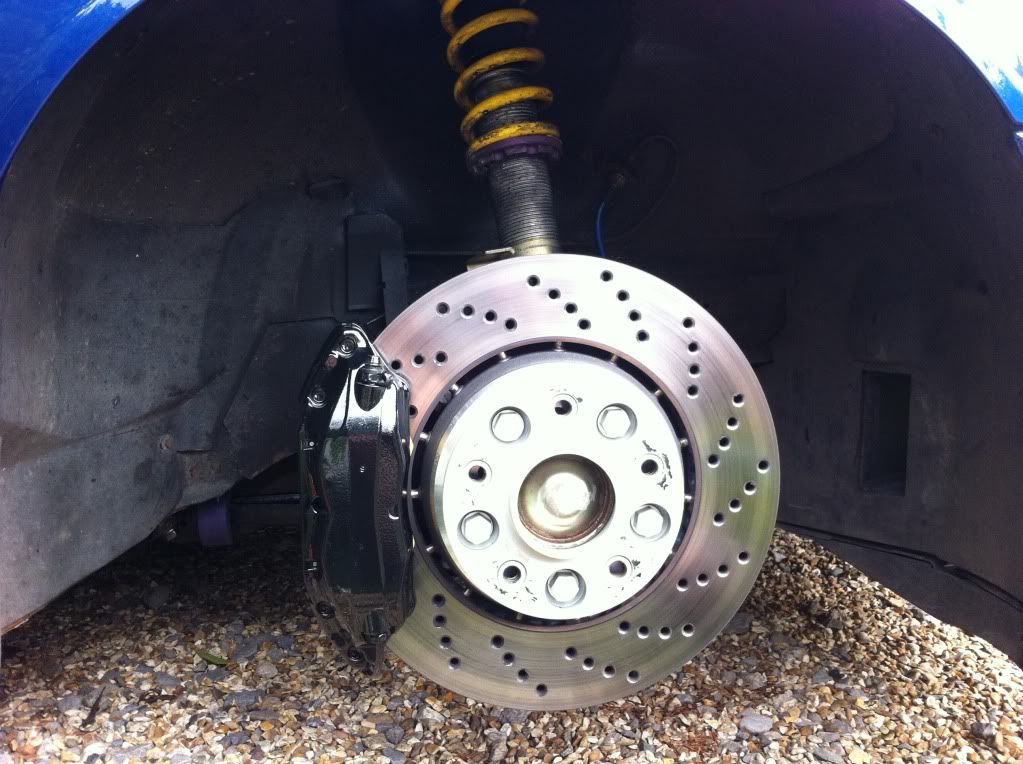

        I looked in big brake kits from AP and Brembo but they were just too expensive, especially for a car that I had intended to sell 2 years earlier and only did 2000mles a year in. Then I looked at a more simple upgrade of using the 4-pot Brembos from an 840ci and E46 M3 Discs.
        I ordered up a set of EBC Yellowstuff pads and set about getting them on the car.

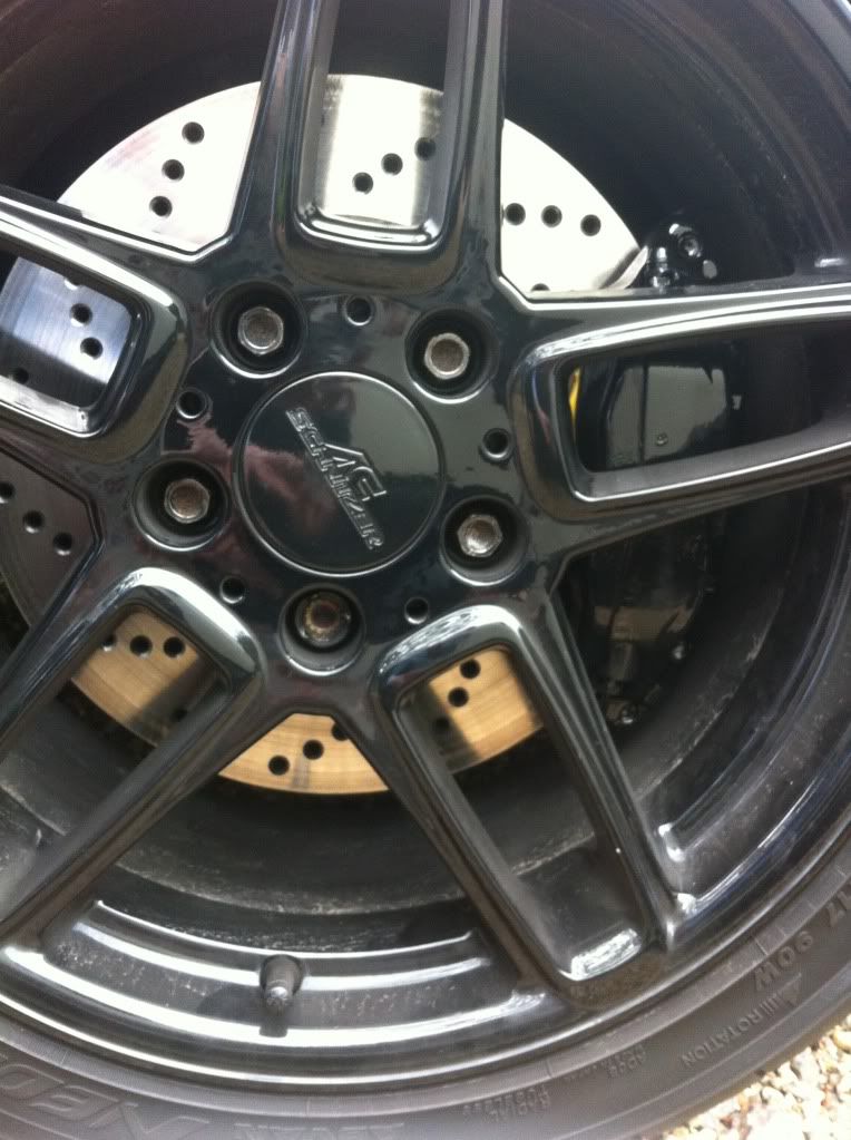

        The first problem I encountered was although they fitted straight on and everything cleared nicely as soon as I put my wheels back on the rims caught the caliper. Now I was already running 15mm spacers on the front to clear my coilovers but I needed 25mm spacers each side to clear the calipers. A set of H&R Trax spacers were ordered up and everything fitted great. I was really happy and they felt great on the road.
        The 330mm discs really filled out the wheels too.

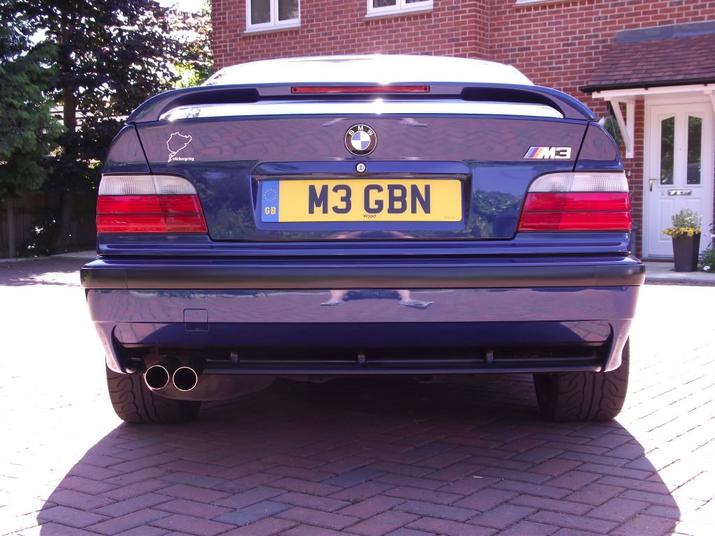

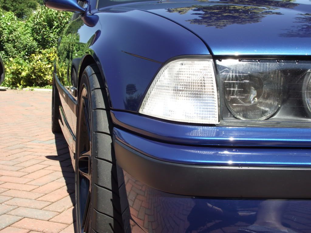

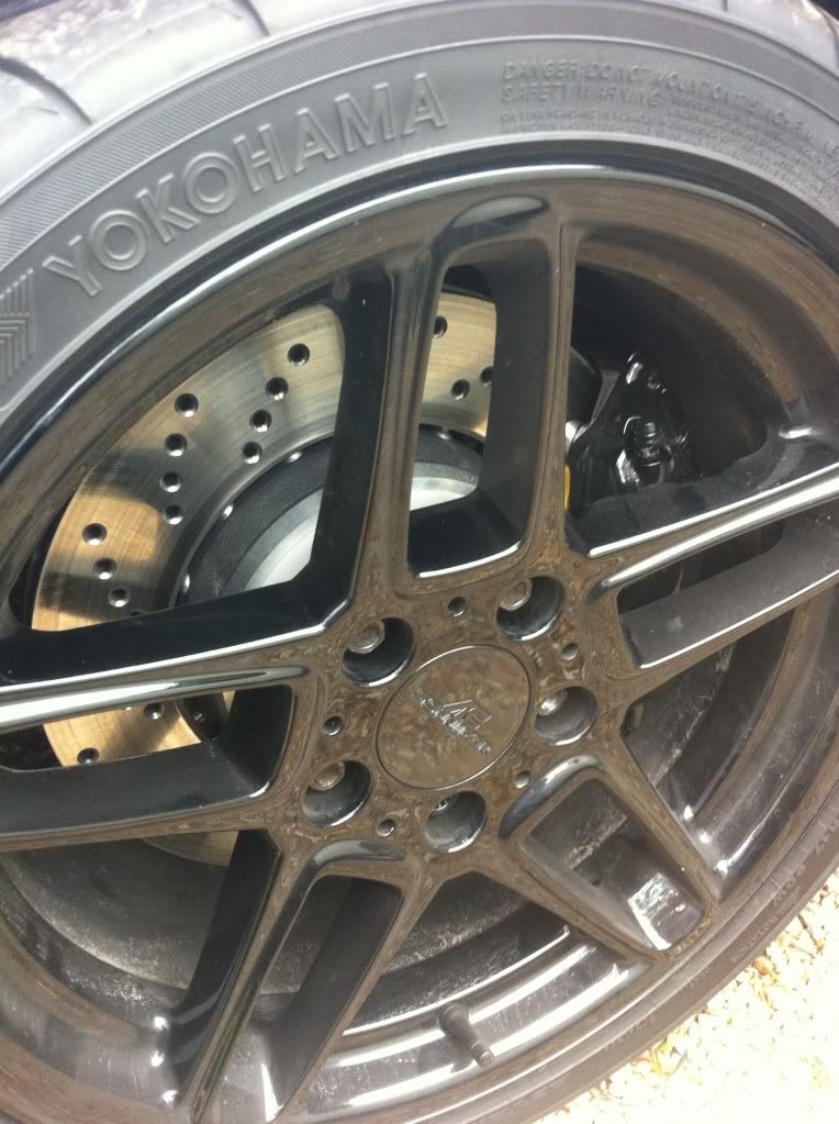

            Now that I was running 25mm spacers on the front the car looked silly as the rear were too narrow. I put my original 15mm spacers on the rear but the tyres rubbed as my Yokohamas have quite a squared off tyre wall being a track tyre. A call to Dan at Arch Enemy saw my rear arches rolled and we fitted the rears on with 15mm spacers. Its still very close and there is now mm's to spare.
            I took some pics after it was done. I still need to sort out the ride height as it is sitting too high here for my liking but the problem I have is accessing my drive. I have to go over a small bridge and the car grounds out badly underneath and on the GT splitters if its too low.
