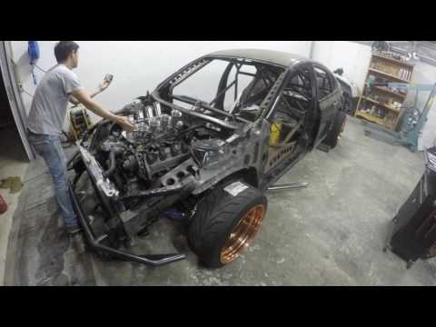

latest video, I would like to gather all I was done 2016 but it rather make you boring so just put in a little. Almost about header.
<3Last edited by phet_fresh; 12-13-2016, 07:21 AM.
