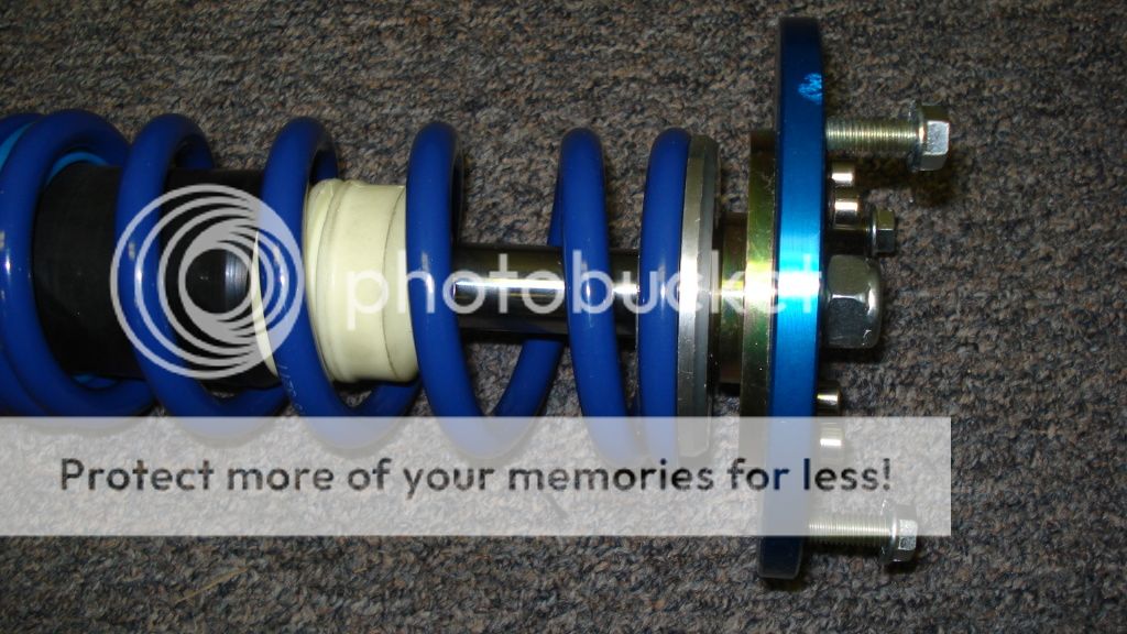

                        Long story short, I relocated the sleeves 4" lower and can now drop the car on the bumpstops.
                        QUESTION #1 - If I adjust my ride height to "barely" sit on the bumpstops, how much higher do I need to set it to have adequate suspension travel for daily driving using 600lbs spring rate?
                        I know Zic and SheaMoose suggested shorter struts/housings, but after thinking about it, most of the suspension travel is taken up by the stack height. If I reduce the stack height, I can regain suspension travel and potentially lower it even more.
                        After talking to NegativeCamber, I am going to try to replace the stock strut hats with shorter Cosmos Racing camber plates. Cosmos (or anyone for that matter) doesn't make a camber kit for the e23, so if anyone knows a place in the Bay Area where I can get them modified, please let me know.
                        PICS BELOW ARE NOT MINE BTW...
