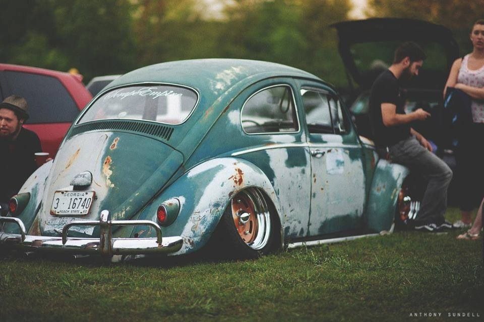

    February 2012 I purchased a "barn find" 1960 beetle from a friend in hopes and dreams of having a sweetastic, raunchy ass, slammed on its balls, beetle.
    Some of the re-spray paint was flaking and I saw some original one year only color code paint and got delusions of factory paint and patina so I easy offed the entire car and found a bunch of beautiful body work. But I decided to just run with it because I couldn't help but like something about it. So I started building it.
    Up front I put a 5" narrowed beam with super clocked adjusters and 2.5" drop spindles. Out back I slapped in 4" drop plates, heavy duty golf cart shocks, and went down one out spline on the rear torsions. New drum brakes all the way around for mad stopping power, new master cylinder and all new hard and soft lines.

    For more offset out back I found some type 181 (VW Thing) drums, which pushes the rear wheels out an extra inch. Just had to turn down the face of the drum and boom HERRA FRUSH.
    The difference between beetle and thing drums.
    Then I decided I didn't want to ride around on stock wheels cuz that shit is lame, so I had some old school appliance pacer centers sett in some custom barrels built at my specified offset.
    With suspension at full droop.

    I'm now in the process of building a new transmission with more acceptable gear ratios for cruising on the interstate and building a 2" tranny lift which will give me the clearance I need under the motor as well as pull out a little camber so my axles can stop committing suicide.
    Hope you guys enjoy this turd.
    I more than love this car. I don't even really have a word for it... Super Love maybe? Anyways, this hing is awesome, you are awesome, and I loved seeing it cruise around at sowo.
