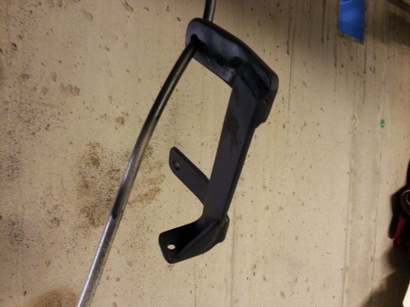

      An popular upgrade on the Mx5 is a brake master cylinder brace. They are possible to buy in all shapes and sizes. Some cost more than others..
      They help a little against firewall flex and help with the feel of the brake pedal.
      So it was time to find the nearest workshop, and cue the music!

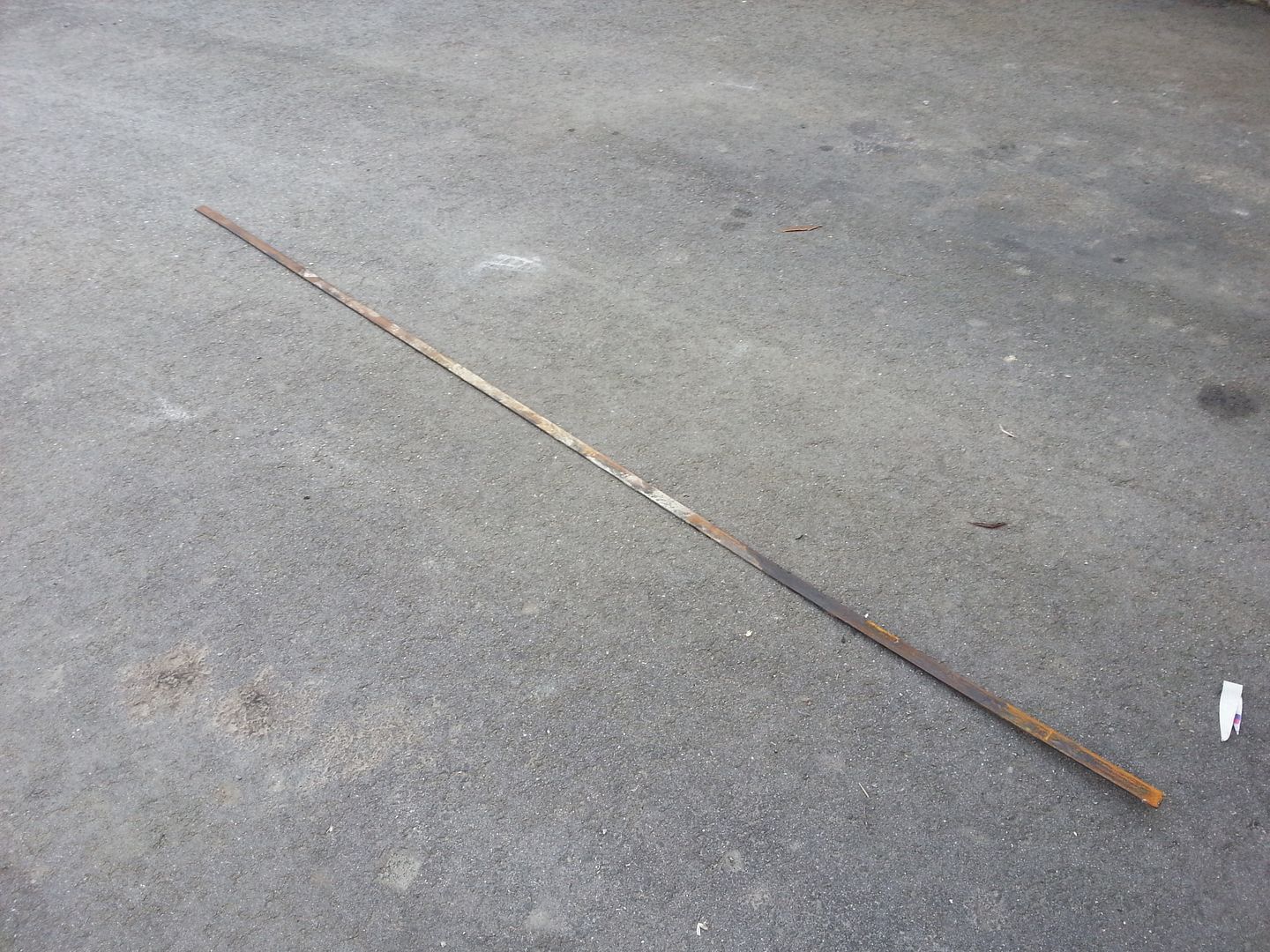

      After looking around in the trunk of my car I found this!

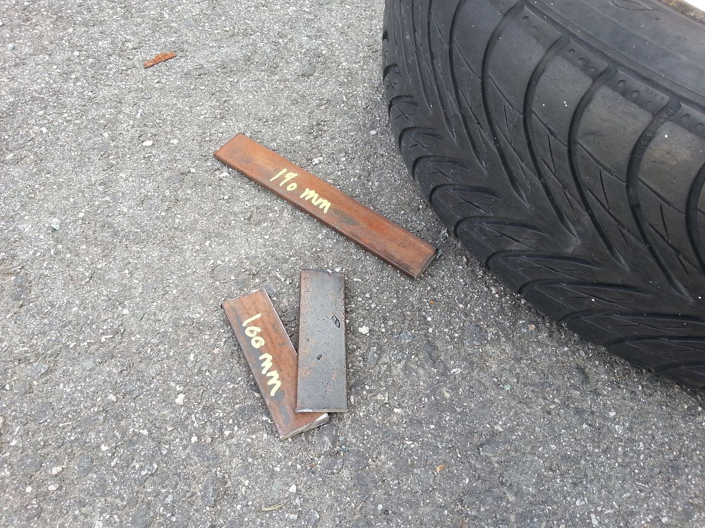

      A piece of steel, 3 meter long, and 4mm x 30mm
      Found some tools:

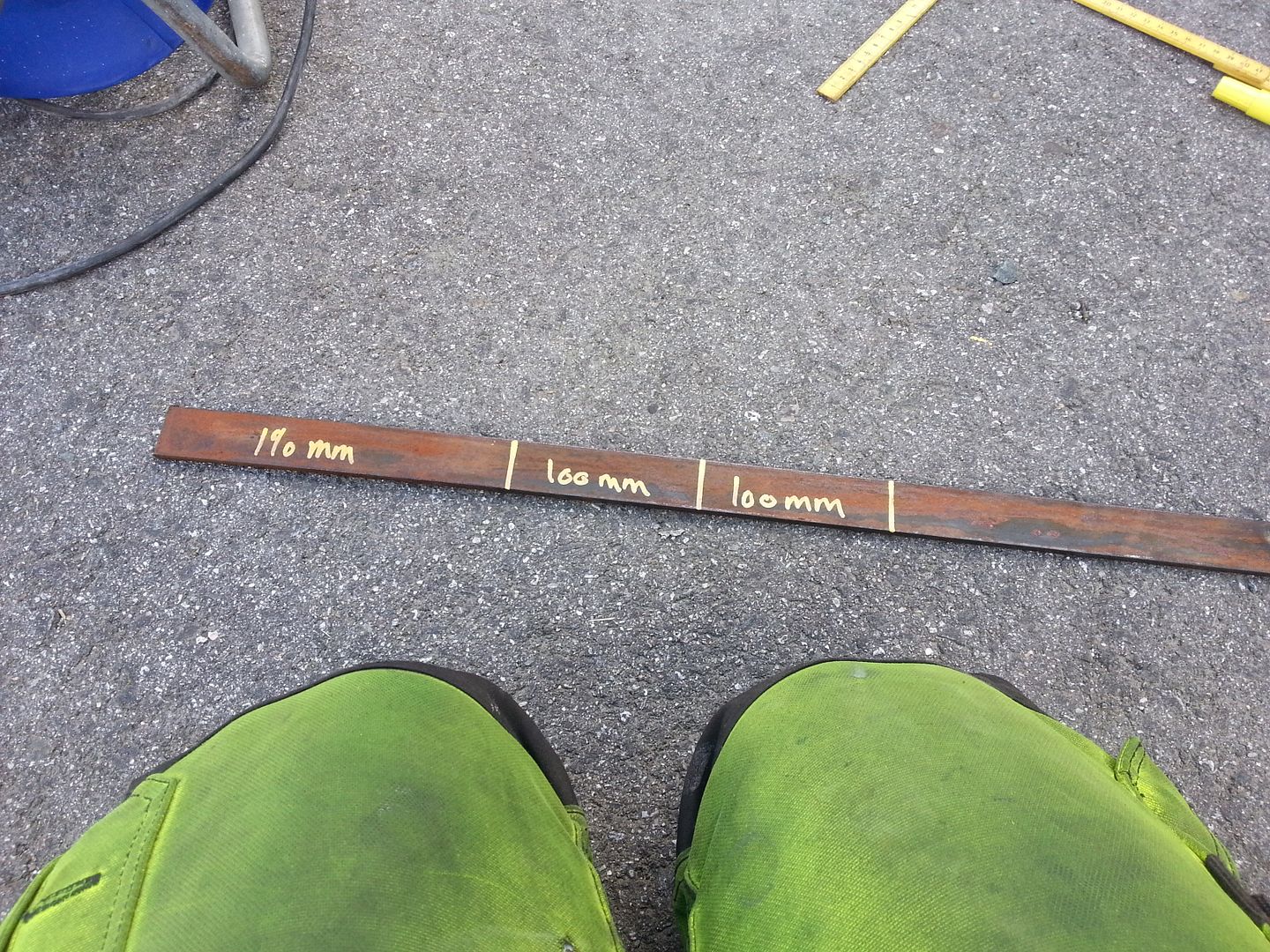

      Measured what I needed,
      and marked where to cut:

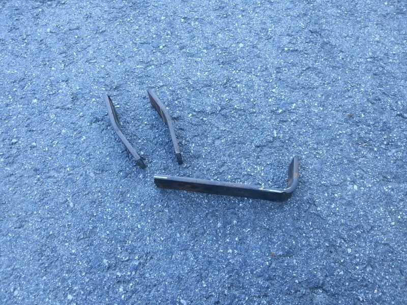

      2 pieces that's a 100mm and one 190mm long piece.

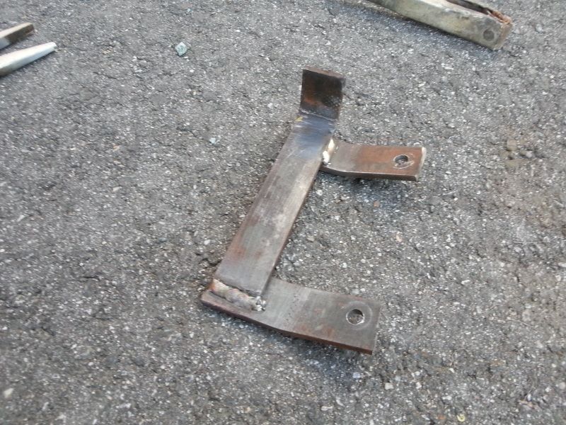

      Angle grinded the heck out of them.

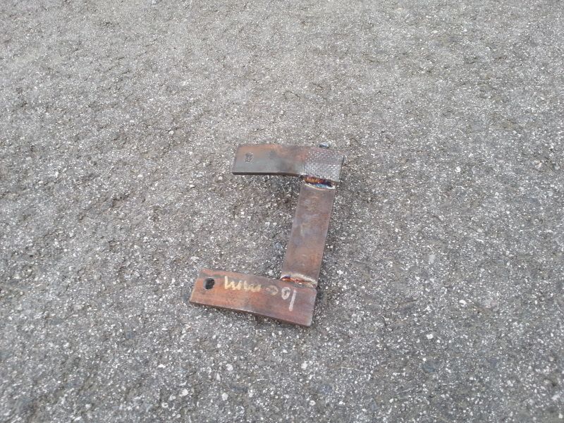

      And, after some heat, and a little.. HAMMER TIME! they looked like this:

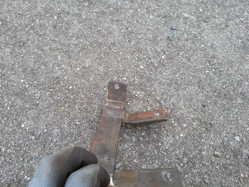

      After some more mocking up, welding a bit, and some hole drilling:
      And when everything was a 100%, it was all welded together.
      Drilled the hole for the adjusting bolt.
      After that I welded in some reinforcing, and grinded all back to clean steel.

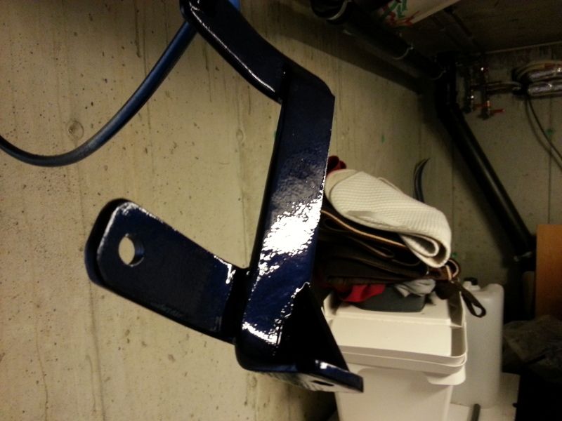

      Followed by some coats of primer:

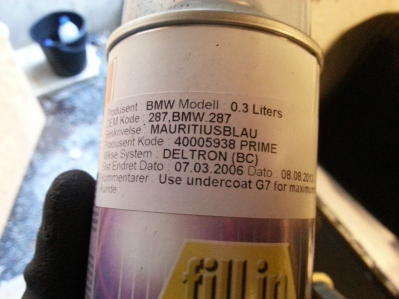

      And some coats of paint.
      I only had some BMW paint around, but they make a lot of pretty things, so why not?

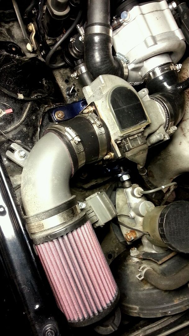

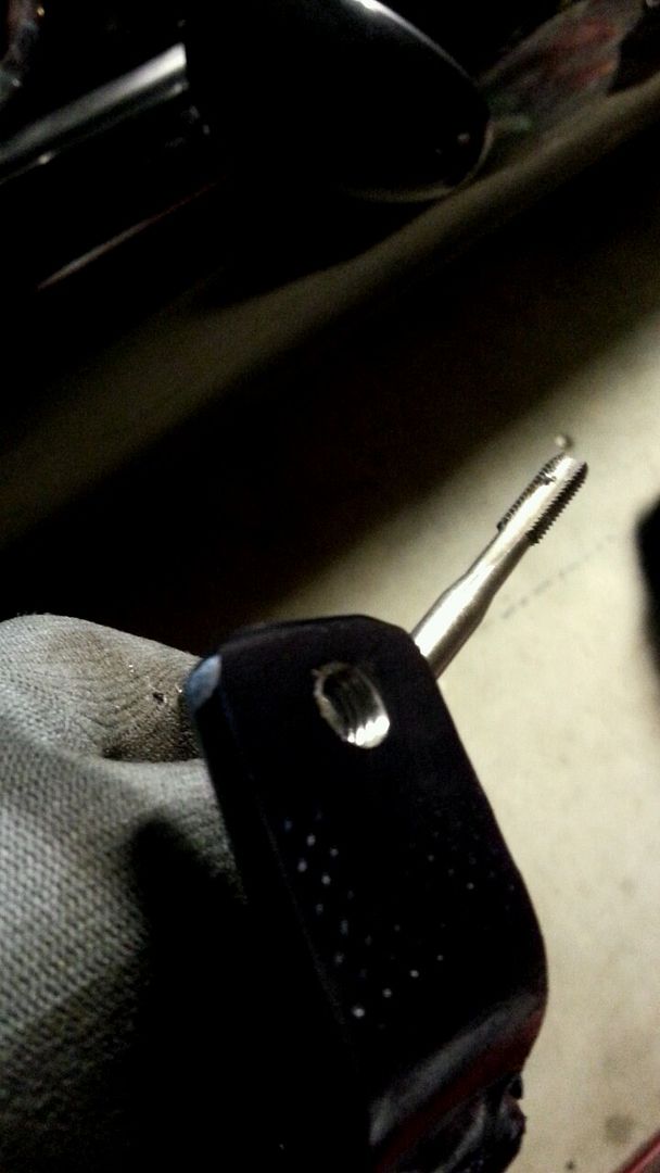

      After everything dried, the hole for the adjusting bolt where tapped to 8mm, and later re-drilled and re-tapped to 10mm for strength.
      Mounted!
      Easy as that!

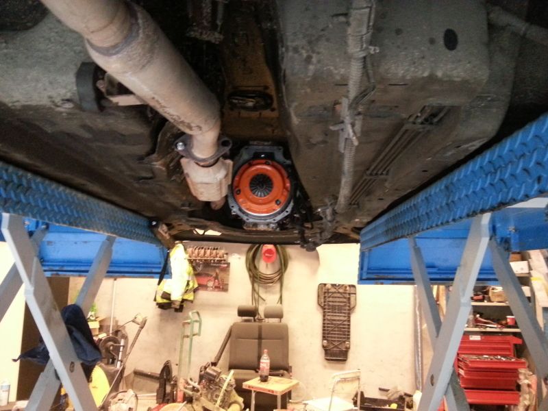

        Mr Miata is getting a new flywheel and clutch today!
        A little over 3kg flywheel, and total, with clutch, around 8.6kg
        • #64
          Mounted the new flywheel and clutch.

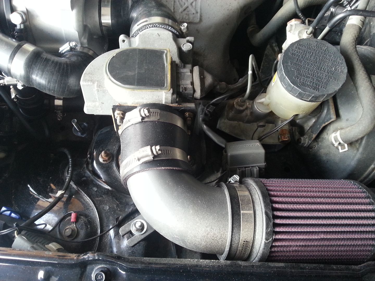

                        After three weeks of summer vacation, the car now got the Megasquirt mounted.
                        Removed the original MAF and installed a Auto Meter wideband sensor.
                        Had two nights with a buddy and a computer on a local highway, and after a couple hours each night and god knows how many km's the car is actually pretty well tuned.
                        I'm currently running 0.5 bar of boost, and the car got a lot more power now than before.
