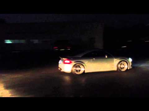

Videos
stupid vid i made
After Installation of Your Haldex Works Powertrak Insert
