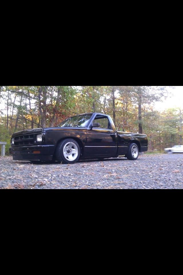

  • looks great! how exactly did you do the cluster lighting mod? and are you running spacers up front? and are the front wheels on the front and rear with rear or the other way around?
        Pull the cluster and get 168 led bulbs for a direct replacement or get 194 bulbs and re solder them into the 168 sockets like I did. Im running the lower offsets in the rears and spacers all around.
        Youll have to figure out the rest. Now that everyother first gen wants to run my setup. I need to keep secrets which sucks because I love to share my process. Wish everyone would just appreciate my set up and come up with there own look. Like I love your truck a lot. and its look. Id never go and build something that looked like someone elses. I never understood why people do that.

                        • Well trans number 3 is toast. Rebuild kit is on the way. Hopefully with us rebuilding it this time, I wont have any more issues. All this trans money is messing up my air ride money lol.

                            • Looks like I need to shorten the drive shaft and rebuild the trans. At the height Im at the drive shaft is pushing the tail shaft in on every bump I hit. That seems to be what keeps destroying my transmissions. At this point Im fully frustrated. Im just gonna have to knuckle down, sell some art and extra stuff I have and scrounge some money together. I know this truck is worth building and doing it right. This is all just a real big kick to the nuts right now. This to shall pass and I will end up with an awesome truck.
