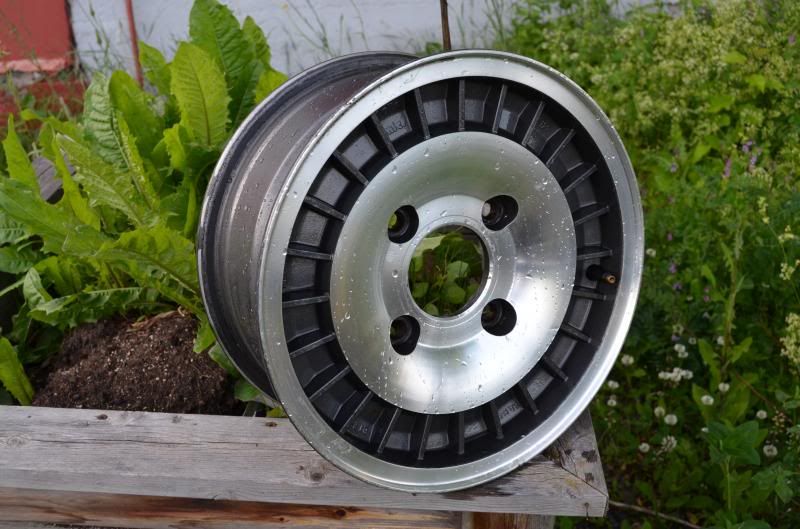

you will have far more 6 lug options than 4x140, that bolt pattern is all but extinct. mid 80's peugeots are 4x140, but those require peugeot specific lugnuts, and that's not worth the trouble for weakass stock offsets. either redrill the hubs (sjrlift.com will provide the machining service for a nominal fee) or you can redrill a 6 lug wheel to 4x140 just as easy, but personally, i went with the hub redrill.
Only the Peugot 504 and 505 are 4x140. And I use the original Subaru lugnuts on my 505 Gti rims.Originally posted by johnnytsunami View Postyou will have far more 6 lug options than 4x140, that bolt pattern is all but extinct. mid 80's peugeots are 4x140, but those require peugeot specific lugnuts, and that's not worth the trouble for weakass stock offsets. either redrill the hubs (sjrlift.com will provide the machining service for a nominal fee) or you can redrill a 6 lug wheel to 4x140 just as easy, but personally, i went with the hub redrill.
I wondered a good while if I should get the hub redrill or find som 4x140 rims, the I found some 14" 505 Gti rims at a man a buddy of mine bought a car from. It's safe to say they went home with me
They look good on the car, but you should see if you can score some 15". They would look tits.
Here are some pictures if you dont mind, I remove them if you do

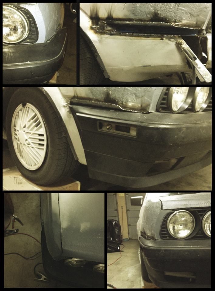

Called around about getting my hubs re drilled and no shops so far are down to do it.
I've got a lot of places I haven't called yet though! My car is back at the garage being
worked on, doing some more medal work at this point because I'm not satisfied quite yet.
