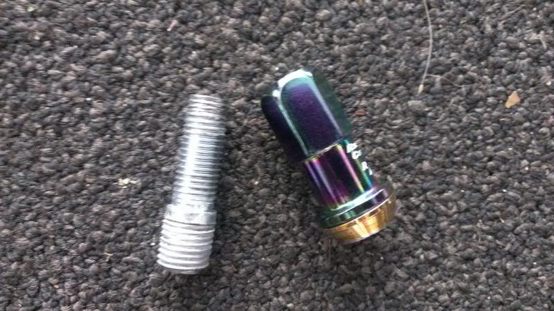

                        Running stud conversion 14.1.5 -> 12x1.5 so I can run my old project kics neo chrome R40 lugs.

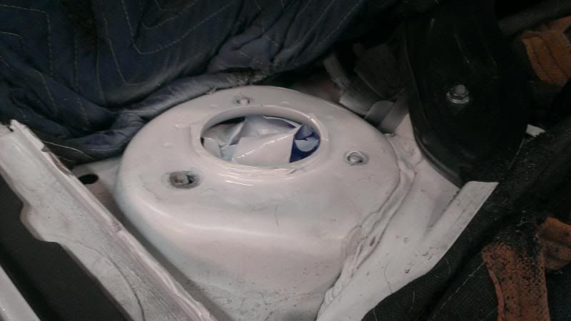

                            Got the strut tops cut off so that I can get the camber adjusted while getting an alignment (via camber plates on airlift performance fronts)
                            Getting aligned final specs are -2.0 front camber, and -3.0 rear camber 0 toe all around or as close to 0 as possible.

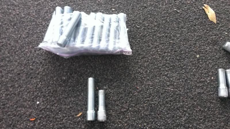

                              Replaced a stripped stud last night, replacing all my conversion studs to longer ones to accommodate spacers.
                              My car floating like a space ship lol!
                              As you can see my old stud setup only got about 5-7 threads before stopping.
                              These new studs will get me about 15 turns
                              All installed, now I just have to let the red locktite dry for 24hrs before I can mount anything to them.
