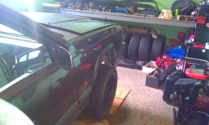

              The new color gave it so much class, without losing the "ratiness". Wheels in black are the way to go, imo.
              Keep it up. In for more.

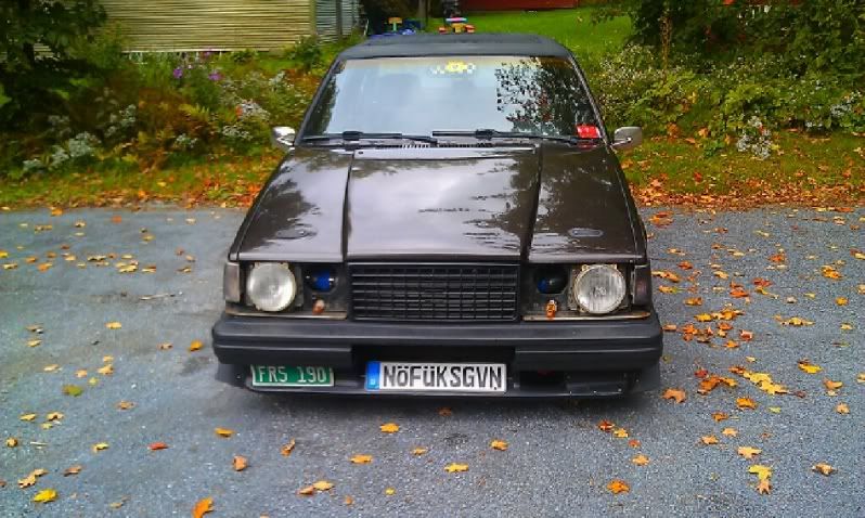

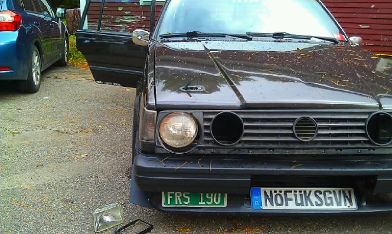

                    As it turns out winter took its sweet time getting here, so i had a few more months to play with the volvo. i started looking at different lighting ideas, as i was getting tired of not being able to see anything in our dear-infested state. something needed to change.
                    i picked up a set of these for cheap. word to the wise, dont ever waste your money on these pieces of ultra shit shit.
                    So that idea was out, and i realized instead of just finding a generic 4x6 light to take the stock ones place, why not go one or fifteen steps further and just do a conversion?

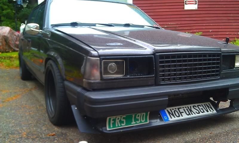

                    so the original thought process started with a leftover vw mk2 quad round grill a friend had lying around.
                    i wasnt sold on it, and thought it looked kindy goofy.
                    but i bought some used single rounds for a mk2 anyway and to my surprise they basically bolted on.
                    a few cuts and chops later with a single round grille and i had something that i was totoally blown away by.

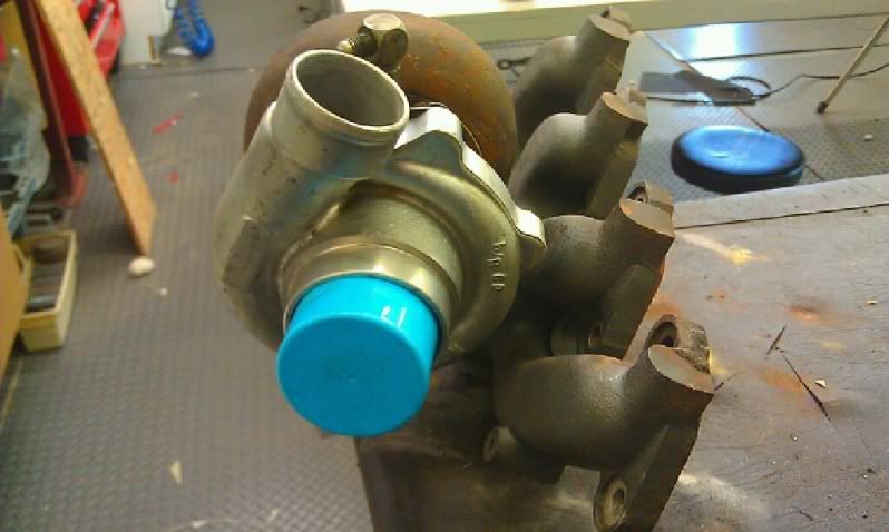

                    on the left is a stock turbo, on the right is the newly aquired Banks A/R .60 snail.
                    oh boy.
                    first thought into my head was "awesome" second thought was " i have alot of work to do.

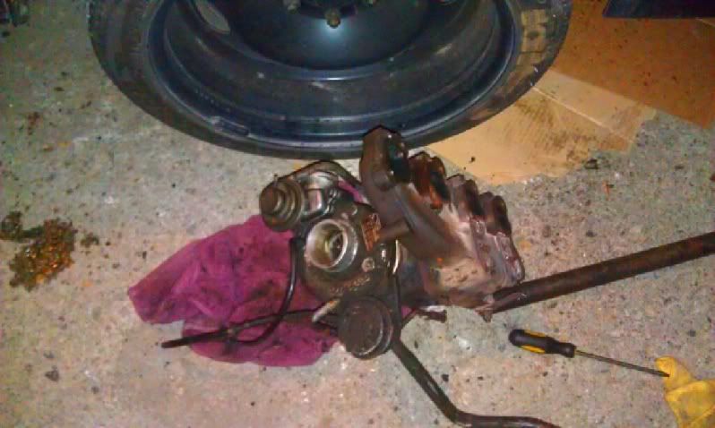

                    step one was pull the stock manifold and old beat up turbo out.

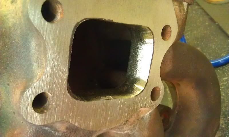

                    Then to my surprise the manifold and new turbo had the same bolt pattern, which i did not expect. so all i had to do was a little port matching and new hardware.
                    and voila!

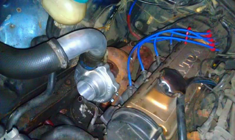

                    brought it home and threw it in, literally have less than a 1/2" between the exhaust housing and the fenderwell.
                    this is basically where it sits now,
                    Waiting on stainless oil lines and A/N fittings to arrive, also have to make a downpipe and plumb in an Audi external wastegate.
                    Fingers crossed nothing explodes.
