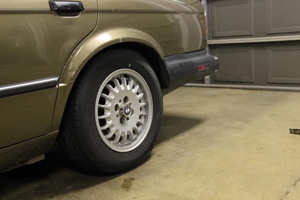

    The day I brought her home. You can see the awful paint and bodywork that needs to be done.

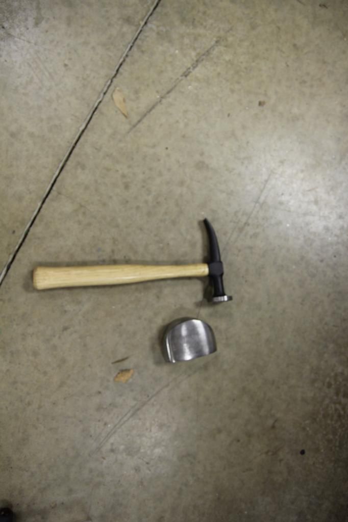

    Then I got started on some body work, got the hammer and steel block out and used that to get rid of all the dents on the hood and trunk.

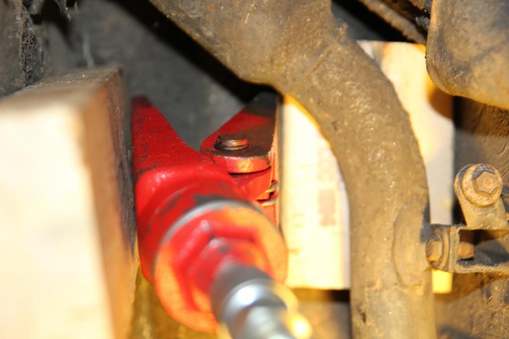

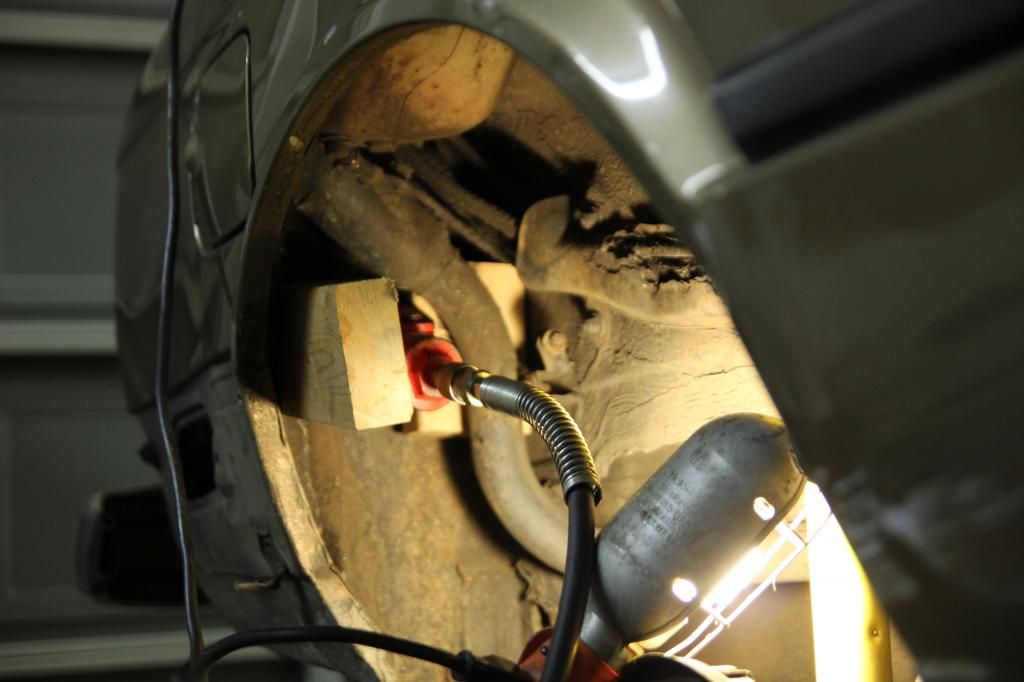

    Then it was time to move on to the big stuff and Dad got out the porta power. He showed me how to use it and we got to work on the right rear quarter panel dent. Just got the big part of the dent out and will finish all the more minor stuff in the quarter panel over the rest of the week.

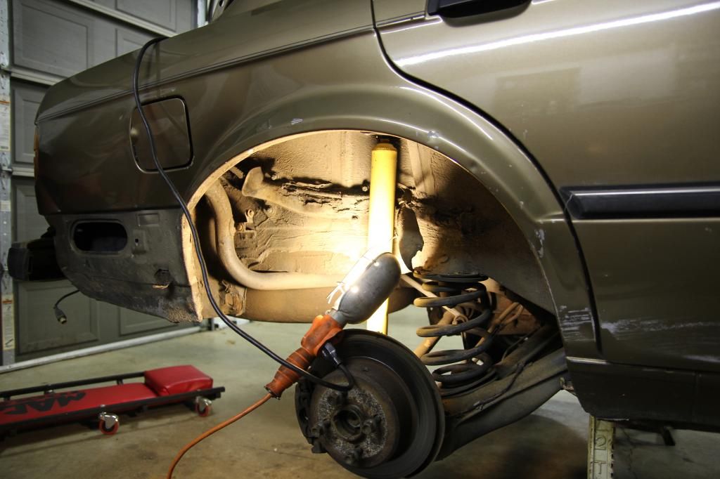

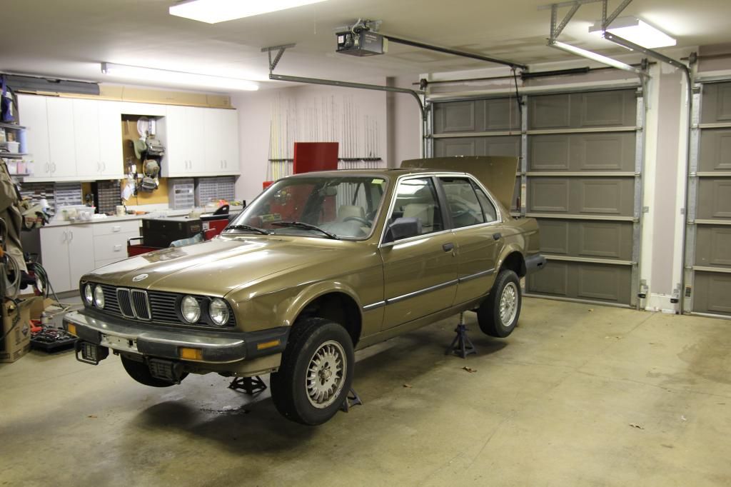

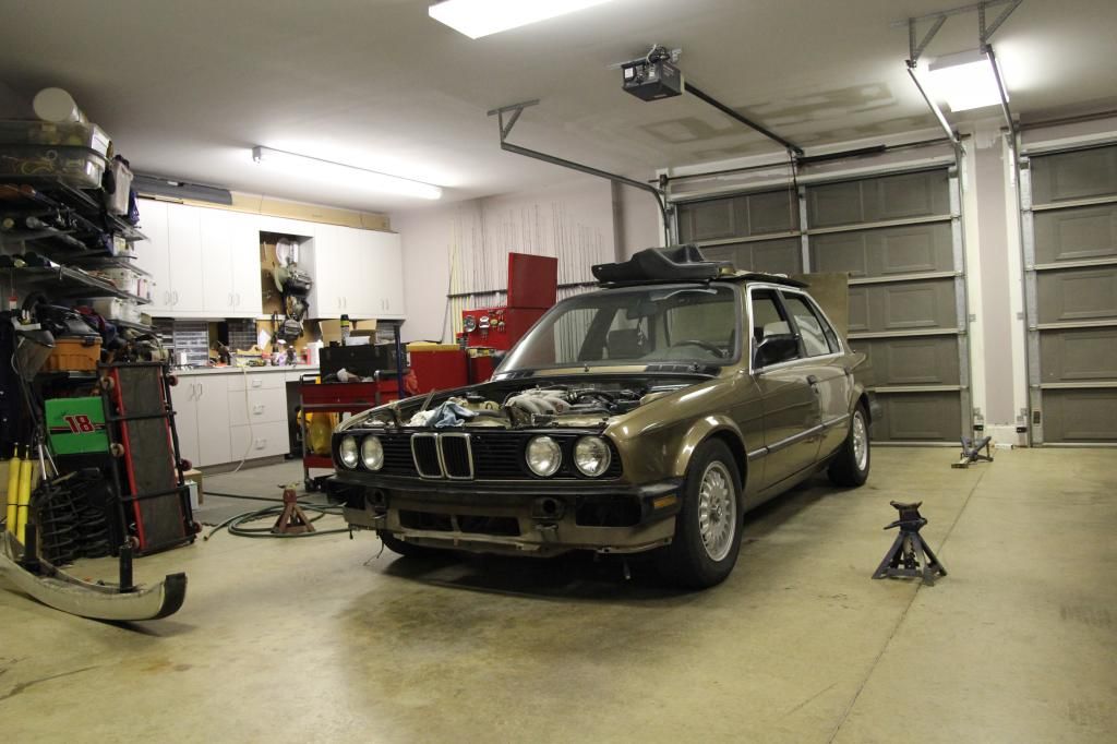

    Then put her on jacks and sat like that for a while.

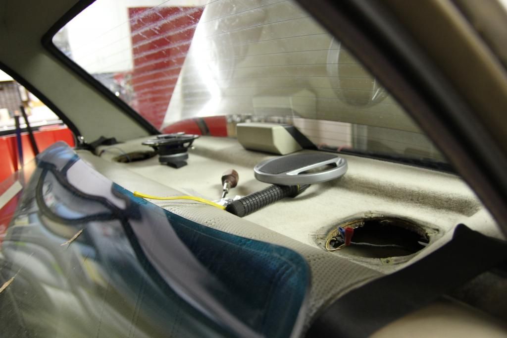

    Next, removed the back seat to plan the wiring for the rear speakers.

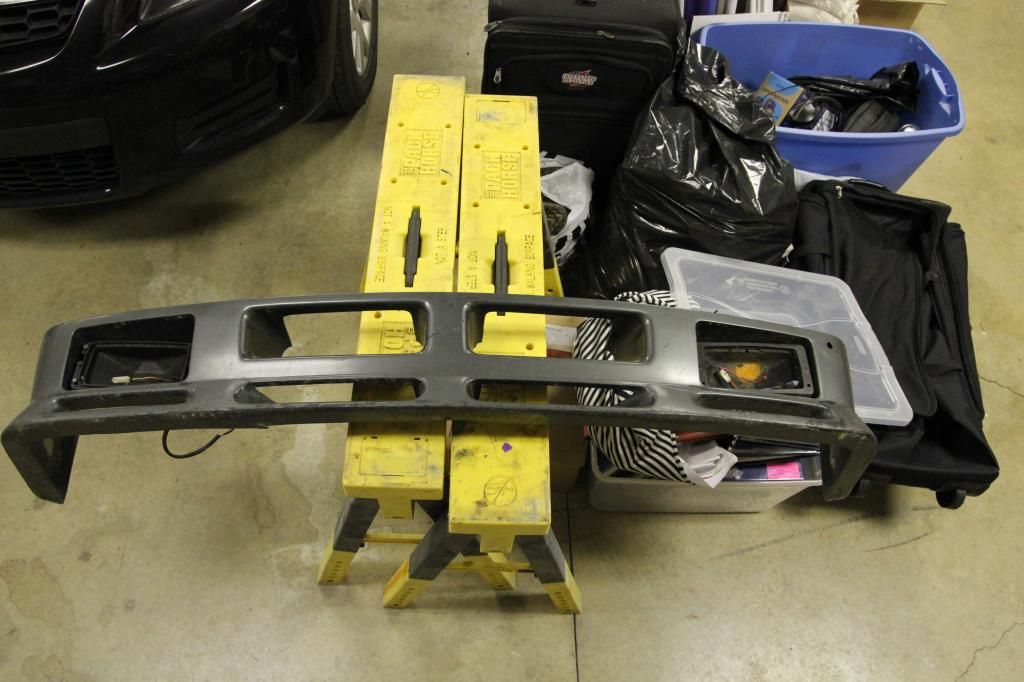

    Next it was time to do the bumper tuck. Looked up the how to thread and saw that it was a piece of cake. The 86 front bumper is mounted a little different than the 88' on the thread. There is no hole in the bottom of the bumper that goes to the bolts. Instead, you have to reach up and unbolt the bumper shocks from the body. That was a tight fit but got it done. Got the shocks off then went to drilling.
    Got through both layers pretty easily so I was pretty happy this was turning out well. I was curious to how hard it was to compress them so I tried hitting them with a hammer and that didn't work so I got out the jack and tried using the car as my compressor. Well I just used the car and a jack extension because it lifted the car 3 inches without budging the shock. This little SOB deciding to be the biggest pain and after trying and trying I still couldn't get either one of them to compress. My Dad got home and couldn't figure it out either so he got the sledgehammer and after about 5 hits finally got it to compress.
    Now I thought the hard part was out of the way but with the 86 bumper design the way it is a pain to get the bumper back on. I just decided to leave the bumper off for now since I have to have it off to do some body work anyways.

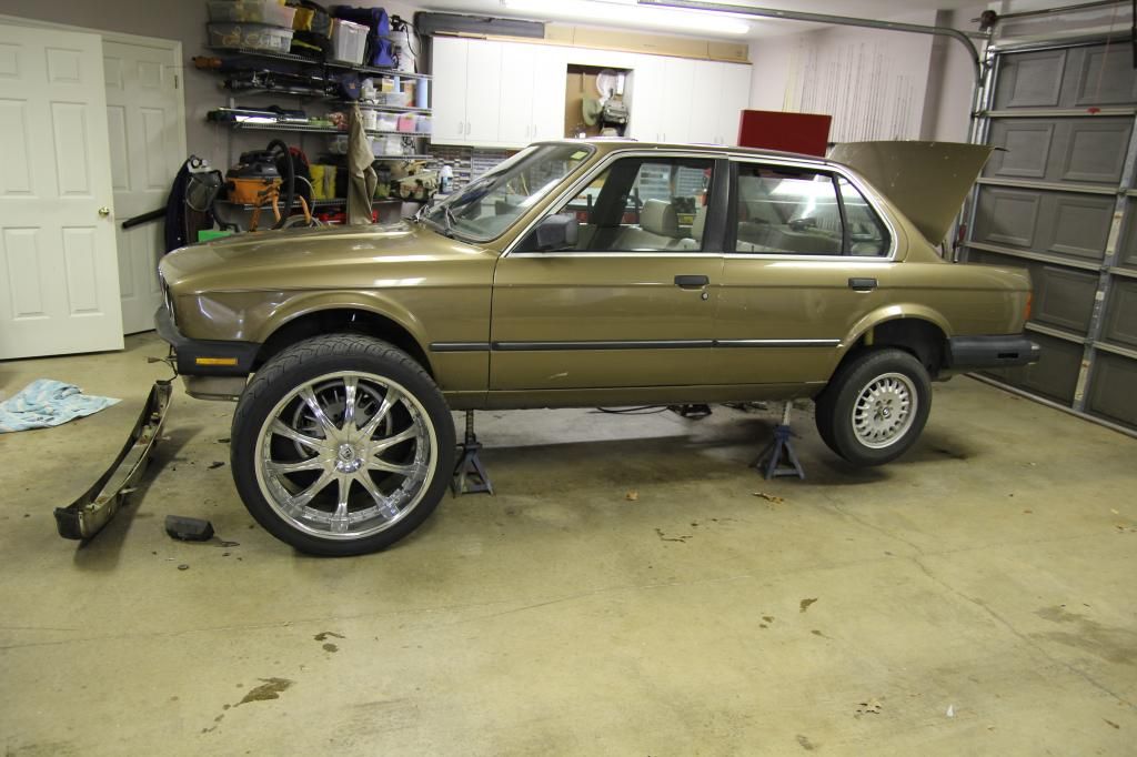

    ohhhh and I test fitted the new shoes. Am I doing this right?

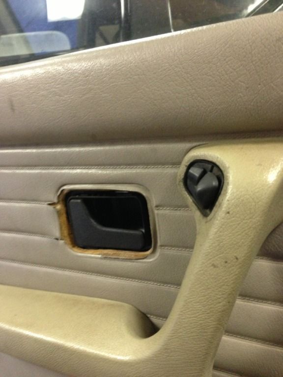

    Then got the door latches installed. I still need the trim piece to go around it but it's better than what I had before which was no handles at all.

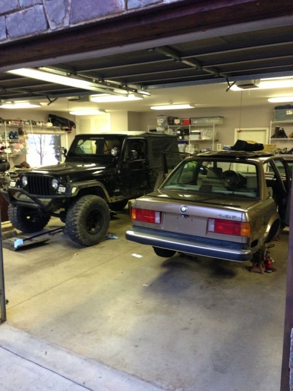

    And then I had both cars in the garage unable to drive. Cracked my transfer case in the jeep. :cry:

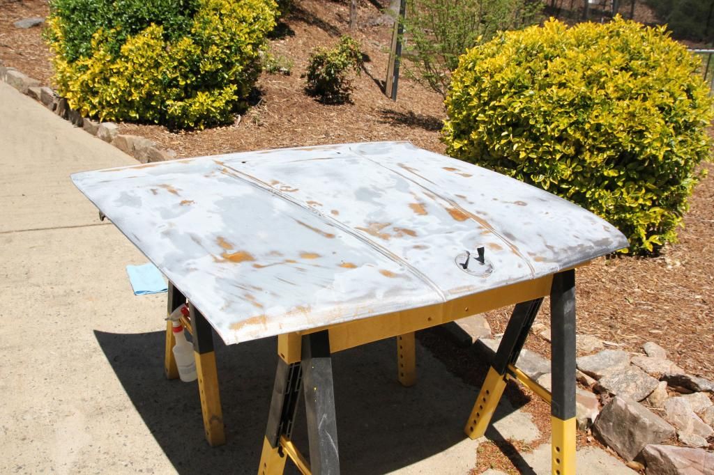

    Then one night some friends and I got bored so we took the hood of and stripped the paint and sanded it down and started to rust it.
    First attempt didn't go too well, didn't get all the primer off so I had to resand everything down.
    pic of first attempt.
    I have the hood almost completely rusted where I wanted. I'll post pics later.
