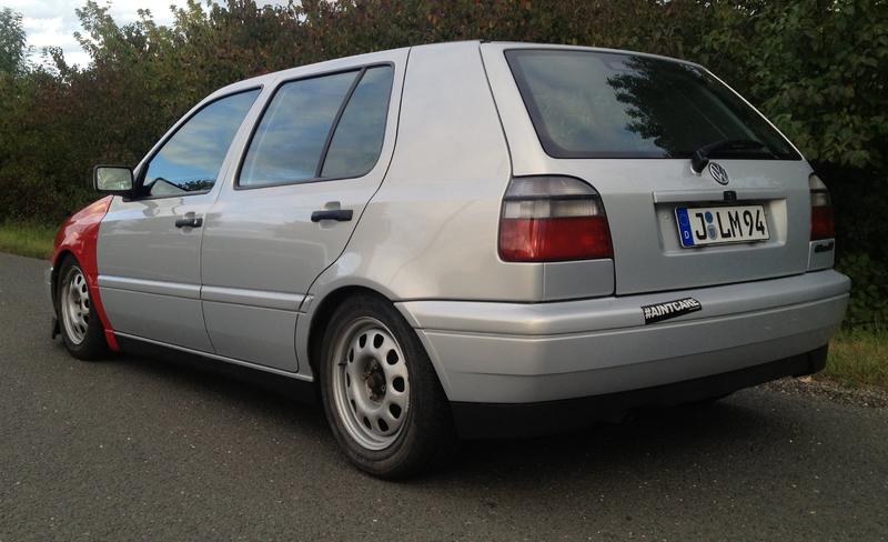

    Much more hasn't happened yet. Just a little while ago I snapped some pics to show you how she currently sits. Enjoy my static fitment

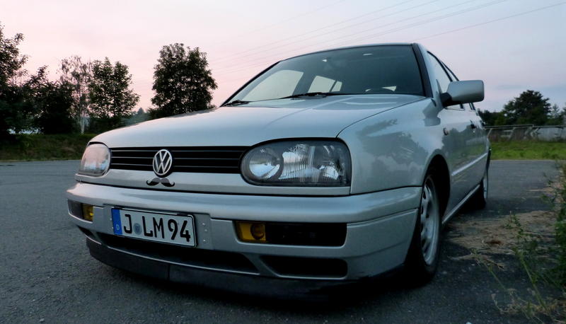

    Yeah, I slapped a JDM stache on. Am I scene yet? No seriously, I like it more than I expected, so it will stay for a while.
    Those steelies are different ones as seen above, they're equipped with summer tires. Not pretty, but at least in somewhat better shape than may winter wheels

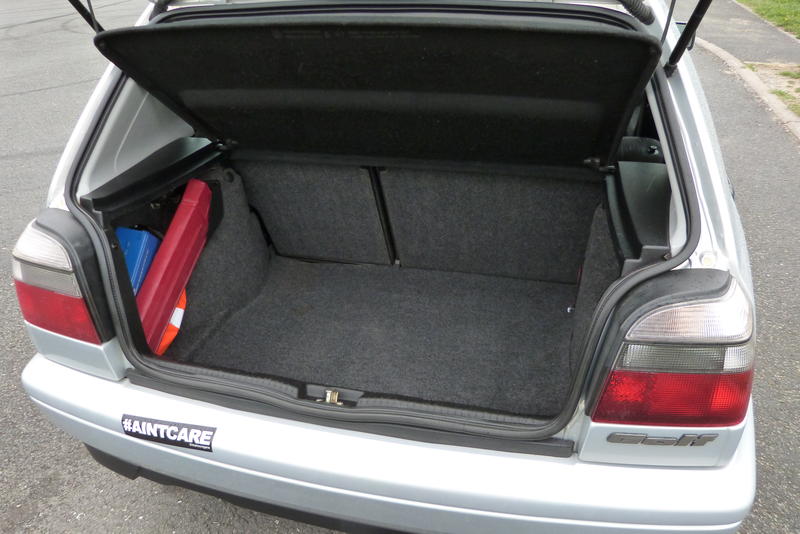

    There is some aftermarket speaker wiring in the trunk, which was left by the PO. I might use that.

        Original French fog lights. Which made my front end looking like this:
        You may recognize that I also swapped the headlights against original ones from a Jubi GTI (anniversary edition). Unlike the old ones these are blacked out (which is illegal in Germany when you do it on yourself, so I had to look for such original ones) and also twin headlights instead of the standard single ones.
        My car came originally with single headlights and, consequently, with a different harness than Golfs with standard twin headlights. Because of that, the low beam was automatically shut down when the full beam was turned on (to avoid overheating in the single chamber). Since I have lights with two chambers now, there was no need for the shut down any longer, so I searched for a bypass to obviate that. Finally found one and plugged it in:
        (The reversed 'C' in the pic)
        Thus, the low beam finally stays on even when the high beam is switched on

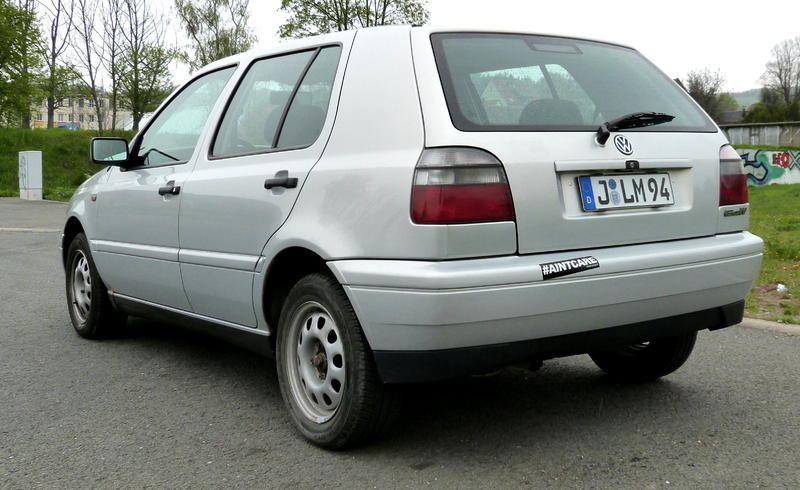

        Lastly another shot of the back of the car. It most definitely has to come down some inches
