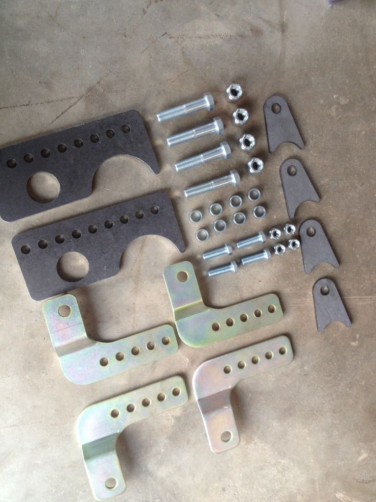

      Parts came in today, still no coilovers. Got eleventy-billion dollars worth of AN fittings AGAIN (I need to stop this) and my QA1 mounts for the coilovers.

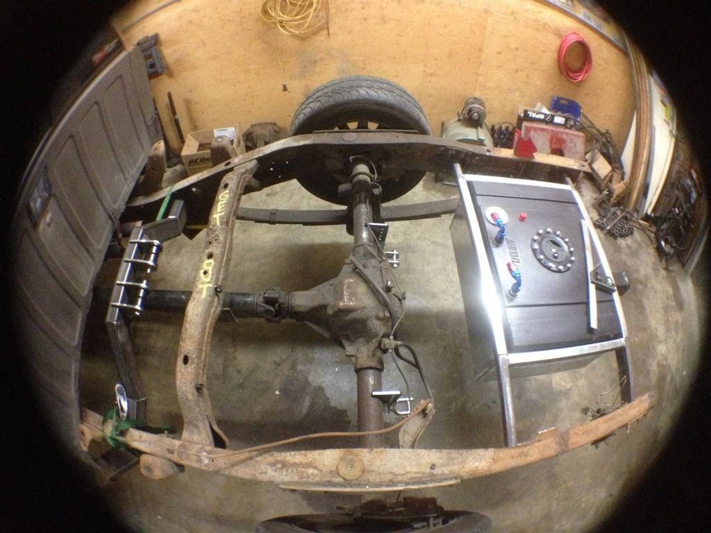

      Finished welding the fuel cell tub and got it mocked up. Once the leaf springs are removed and the rear half of the frame is boxed in I'll weld this thing in for good.
      It's offset to allow the charcoal canister and vent valve to fit within reason, aswell. A rough mock up.
      It is all super tight to the trailer hitch, all fits under the bed, I couldn't be happier. I realize it doesn't look like it, but the edge of the trailer hitch is about 1/4" from the cell tub. TIGHT.
      I tossed the front x-member in for a photo-op, as well as tacked in the lower coilover mounts (rough eye-ball again).

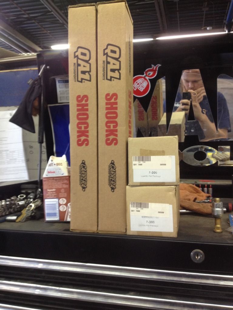

            • I just went and had a good poop at work, and when I came out QA1's were sitting on my toolbox. So, naturally, I completed ignored what I should've been doing and assembled.
