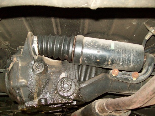

            One thing you need to check on your car is to see if you have the Hydro-Pneumatic compensator on your differential. looks like this:
            If you have that, you need to swap it for the static spring like this:
            if you dont replace it, when you cut your springs, your car will be low for about a day or two, while driving, the rear will pop back up, that is of course if it still works. I ended up cutting a coil and a half off the static compensator as the static one will give you positive camber.

                  I don't have the Hydro-Pneumatic compensator, i think those never went on a 250 only the 4.6 and 6.3 had that as far as i remember

                        Nah, def had them for your car as well, almost all of them with the split diffs had them, what I dont know is if they all came standard or if it was an option and the static spring came with the car as a replacement.
