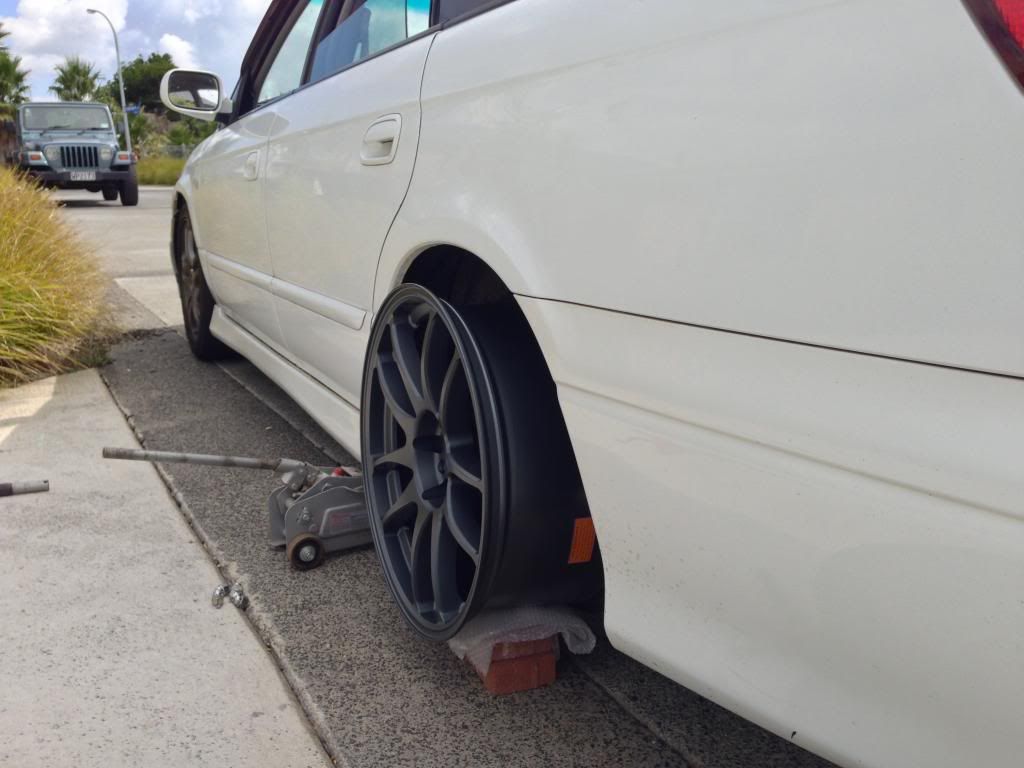

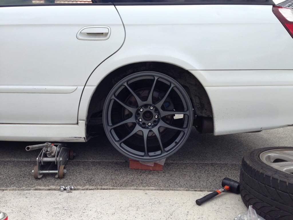

Been reading forums all day. Found one guy with 18x9.75 +20s which poke more or less the same as mine. Have messaged him to see if he has any info. What I have confirmed is that my set up is the same as the next gen legacy (BP/BL) and there are camber correction kits available for that shape.

going to buy two tyres next week or the week after and start playing, then once its all set I will get better tyres if need be. I did another test fit today on the front and it seems like it will work without modifying front end, just dial in camber at the front with top hats.

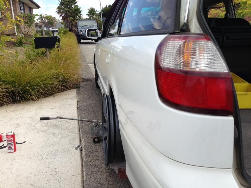

So today I tried the wheel on the back again at home and wound the rear coilover as low as it would let me. Doesn't go as low as I'd hoped for but camber will solve that and the front has a lot more room so should be good! Any body shortened shocks on these?
