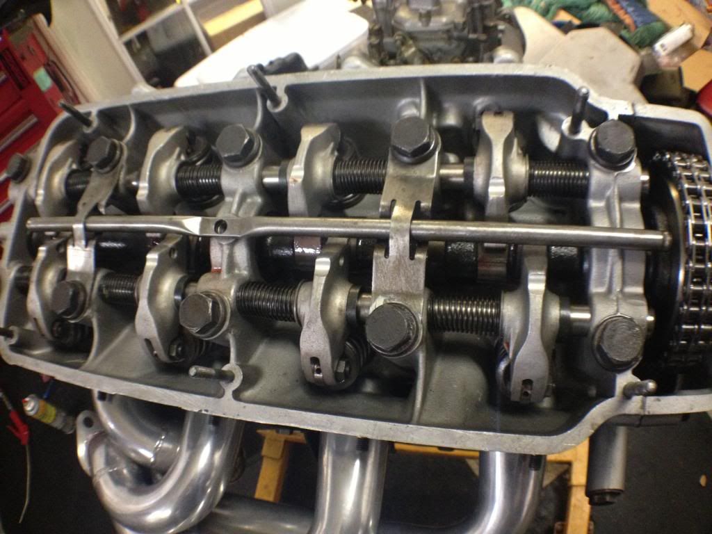

    I've been lurking on this forum for too long now. I work for a small independent german car shop. I thought I'd show you guys one of our projects we are getting ready for Bimmerfest!
    Parts List (I might miss a few things since this is off the top of my head)
    Engine- The original M10
    - Schrick 292 Camshaft
    -Stainless Steel Exhaust/Intake Valves (Oversized)
    -Cast Pistons (90mm) 9.5:1
    *We tried some other pistons that would bump compression up to 10:1 but they were really bad quality. We ended up getting a set from Ireland Engineering. Good quality stuff!

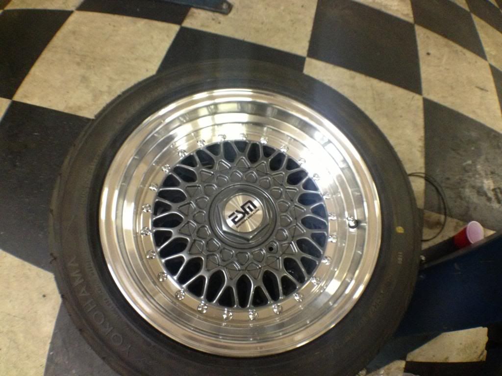

    -ESM 002R 15x8 Front and Rear et15

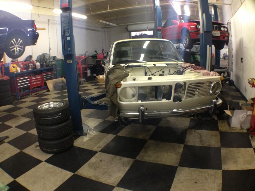

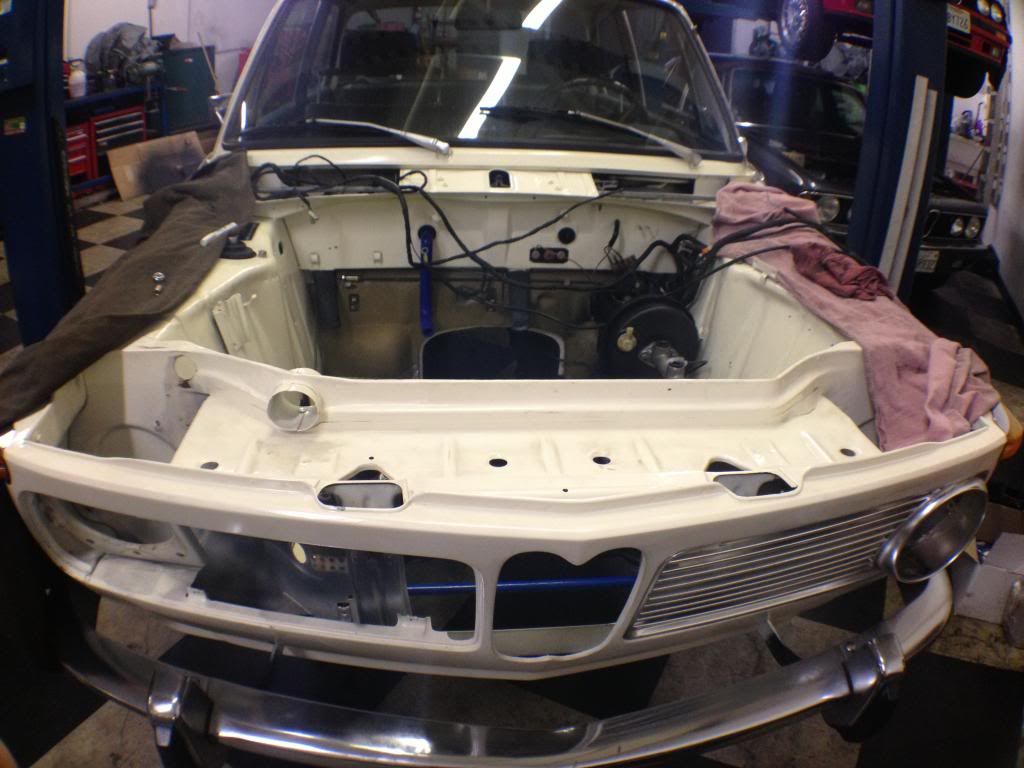

    This is how the car looks right now. Just chillin on the lift waiting for her engine.

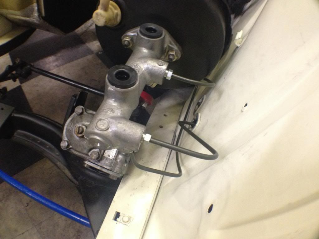

    Just Finished the brake lines, brake booster, master cylinder etc. today

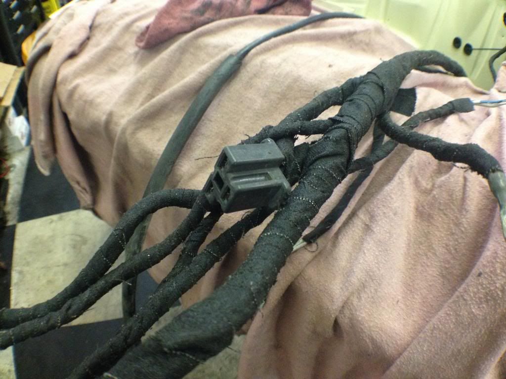

    We wrapped the whole wiring harness in the original Wurth cloth electrical tape

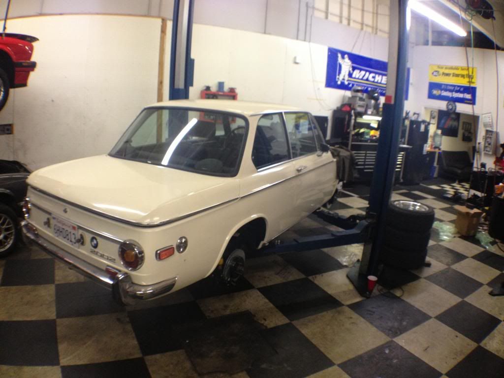

    Just a few more things left to clean/refinish/bolt on and then its good to go!

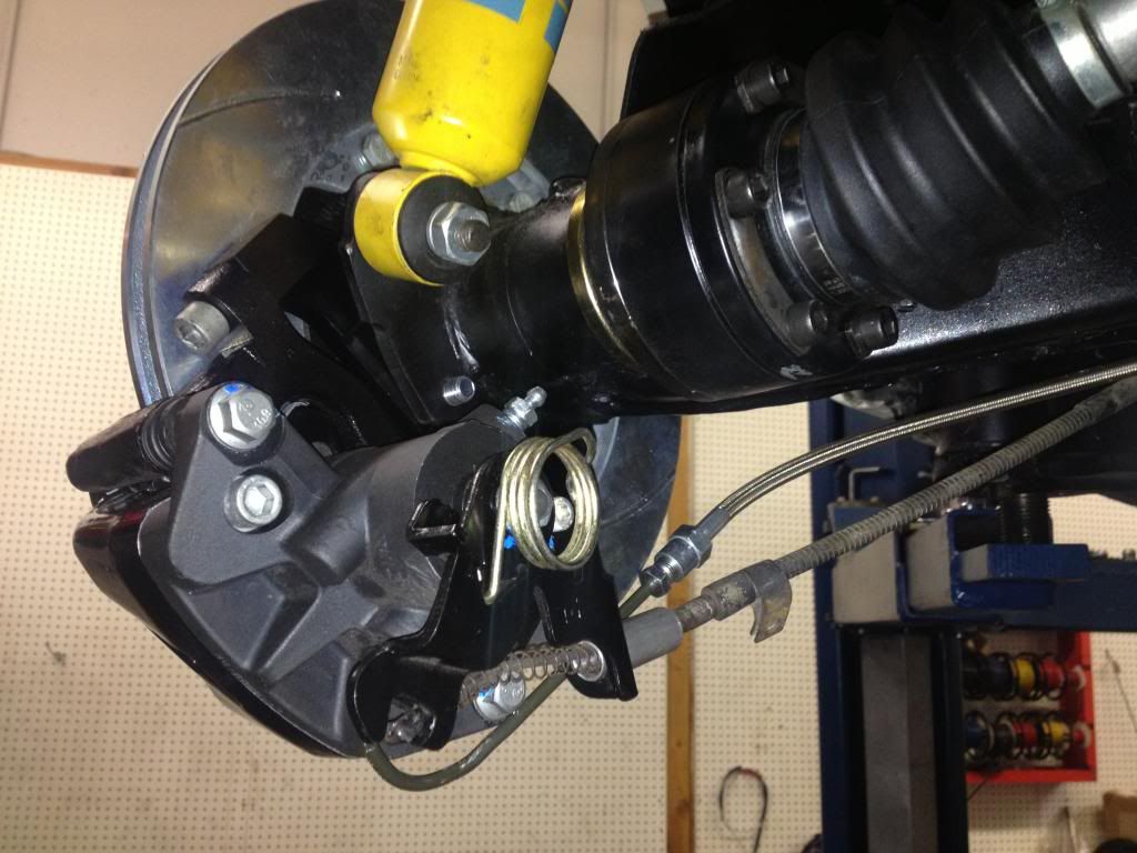

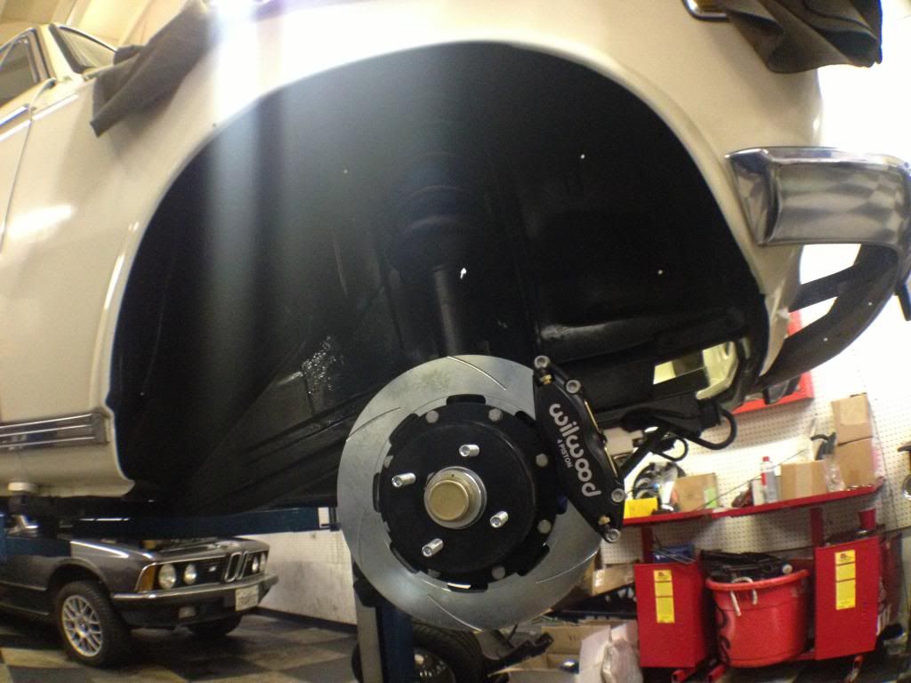

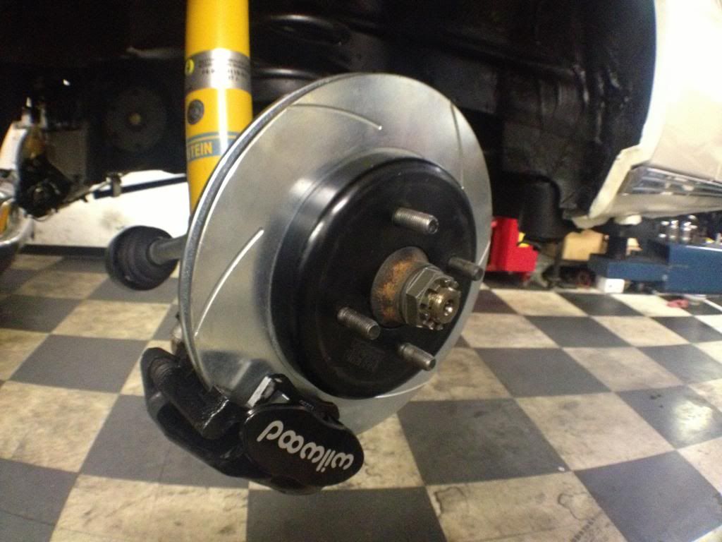

    Brakes are all bolted on

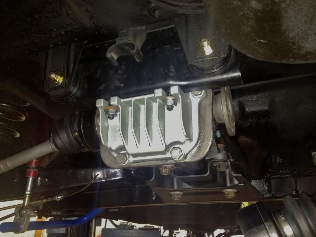

    Cleaned up and painted the diff, rebuilt the drive axles

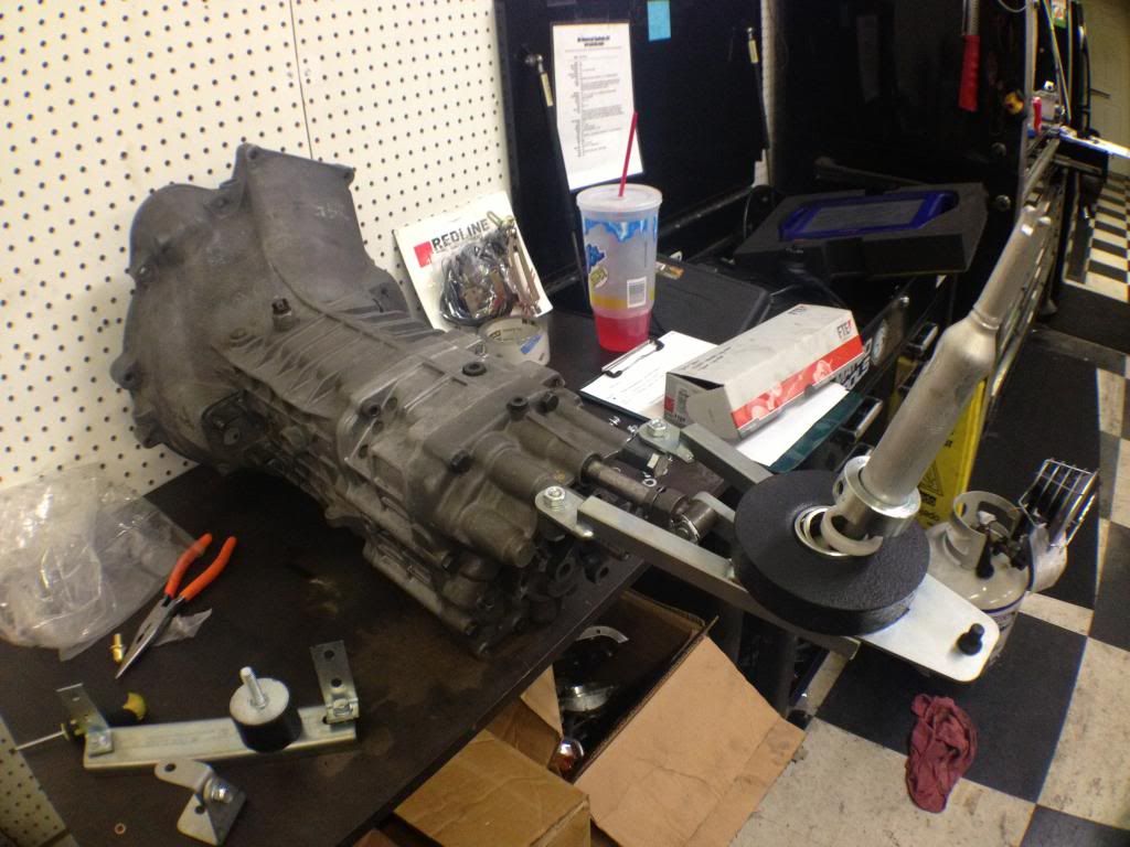

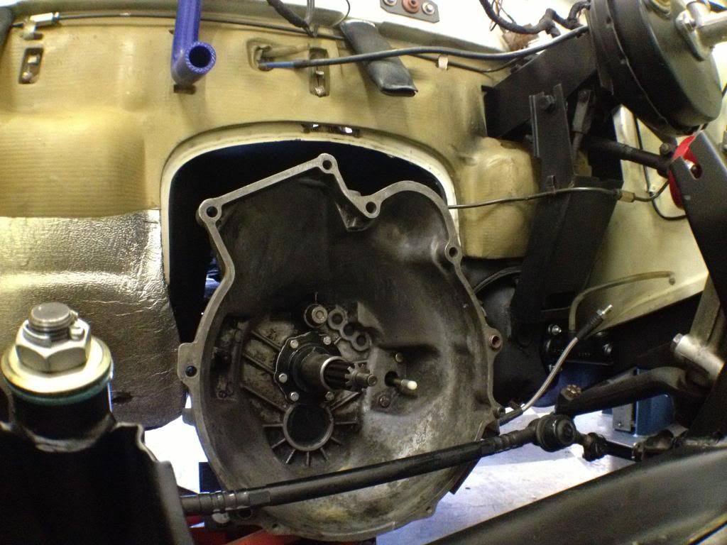

    5 Speed Conversion!

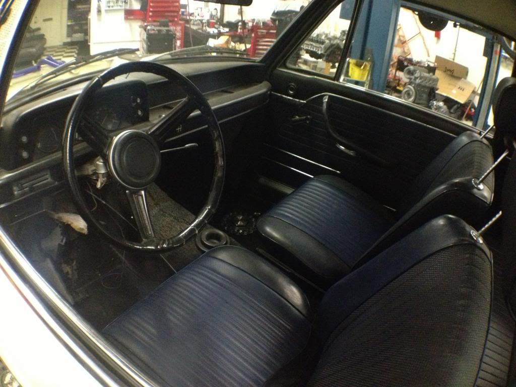

    We are going to leave the interior unmolested for the most part. just a few gauges and some other tidbits

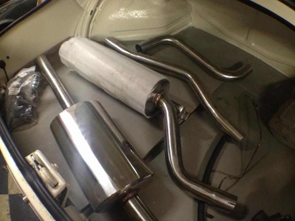

    Stainless steel exhaust anxiously waiting to be bolted on!

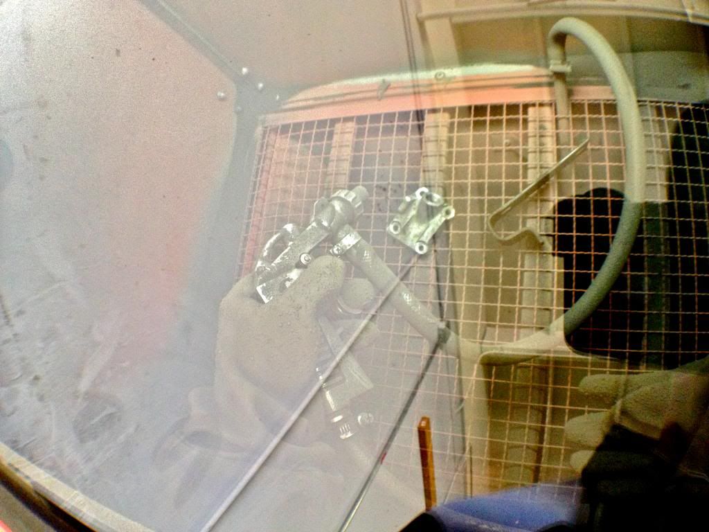

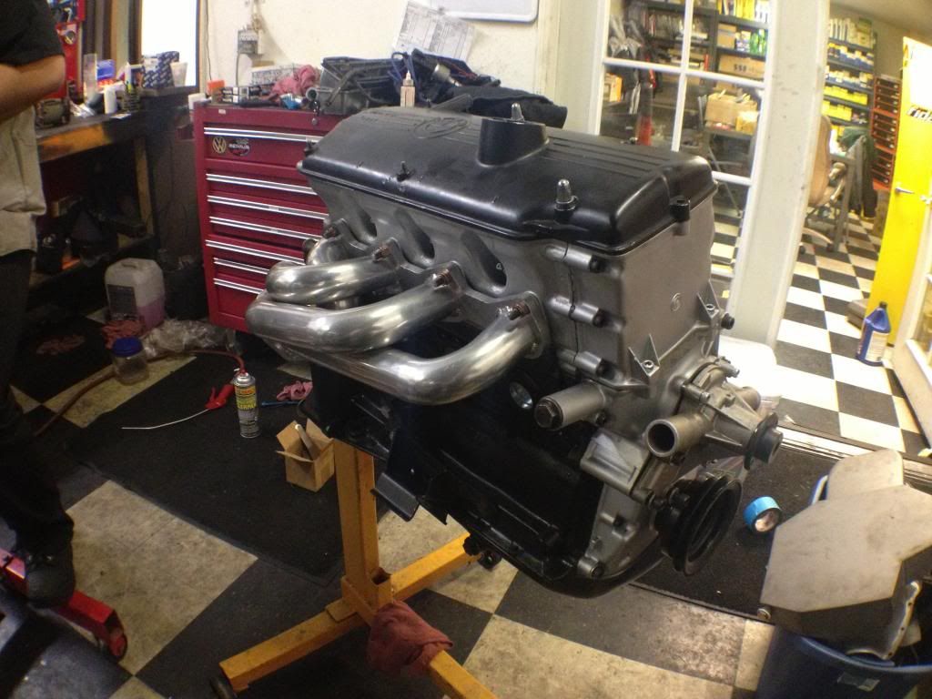

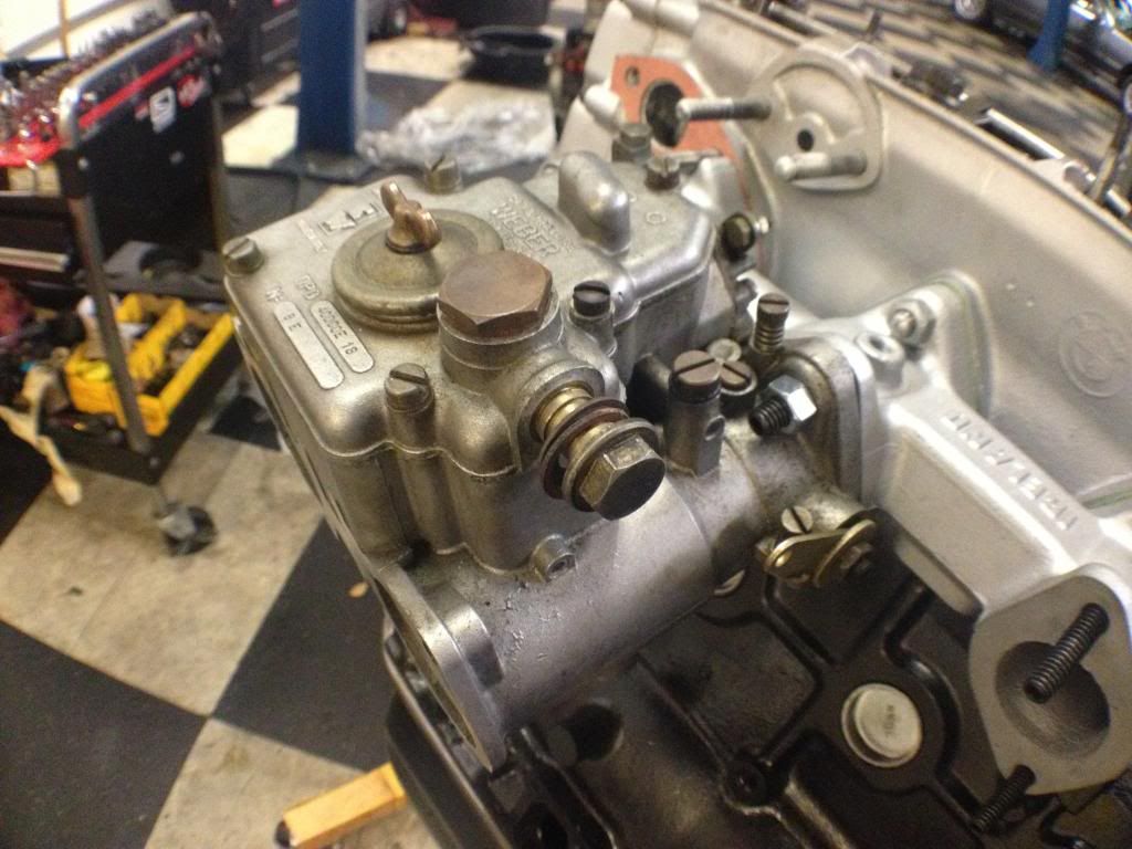

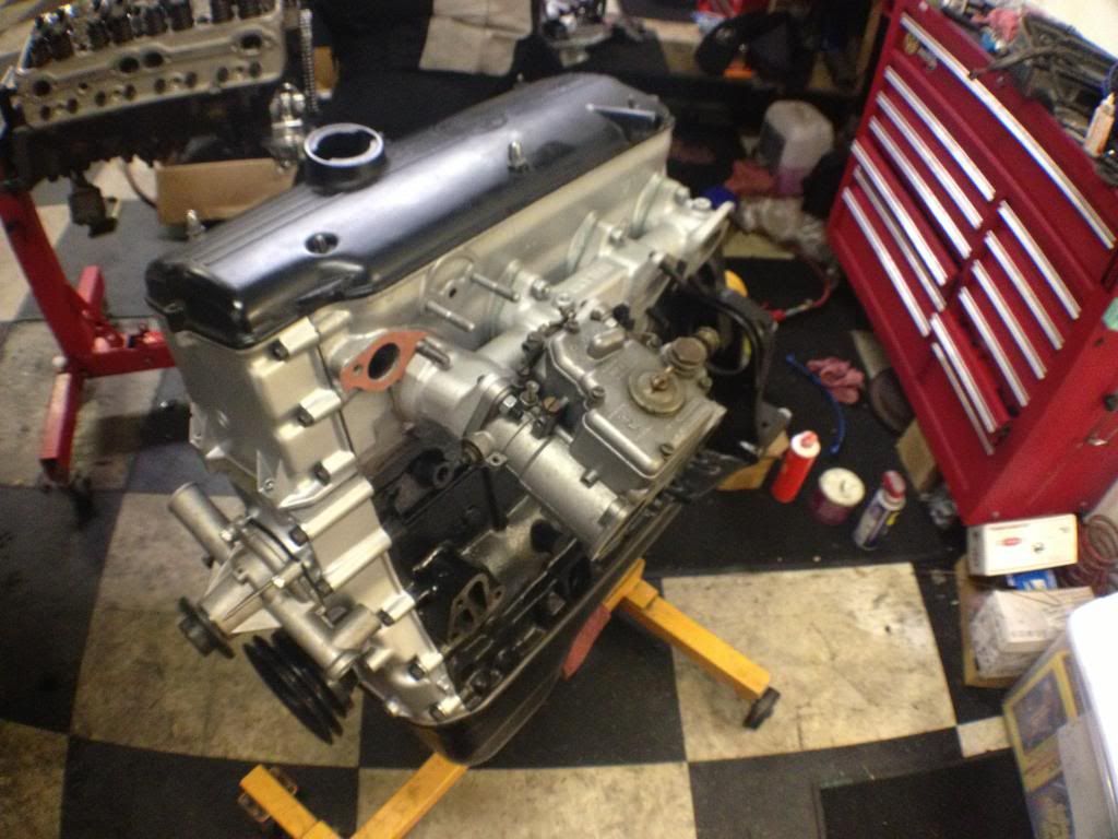

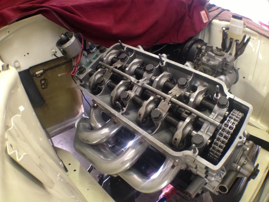

                        Today I sandblasted some more parts for the engine, everything should be done. I plan on fitting the engine in this weekend.
                        We also test fit the 5 speed transmission
                        Andddd I had to re-flare some of the brake lines, but I think we are finally leak free!

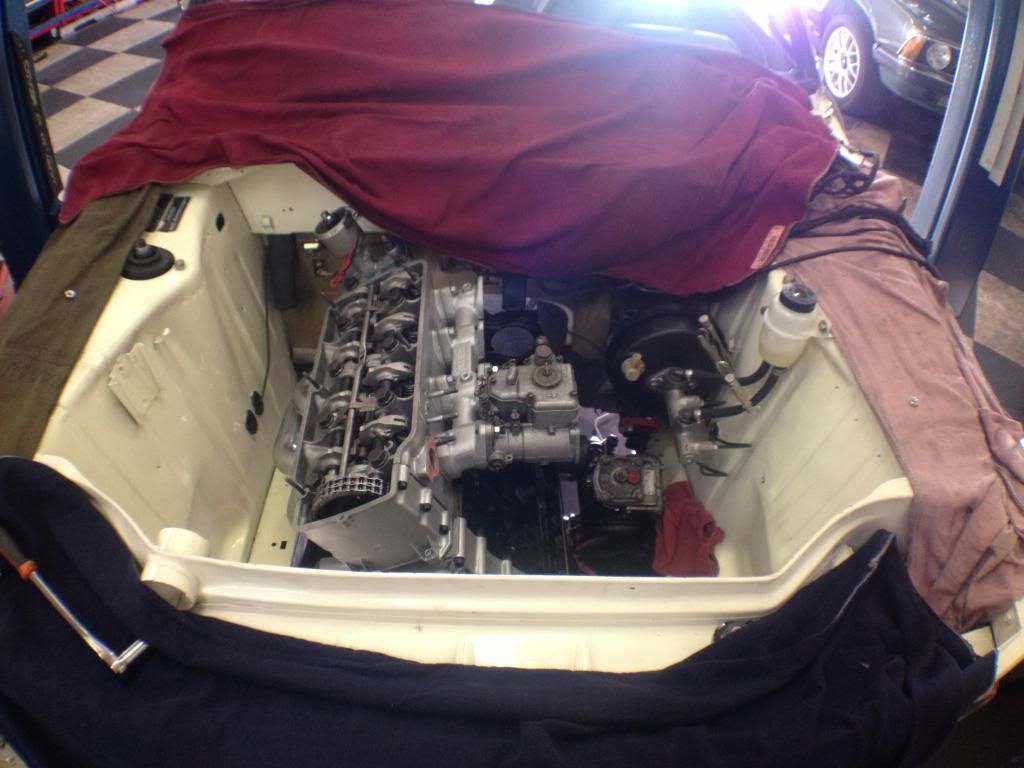

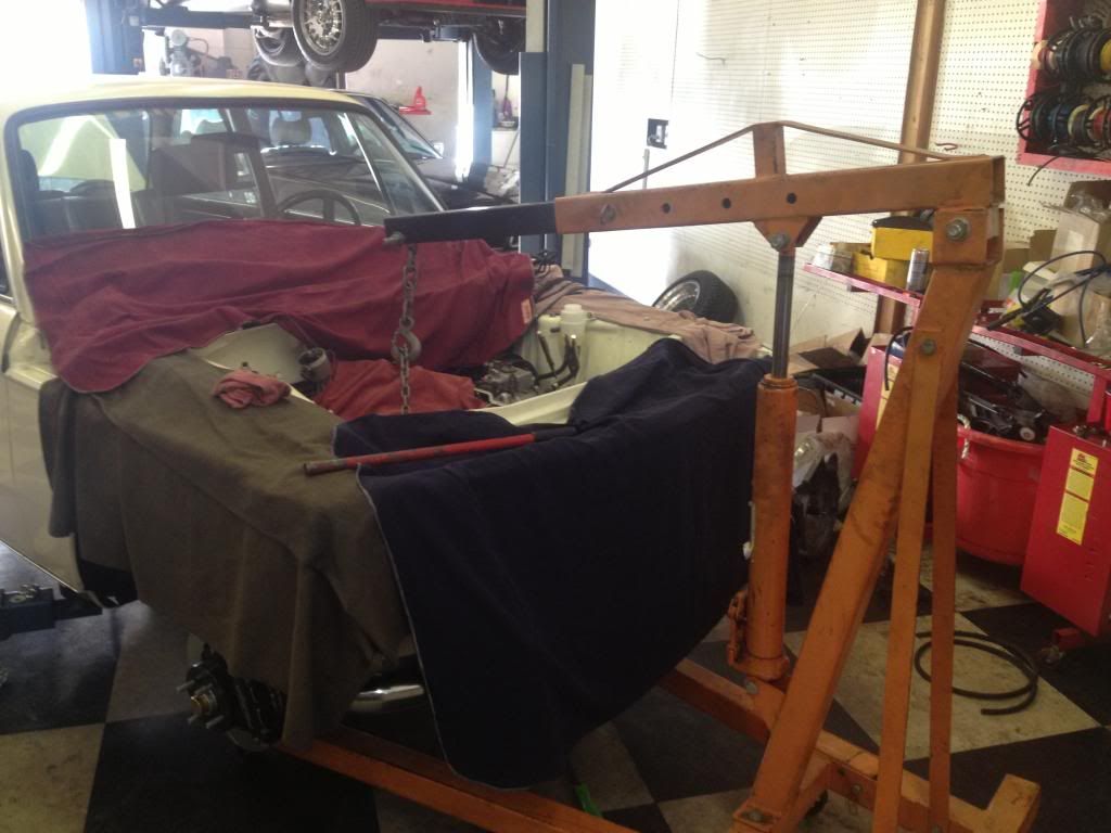

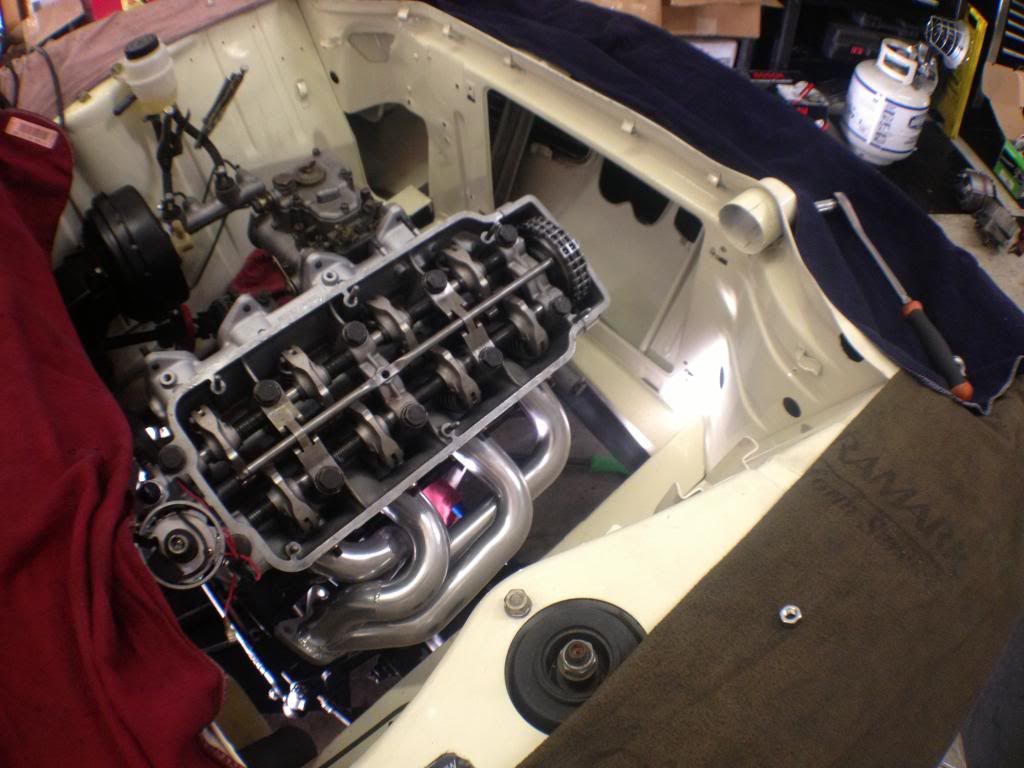

                          Alright, well I got the motor in last night, it's all bolted down pretty much, I havent seen the engine inside this car for a year now so it's pretty sweet to see it back in! ha
                          I'm still looking for some misc. bolt-ons for the block like the updated alternator bracket, since we are using one off of an e30 318i.

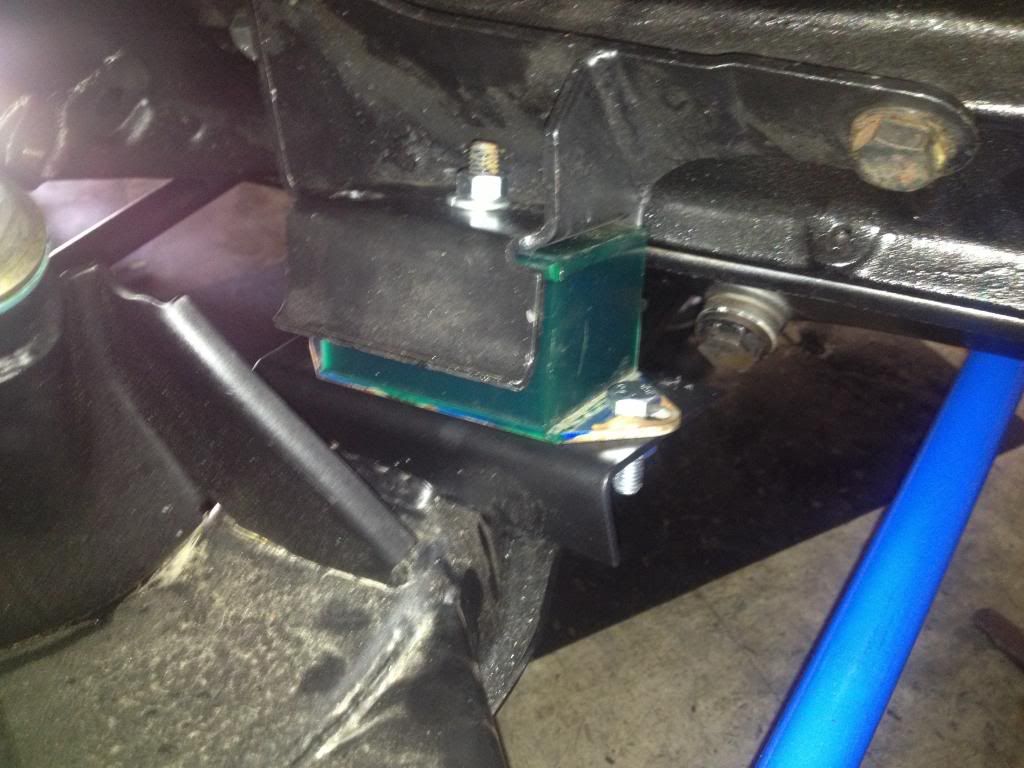

                          Next we'll be able to bolt in the trans real quick to get some measurements on where the new transmission mounts need to be bolted on.
                          I still need to slide in that little stopper bracket under the motor mount. I just need to find it in our huge box o' parts
