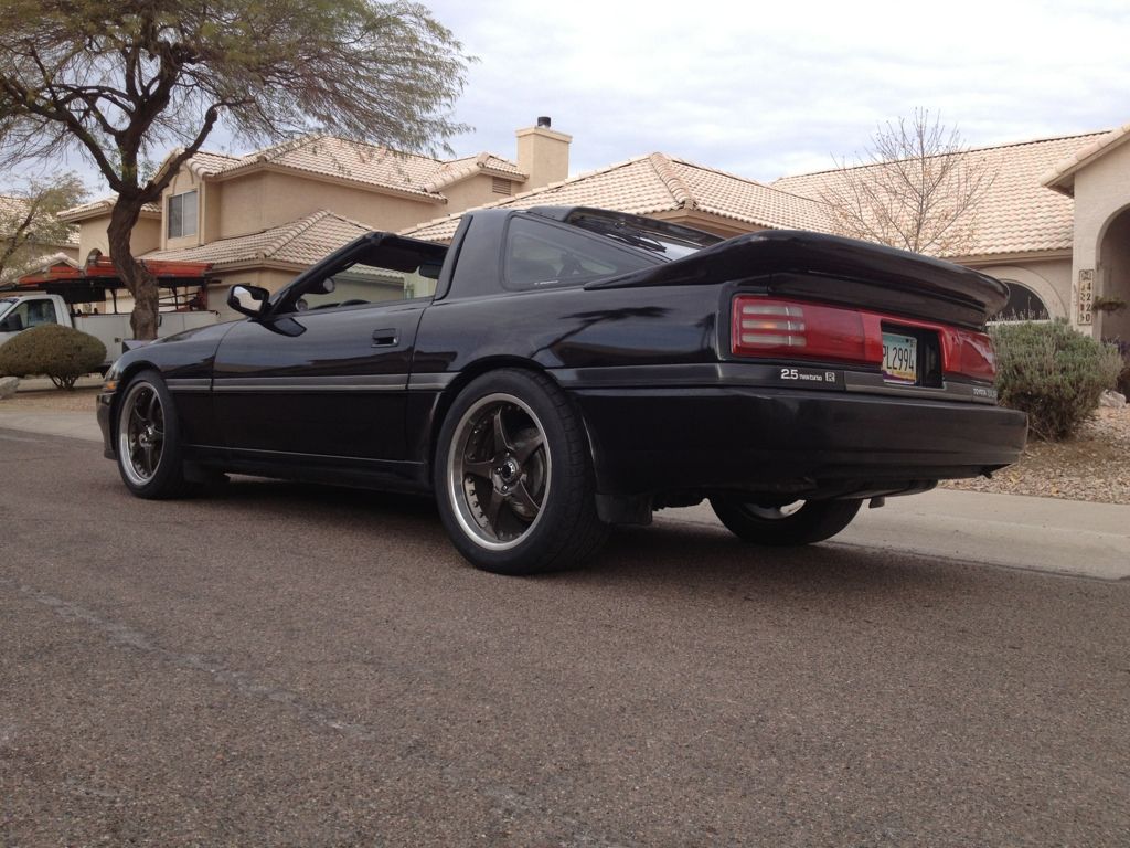

    Love these supras, and love these supras with that wing on them, 1jz makes it even cooler.
    Fuck Rotas, I'd rather my wheels not break apart when I drive over a watermelon seed.
      God I love TTR seats, wish I could pick some up for my JZX73.
      nice mk3!
      '88 TOYOTA CRESSIDA 1JZ-GTE "Desiree"

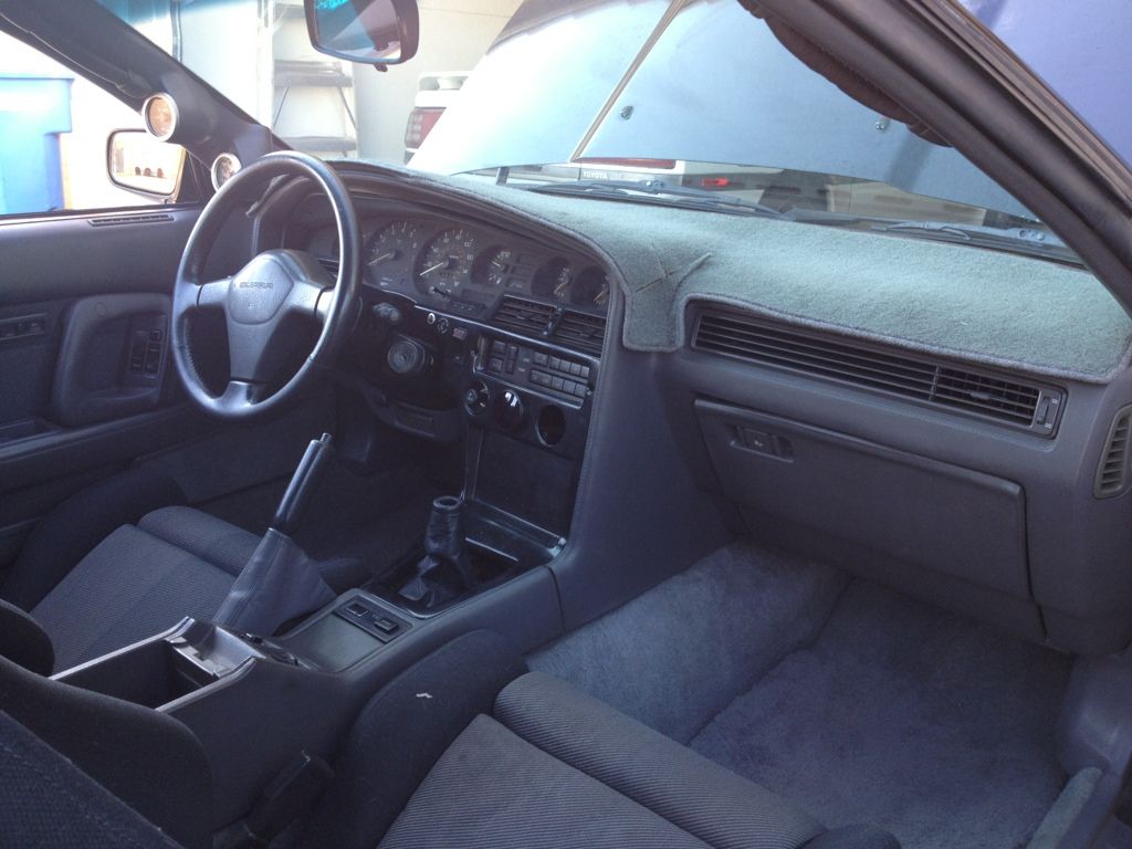

        Nice! I really should get to work on mine, but its a bit too cold. Where did you get the rear sunshade?
          i like the super high tech invisible shift knob.
            Sunshade came from KevinM on Supraforums.
            The shift knob is missing because the motor and trans are not in the car...in any of the photos

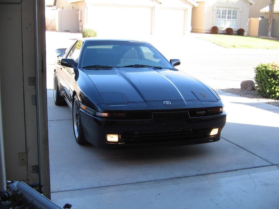

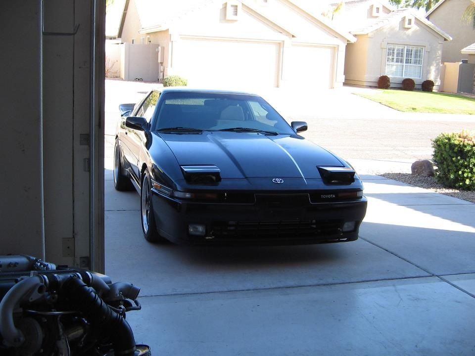

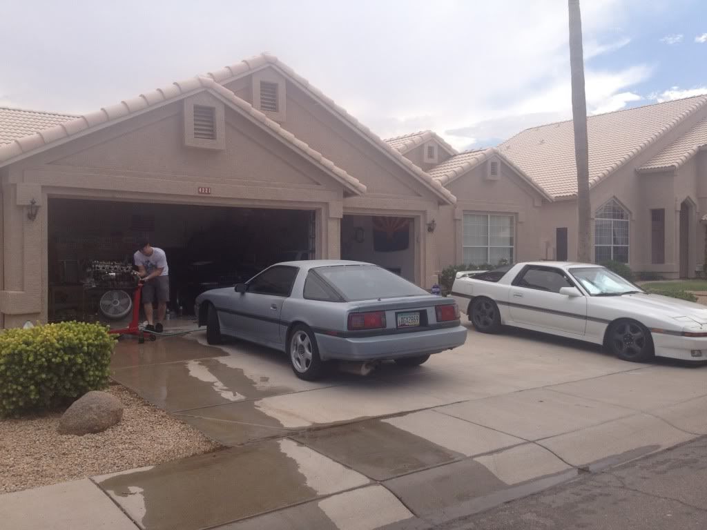

              damn bro! looks really good, are you located in vegas/henderson? that neighborhood looks really familiar...not a stock i swear
              Instagram: @half_lung
                Such a clean example! It's begging for some low and wide
                Instagram: @Eurow
                  I realize that.
                  Apparently humor did not translate.
                  Nice car.

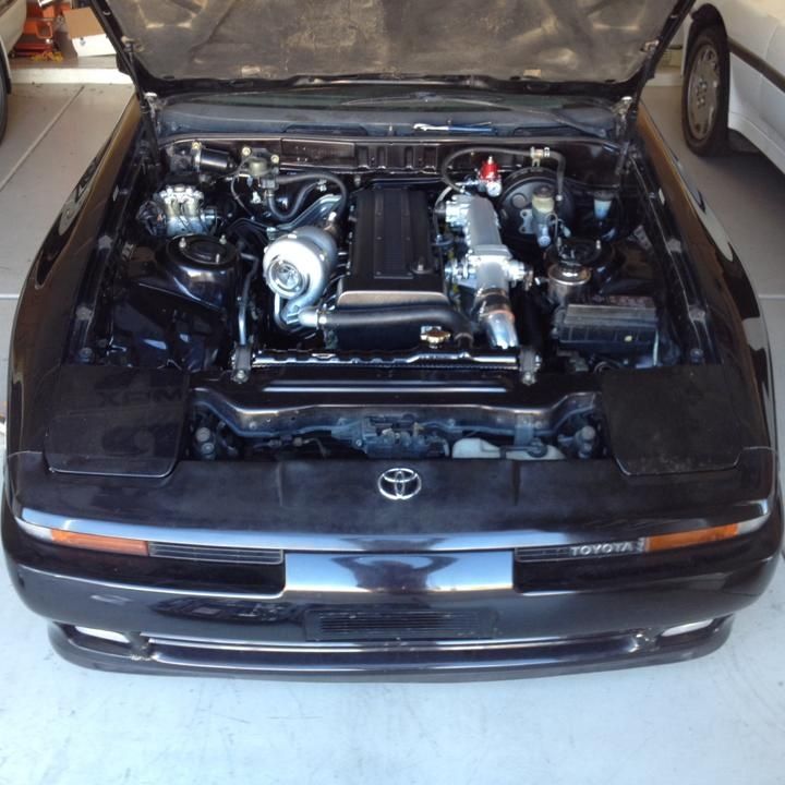

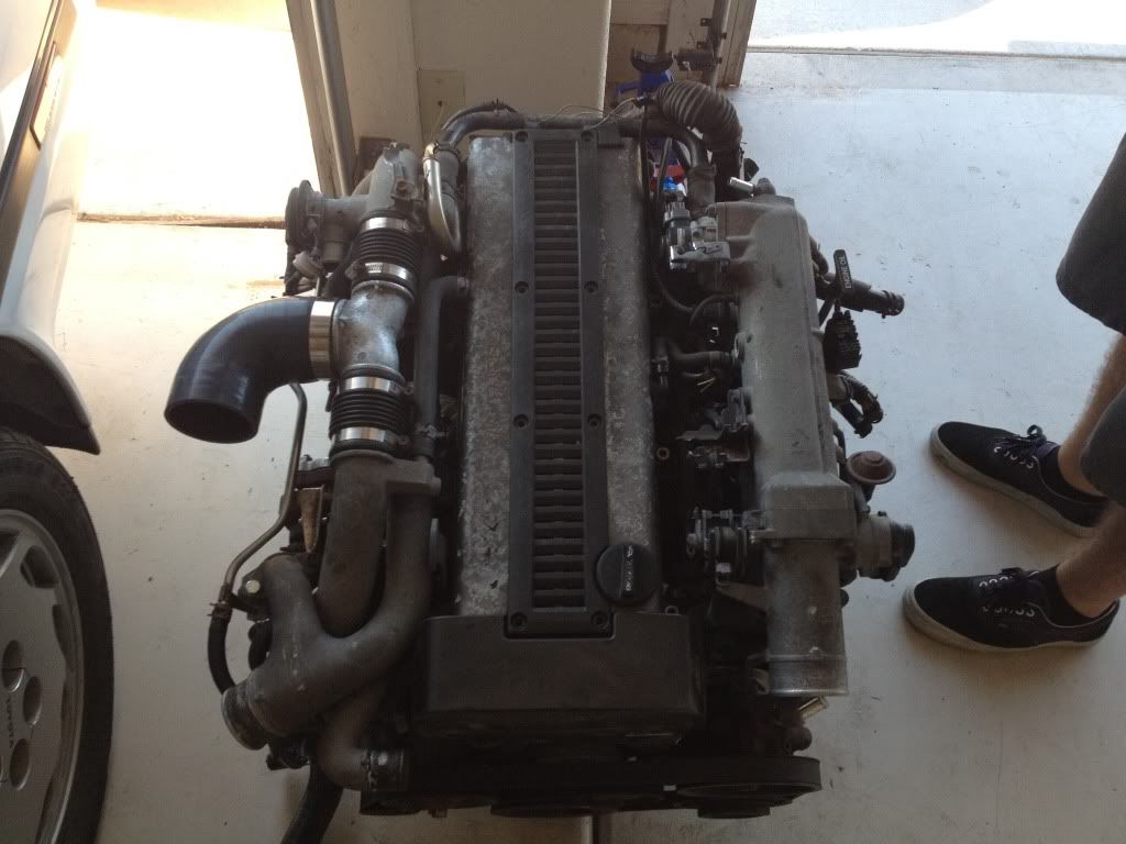

                    Holy hell it's been a long time since I've posted on here! Got a few things done since I've last posted lol

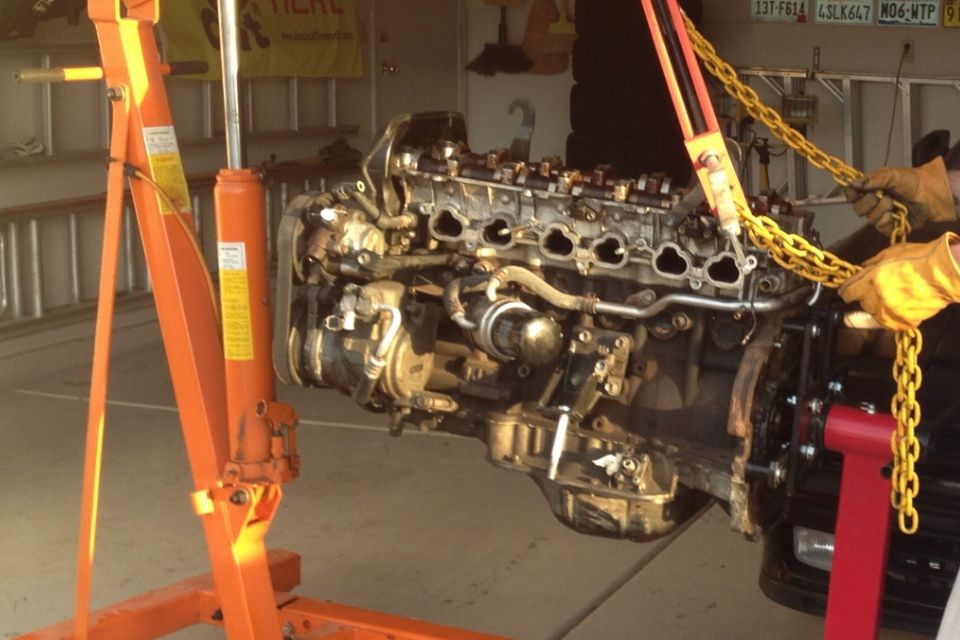

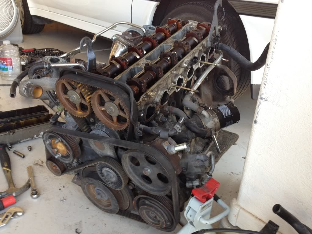

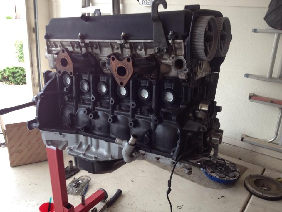

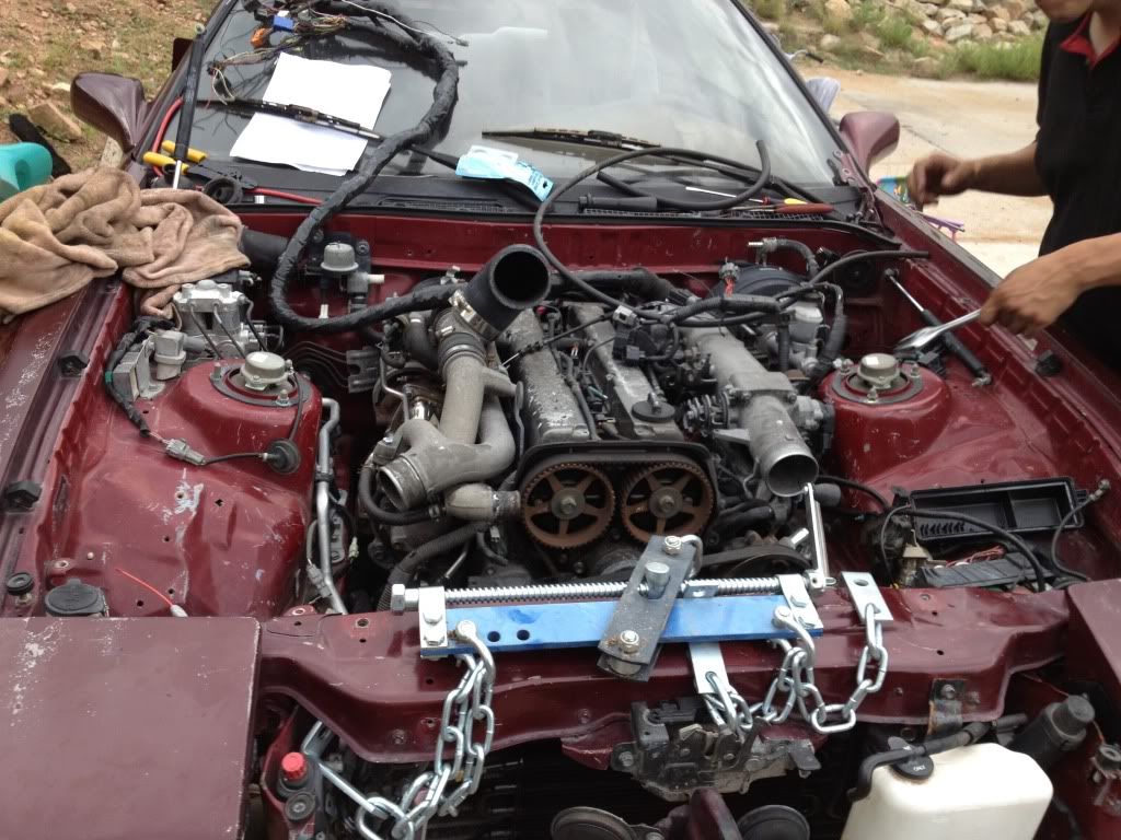

                    Here is when I got the motor from an owner who attempted to a 1jz swap
                    Tear down! Notice the nastiness :barf:

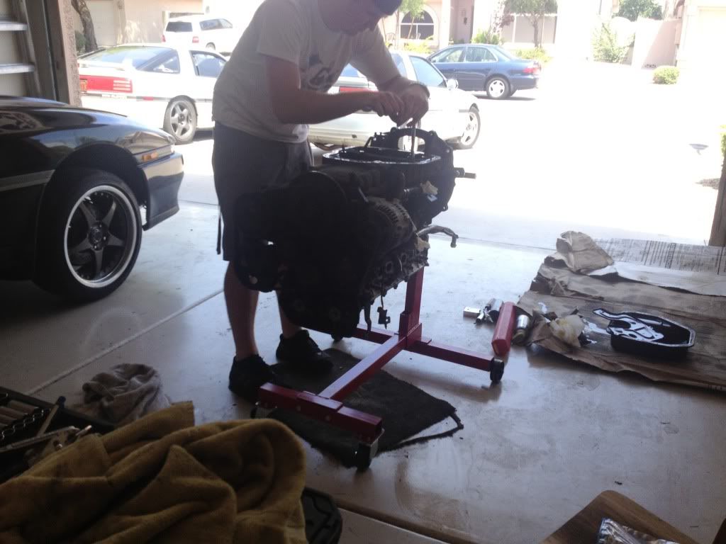

                    Got the motor on the stand
                    A friend came over and we tore it down to inspect the bearings and paint the block. The rod bearings looked amazing! Super happy about that

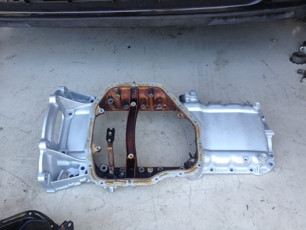

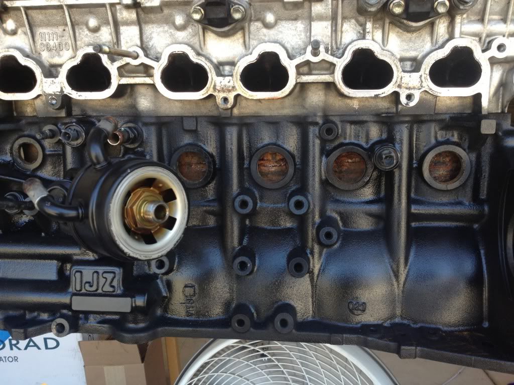

                    During the cleaning of the block we discovered a little problem :unsure:/>
                    Paint!
                    Popped out the freeze plugs and replaced them

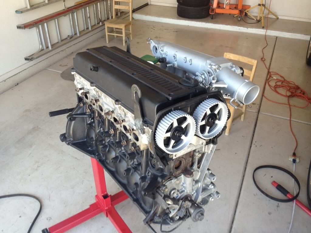

                    I decided to paint a few other things and mock it up. Looks so tits
                    Cleaned up the upper pan.... took fooorrrrrevvvverrrrrr.

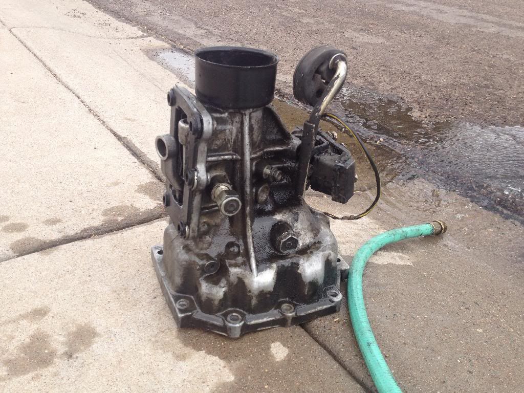

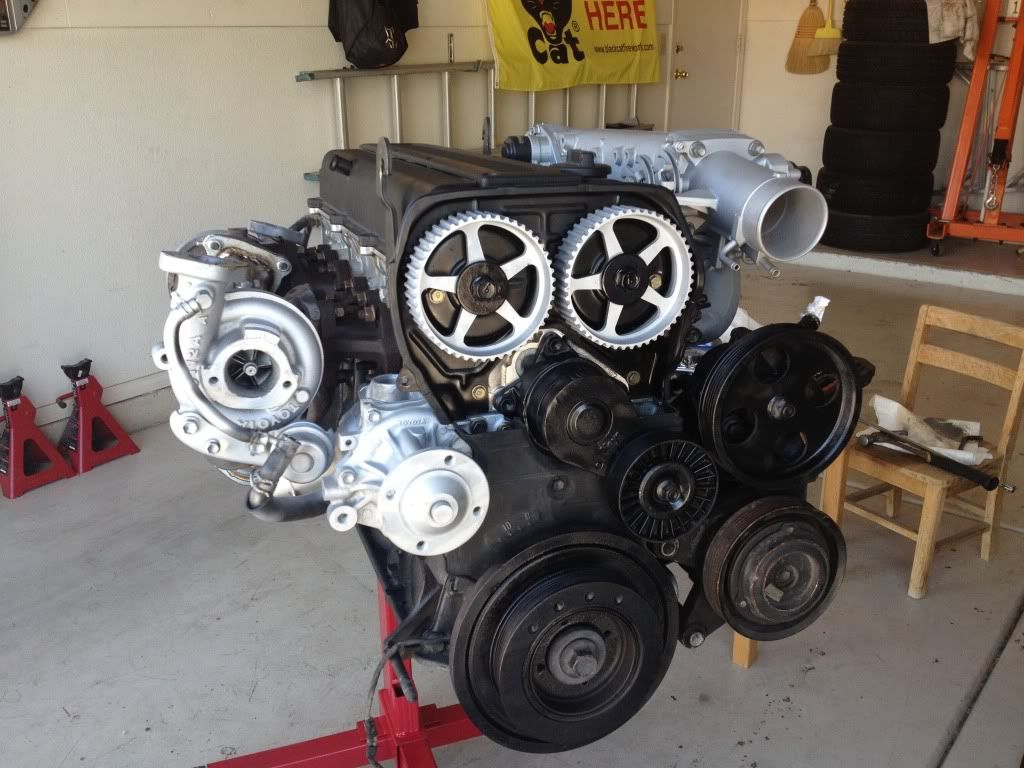

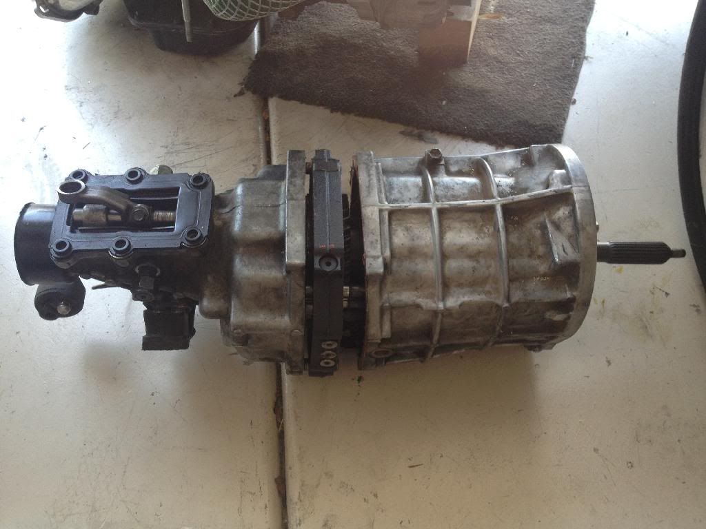

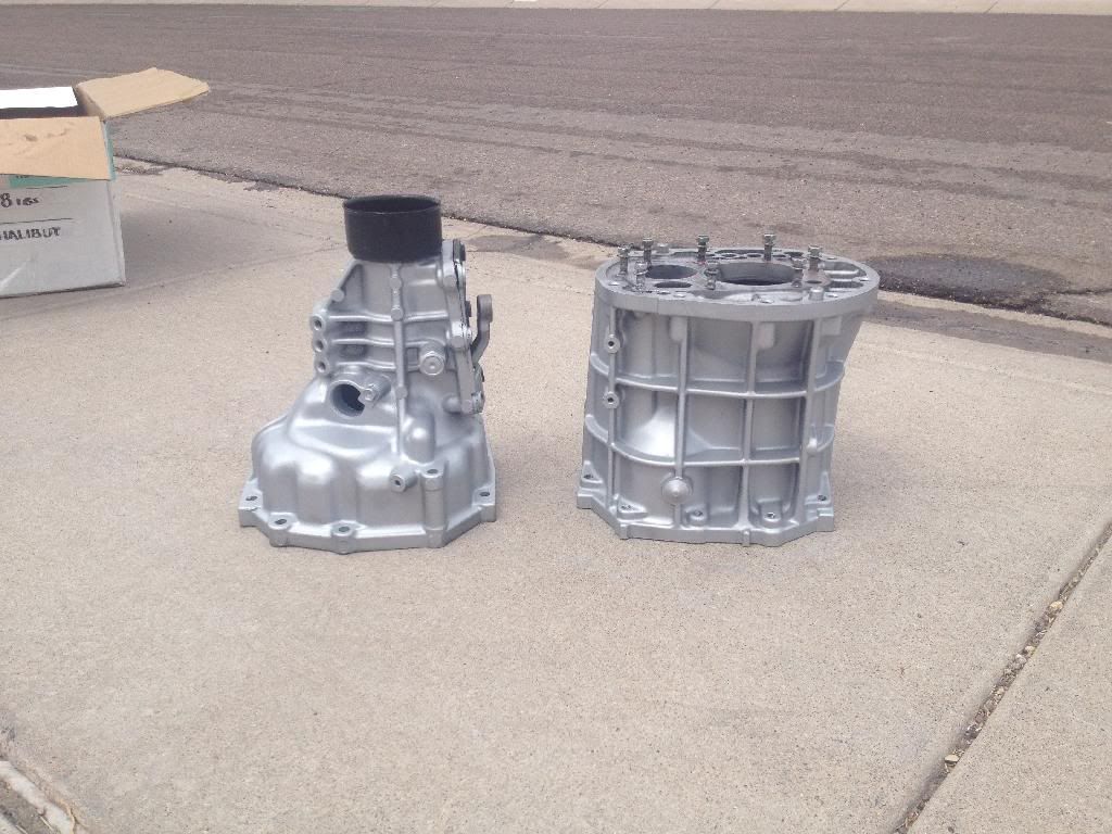

                      Picked up an R154, took the casings off inspected the trans then cleaned/ painted them.

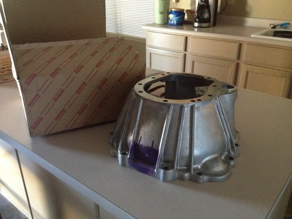

                      Bell housing came in so I painted it and slapped it on

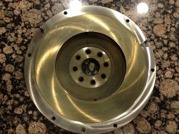

                      Found a flywheel on Craigslist for a decent price, got ARP flywheel bolts put it on and mounted the trans

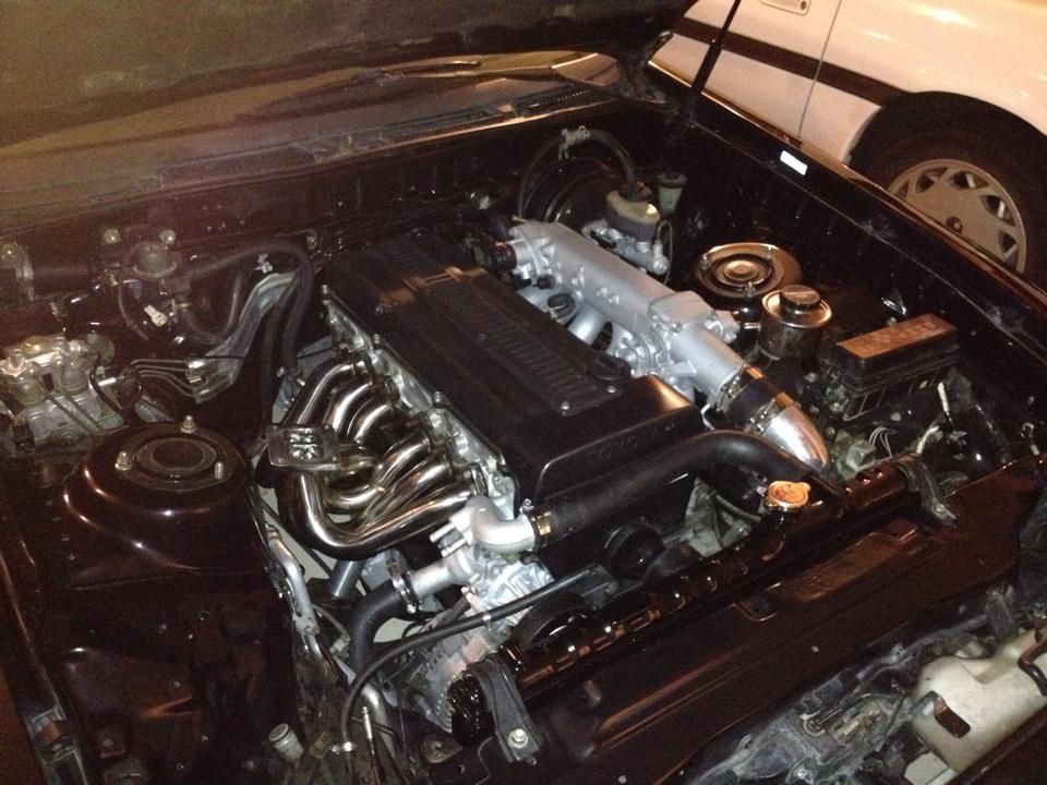

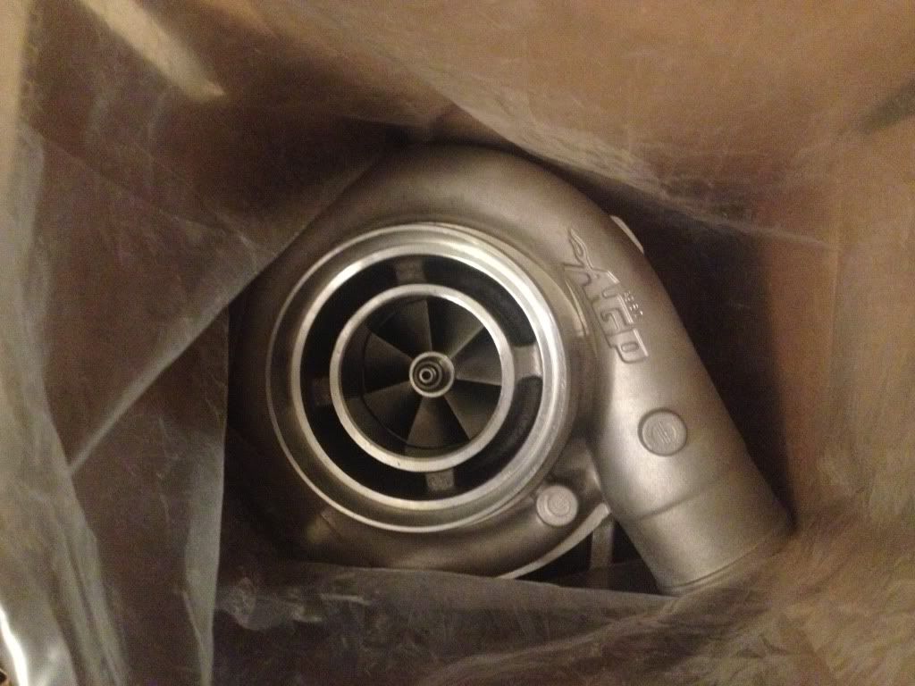

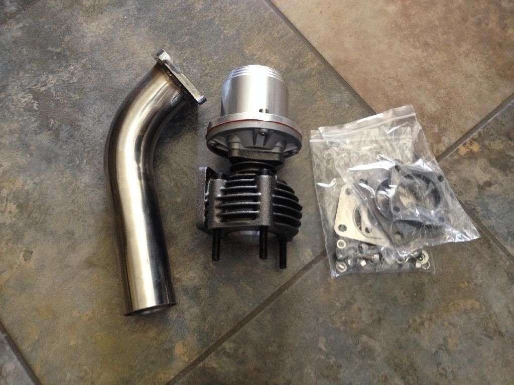

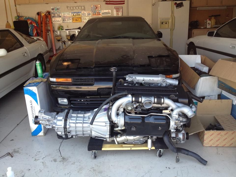

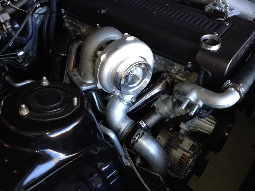

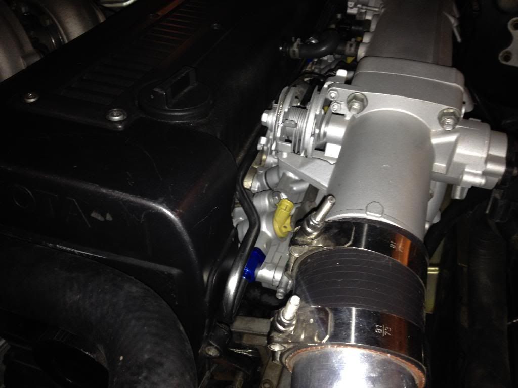

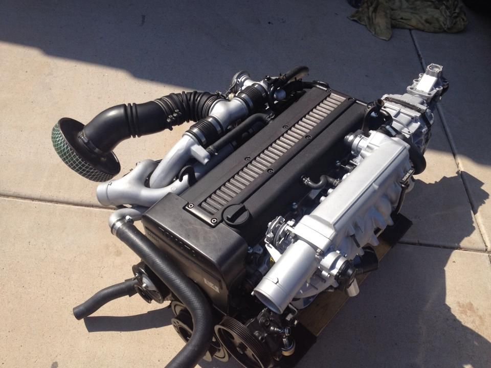

                        After all the work making the twins look good, I finally got talking into going single. After trading a few parts I got this
                        Borg Warner s256, AGP 4960 Anti-surge housing 4" inlet 2" outlet, Master Power .68 A/R Exhaust housing. :wackit:

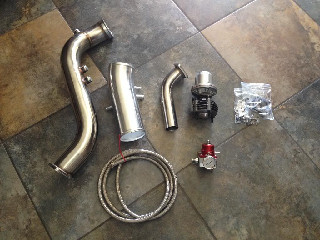

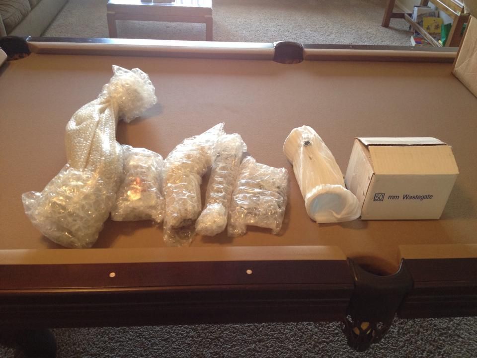

                        Ordered a few goodies from DM.

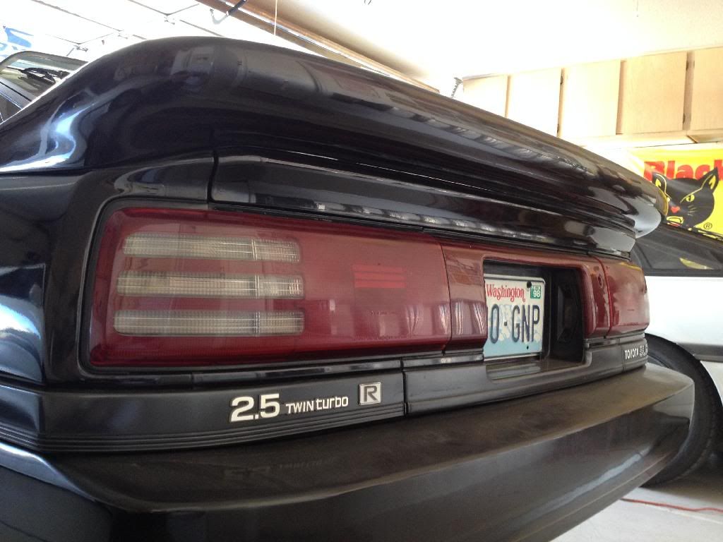

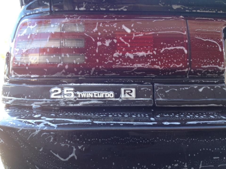

                          A year of bugging the hell out of my friend about his JDM tail lights finally paid off. Looks so much better with the TT-R trim than the American ones.
                          Next to my DD 87 .20 JE pistons, hks HG, arp studs, 57trim etc..

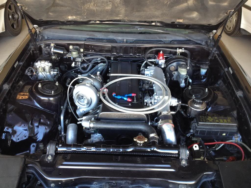

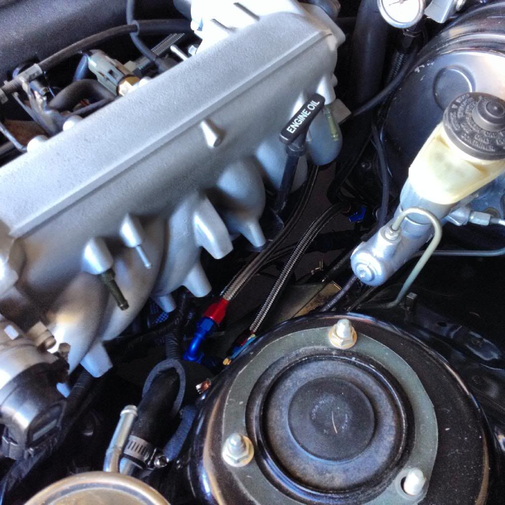

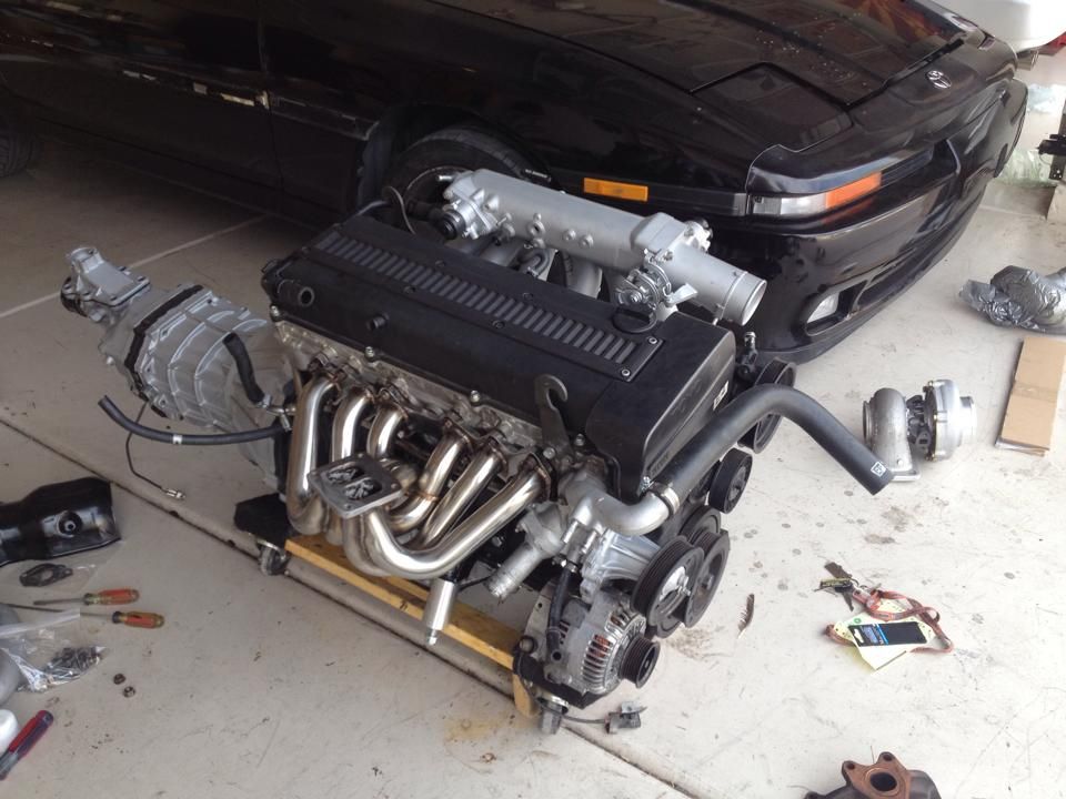

                            Picked up an uncut JZA70 harness, ECU, map sensor and intake temp.
                            Harness ran
                            Ran fuel lines for the dual walbros to a stock rail

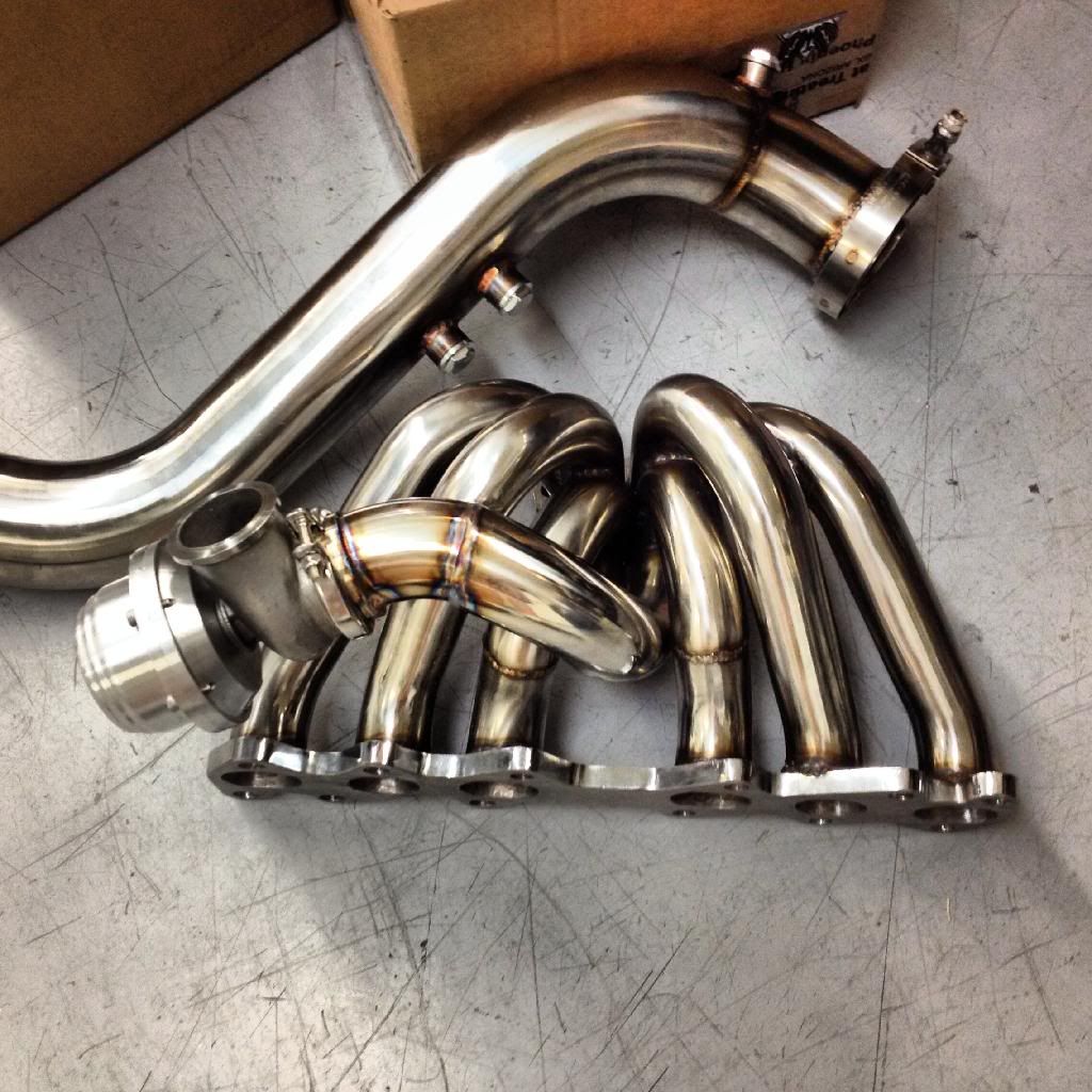

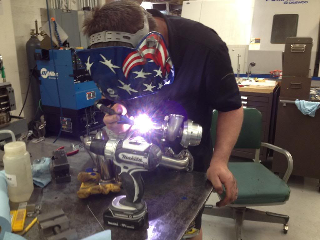

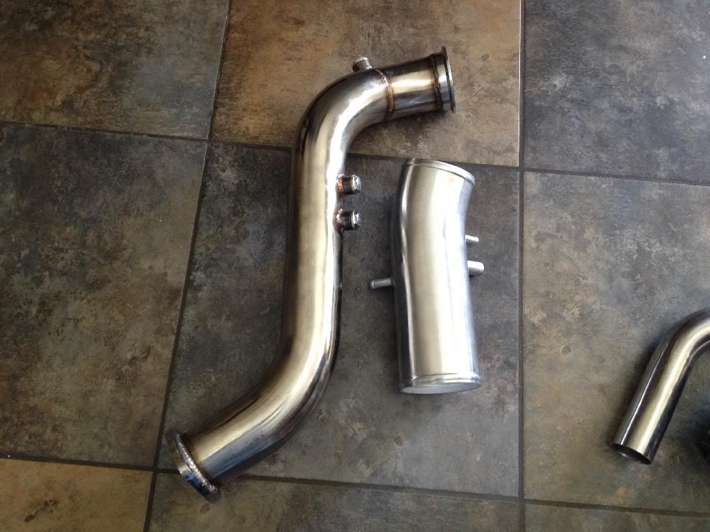

                            Modified the chinafold for the wastegate to fit and welded a 90 on the turbo

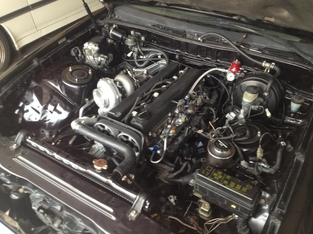

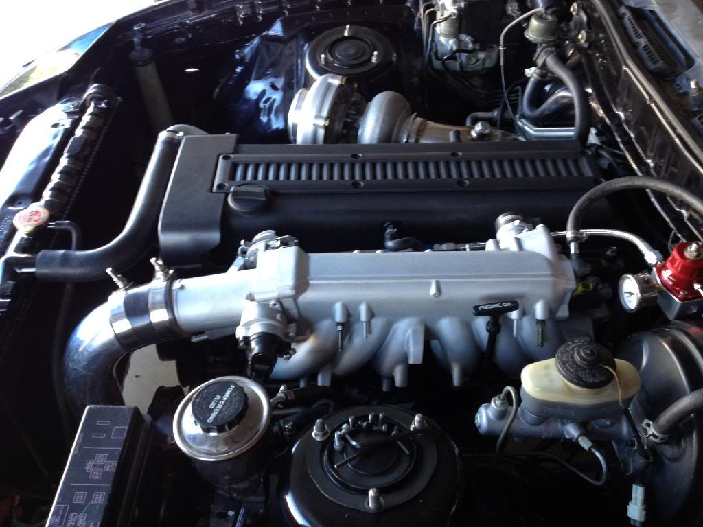

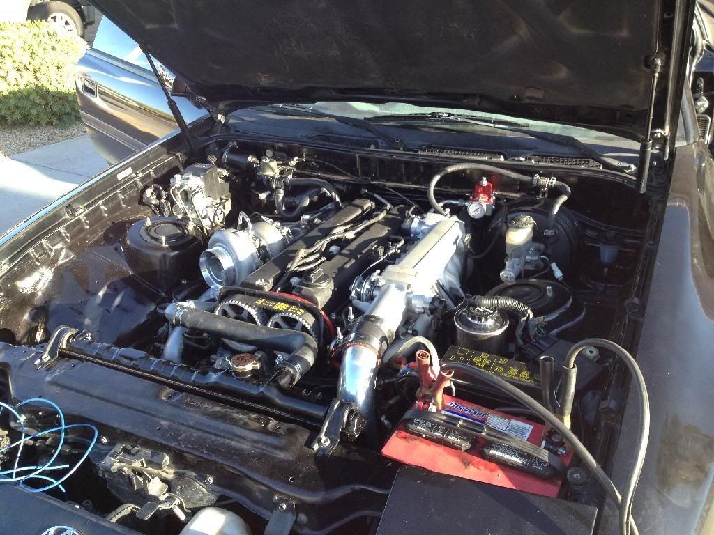

                              First start!!!!
                              As you can hear the motor isn't firing on all cylinders. The previous owner of the harness was running a 2jz ECU and had the injectors set up for sequential. He said he changed it back to batch for a stock 1j ECU. I couldn't figure out the issue so I pulled car out to run some tests on the wiring for the injectors
                              Spent at least an hour trying to figure it out when I noticed the check engine light was on and thought I would check codes. When I popped Open the diagnostic box there was a jumper from FP to +B... Took that out and the car ran fine
                              Second Start!!
