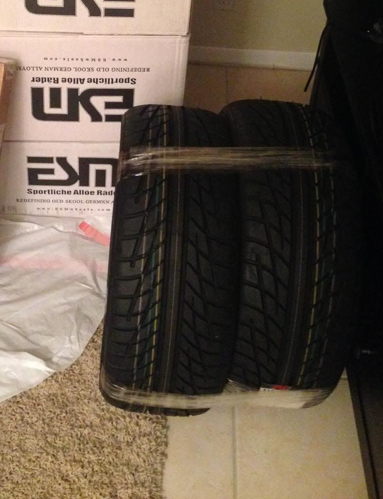

                  • Finally got some time to up-date this build thread.
                    So here we go...

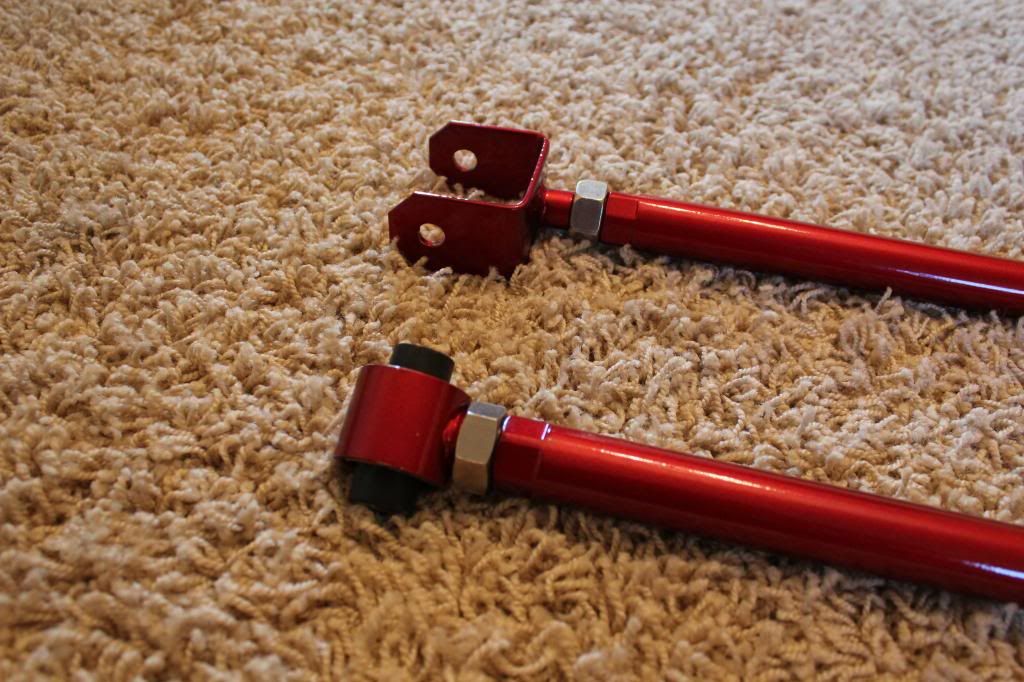

                    rear camber arms

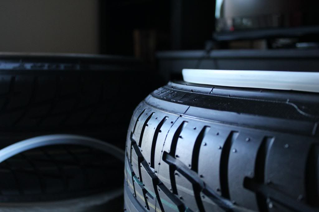

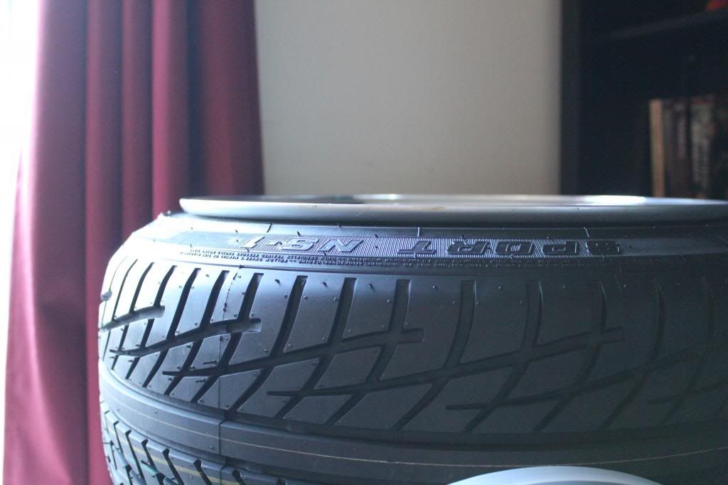

                    rear tires
                    Nankang NS-1
                    Specs: 215/40/17

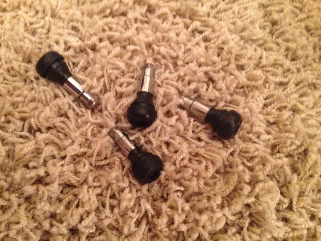

                    hidden valve stems

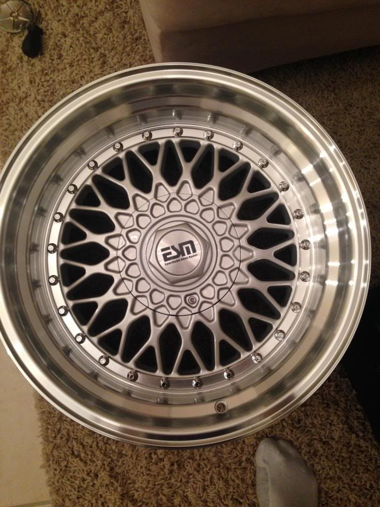

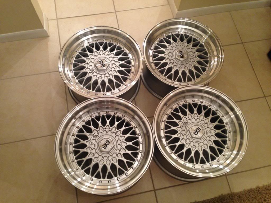

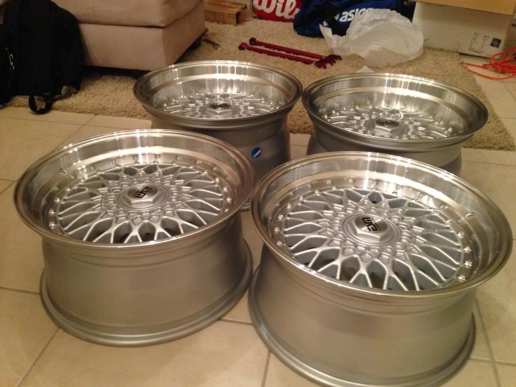

                    and wheels
                    ESM 002.
                    Specs: Front 8.5 et20
                    Rear 10 et15

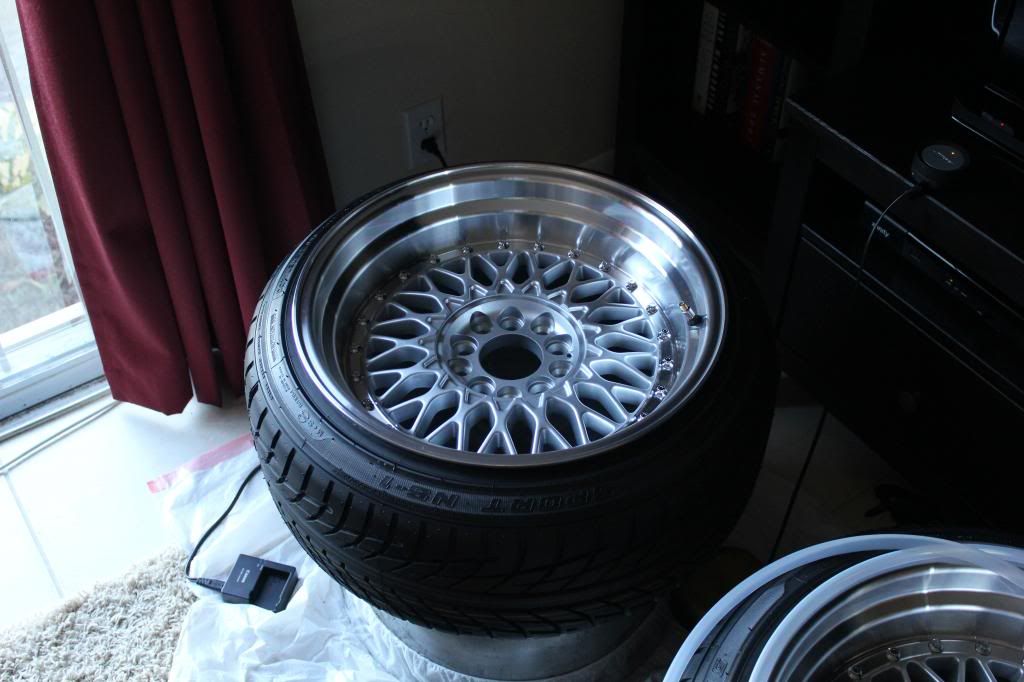

                    Onto the installation.

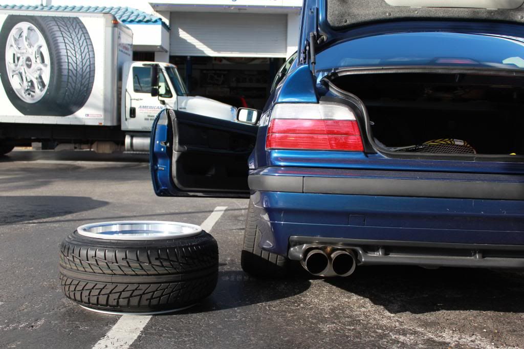

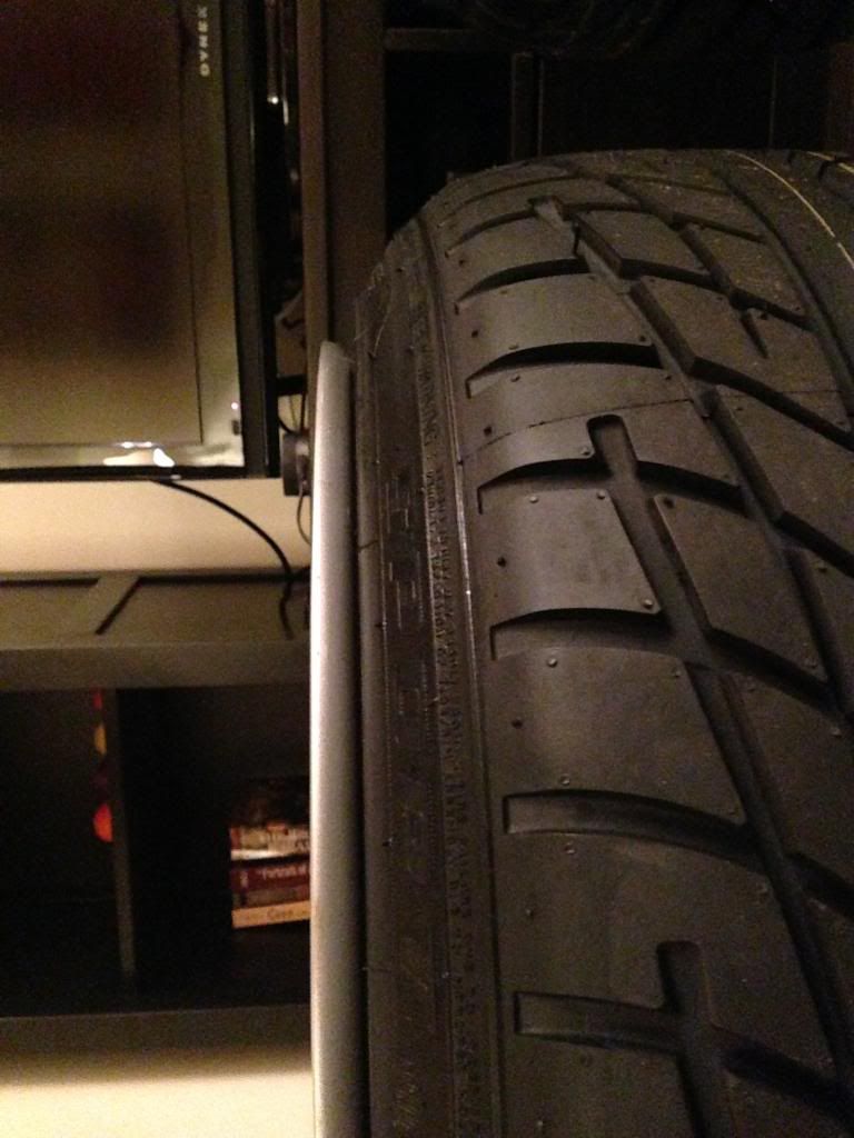

                    Started by mounting rear tires. Wasn't able to put them on the car for a few days due to the wheel's offset so had them laying in my living room and this made my gf pretty upset
                    This is how the stretch looks. 215 40 on 17".

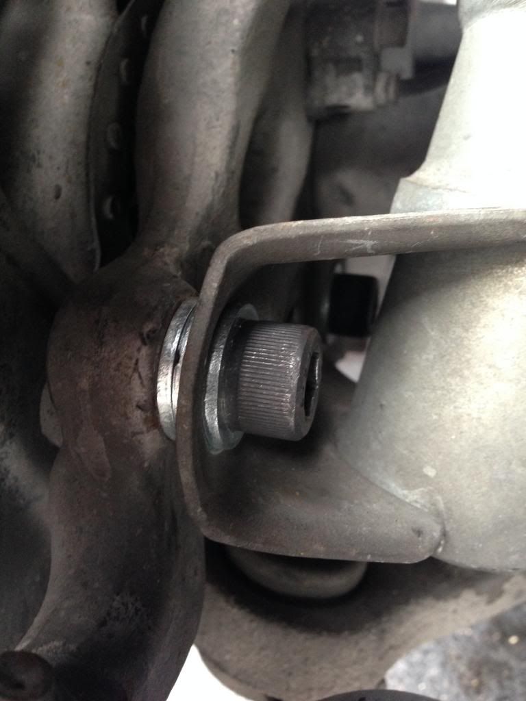

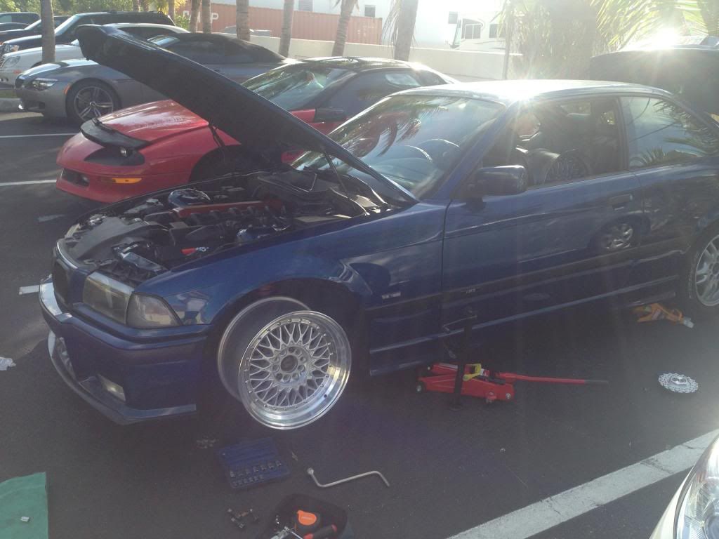

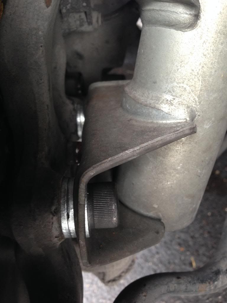

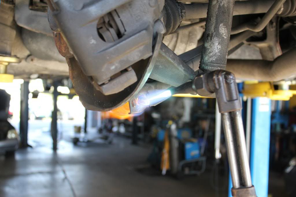

                    After test-fitting the front wheels I decided that more camber was needed.
                    I went ahead and shimmed the girl out,.
                    Its a very cheap, ghetto fix but it does the job very good.
                    Went ahead and installed 205/40/17 tires on the front wheels and put them on the car.

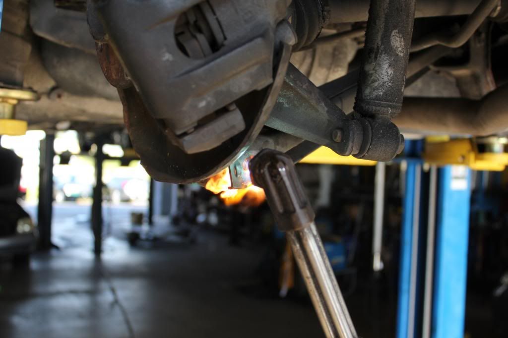

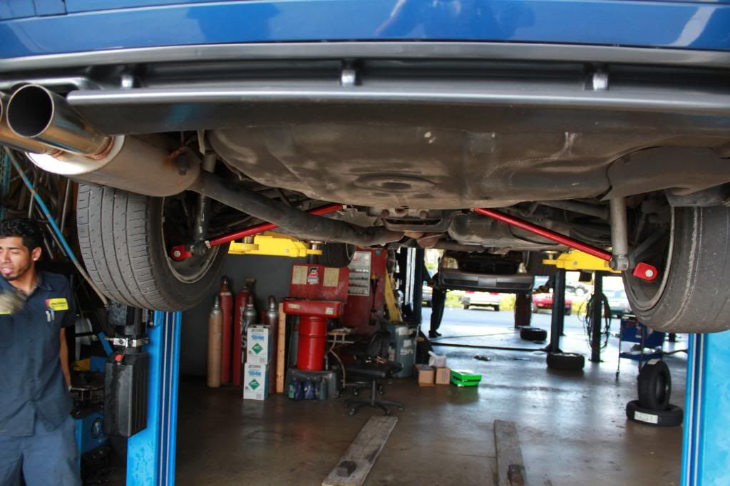

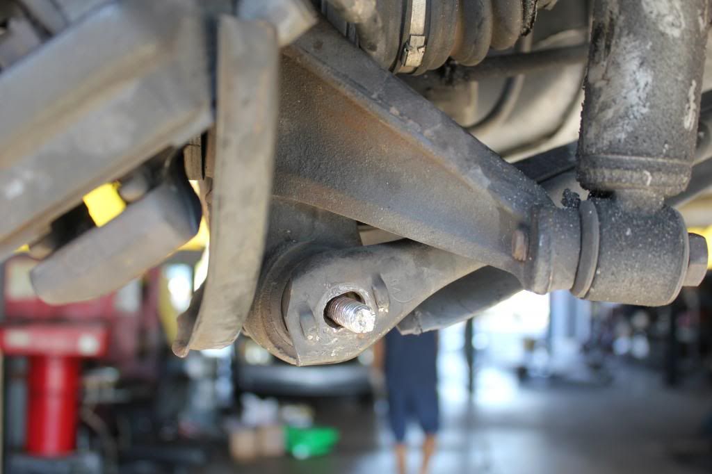

                    Next on the list were the camber arms.
                    Took some pics with the camber before alignment just for the sake of it...
                    It was around -8 degrees camber, and the arms were not stretched at their max...

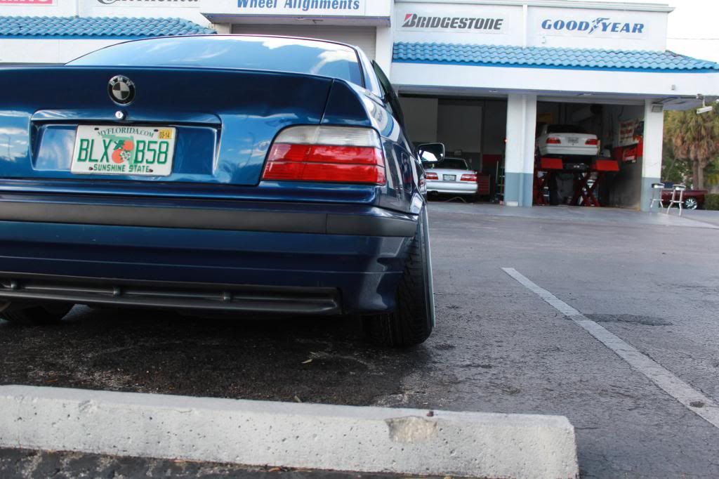

                    Anyways, placed it on the bed and took a proper alignment.
                    No pictures on the ramp but I set the rear camber to -5.5 degrees.
                    In the front the camber is -3.8 degrees.
                    The rear lip is resting on the fender and the front needs spacers and more low.

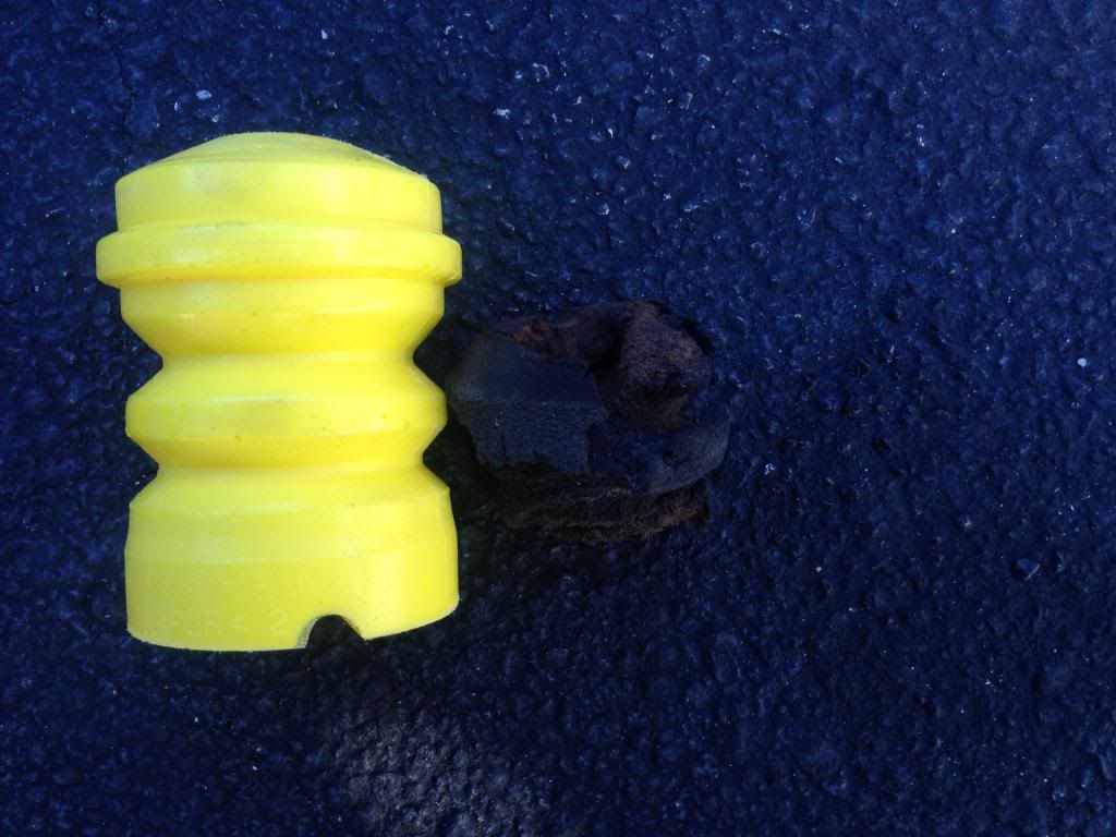

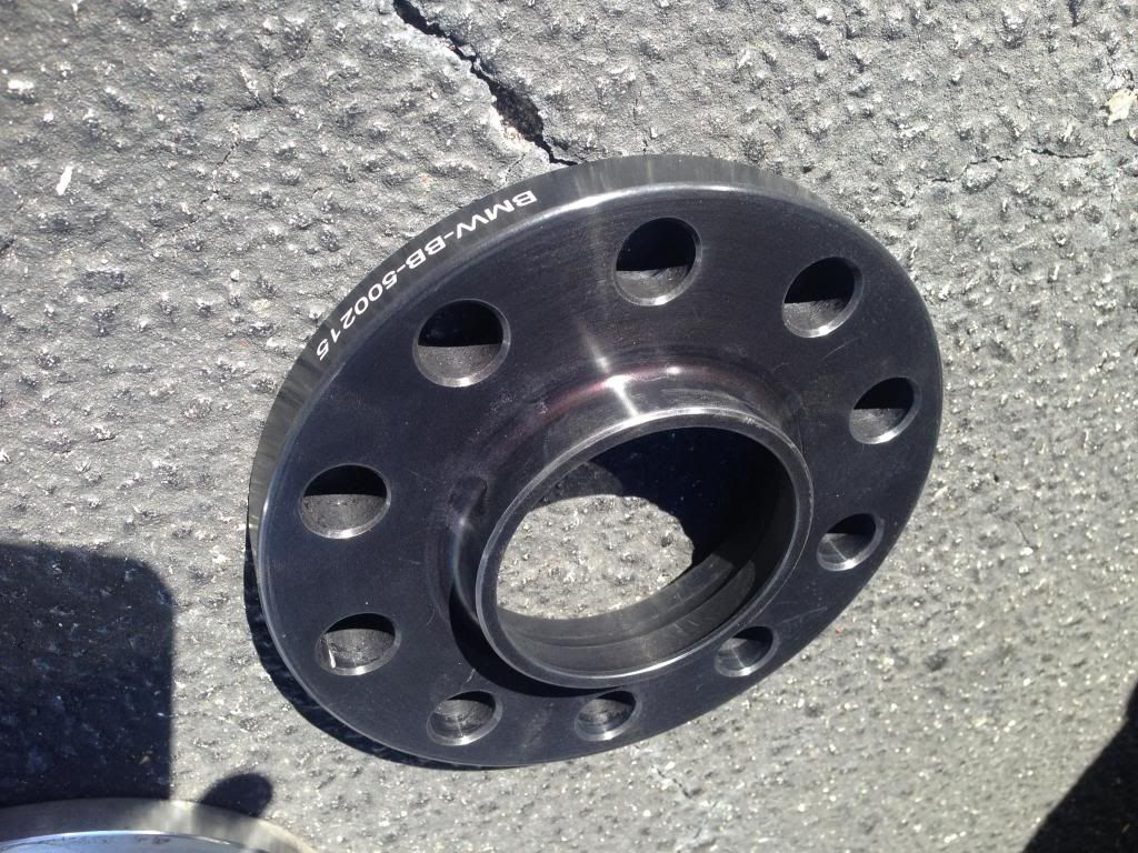

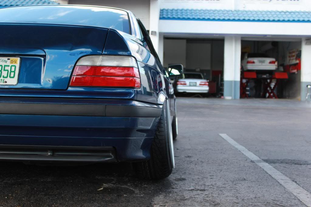

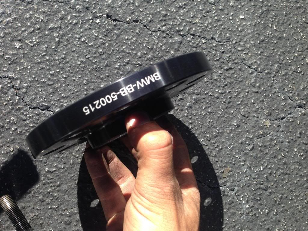

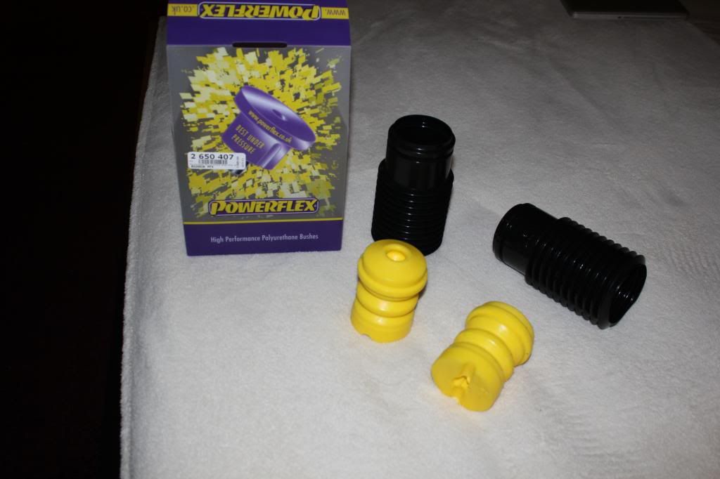

                    Next on the list was a set of polyurethane bumpstops for the rear, and 15mm spacers for the front.
                    And finally this is how it sits
