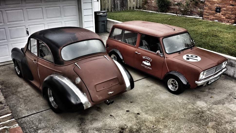

            Jeez, to think I started this build.... BEFORE I HAD A KID.... now she is a 1.5 years old. But eh progress is progress. So what will I do to make the purist **** me more? Shaved the front turn signals (Headlights have them built in), shaved the trafficators (I wanted to keep em, but they were just dummies anyway, and clean... clean.. clean), shaved gas filler (got billet filler in trunk now, re hung front end and added supports, tweaked both doors, and of course rear fenders are now done. I was going to fabricated a roll pan, but I just didn't see it working at this point. So I am gonna turn my time instead to finishing welding interior trans tunnel, wheel wells, etc. Also trying to come up with a dash extension to hide the heater/ac unit.

              Cars still amazing. I find it really good looking in its current raw state with some rust, some fresh metal and satin black fenders.

                    Floors all welded up! Trans tunnel fully welded up, well wheels, and custom dash made up!
                    Turn signals shaved (They are located in headlights now)
                    Sadly Trafficators are shaved... but pops wants everything smooth and clean...
                    A great solution to widening the rear fenders 3.5". A nice rounded front.
                    Gas filler shaved, and the 3.5" wider rear fenders fully welded up.
