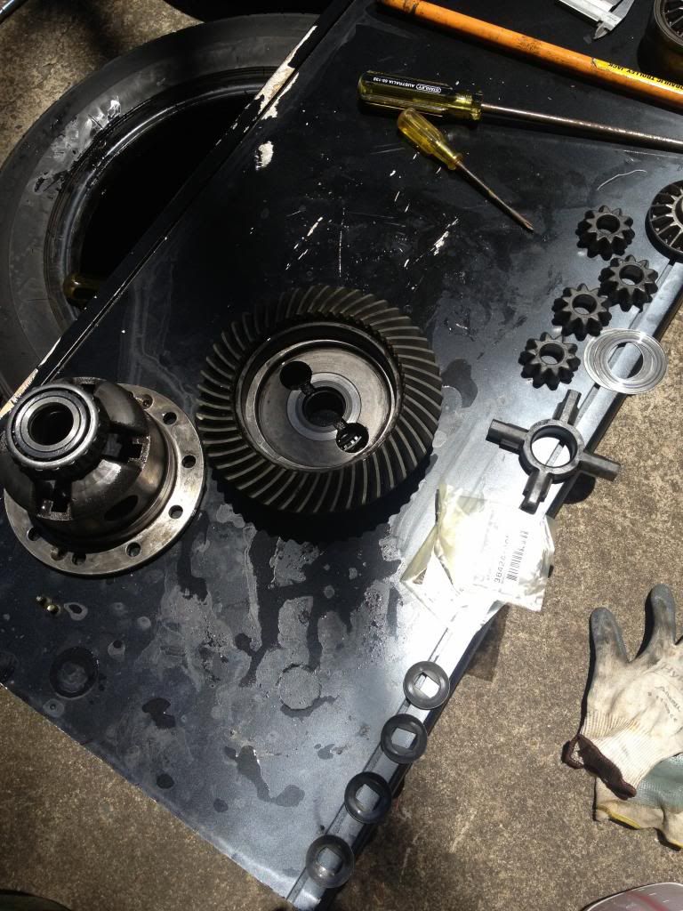

So next thing was to lock up that VLSD I had sitting back there. So shim the diff they said.. it will be funn they said.. said NO ONE EVER..
So I went out and got 2x 1.01mm shimms from nissan.. pulled apart the diff
I did have problems.. for starters getting the diff centre back together was a nightmare. Getting the diff centre back into the diff casing was even worse. And realising you didn't line up the shafts was just like being punched in the testicles multiple times..
Having taken so much force to reinsert the centre, we couldn't get it back out..
ENTER worst mechanic ever... I took it to my local workshop and asked them to take it out.. they tried battering/pressing the shaft in and ruining the teeth on the shaft
They didn't believe me when i said the splines weren't alligned..
They eventually got the centre back out, and we put it back together properly. Only this time the shaft wouldn't go in because of the ruined splines. I H*** MECHANICS!
So i took the shafts home, pulled out the grinder and did a super shifty DIY job and got the diff back together just in time for my first ever drift day.
