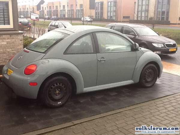

    She wanted a New Mini. But after a long journey for looking for the right one in Holland and Germany, we let the mini idea float. All the mini's have serious gear trouble and electra.
    Good talk with the misses lead to another of here favourite cars. A New Beetle. target was a black1.8 20vt or a 2.0 8v highline.
    After looking at a quit a few new beetles, all with high milage, cars with 3 colours black, female cars with damage, we got a perfect NB!

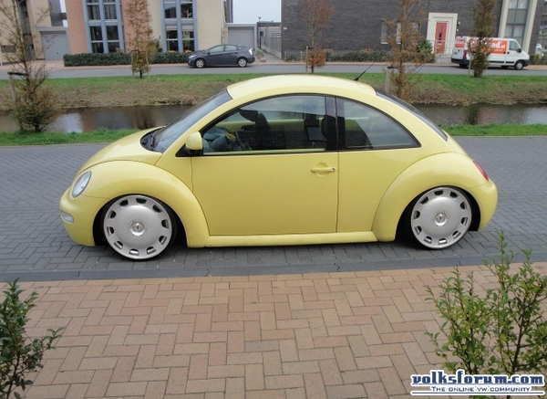

    Its a 2.0 8v with 110t KM from dec 2000. Dealer maintance, 1 prefious owner --> a adverticing company.
    NO history of damage. Only mod was a 4 tailpipe exhaust
    Its a NON highline, so no airco, no electric windows, but all the other options.
    Colour is Yellow. Not the targetcolour but fresh and fun.
    The wife loves it and the kids find it cool. I find it nice ( a have driven it 4 times now ops: ) and promiced the wife i would do anything with the new beetle. So here is Project : Kindergartenrenner part III :lol:

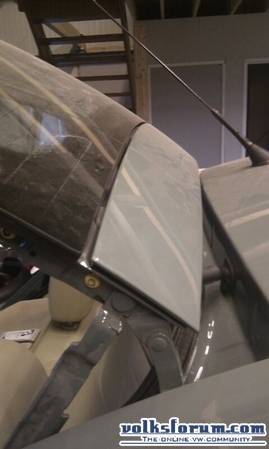

    Bought a bootlid from a beetle 20v( electric spoiler). I'm going to wire it with an corrado speedbox.

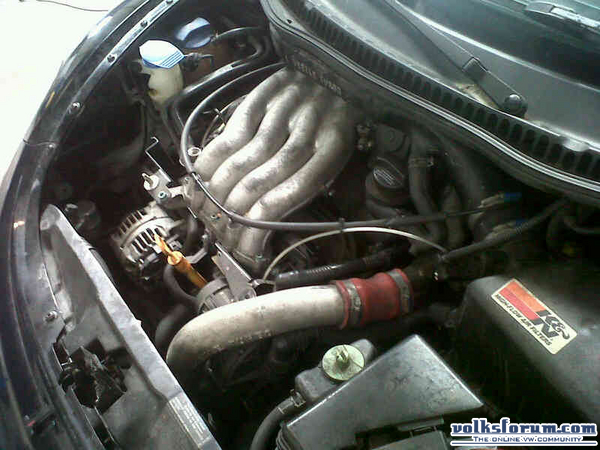

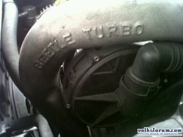

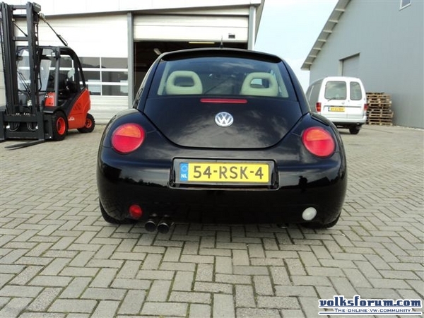

    details on the black bug.
    look at the details on the intercooling pipes ( beetle turbo)
    got the blackbug on dutch plates and it drives quit fast. it's faster then my mates his JD engineering MK4 r32.
    PS god Rick made a PS for the idea ( and no the turbo signatures won't come on i think)

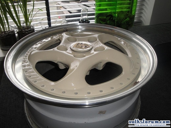

    when you look at the wheels you notice that these are different then the touareg.
    that's because i also bought a set of kerscher kcs 18 inch.
    also bought a set of original beetle xenonheadlights.
    i polished the kerscher wheels and the inners are of to the painter

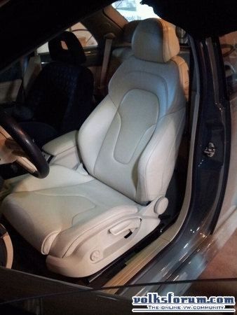

    I let the seat be proffesional painted in beetle cream.( the lightning gives a FU picture but it's all 1 colour) the headrest is of the backseat.

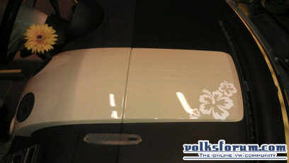

      also after long long waiting the back bootlid i go a mail from the german/polish seller that it got lost in the shipment and got the refund.
      With luck the local carbreaker got a silver Beetle v5 in from GB with a bootlid with spoiler..so i bought it..but the thing i noticed is that the vw emblem is the same stuck like the bonet( so no handle and locking)

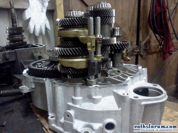

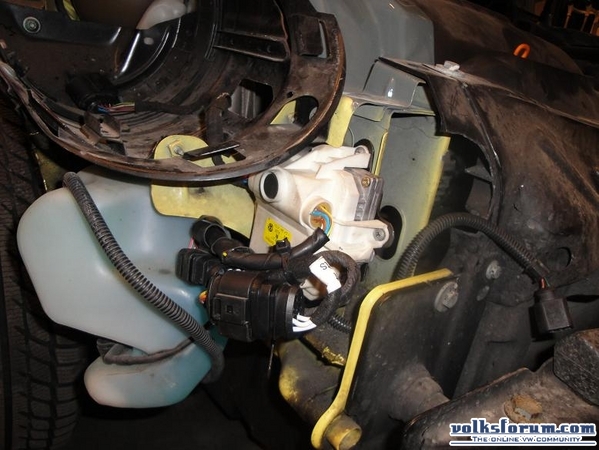

      also completly rebuild the gearbox with new parts, so it will be smooth. also did a modification with the arm for the first and second gear ( stronger) controle arm.

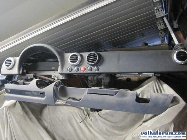

      also bought the complety front of an audi tt ( controle arms, steering rack etc, brakes, subframe, stabi etc) for a better drive in the corners.
      also busy with a tt dashboard (looking for it)..

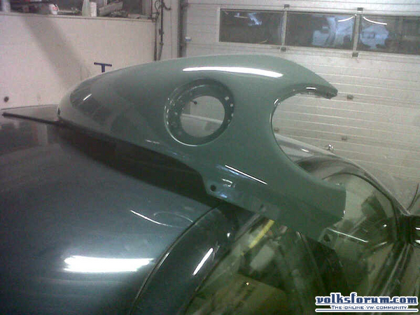

      and the new bootlid from GB

        tommorow of for the complete tt dash and stuff
        picked up..only the cluster and steering wheel are missing.. but all the other stuff, mid consol gear stuff complete..

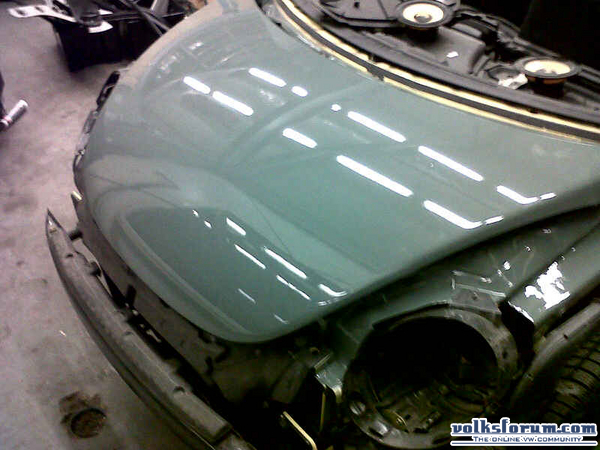

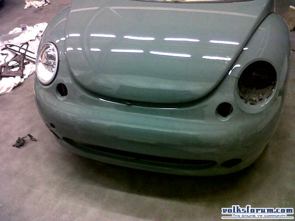

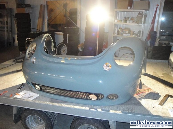

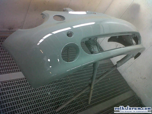

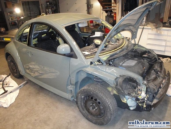

          it's at the painter..
          off to the painter

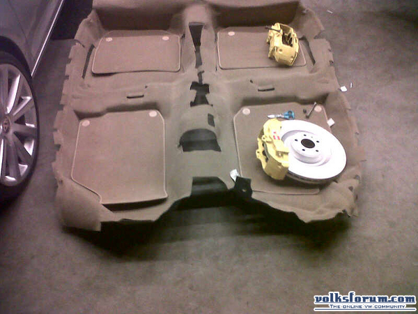

            Original beetle carpet and feetcarpets. Only where in the car for 10 miles.

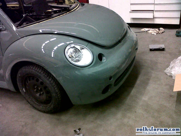

            bought this today.. brand new votex sills .. just in time for the painter
            good company
            Again with help of friends

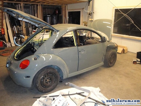

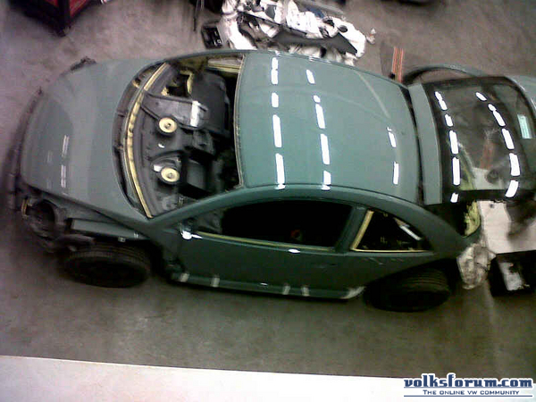

              We have welded the side markers. found some tiny rust spot under the striping on the roof. Cleaned it and, some tinn and zinkspray.
              so now all the work is done.. now sanding paint etc etc

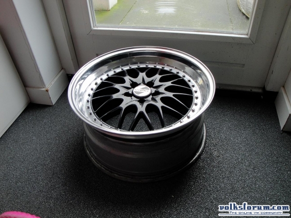

                  long nights, did the wheels

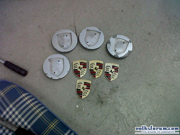

                  parted them
                  de badged

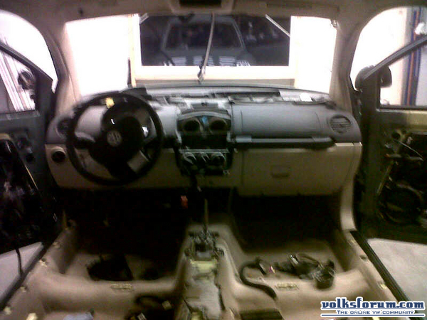

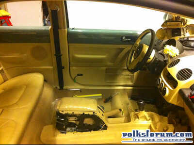

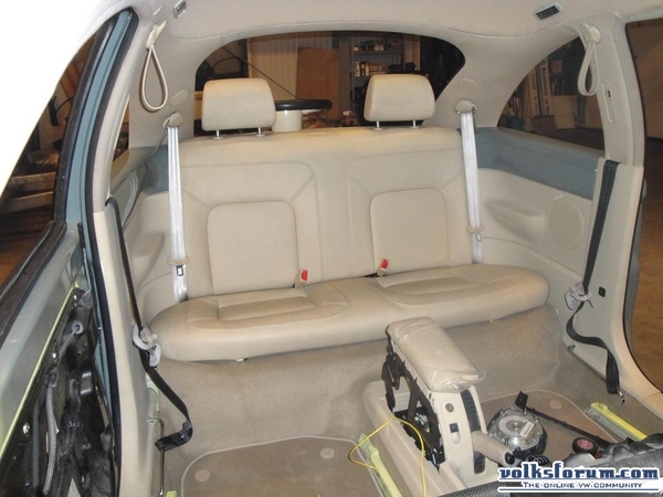

                    interior.
                    All beige leather, with beige leather audi R8 seats. dash i don't think i'm going with the tt dash, but i'm going for a rsi dash
                    updates
                    parting it together
                    rsi bi xenon

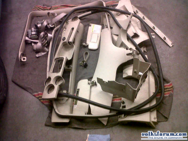

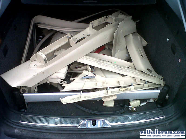

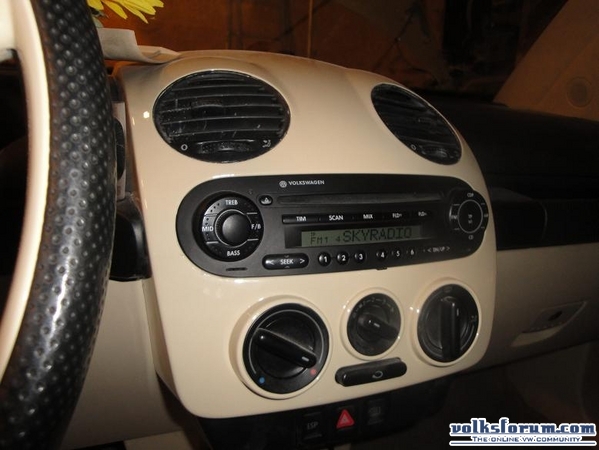

                    beige parts
                    also the grey ones out and in with the beige( also carpet and headliner beige)
                    doorseals also with beige

                      Good friend of mine Arno did all the electrics
                      it turned from manual windows to electric orginal vw

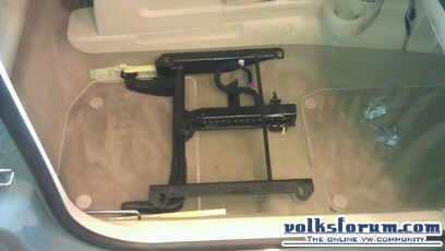

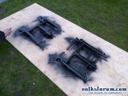

                        custum seatframes
                        polished
