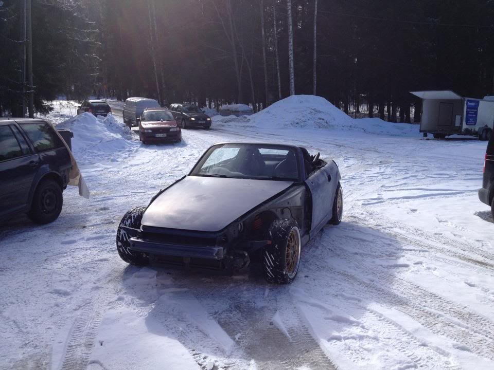

    Got my S2000 back in the spring of 2011 after dreaming about one for many years. Since there was only 1 S2000 sold by the dealers between 1999-2008 in our country I had to search for it from abroad. I was looking at them from the internet, and found a good looking car from the UK. I had a local guy go do a test drive it for me, and bought it after that. He dropped it off at the harbour and it was shipped here after that. I had never even seen an S2000 when I went to pick it up, let alone drive one. A pretty breathtaking experience to say the least!
    Hereīs how it stood when I bought it. Completely stock 2002 UK-Spec in my favourite colour for the AP1, Monte Carlo Blue.

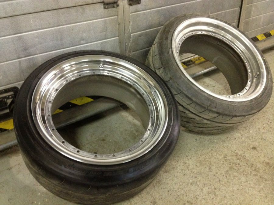

    These rims are 2-piece, and they were put together with these rather irritating titanium rivets.
    I tried drilling the rivets, and cutting them off with a Dremel-tool with no luck, so we took out the angle grinder..
    A couple of exploded cutting blades, and a lot of bright-white sparks later the wheels were taken apart.
    Some polishing of the lips and painting of the centers took place, and here they are put together with new bolts.

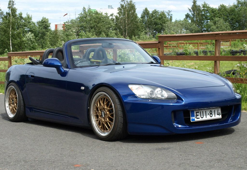

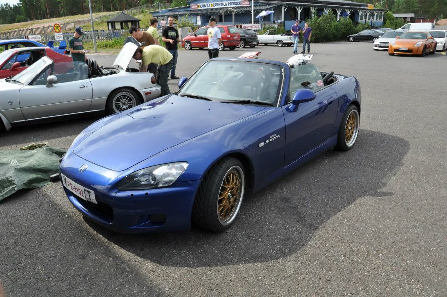

    The rest of the summer went driving like this. Racked up some miles, hit the country lanes and twisties when ever I could and also attended a few track days. Some random pics.

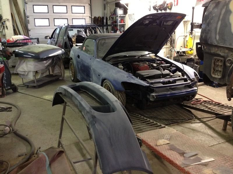

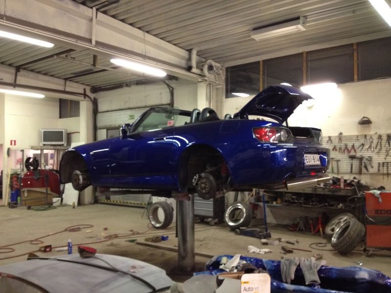

    Well, as always the summer ended too soon and it was time to put the S away for the long and dark winter. We rent a garage for the winter with a couple of my friends, and once we got the car in there the tear-down could begin..

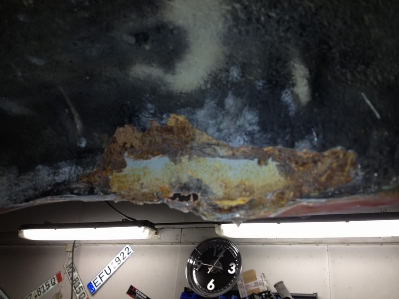

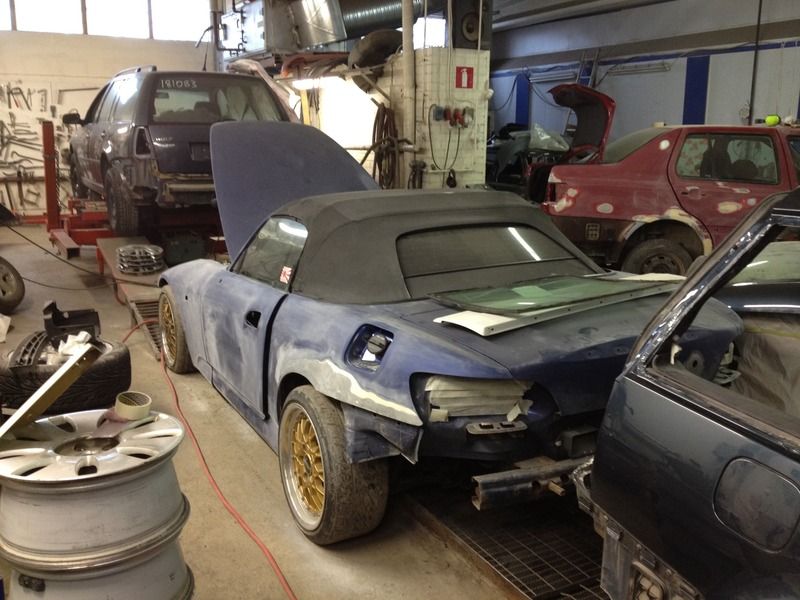

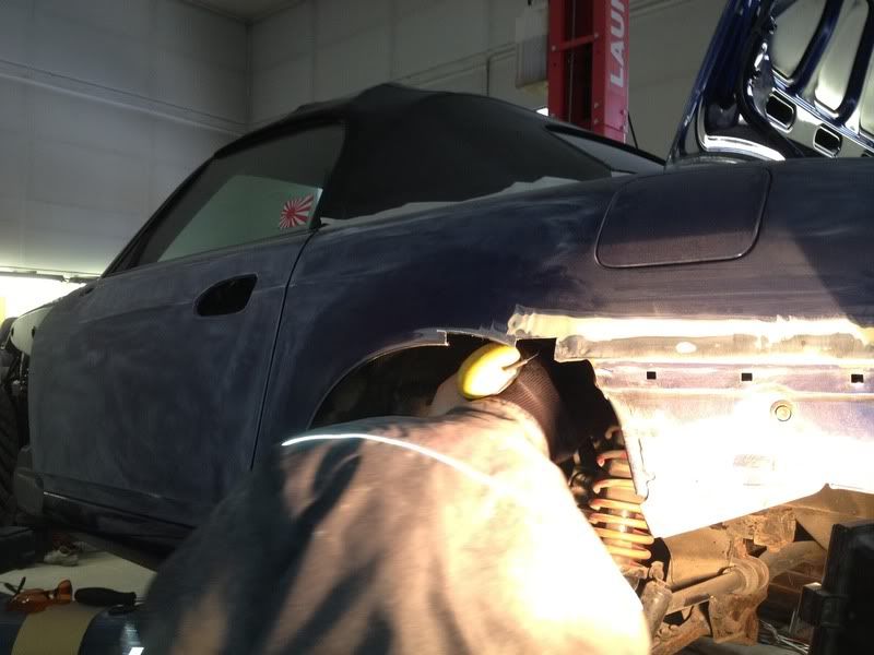

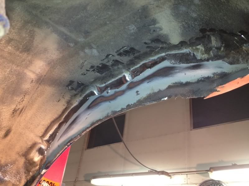

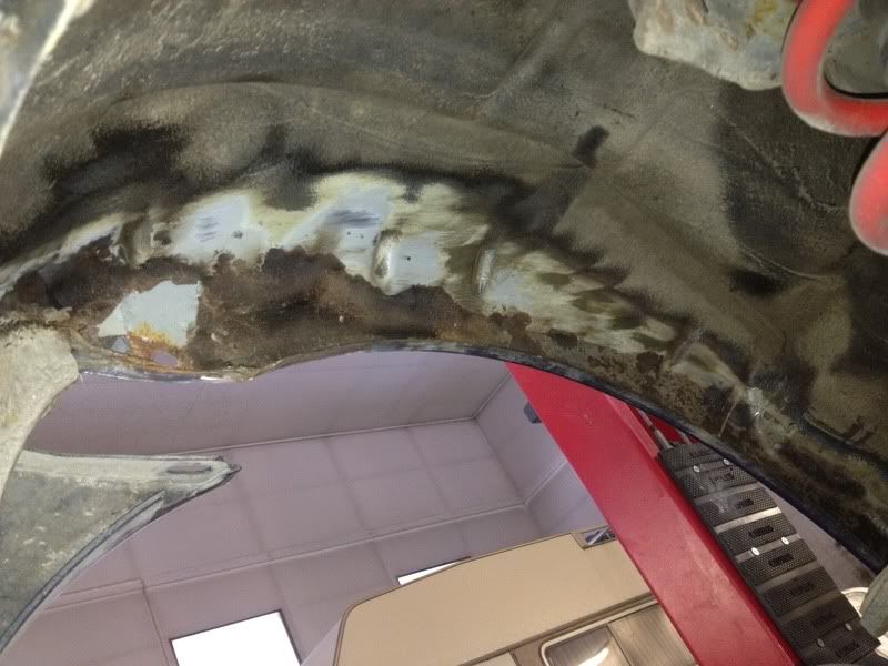

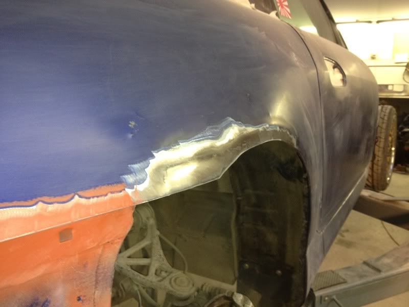

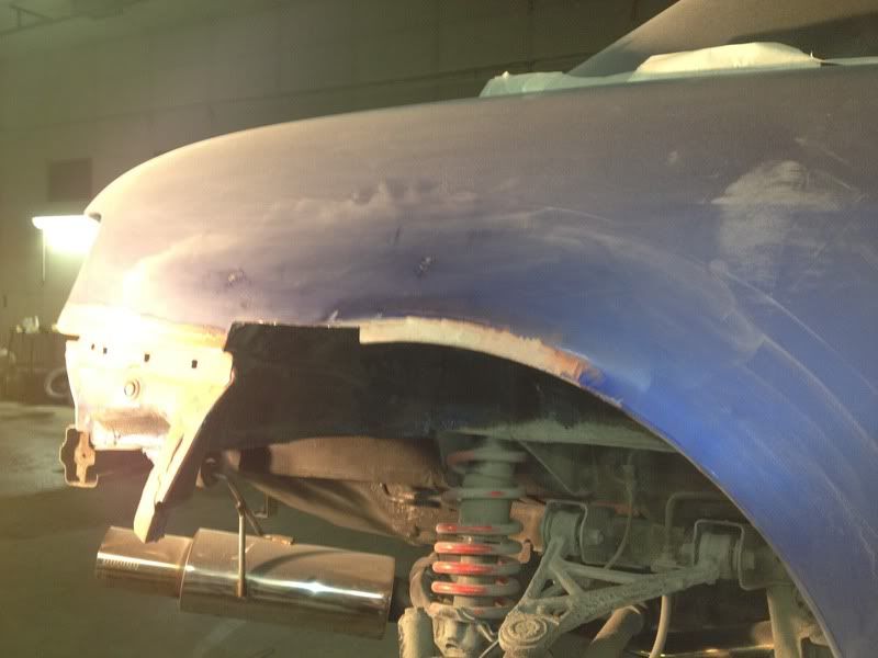

    The rear arches had some rust, so we started with taking care of that.

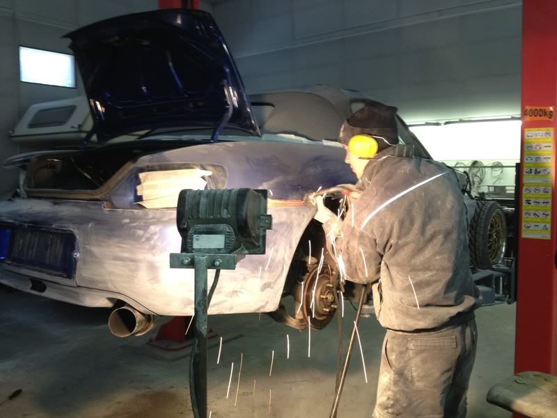

    Cutting off the rotten bits one by one..
    A lot of thanks to my friend Juhi for taking care of the sheetmetal-work, couldnīt have done it without him!

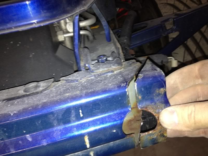

    I also modified the front beam a bit to accept the AP2 front bumper.

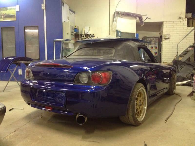

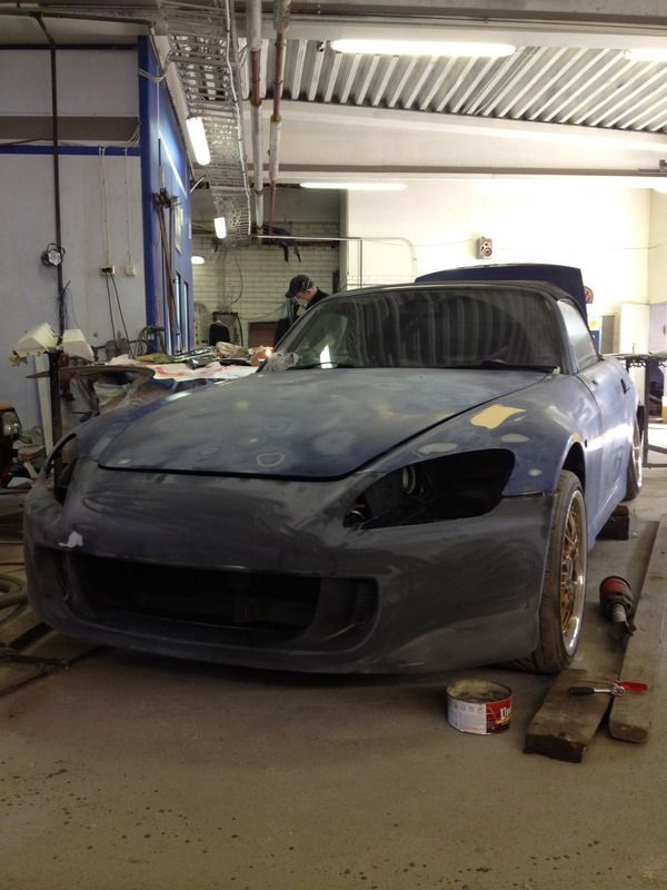

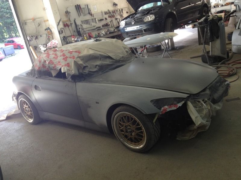

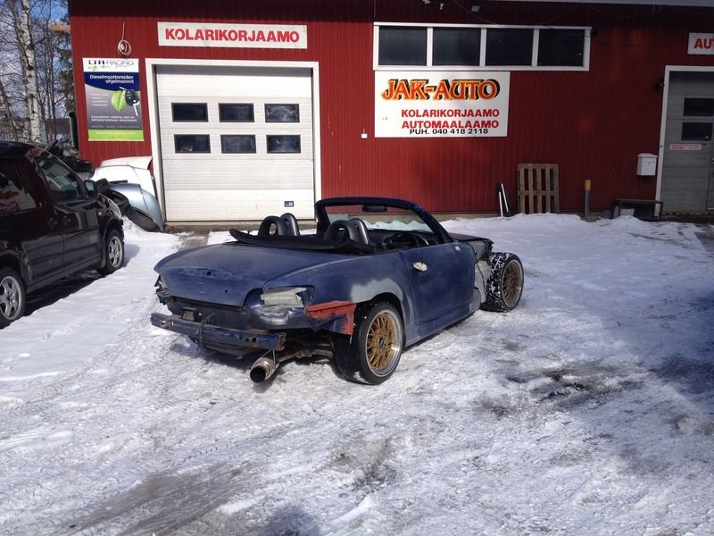

    After the rust was taken care of I started doing prep work for paint. Once I had matted the surface and taken off everything that was in the way for painting we put the car on a trailer and took it to my friends paint shop where I continued doing the prep work.

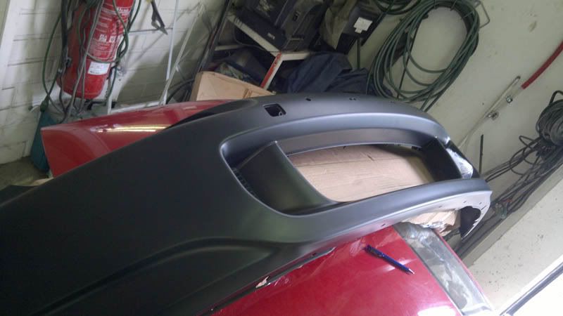

    Test fitting the AP2 bumper.
    Primer layed on, sanding process starts all over again!

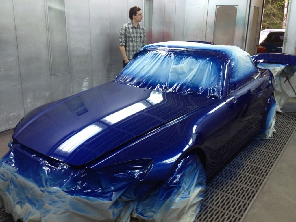

    Fresh paint, turned out great!

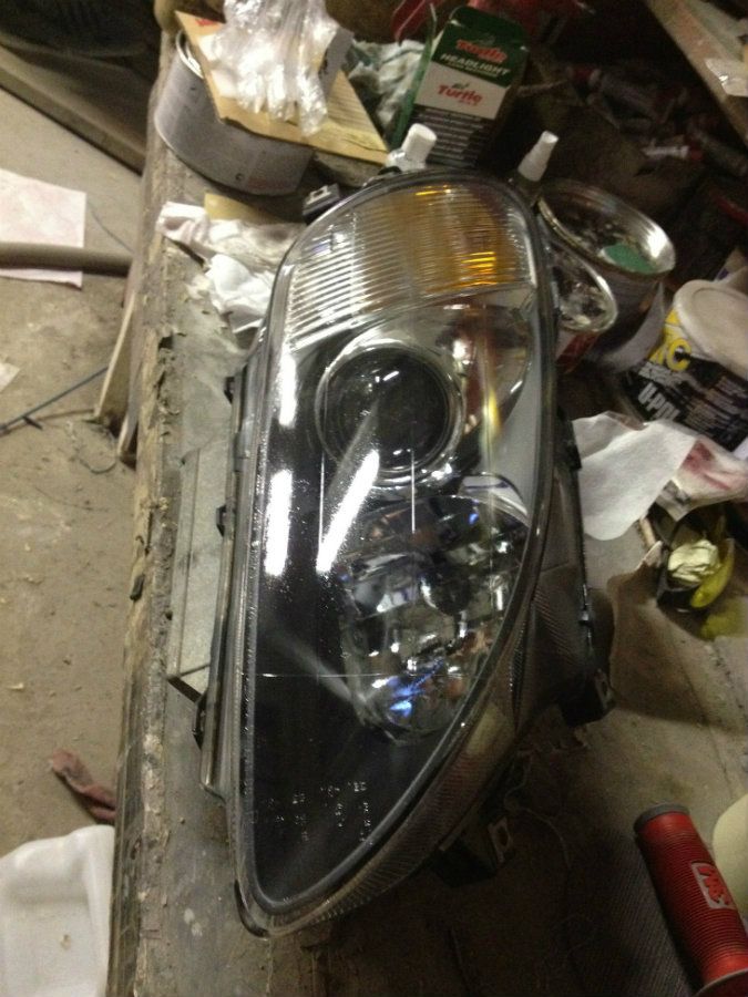

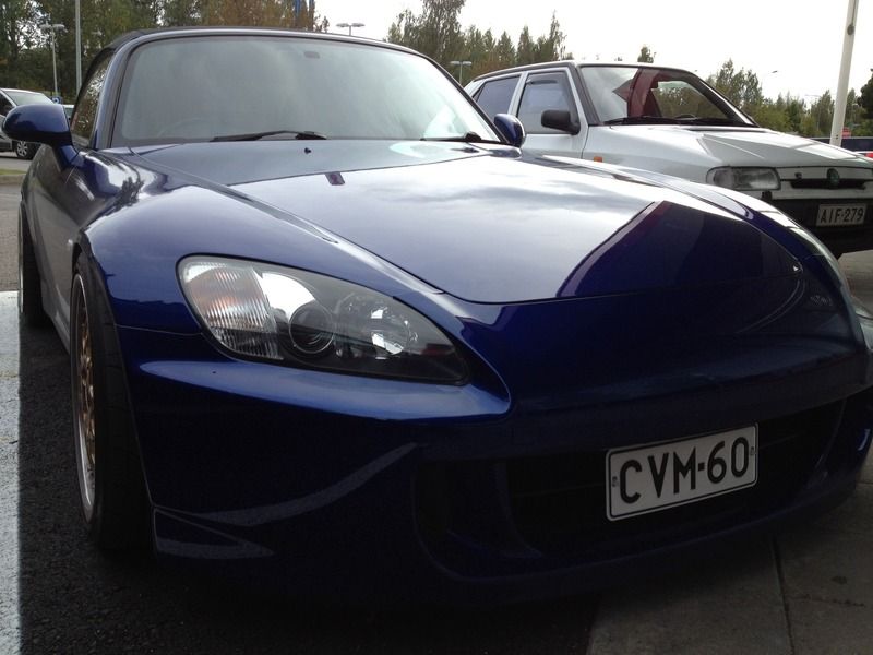

    Refurbed and polished the headlight lenses before putting them back on.

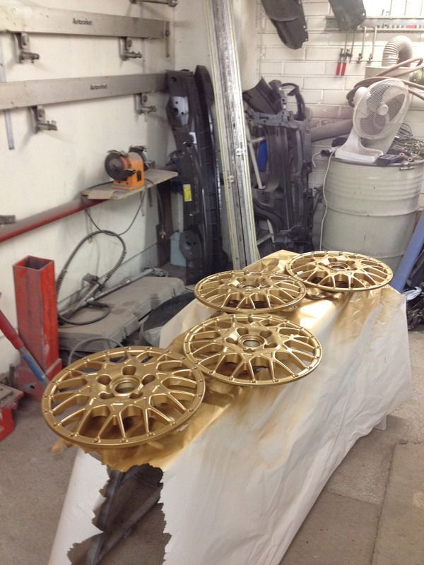

    Giving the wheels a fresh coat of paint and a polish. A slightly different shade of gold this time.

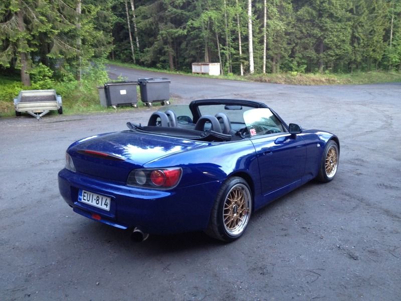

    And after two nights of assembling I could take the first ride of summer 2012.

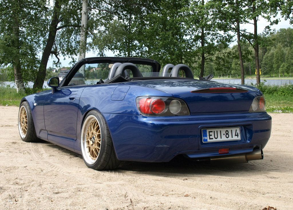

    Next up was the installation of the BC-Racing coilovers I bought. No pics of this, but this is how it looked after that.

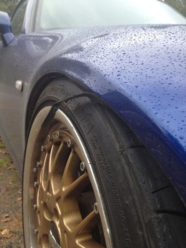

    The wheels were sitting two far inside the fenders so I threw on some 30mm spacers to cure that.

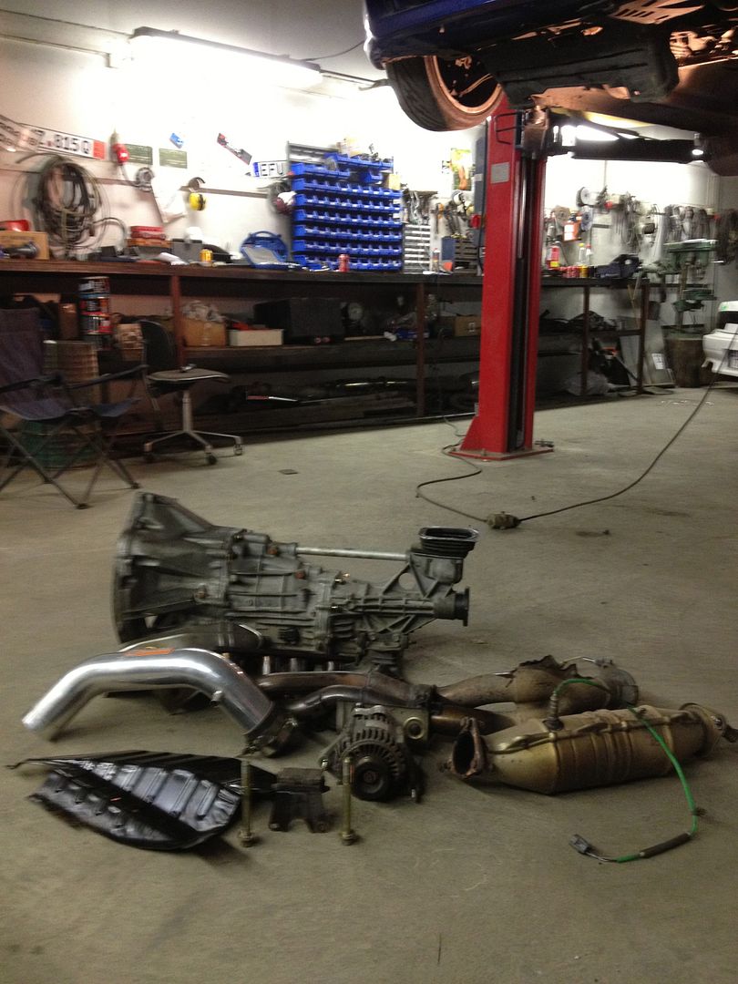

                  Some updates. I took off my gearbox a few weeks ago.
                  Lucky to have the lift! It would have been a massive PIA to remove it on jackstands..
                  Still had to use a looooooong extension to get to some of the bolts though.
