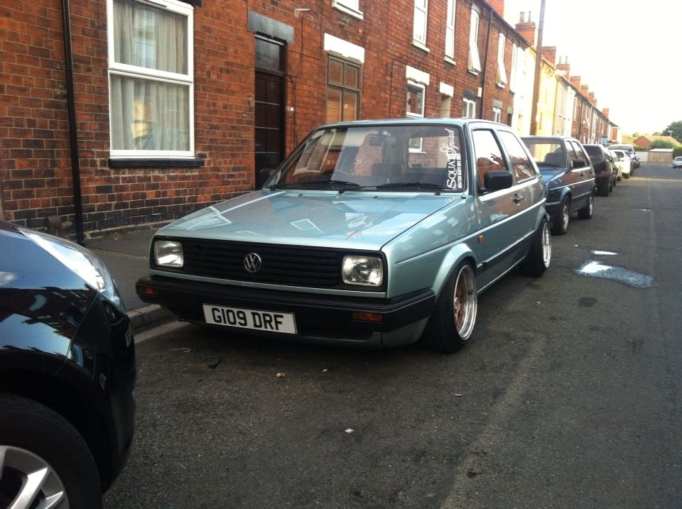

    Just a single photo for you guys...
    • #77
      Sitting nice!

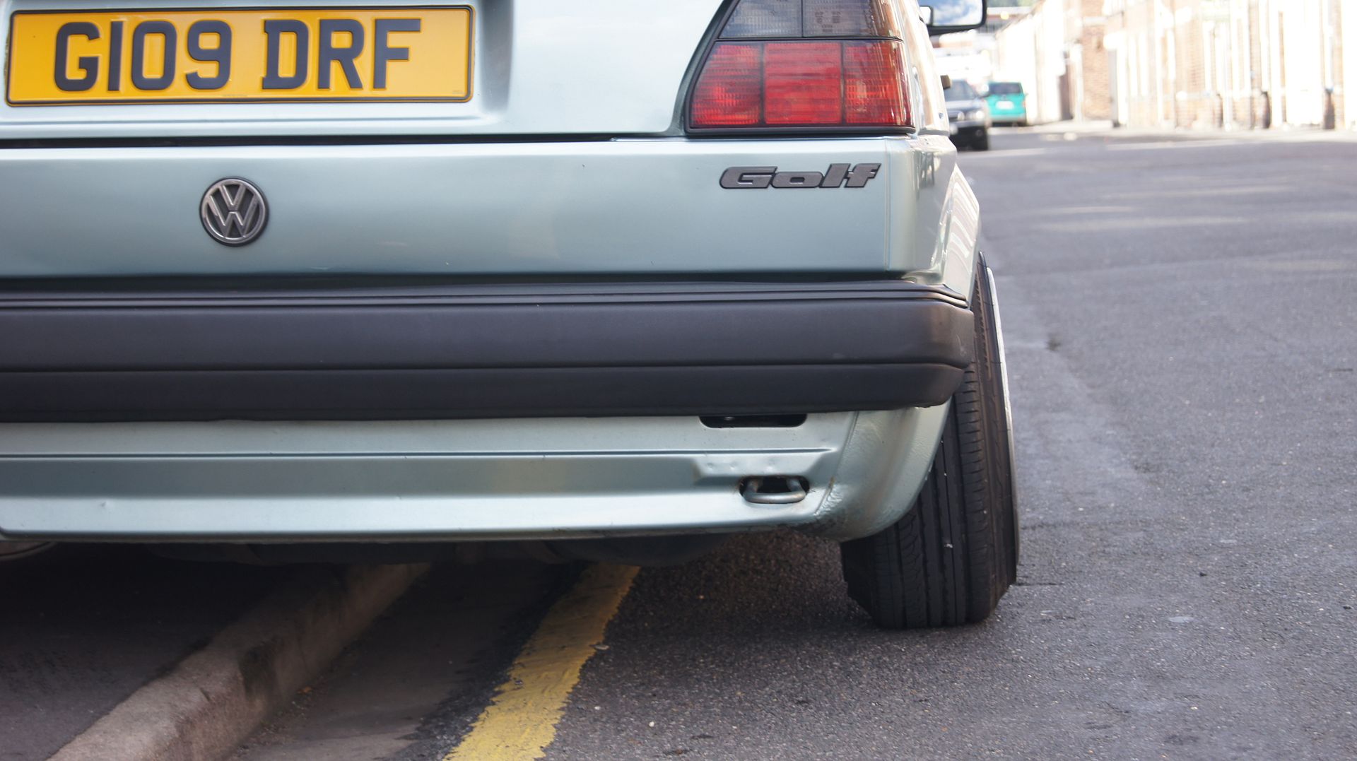

            My pursuit of being silly low continues! The next step for getting lower was camber. There's a photo above showing the little amount of camber before so i'll just post the afters...
            Tomorrows job is to (hopefully) camber the fronts and then I can wind the coilovers down some more!

                Another week, another update.
                Yesterday I finally got around to cambering the rear wheels and then today we camber the front which in turn, allowed me to lower the car all around a bit more. The rear has not yet been lowered (tomorrows job) but the front has.
                I've had to remove my splitter as it was curled under the car. I'm now on the look out for a small CL splitter. I'll post a few photos tomorrow once I get the back down more

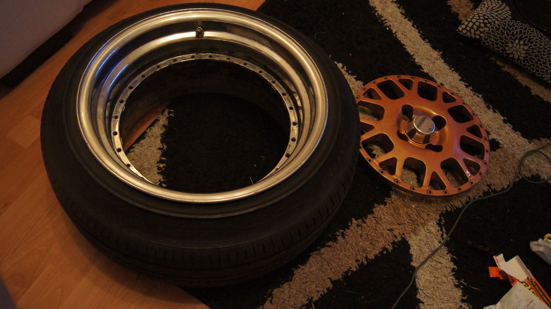

                    I then decided to take it for a drive. Bad idea. My front right tyre suddenly lost all air forcing me over into oncoming traffic. Luckily, no accidents but it would appear that TEN bolts had snapped in my split rim.
                    No messing around, straight home and the wheel was split.
                    Now, there was absolutely NO sealant between the inner dish and the centre, could that cause it?
                    • #85
                      Nope. Looks like they were torqued incorrectly from image.

                        A few of you may have seen a thread from me last week. Long story short, I had TEN split rim bolts fail at the same time. It lost all air instantly but luckily, didn't damage the actual wheel itself.
                        We have since learnt that the bolts were torqued up to THREE times what they should have been. Anyone, spoke to Image Wheels for the correct details and rebuilt the wheel.
