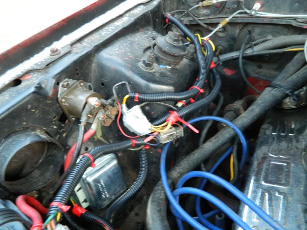

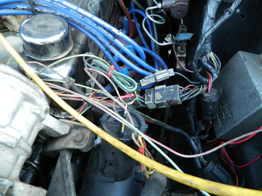

Started cleaning up the complete clusterfuck of 28 years of quick cheap repairs on the wiring. Areas where broken connectors have been cut out and somebody has cobbled together something to fix it. There's a single flat spade terminal that has 7 wires all soldered to it, and 3 of them are 10g power wires. Such a headache, but I'm making some progress. Need to buy bigger black wire looms, some heat shrink tubing, electrical tape, about 50ft of 14g black wire and a few nice junctioning blocks.

To clarify, under the grey tape on the left is the 7 wires all now on loop terminals, attached with a good sized bolt through the middle. Just a temporary until I get a junctioning block, but a lot better than a single super corroded terminal.

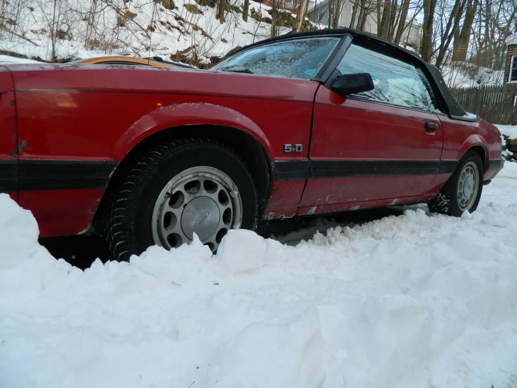

So, here's some better pictures as it sits now. Needs door pins to fix the crooked door, desperately needs paint work, but surprisingly not much rot really. Windows don't line up at all on either side, which is pretty sweet.

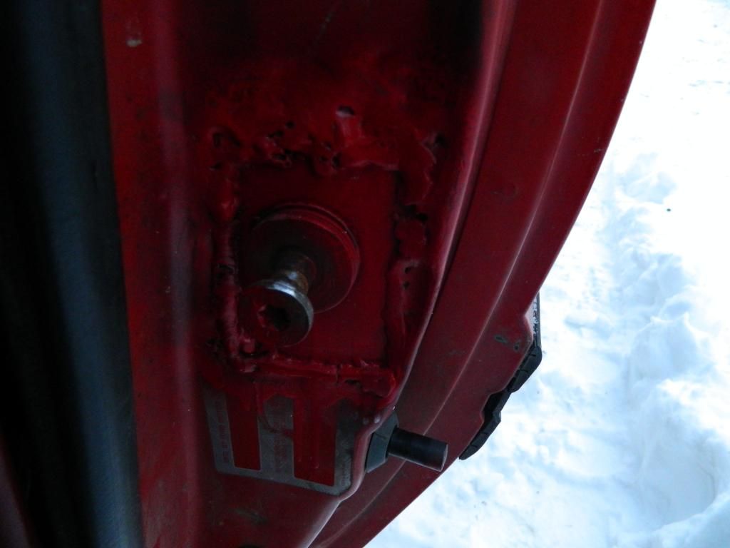

Here's the fixed door latch. I didn't have time to grind the welds down, but that plate is 1/8" steel so it's not going anywhere.
Door latches perfectly now. Just gotta make it pretty before spring.

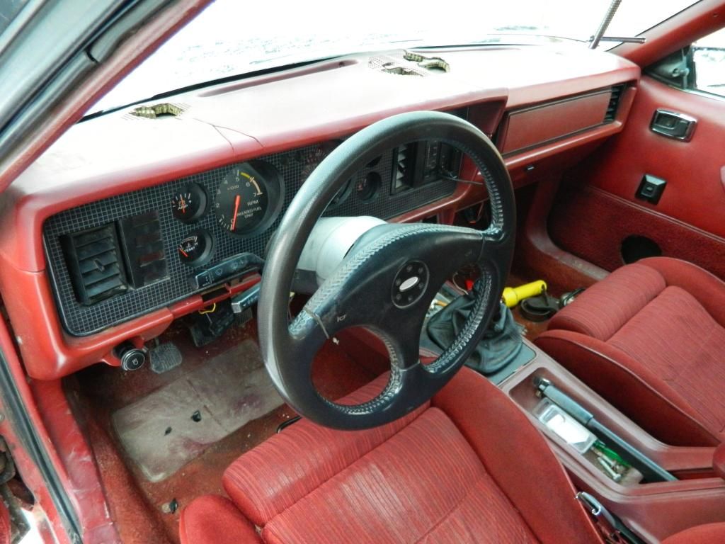

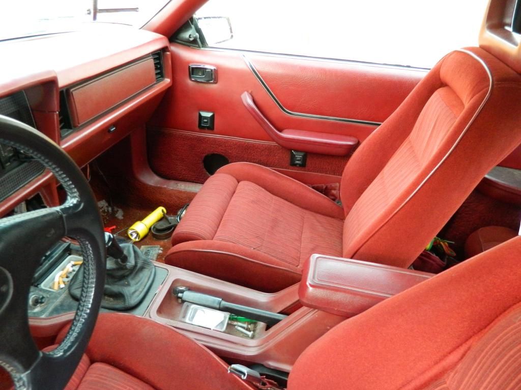

I love the steering wheel, it's got an awful tilt wheel though. The tron grid dash is about as 80's as it gets. Amp gauge.. doesn't work. Temp gauge... doesn't work. Gas gauge... does work, but only half the time. Missing the entire lower dash panel, as well as the dash being cracked to hell. Seats are in remarkably good condition, as are the door panels and carpet.

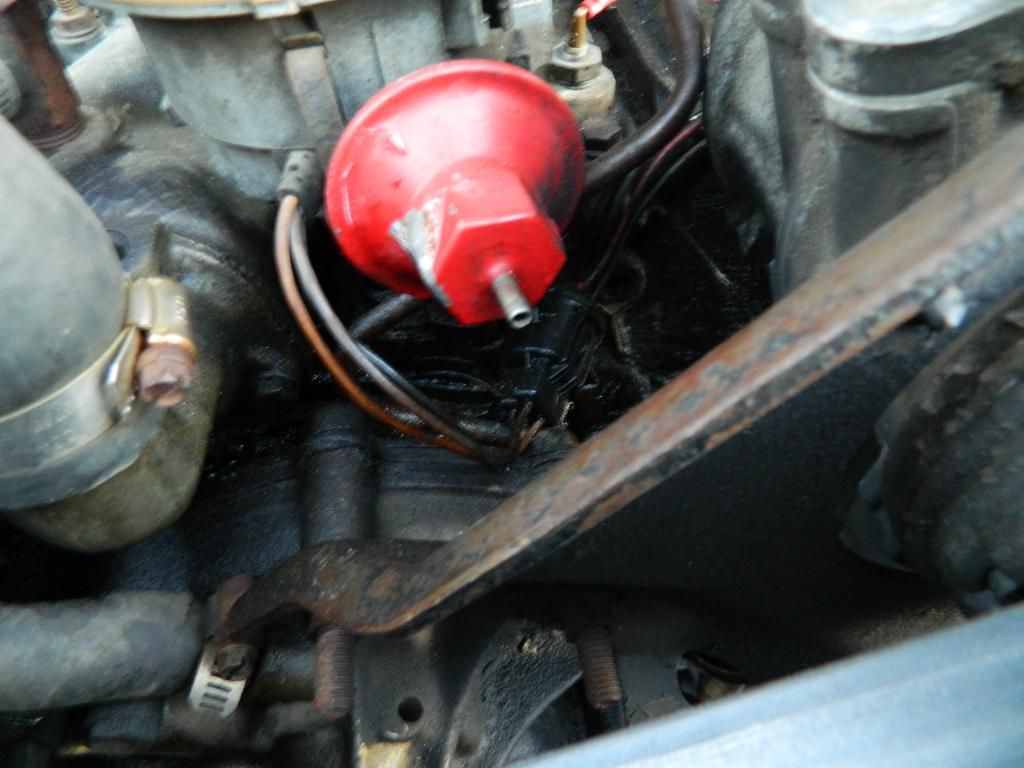

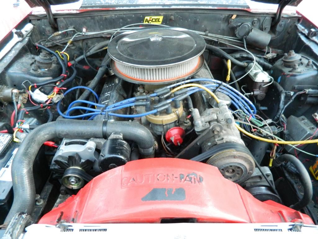

Filthy engine, haven't had time to sit down and clean it yet. In the middle of running a new vacuum line to the distributor, so don't mind that. Rat's nest of wires currently, and leaks oil like a sieve but that's okay. You can see my wiring on the left, vs awful wiring on the right.
