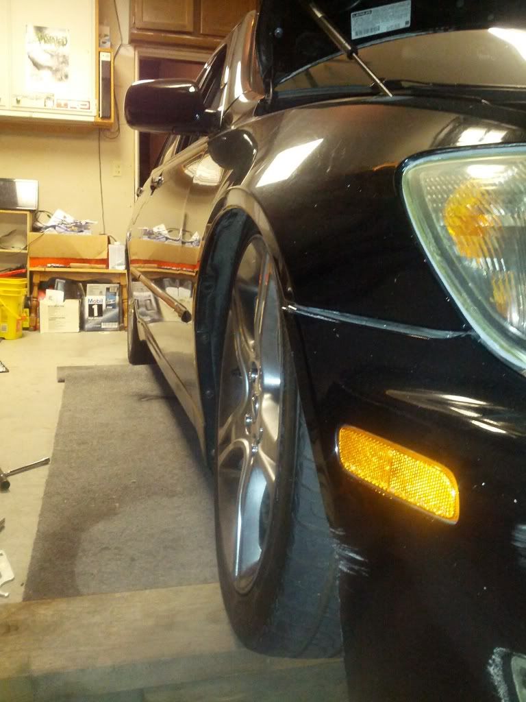

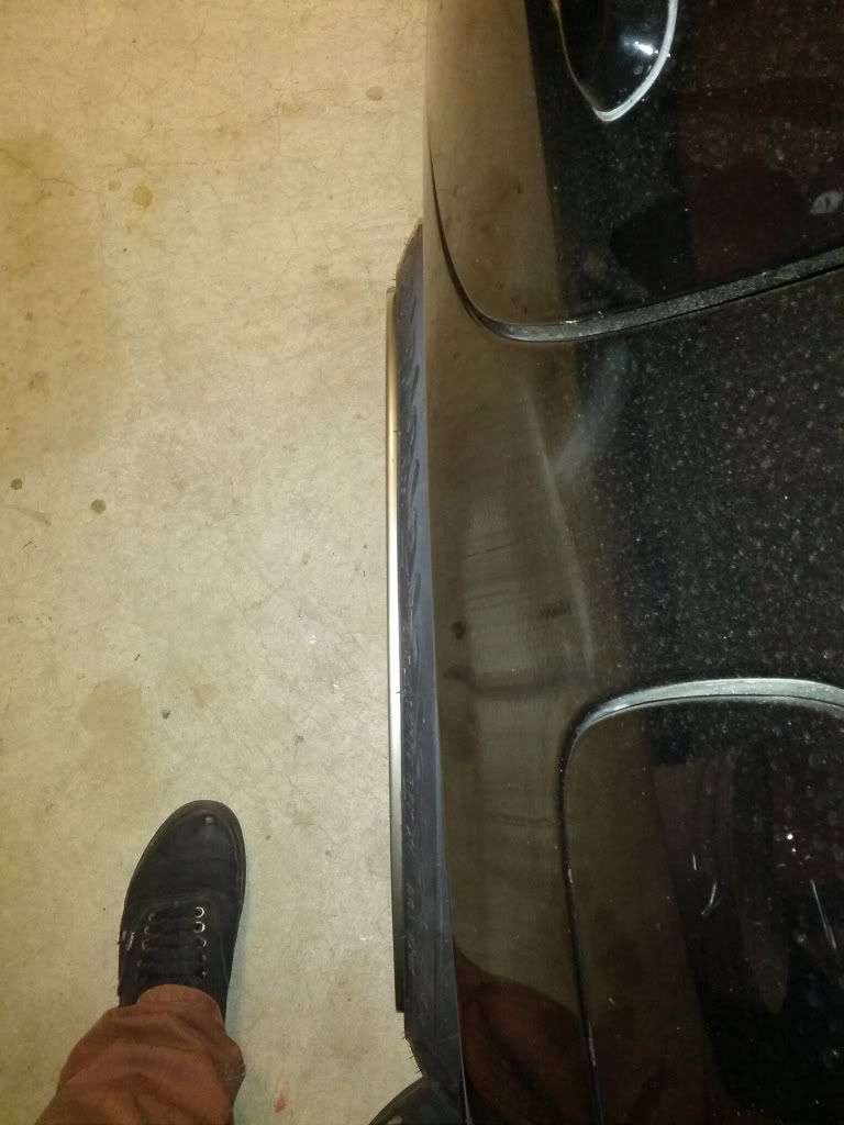

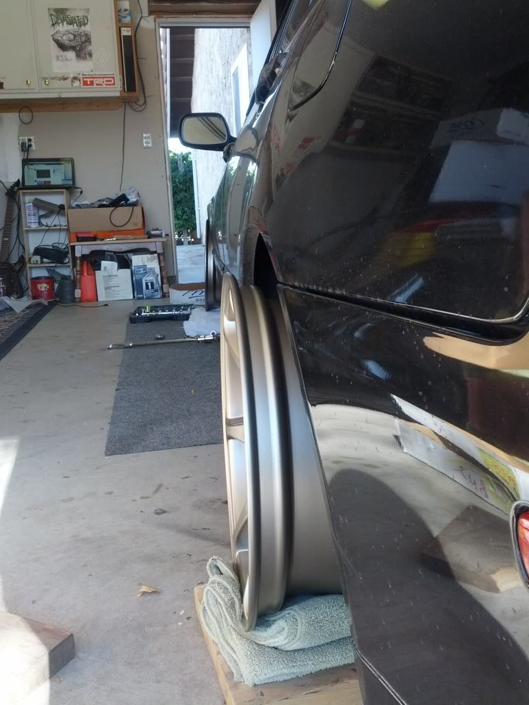

    Looks good! Question, have you gotten an alignment since you've lowered the car? It looks like you have some toe-in for the rears and that will absolutely destroy your tires. Looks good and looking forward to seeing some videos.

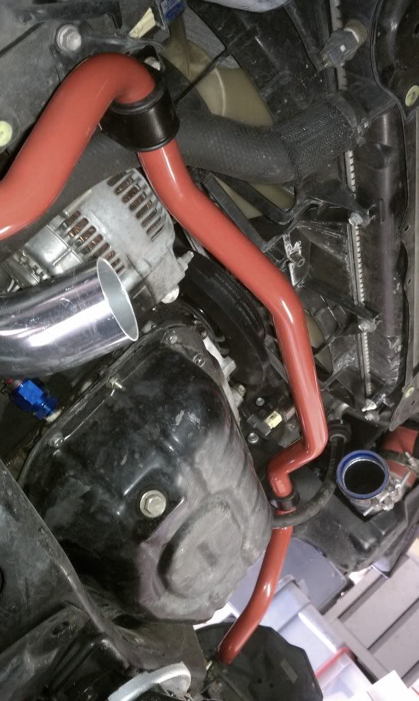

    Thanks man I can't afford some nice Works or CCW's right now. I think the Battles take care of wheel dept for now. Right now the motor is still NA, I haven't put the kit on since the rebuild. But not to worry, it'll be going on very soon Next I plan to go with a Vertex kit, get the cabin caged, and put in some bucket seats. After all that's done, I hope I'll already have been turbo'd.

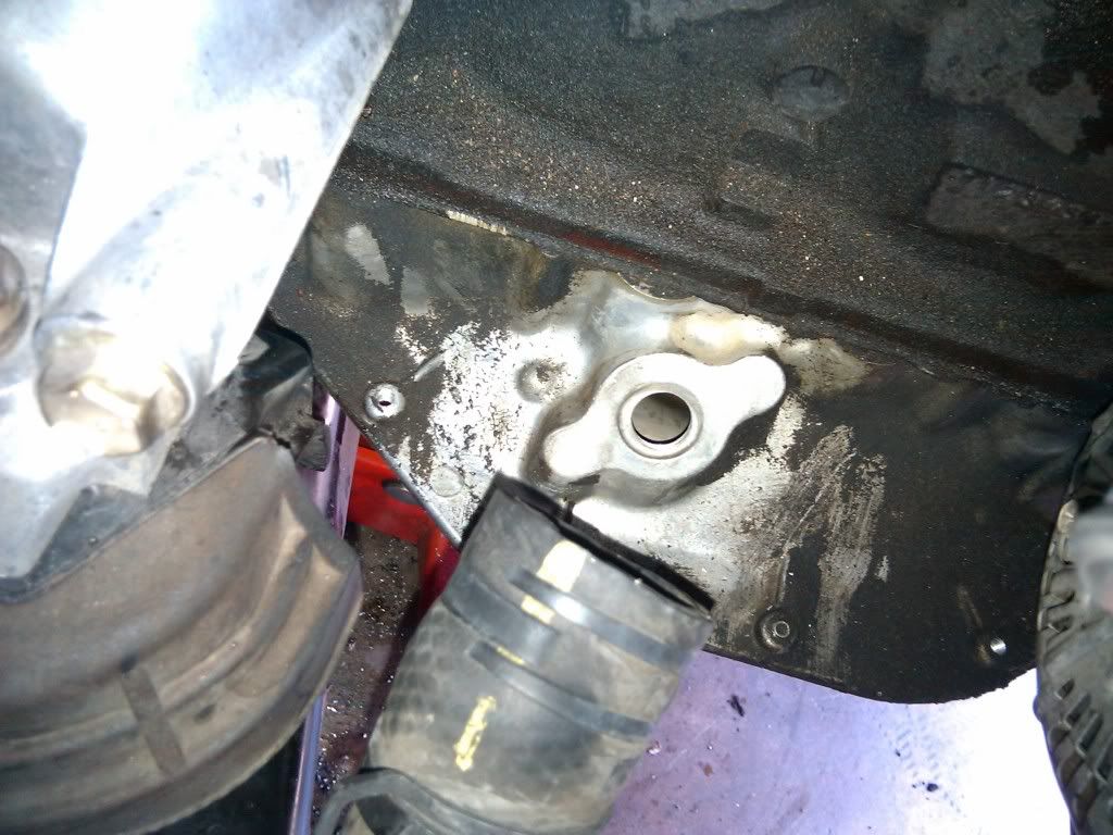

    It's the small things keeping me from boosting right this second, I need to re-drill/tap my upper oil pan for the oil drain line from the turbo cause I had to get a new one. I also still need misc oil lines/fittings as well.
    Things like this aren't very fun to do all over again lol:
    ...one step at a time though, it'll eventually happen.

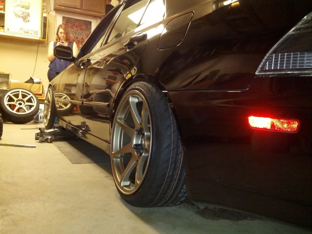

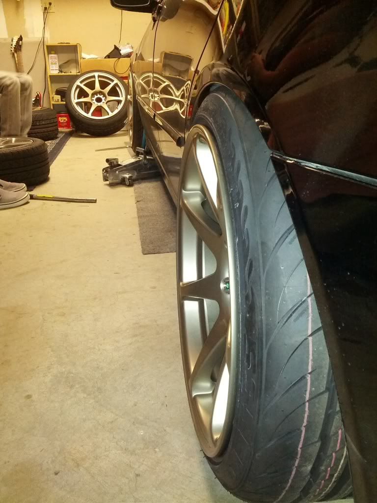

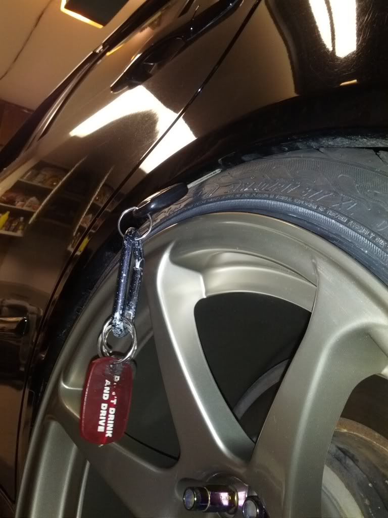

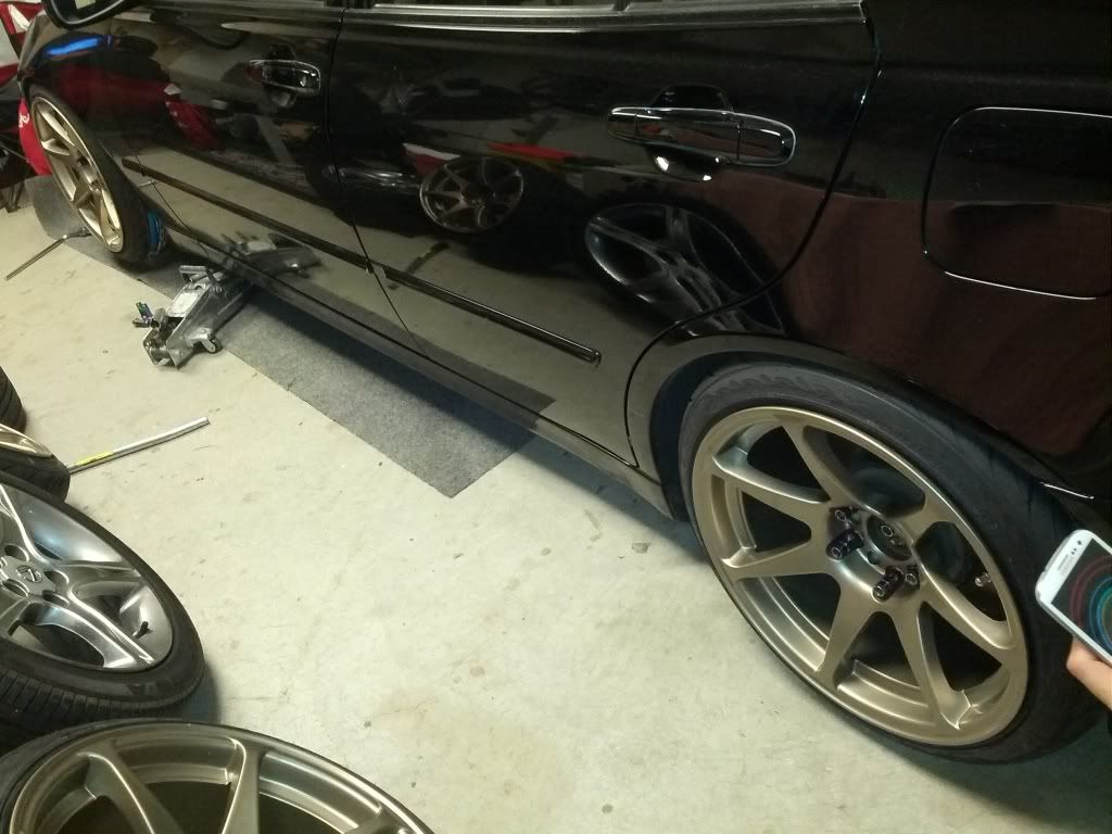

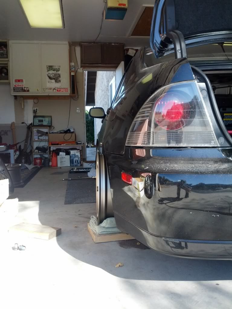

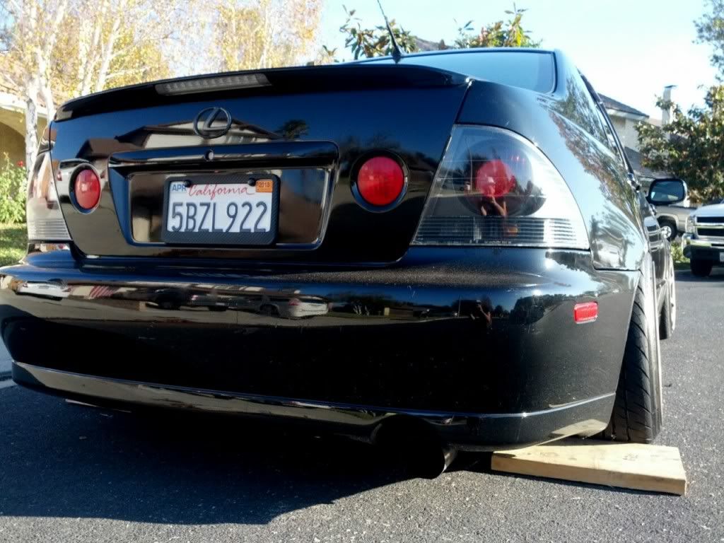

    And finally, this is how the car is sitting now until I pull the rear fenders out some more:

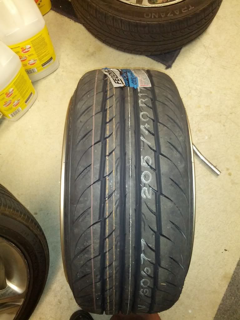

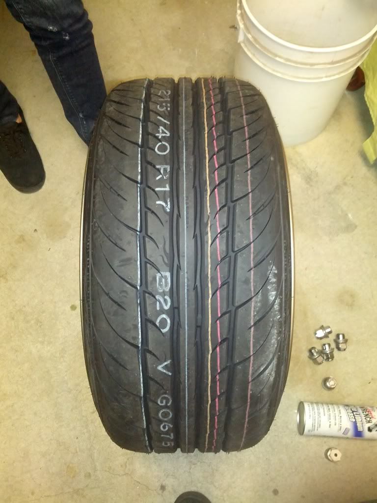

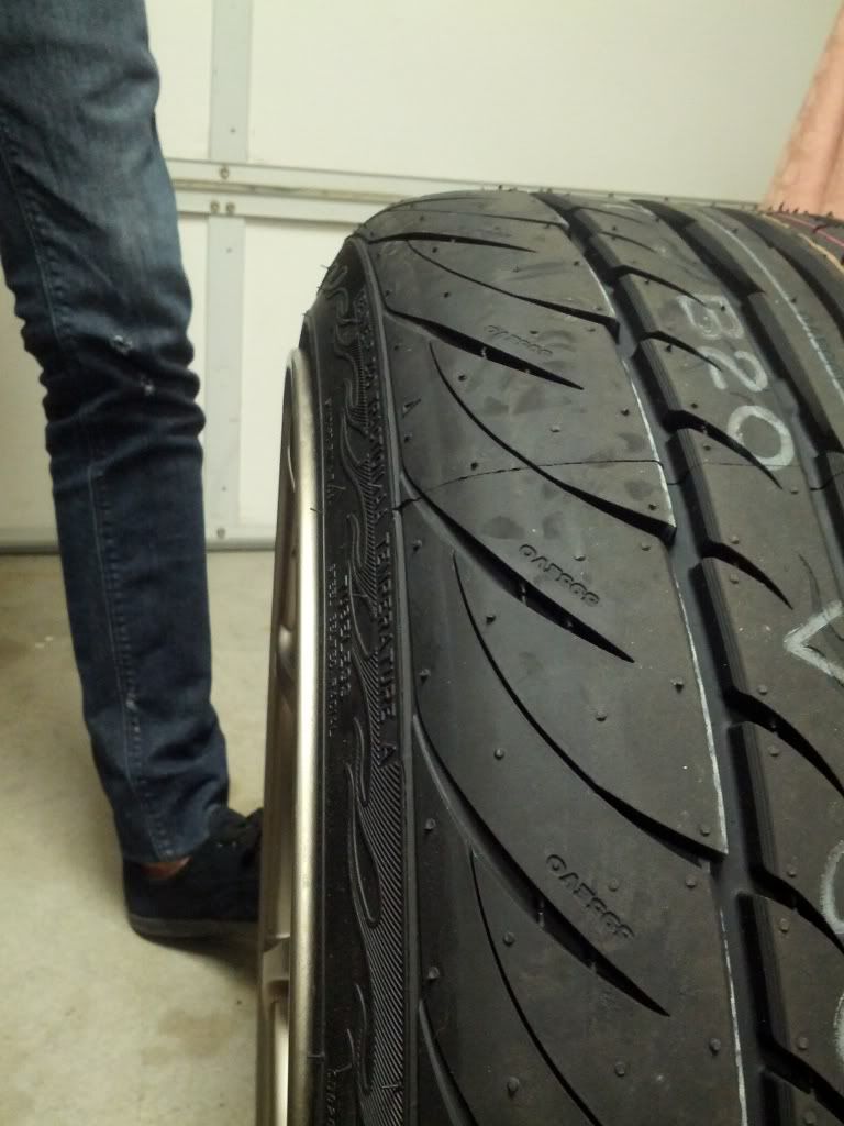

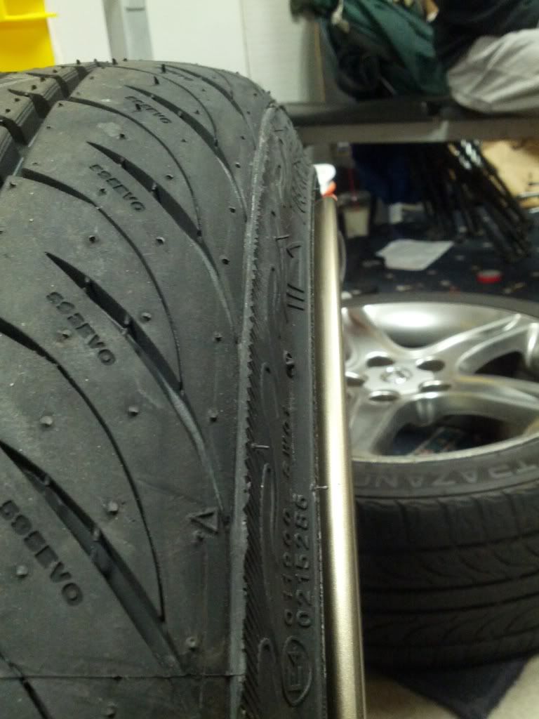

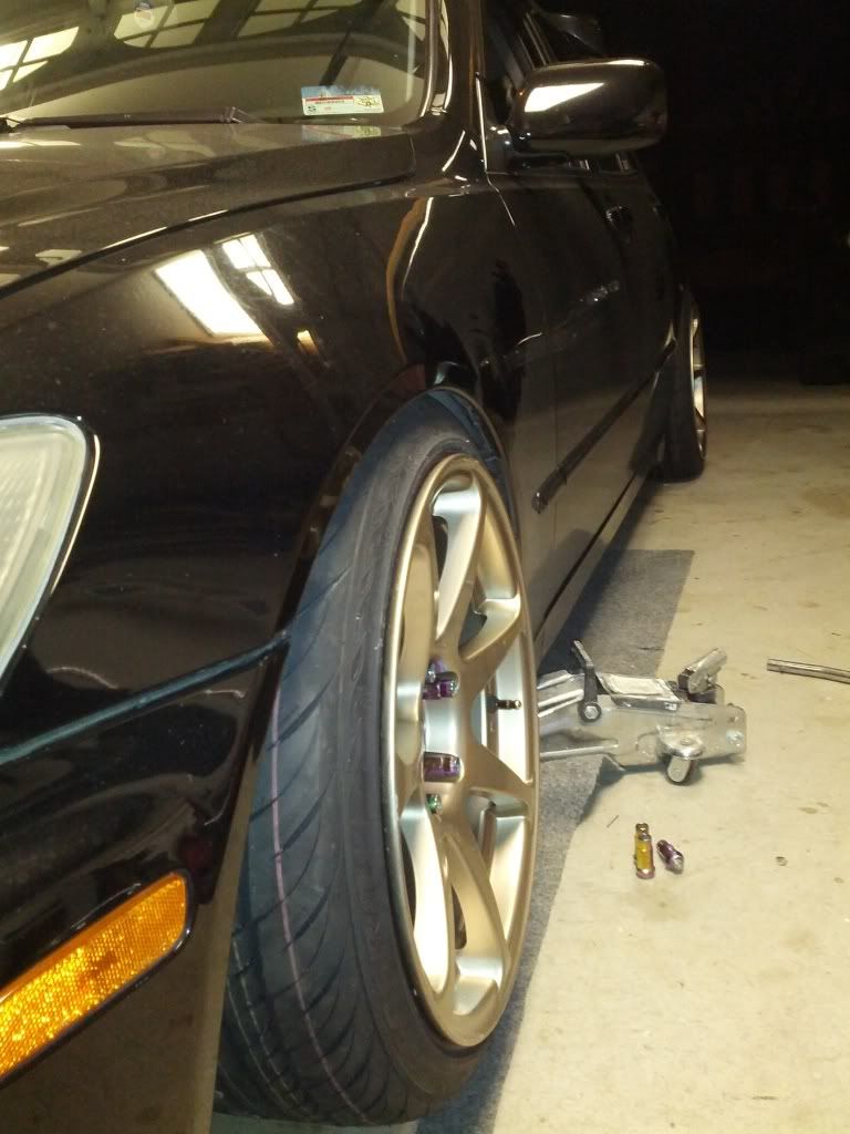

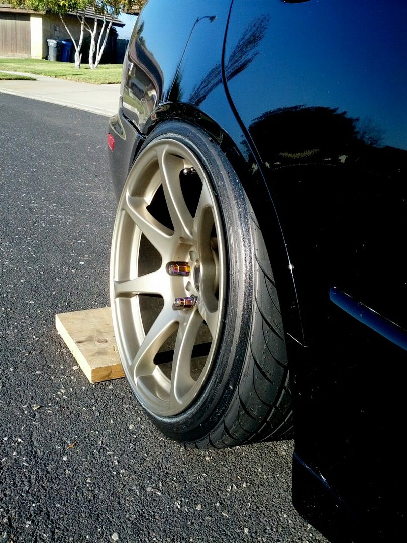

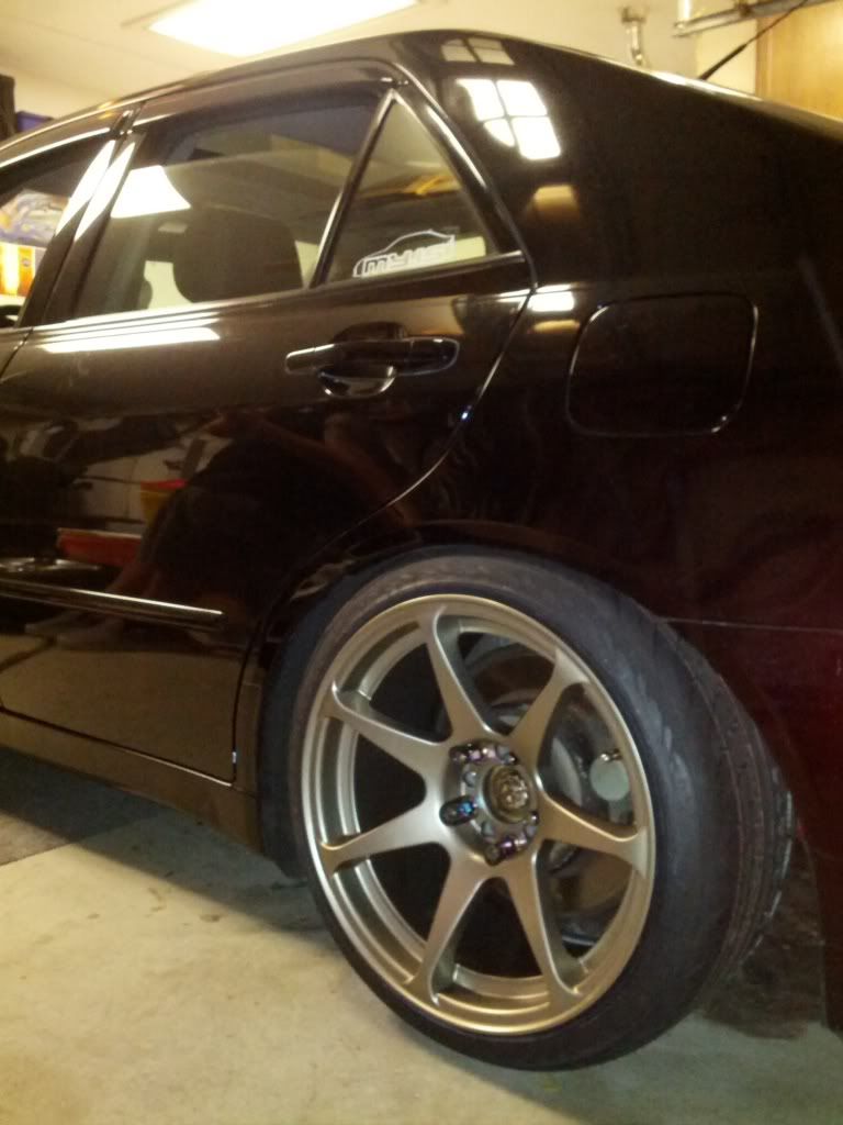

    Tires! Specs are Federal 595Evo's 205/40/17 and 215/40/17. I chose these tires because of how affordable they are, and I've heard a lot of good feedback as far as stretch goes.
    Fronts:
    Rears:
    Leave a comment:

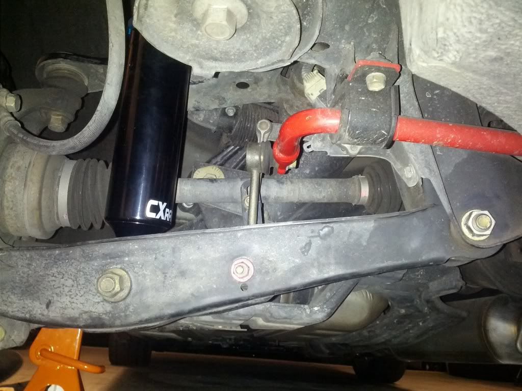

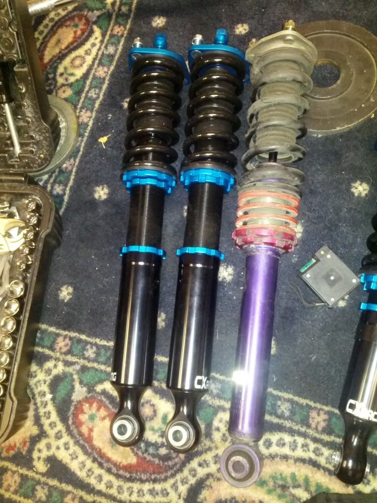

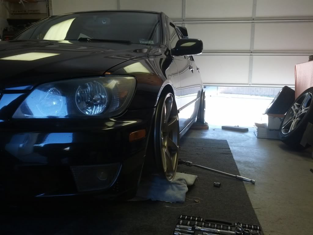

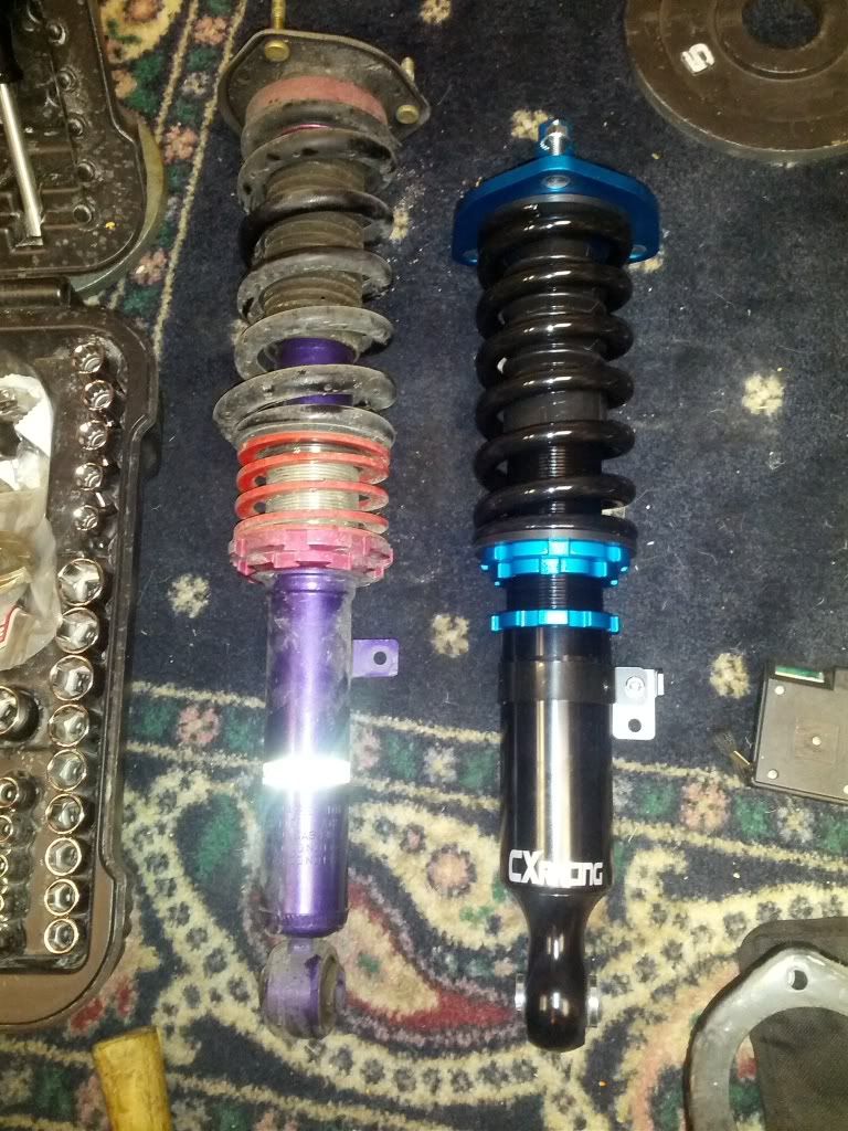

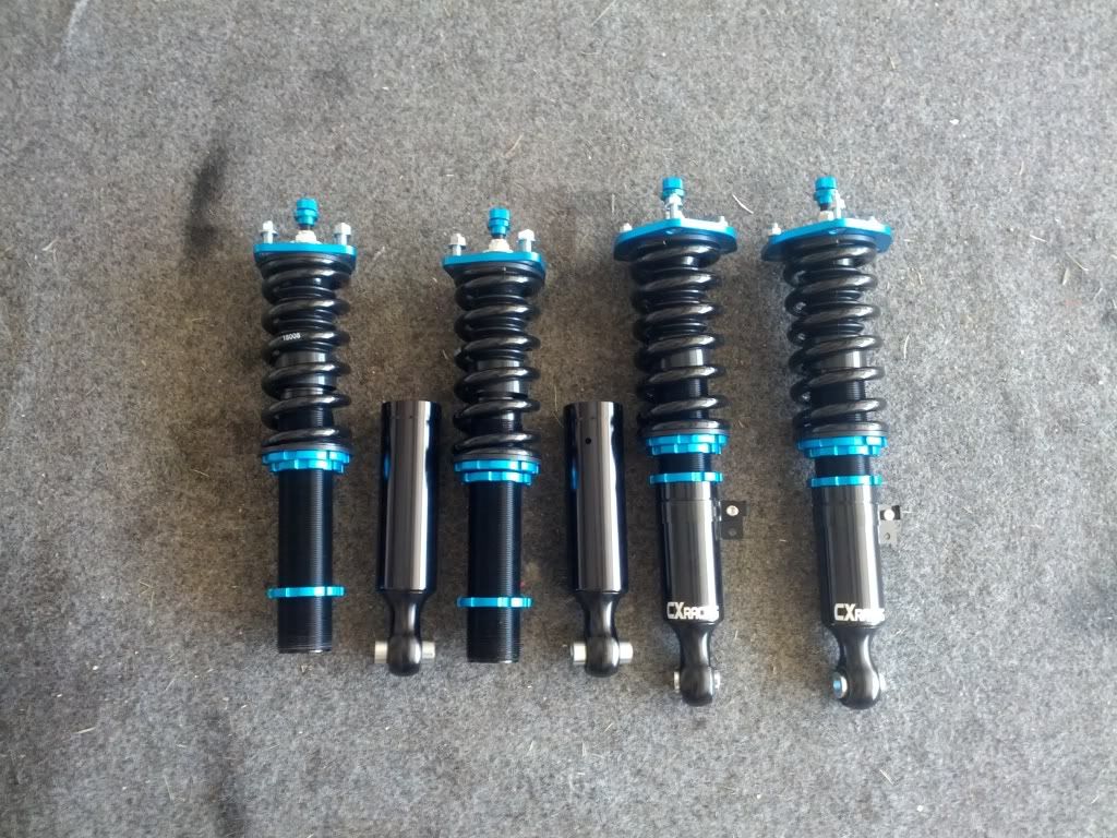

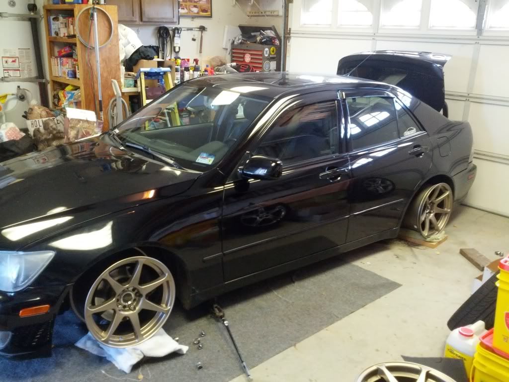

    Then I sold my Tanabe coilovers so I could do this:
    CX Racing coilovers
    Fronts comparison
    Rears comparison
    Some install pics
    When I installed them, I kept the coils at the same height as they were shipped to me, to give me a starting point to begin adjusting the height. Rears were actually really high, but that was my error as I assembled them that way. So we lowered them significantly. Then the fronts...These coils will literally lay frame no problem. There was plenty of room to lower even more and this is how it sat out of the box (the car looks high up, but that's because the front wheels are sitting on 2 blocks of wood lol):
    Adjusted:

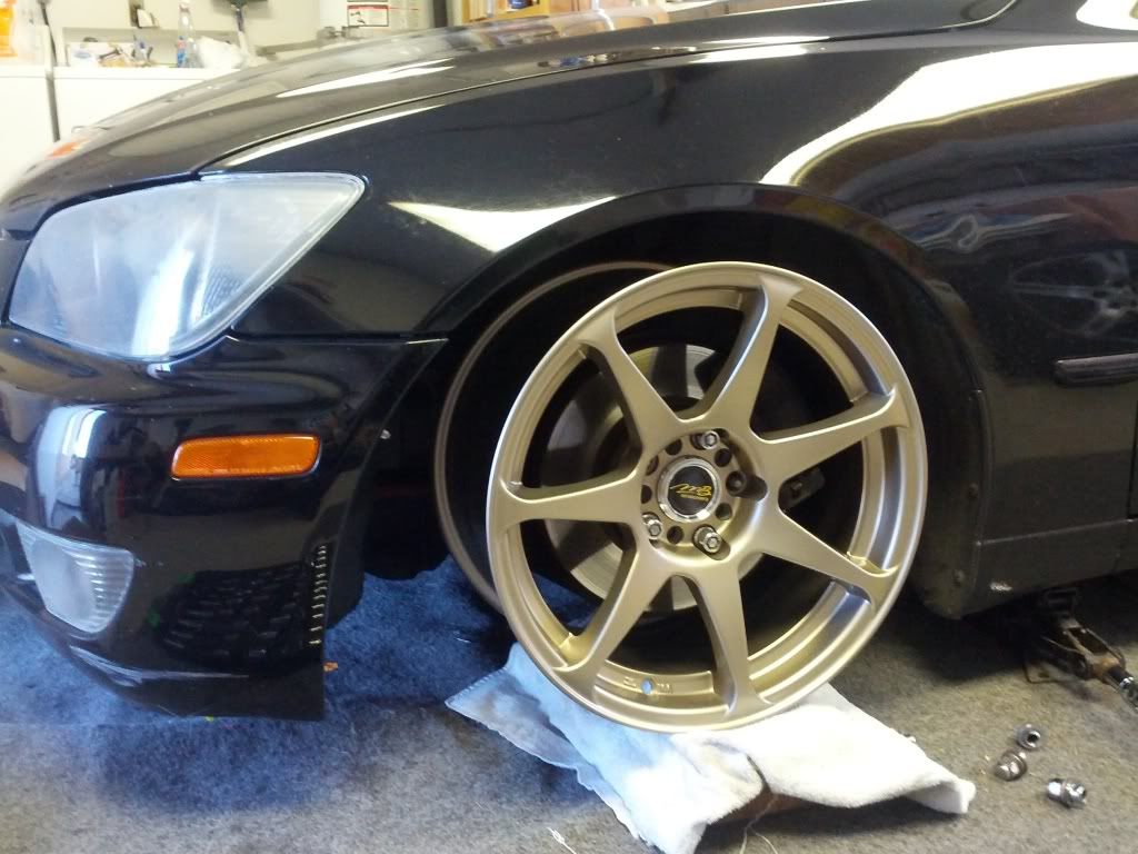

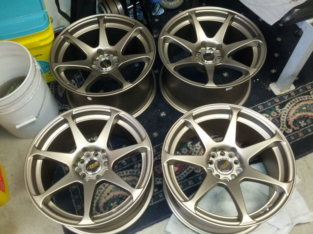

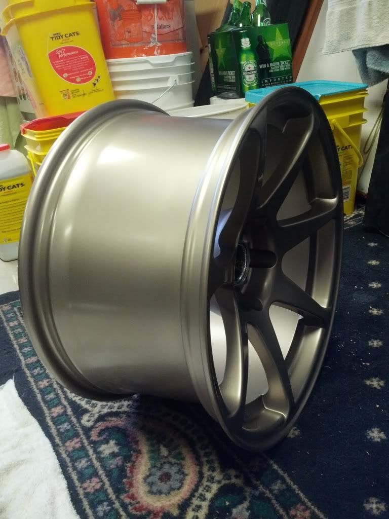

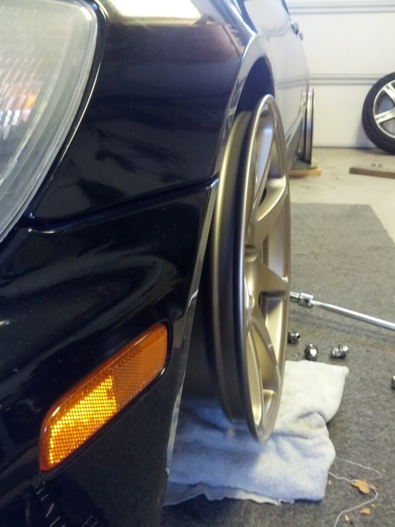

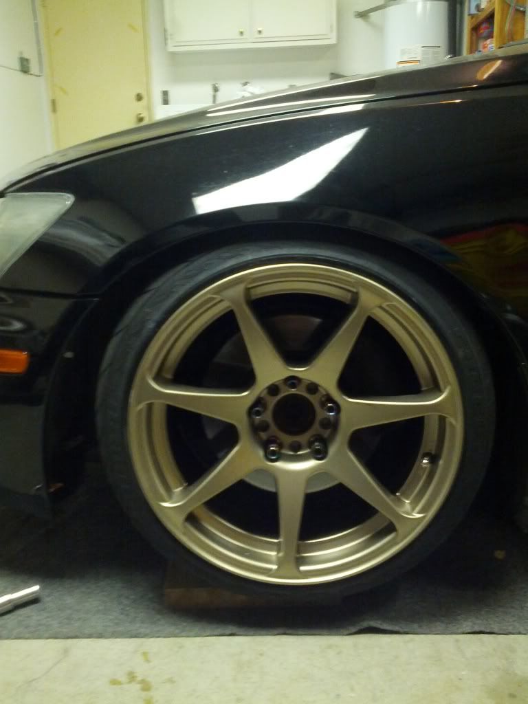

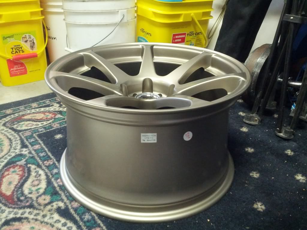

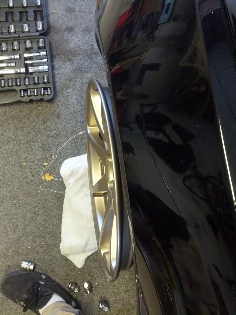

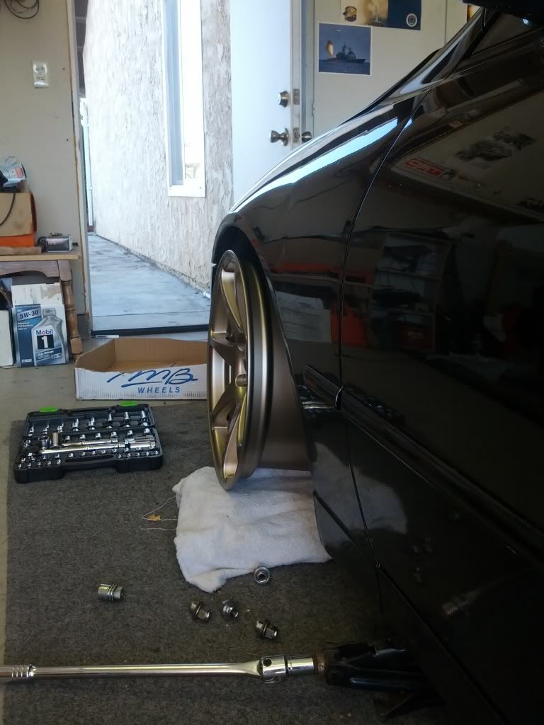

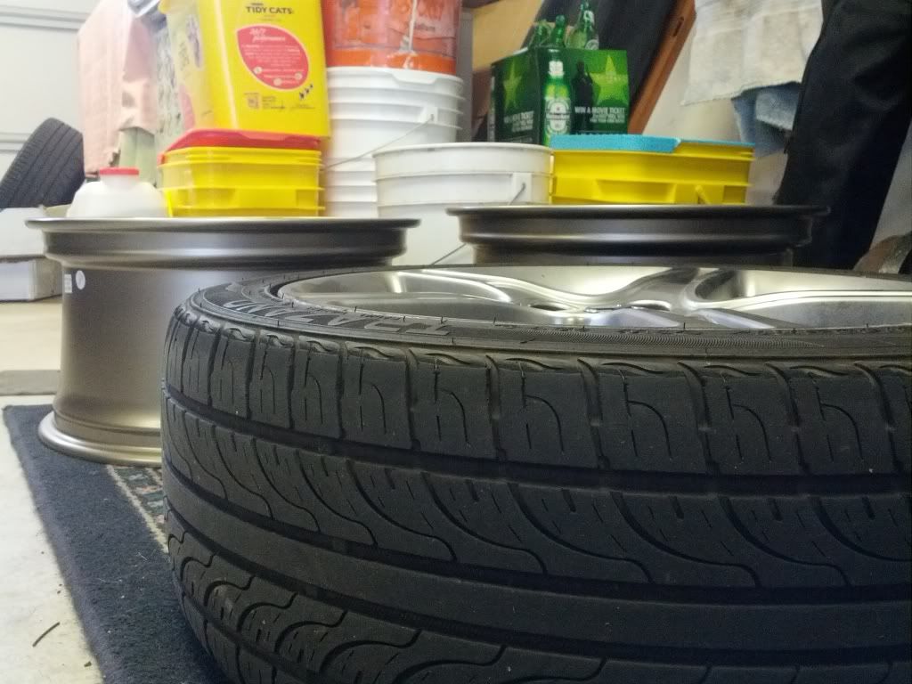

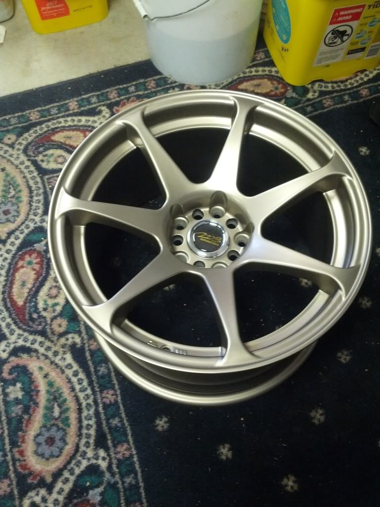

    Then I purchased my first set of wheels: MB Battles (bronze) F:17x9+30 R:17x9.5+15
    Test fit:
    Comparison (stock v battles):

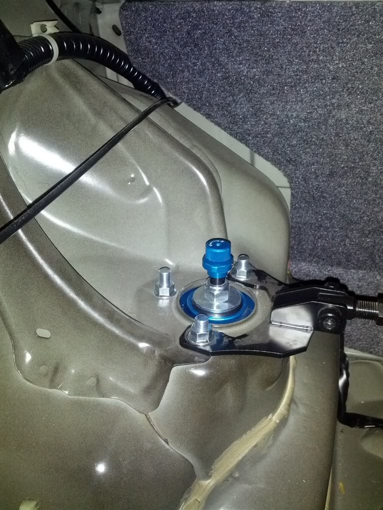

    Same time I also installed the Tanabe rear strut bar. Makes zero difference in performance, but looks pretty cool.
