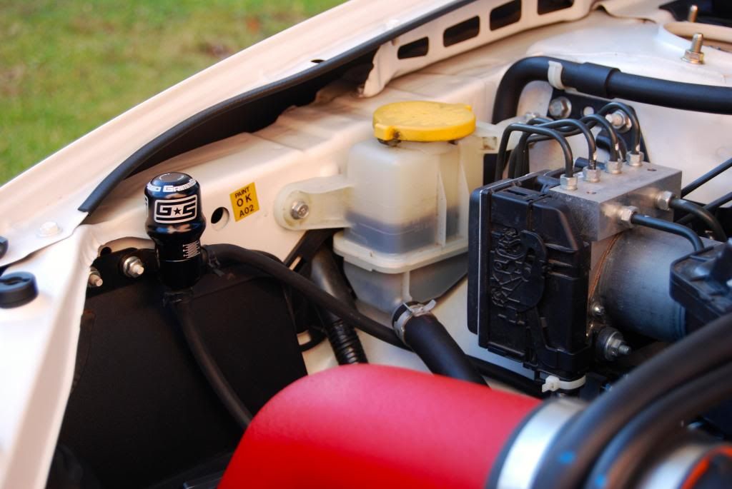

    Turbosmart Kompact Series BPV
    Took her to the track to see how shed do. Not too bad for my first time with this car.
    Also upgraded to an AEM cold air intake around this time. Heres a shot of how the bay was looking.

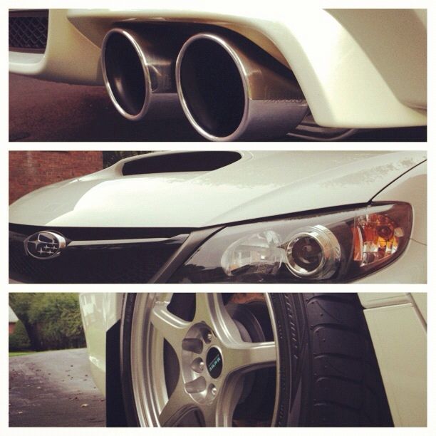

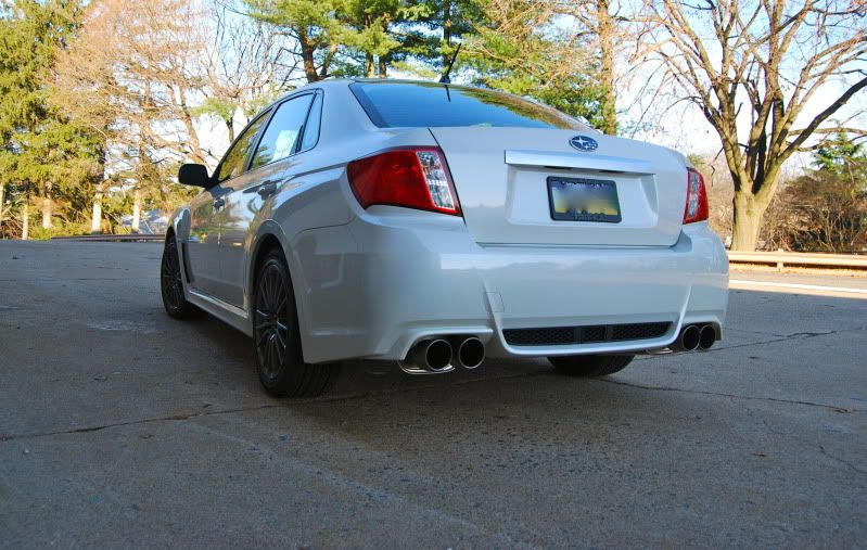

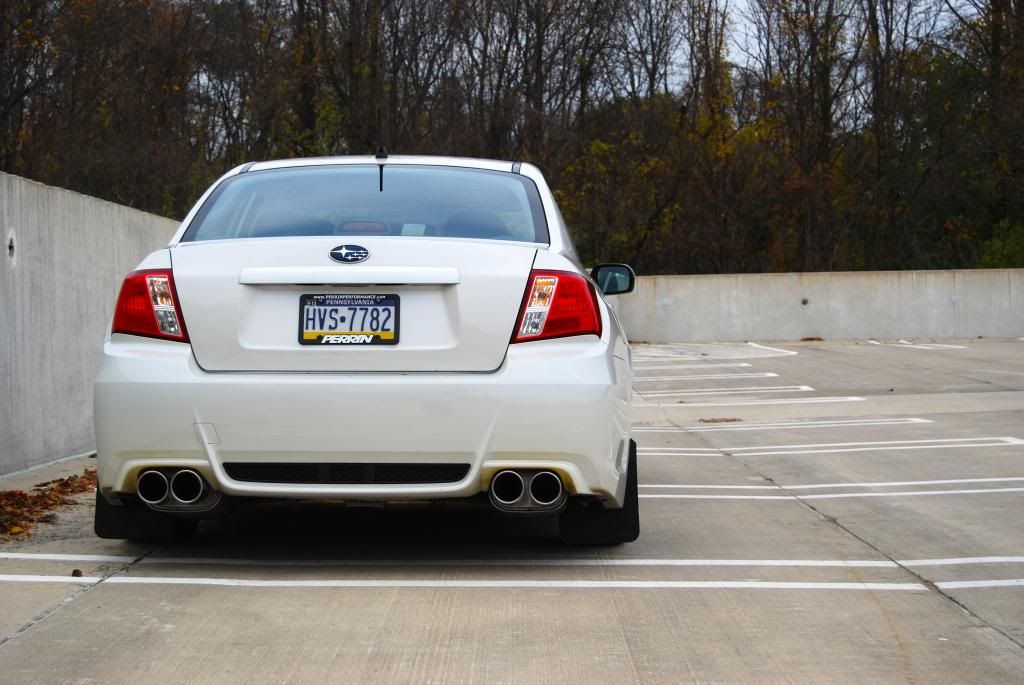

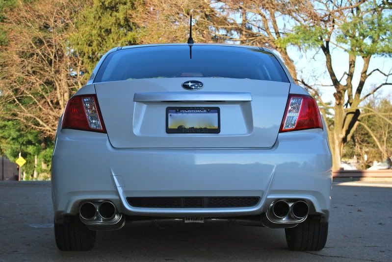

    Got tired of being quiet so i splurged on an Invidia Q300 quad tip catback. Arguably the best looking and sounding exhaust so it was an easy choice in my mind. Also debadged the rear at some point.

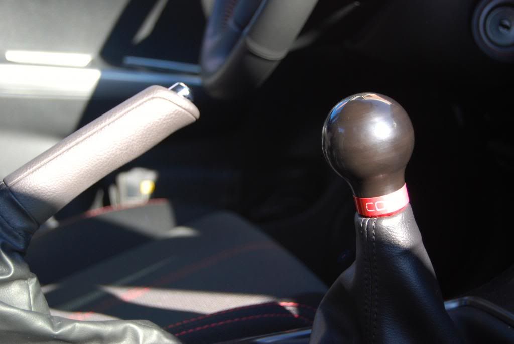

    Cobb Shift Knob

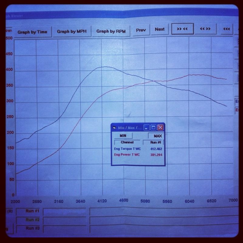

    So this is where things get fun. I was sitting at about 300awhp and though it was fun i wanted a little more. I had a 2011 Honda Ruckus i built and decided id sell it and fund a turbo upgrade. Took her to R/T tuning for the install and tune (Only thing i didnt do on this car by myself)
    Blouch Dominator 1.5xtr turbo
    Perrin Big Tube uppipe
    DW 850cc injectors
    Also switched my downpipe out for a Invidia catless
    Went and picked the car up about a week later and was beyond happy with the upgrades

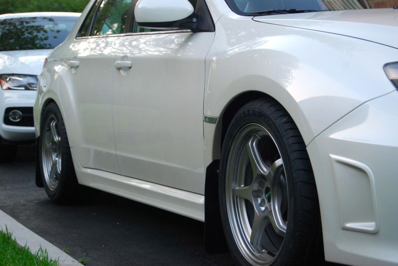

    Specs on the wheels are 17x9 +42 wrapped in 265/40/17 Falken 452s....boring huh? Exactly. Heres some pics though.
    I wasnt super hype on them or anything but it was a look i wanted to try out so that's that. Also notice i threw on some Rally Armor Mudflaps typical subie owner

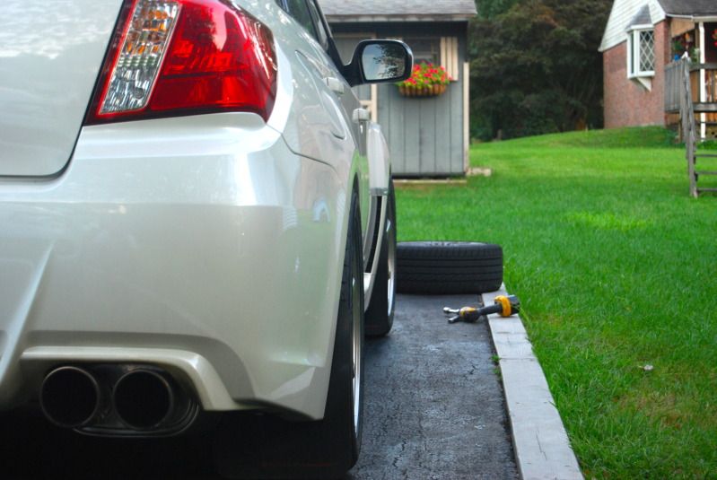

    Last picture with the wheels on as i quckly took them off and sold them. H2o really got me bummed about the direction i was going with the car. It was fun as shit dont get me wrong. I loved getting in it everyday and driving it but i guess i missed the looks and attention all of my other cars got. Not too sound cocky, or self absorbed but anyone who says they dont enjoy people staring at your car as you drive by is lying I decided i wanted to go a little lower as these coilovers werent quite cutting it. I bought a set of BC BR Etreme Low coilovers and sold the set of standard br's.

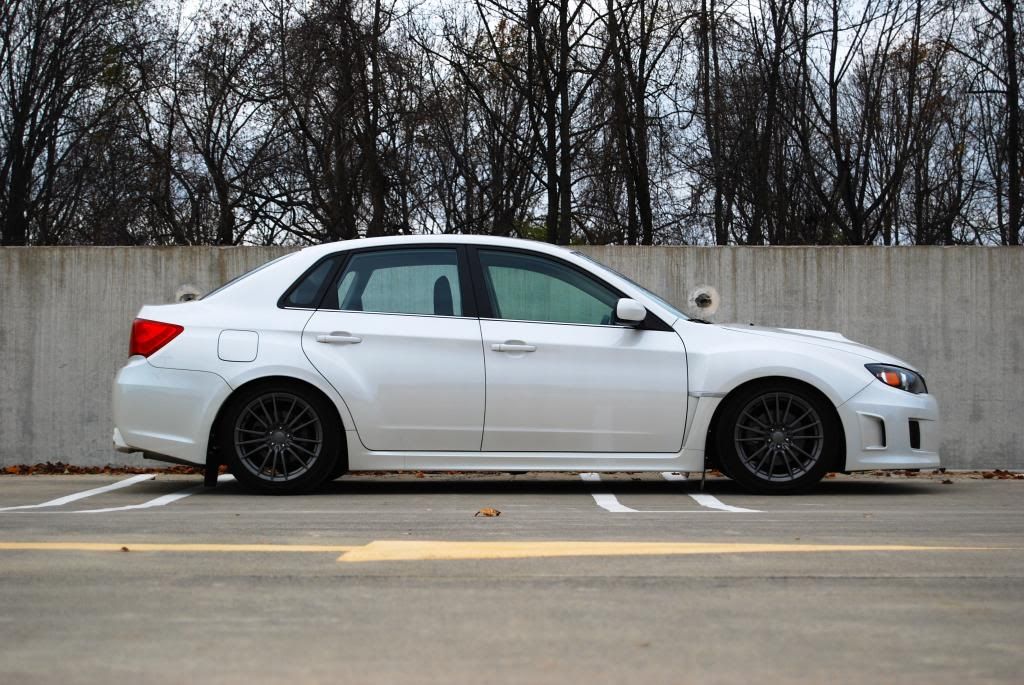

    At this time i stuck my stock wheels back on lowered it down a little bit. Its not all the way down but pretty close ( i know, i know...for coil overs advertiesed as "extreme low" these do not go all that low).
    So thats where im at with the whole stance part of the build...kind of a crossroad.
