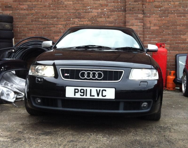

Got there and the car was spot on, nothing I could knock on the price as every problem was listed in the ad.
Water light came on in the daily A4 so stopped to top it up

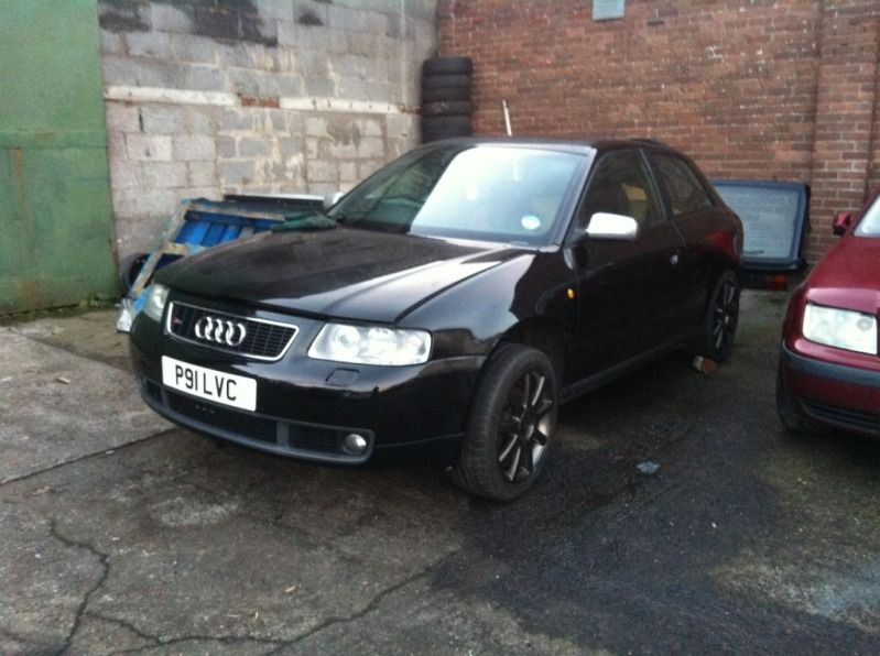

Driving home I noticed more and more about the car, like the fact it had
-S3 front and rear bumpers
-S3 facelift headlights
-S3 exhaust

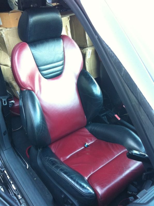

-S3 electric recaro seats in red (wired in and working) and one(?) doorcard
-S3 glovebox
-S3 steering wheel
-S3 gearknob
-S3 headlining and ABC pillars
-S3 mirrors

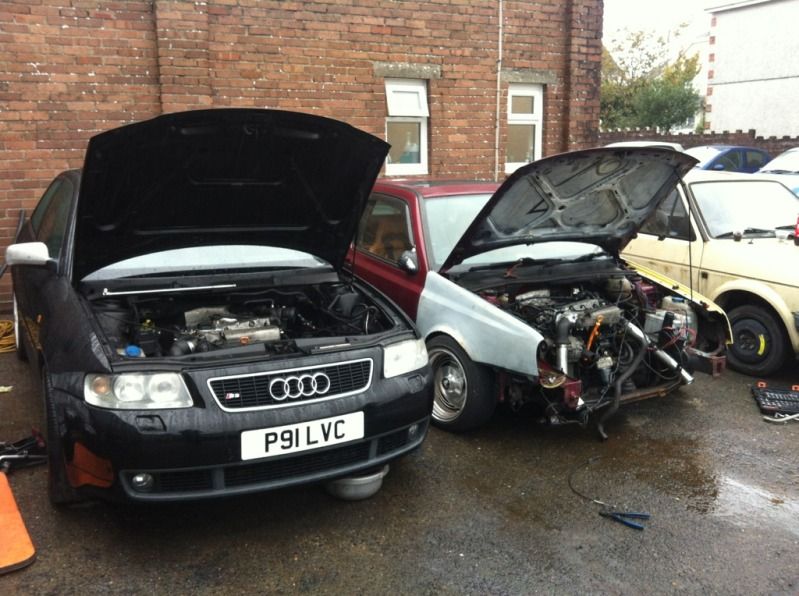

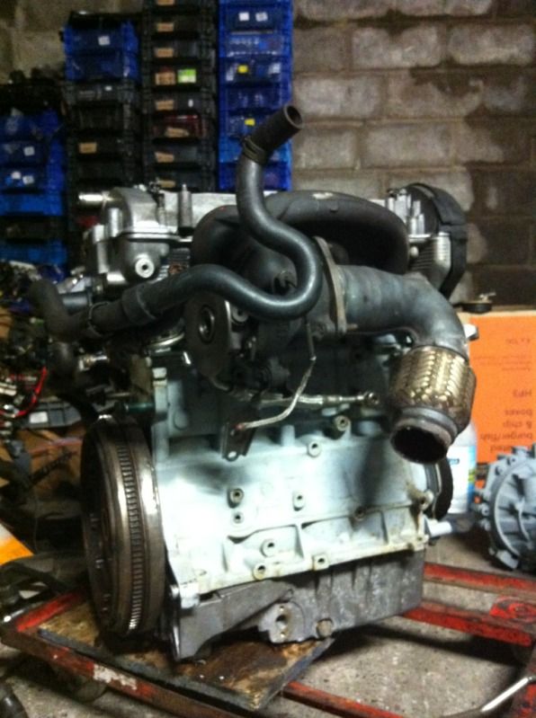

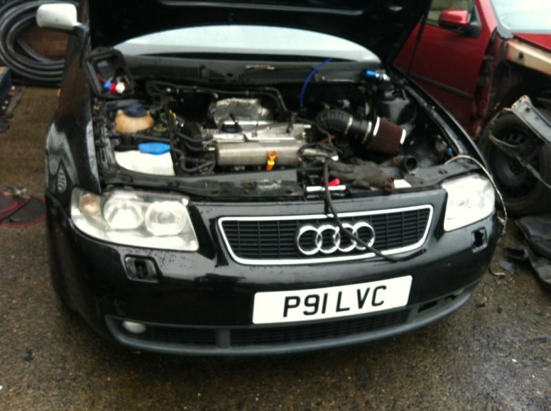

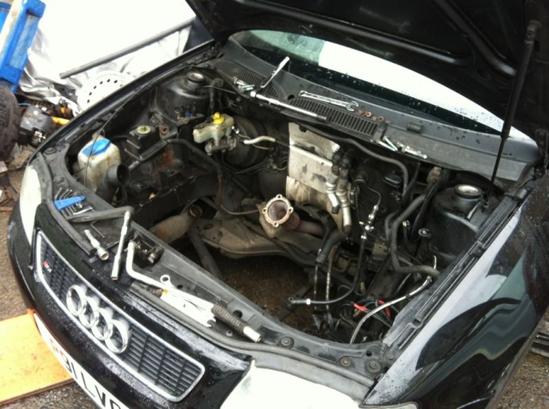

In fairness it drove spot on. Couldnt fault it one bit. So the engine came out
Enough cars?

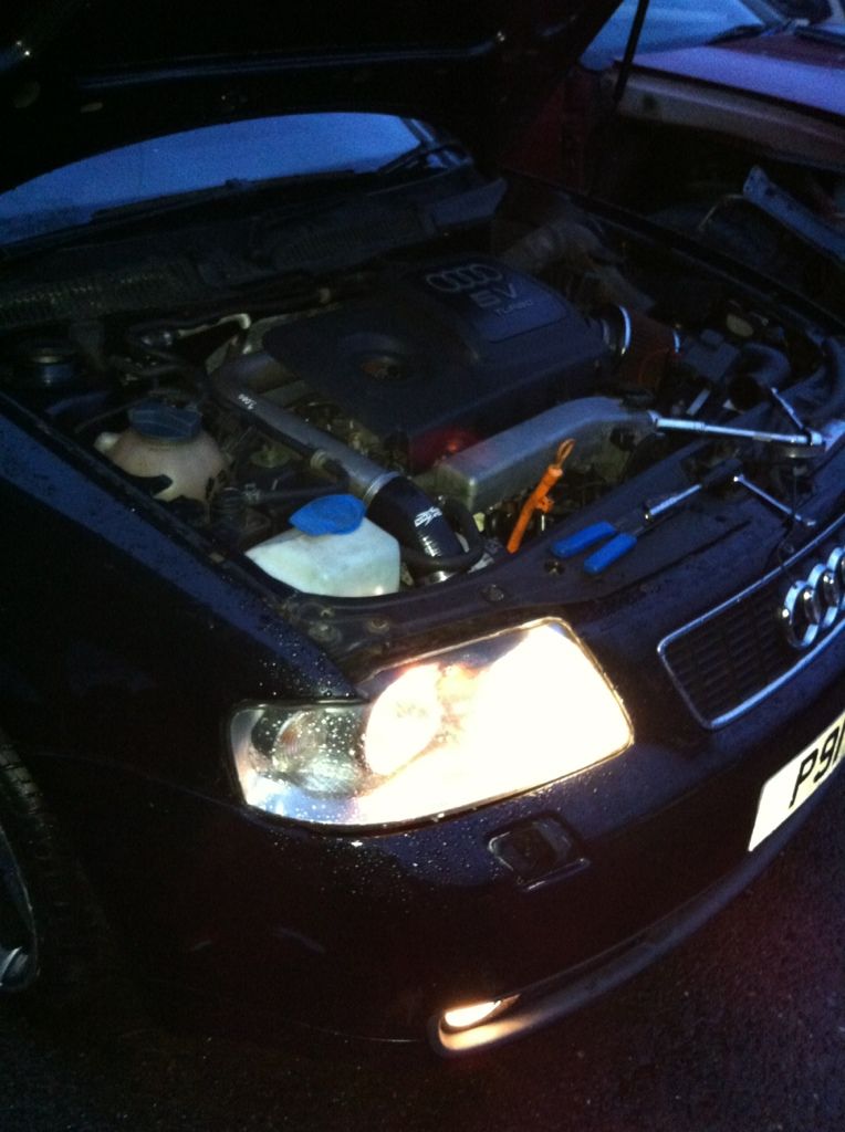

I then decided it was too good to break so I'm putting a freshly built 20V with K04 and remapped APY management in, might sound silly but it should be faster than most S3s without the weight of the 4WD, and owe me a lot less than one once I've sold the AGU management and the bits I'm not using.

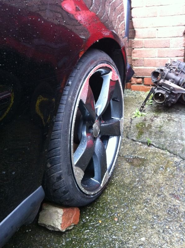

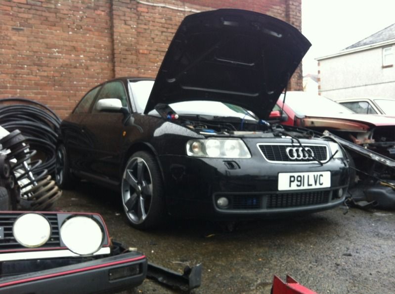

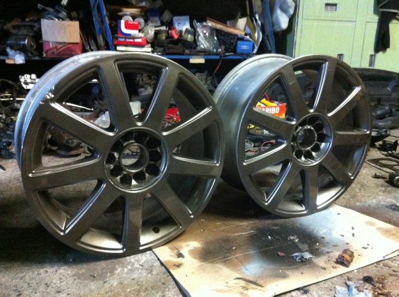

Bought some 17s so I could bin the horrible things on there

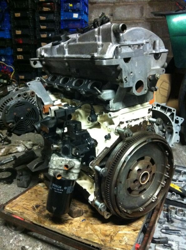

Made a start on the engine work

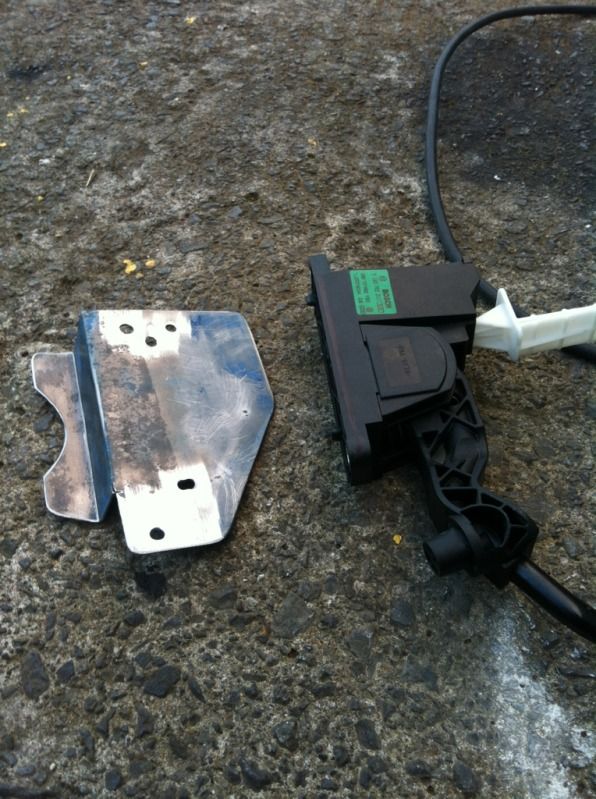

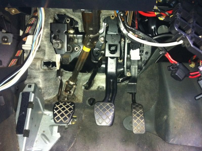

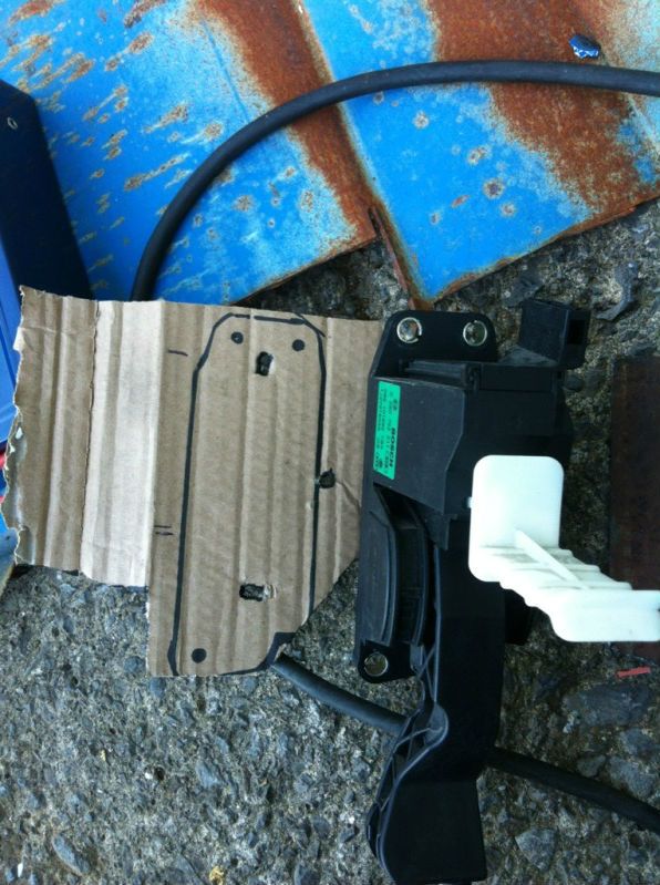

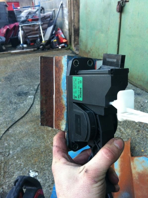

Then as APY is drive by wire and there was no way I was swapping the bulkhead to mount the pedal, I made a bracket out of 2mm steel
Pic with the wheels

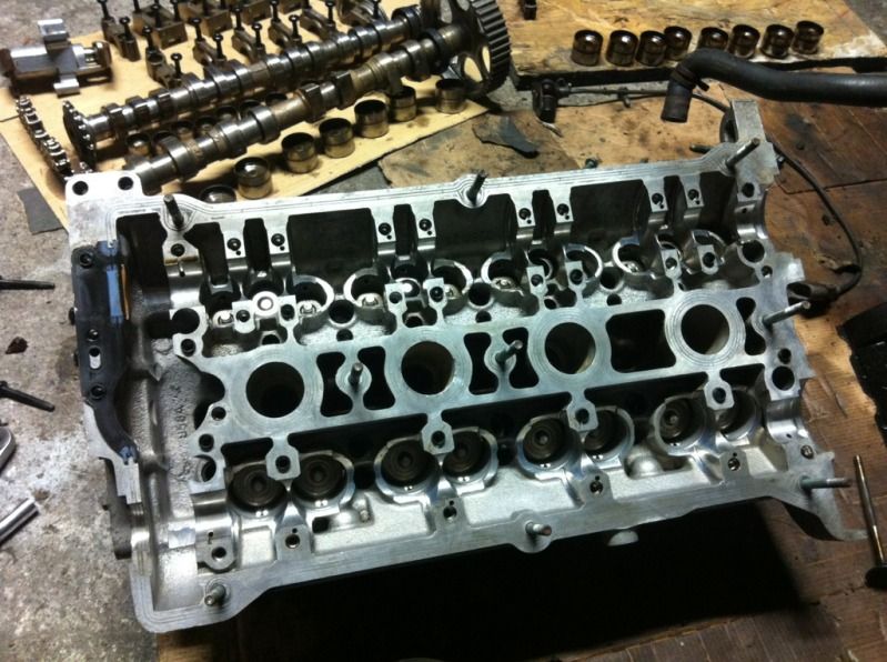

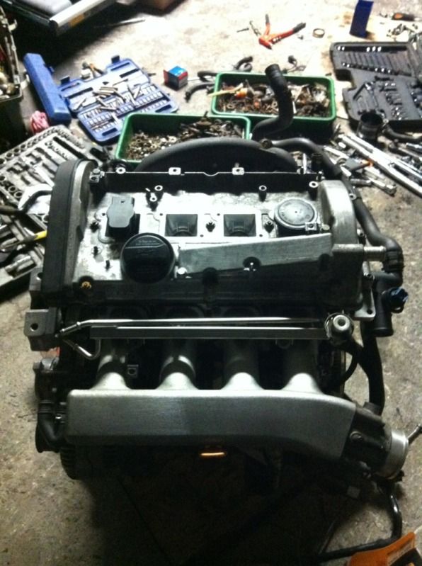

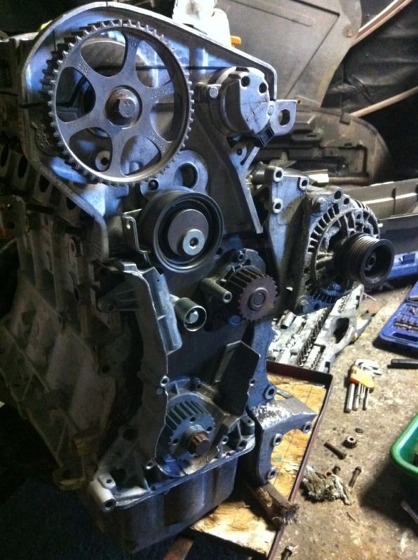

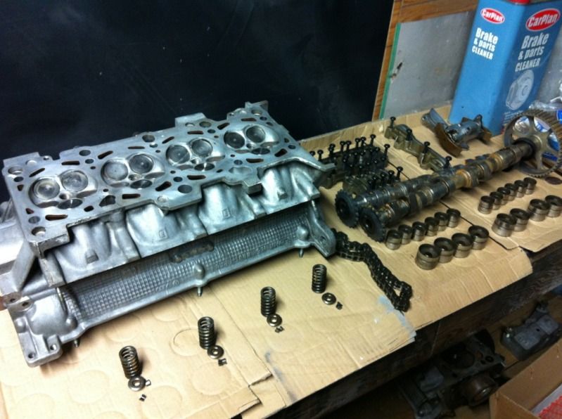

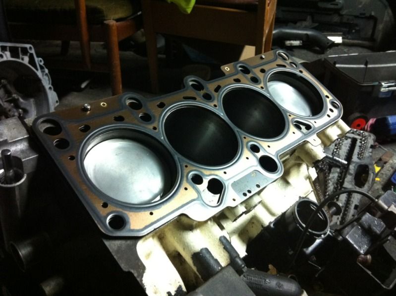

So I finished the head!

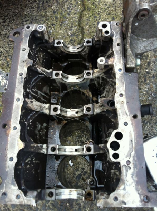

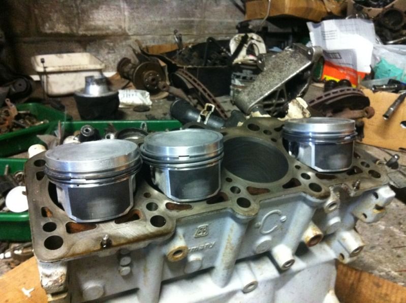

Cleaned up the block and its guts too, need to strip one of the engines outside for a piston as the missing one in this pic has a bit of damage, pinched the oil control ring
Mounted the throttle pedal, feels just about right

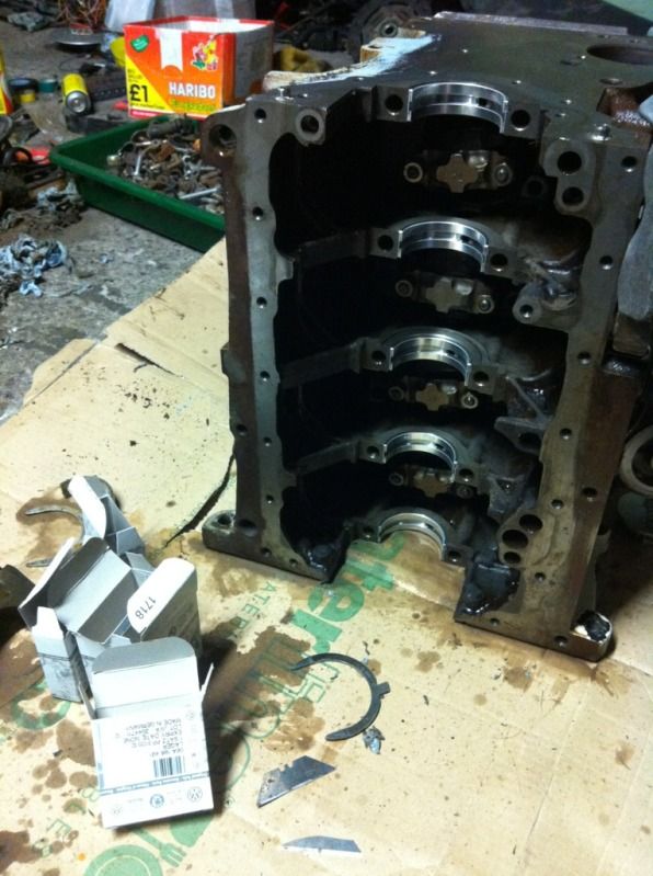

New main bearings bought (genuine) next step is to get the crank in, polished obviously. Had new big ends about 2k ago, checked them and they all seem fine.
Old bearings pretty scored
New genuine ones

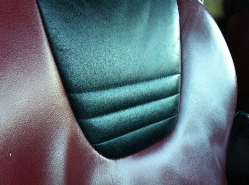

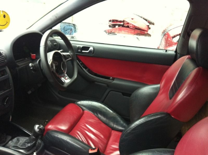

Pics of Recaros...

Further progress shouldnt be too far away, I'm itching to get this on the road as its getting to winter over here and I like the idea of heaters and heated seats :s
-S3 exhaust
-S3 glovebox
-S3 steering wheel
-S3 gearknob
-S3 mirrors
Enough cars?
Pic with the wheels
New genuine ones

Pics of Recaros...
