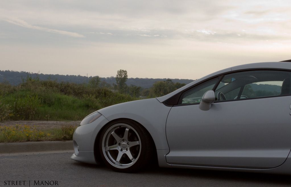

    So I have had my Eclipse for about a good 4 to 5 years now, I was rocking HIDs for about a year and finally decided/had enough money to buy some coilovers after graduating college and saving forever for months to afford coilovers. Anyway this is how she sits currently, she still has caster issues and is shaking when driving from 15-30MPH (so I still need to figure out how to fix this, but I still love her to death; more than my girlfriend.
    Sasha by Daniel Michael, on Flickr
    Stanced by Daniel Michael, on Flickr
    The coilovers are not maxed out, the front can go much lower, the back can maybe drop another inch but thats about it till they are maxed.
    After I fix the alignment issues (caster, camber, and my shaking) I will invest in some tires/rims along with a new pair of headlights, OEM foglights, short throw, weighted shift knob, intake, headers, exhaust.

        FWD? i bet your axels are binding from the angle its at now. i had the same issues with my old cavalier.

            Yes, I think you are right. What did you do to fix the issue? I mean it seems to be a FWD issue so how about every Civic or Golf/GTI shouldn't they have that wobble? what did you do to your Cav. to fix the issue? Sell it?

            So raised the front of the car an inch and adjusted the coil-overs so it is much less stiff and now I can drive down pretty much any road here in Texas without having to slam on my breaks so I don't scrape. Not only did raising the car reduce the wobble while driving by 70% but it also lets me drive down the street of my apartment complex without having people pass me at double the speed I am going or honking at me every time I'm about to drive over a rail-road track or turning down ruff streets in downtown Austin which can be pretty bumpy. All the bumps in the road made my tires rub through the wheel-well. So now everything is fixed except for the bit of wobble still, but I can give gas without getting scared unlike when I was an inch lower.
            I really want to go as low as I was and then some. I need to do a bit more research on this wobble on my 4G Eclipse. Once the wobble is gone I can go as low as my car lets me and figure out how to have the tires not rub on every little bump (could be cause I'm still stock set-up).

                          I've got that issue also, it definitely is a fwd issue and I mostly get vibration when I accelerate. I just ordered some engine spacers, the idea is to lift the engine to try and correct the geometry of the axles that changed from being lowered. Idk if its the same for your car, two totally different manufacturers haha, but hopefully this helps.
                            Let me know if it fixes things.

                              I got the engine spacers installed, made a world of difference with the vibration. Theres almost none now.
