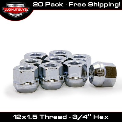

            some lugnuts like these should be good, I think they will be short enough to fit under center caps. Im not sure how much space i will have for lug nuts under centercaps, but I would like locking nuts, not sure if they will fit though
            I want to run at least one set of locking lug nuts, hopefully 2 different ones for protection because I wont want my wheels to be taken after i finish them
