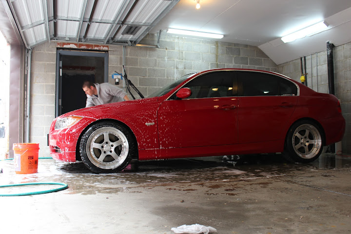

Finally a chance to improve the looks of the front end and add additional cooling capacity. The BMW Performance Bumper was purchased along with Performance Aero Pack for 335i.
This is how the car sits today:
