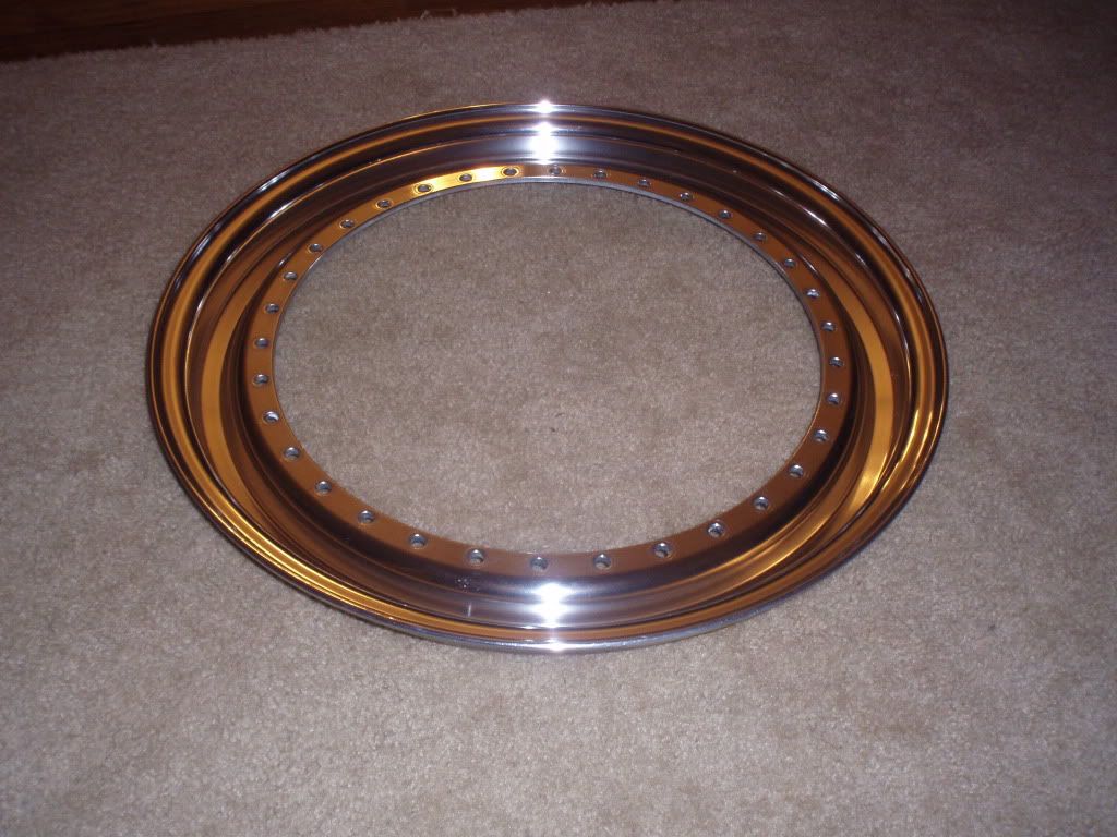

Trying to polish my lips but it's not going so well so far. I was trying to avoid using aircraft stripper as I think I am already past the clear, but it's still not looking so hot. I posted this is in the polishing DIY thread, but when sanding for polishing do all of my motions need to be in the same direction? It seemed like I was getting some major imperfections where my hand was changing directions when using 320 grit.
Use the aircraft stripper. Even if your past the clear, it shouldn't hurt the lip. You'll know as soon as you apply the first coat of stripper if you still have clear on it or not. For the sanding, don't do small circles, go with the rim. I went left, moved back a little, left, moved back a little, left, ect... (if that makes any sense at all haha). Your starting low, so the higher grit you go the more those imperfections will disappear.Originally posted by cardoza View PostTrying to polish my lips but it's not going so well so far. I was trying to avoid using aircraft stripper as I think I am already past the clear, but it's still not looking so hot. I posted this is in the polishing DIY thread, but when sanding for polishing do all of my motions need to be in the same direction? It seemed like I was getting some major imperfections where my hand was changing directions when using 320 grit.
-Dan
There's your issue.Originally posted by cardoza View PostI posted this is in the polishing DIY thread, but when sanding for polishing do all of my motions need to be in the same direction? It seemed like I was getting some major imperfections where my hand was changing directions when using 320 grit.
As stated above me, the higher grit you use, the more they will disappear. If you've done the stages "right" by the time you get around to using 1000 you should begin to notice a slight shine. (more elbow grease = more shine/longevity)
Typically, i step it up gradually to 2000 grit and finish the job with some nice polish. Use an orbital buffer with a new mitt if you have access to one.
