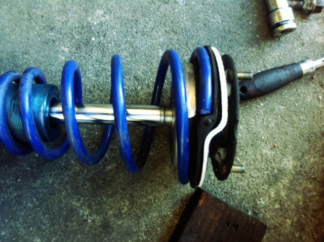

              Then i got my front apart! I had some e90 top hats that were about 45 bucks at my local BMW dealer. Those will get you a extra 10-13mm lower... Great buy for a little extra drop!
              Here they are installed! They are deeper then the stock e30 ones so the spring sits up a little closer. PS not much travel left here...
              I left the spring pads in so it gave me just around a 10mm drop that i am much happy with right now lol
