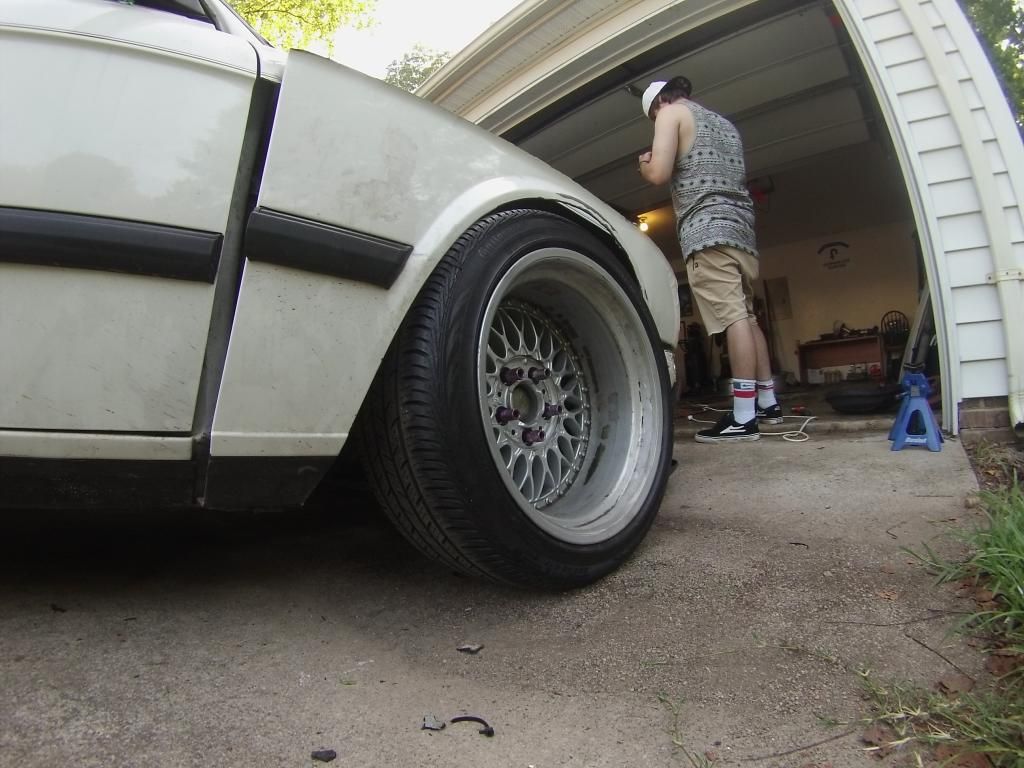

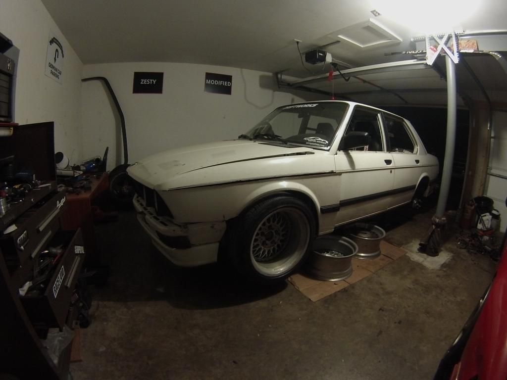

      and she's back on the ground and ready to drive, just need to sort out the tune.

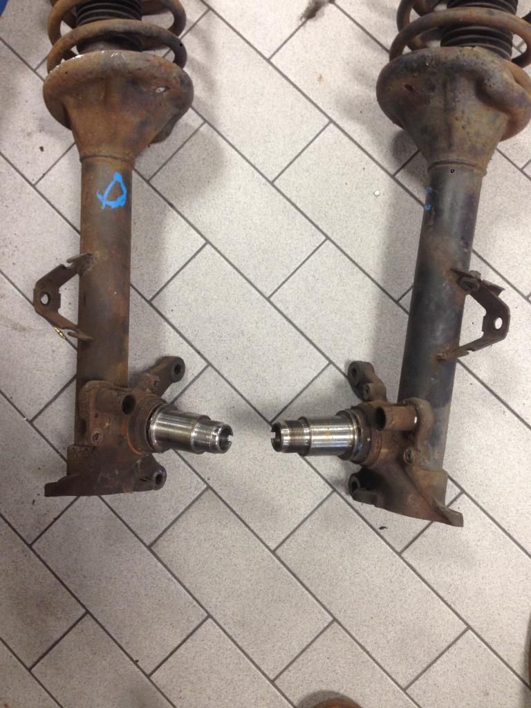

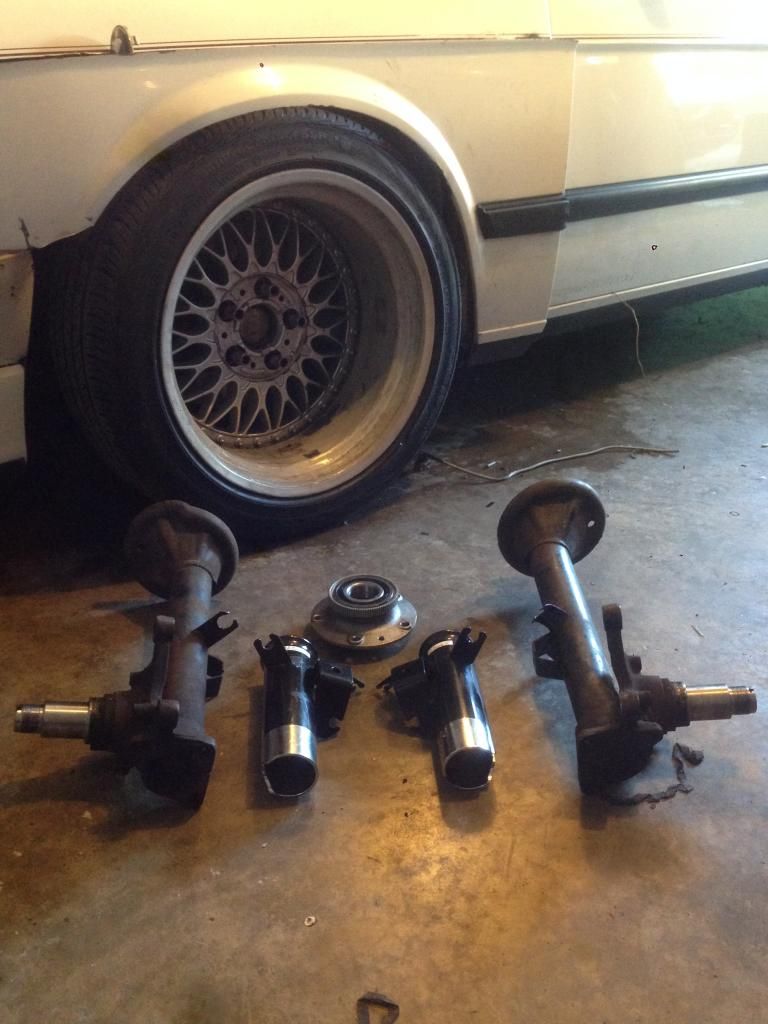

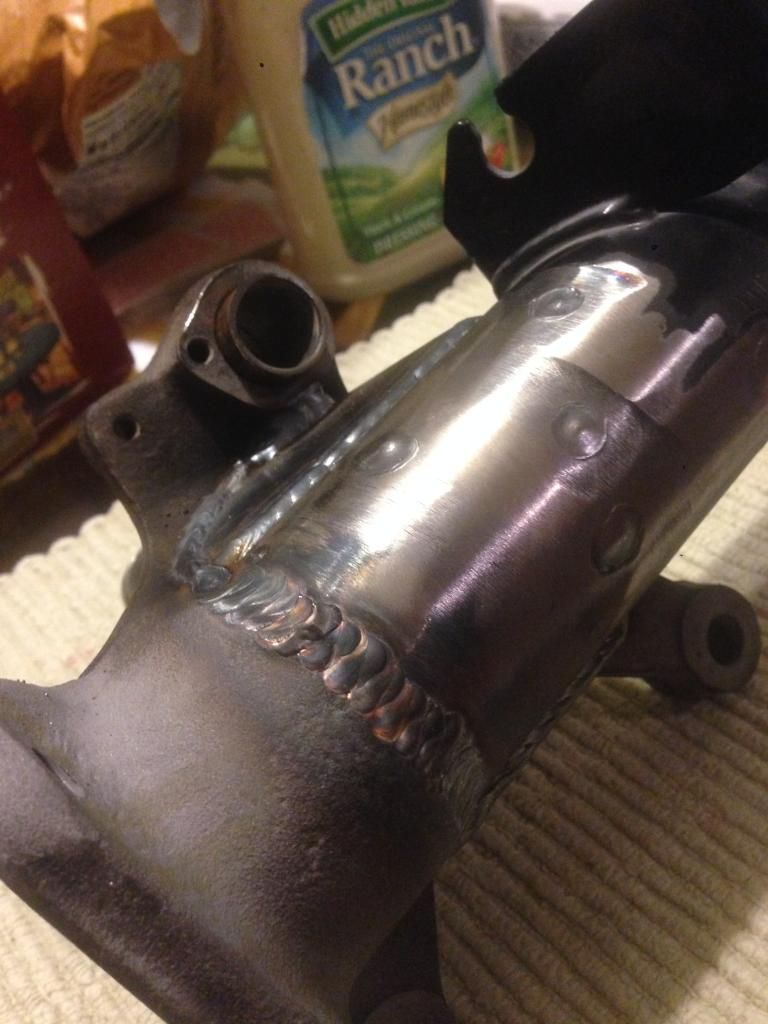

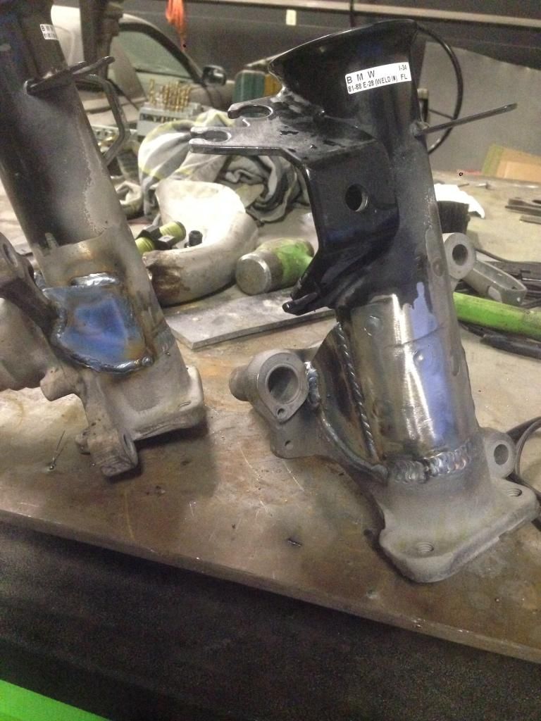

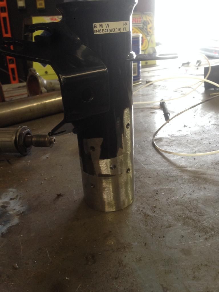

        • I finally fixed my contorted and mostly broken lower strut mounts this week. I've been through hell with these and BC. They've snapped on my multiple times on track. Now hopefully I won't have that issue. I also hopefully won't have to deal with BC. I don't think they like me much anymore.
          Got these for $40 for both. Some jackass on NCE30 tried to say just the strut tube/ spindles were worth $160..... yeah right.

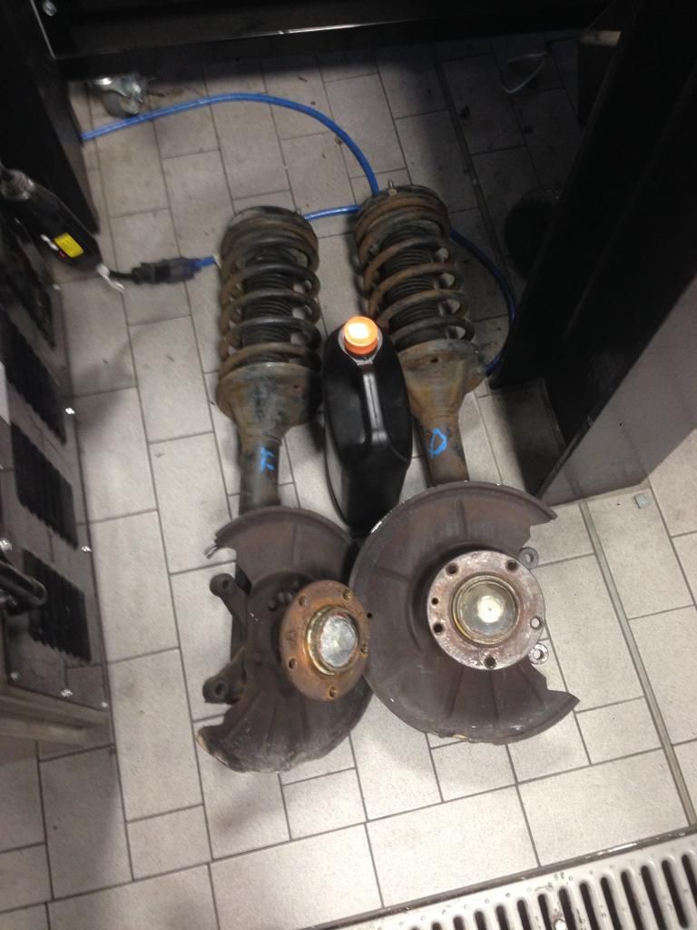

          Stripped them down

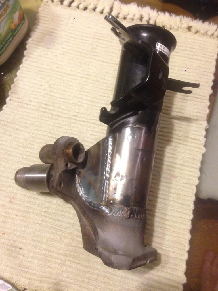

          Took them to my friends shop. I figured I should let a professional do them this time. He started out with some holes for some rosette welds.
          TIG'd the bottoms and filled the holes
          Then he MIG'd braces on to the sides. The results made the mounts heavier in the end but I don't think they'll be breaking any time soon.

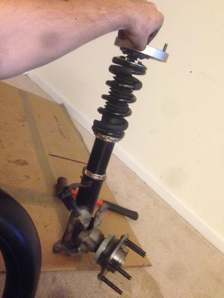

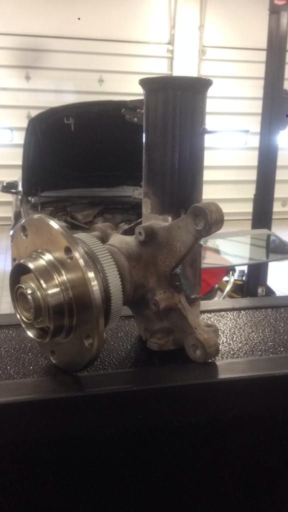

          New wheel bearings (china special) $30 shipped lol
          Ready to roll. Love my stud conversion. Probably one of the best mods on the car.

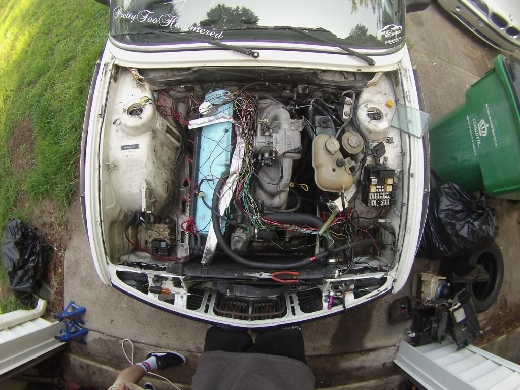

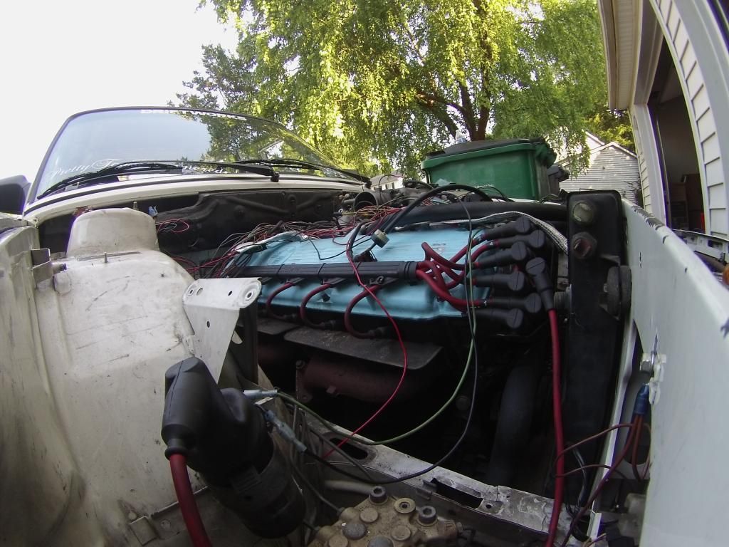

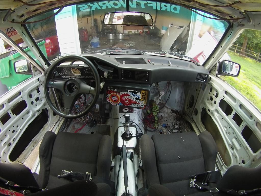

                            Basically, Sunday morning I got super pissed off at how many wires were sitting in my floor board. So naturally I ripped every single wire out of the car. I decided to rewire the whole damn thing because I can't justify having 2 million wire just to run the engine and some lights.
                            All wires removed
                            No more stupid ass fuse box.
                            What the engine bay looked like before
                            All cleaned up. I literally did all of this in one day and on top of that, I wired my roomates 240's gauge panel and fans in.
                            Pulled the dash and started organizing and shortening the MS2 harness. That's almost done.
