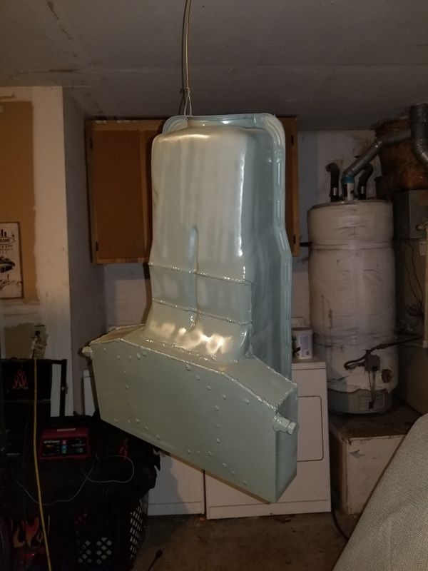

  • Life has been in the way but progress never stopped. I don't have any pics of the rear on this phone but I'll make an update for the front. Basically it now has a 240sx front subframe, 240 knuckles and everything else is custom, I fabricated the control arms and all the mounts. I custom built an oil pan with trap doors and baffles to fit around the subframe and suspension.
