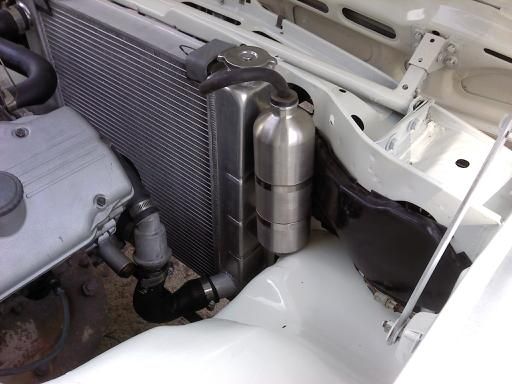

              • The stock radiator didn't have an expansion tank, but it turns out the new one requires it. When it was getting up to temp, it would spit a little bit out of the fitting. So I made one. I think it looks pretty good in there.

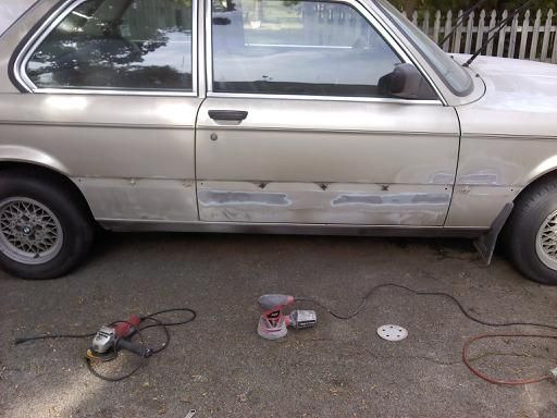

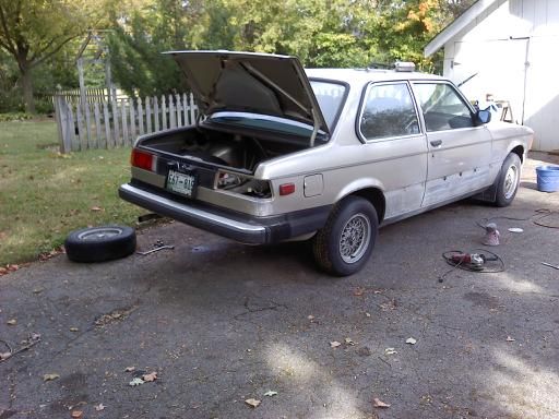

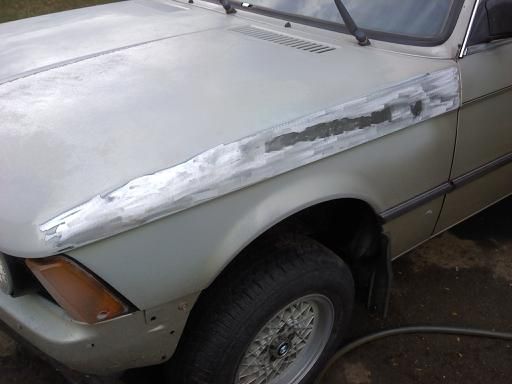

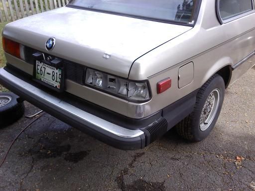

                Then I got a little crazy and decided to just start the bodywork. Might as well paint it before it's cold out. Knocked out any dents I could get to from the back. The car also had a couple big creases that I just had to fill. They're still fairly shallow, and I took everything down to bare metal, so it shouldn't be an issue.
                "Fixed" a rust hole in the trunk. I'll go back and weld in a patch later on, but for now this will at least keep water from getting in and making it worse.
                I did more, but forgot to take more pictures. I primed everything up and will hopefully get it close to finished by Thursday.
