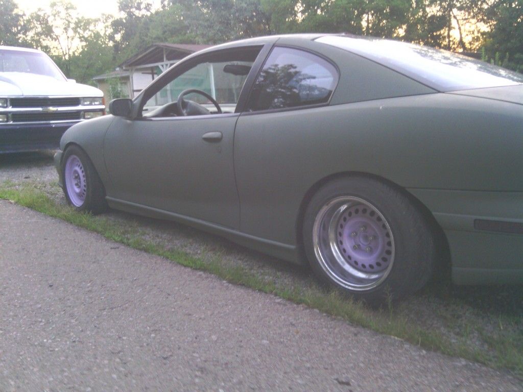

    I went with 15mm backspacing on my 15x10 steelies I think it worked out to a +13 offset. The fit was right where I wanted it on the sunvalier. I still need to find some 15x8 or 9 for the front. Here is a crappy cell phone pic of mine to maybe motivate you to get yours done.

      Holy snap! You know how long I've been waiting for you to either, chime in here, or update your thread? The whole reason I'm going this route is because I saw yours and absolutely loved how it looked.
      Got any advice for welding the wheels together? I've got faith that, between my brother, dad, and me, we'll be able to do it, but I'd love to know exactly what you did to get it to work.

        I'm happy to be seeing these cavaliers getting in the game. I thought I was crazy when I started with my sunfire. I don't think it will ever catch on with most of the Jbody guys though. haha.
        The faces will be a tight fit in the barrels, so you will have to beat them in with a hammer. I measured to find how much backspacing I needed and got that as close a I could with a ruler. Then I mounted a dial indicator on the shock and just kept spinning and pounding until it was really close to perfect. Oh and measure from one of the inside lips and not the outside lip because with used wheels chances are the outside lip will be bent slightly. You should get the in-out movement below .045" but as close to .000 as possible. I tacked mine together and took them to the tire shop to make sure the wheels would balance before I finished welding them just in case I needed to fix something. I think I got mine to within .030" and I have no wobble or vibrations from them. The best advise I can give you is to take your time and make sure you get them right before you start welding.

          I know what you means about the jbody guys... they usually take a while to accept certain styles, haha.
          That's really good advice!! I'll have to tell my brother and see how he feels about it.
          Where did you get your barrels from? I'm using a set of Ford wheels and the inner diameter (for the face) is a bit bigger than the cavalier faces. I have to fab up an extra ring to be able to get them to work... I have no problem doing it this way, it's just an unexpected hurdle I have to get over.
          Again, thanks for the advice, I'm sure I'll end up putting it to good use.
