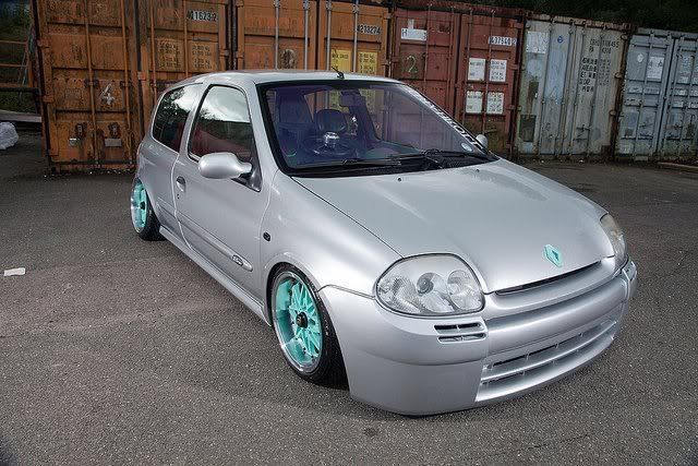

    anyway used to have a bagged clio 172 which i stripped for parts and sold shortly after a mag feature

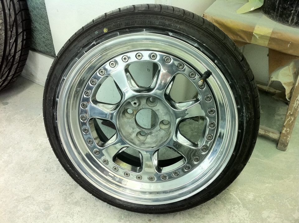

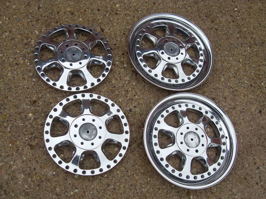

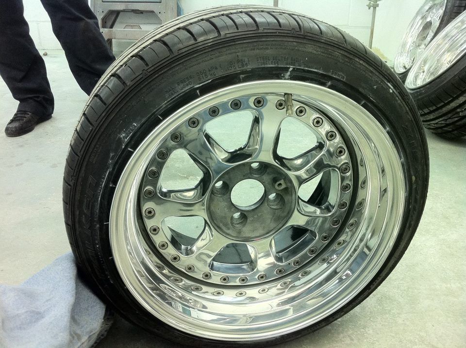

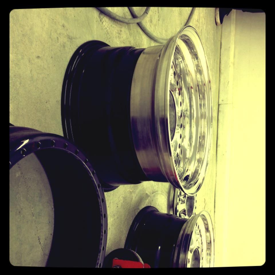

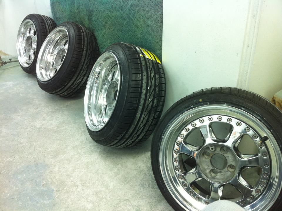

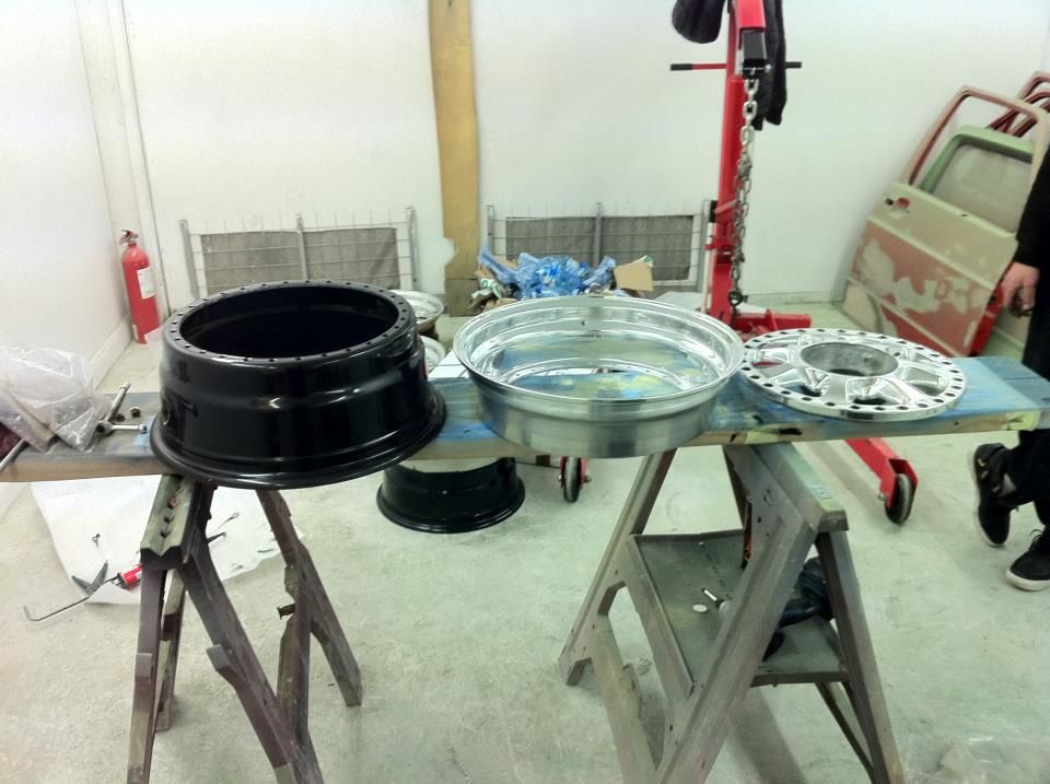

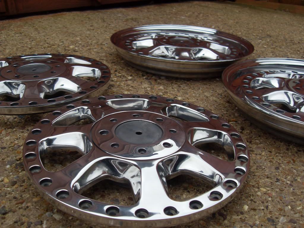

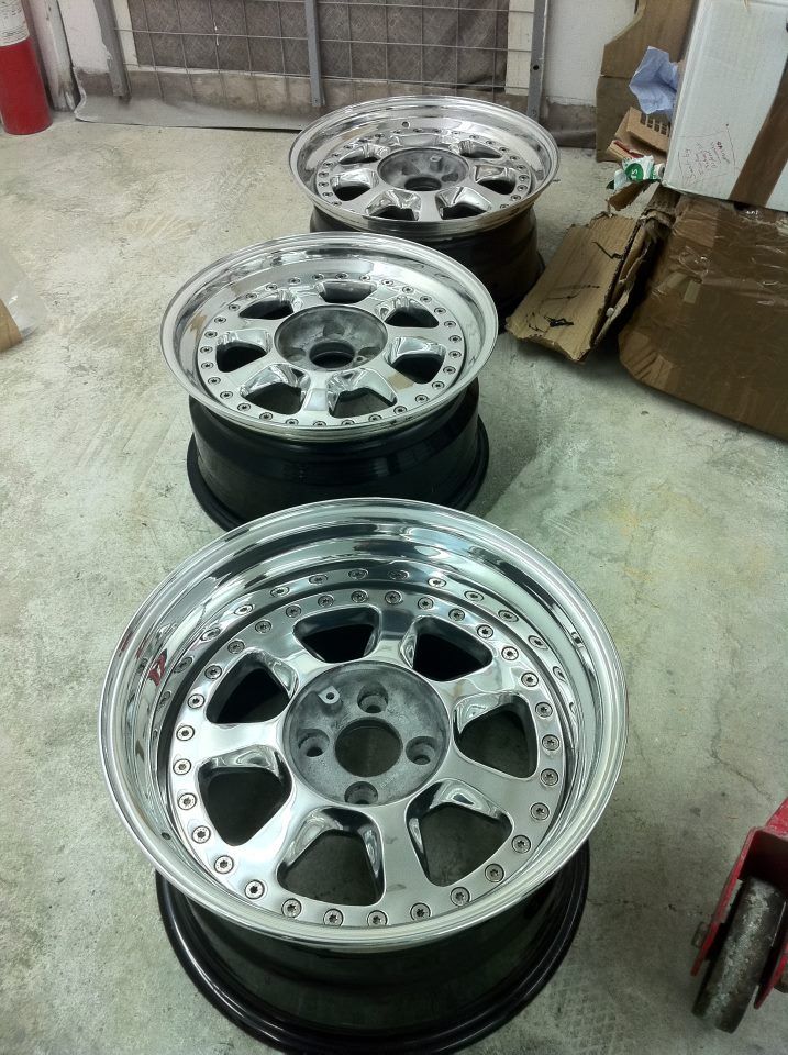

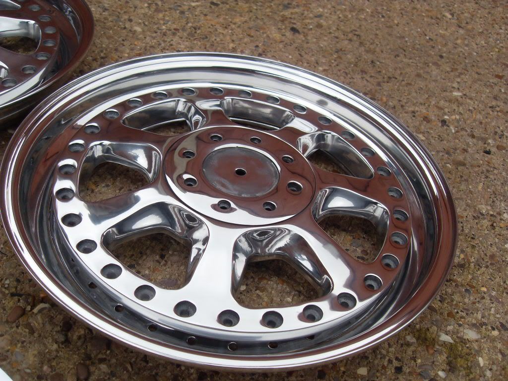

    i found a set of ACT sx 3 piece splits which were in quite bad condition and decided to fully refurb and rebuild them. fully mirror polished and custom made 4" dishes for the rear. fronts are 8j and rears are 10j with the new dishes.

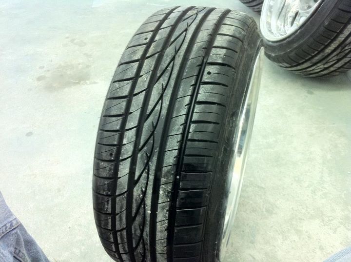

    got tyres on
    fronts - 195/40 on 8j
    rears - 225/40 on 10j
    all together

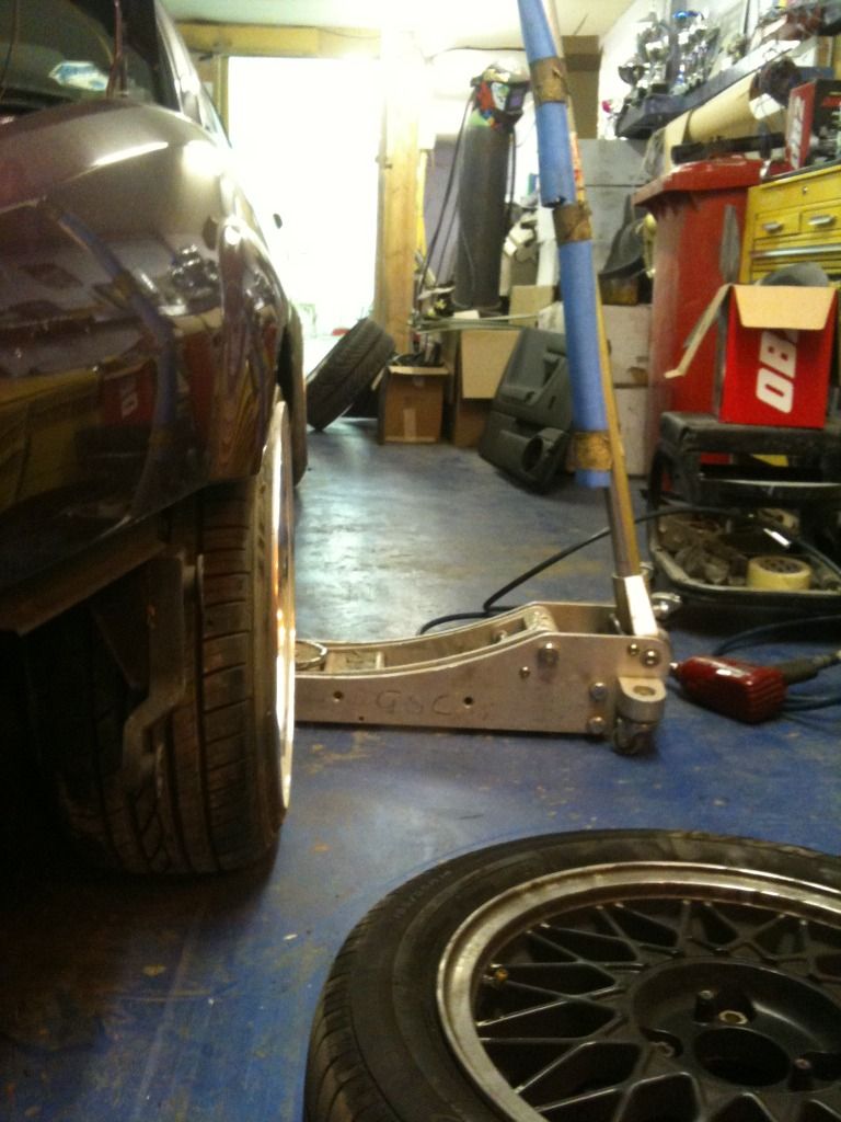

    so now the wheels are finally ready i can get them on the car and start measuring up for the custom struts to get the car laying frame.

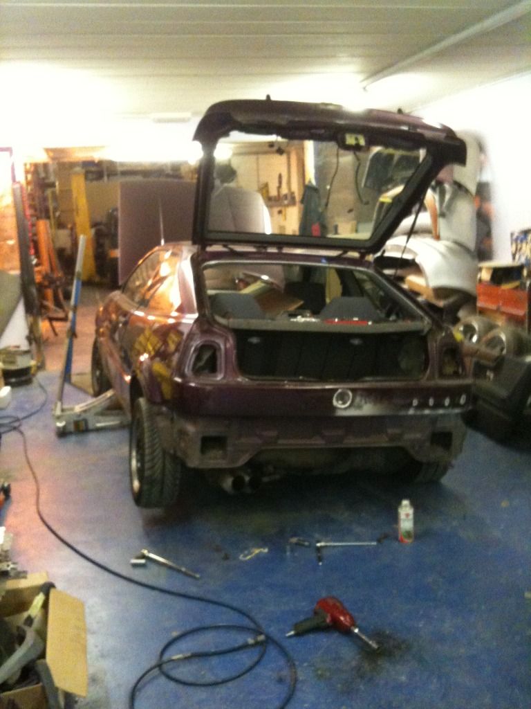

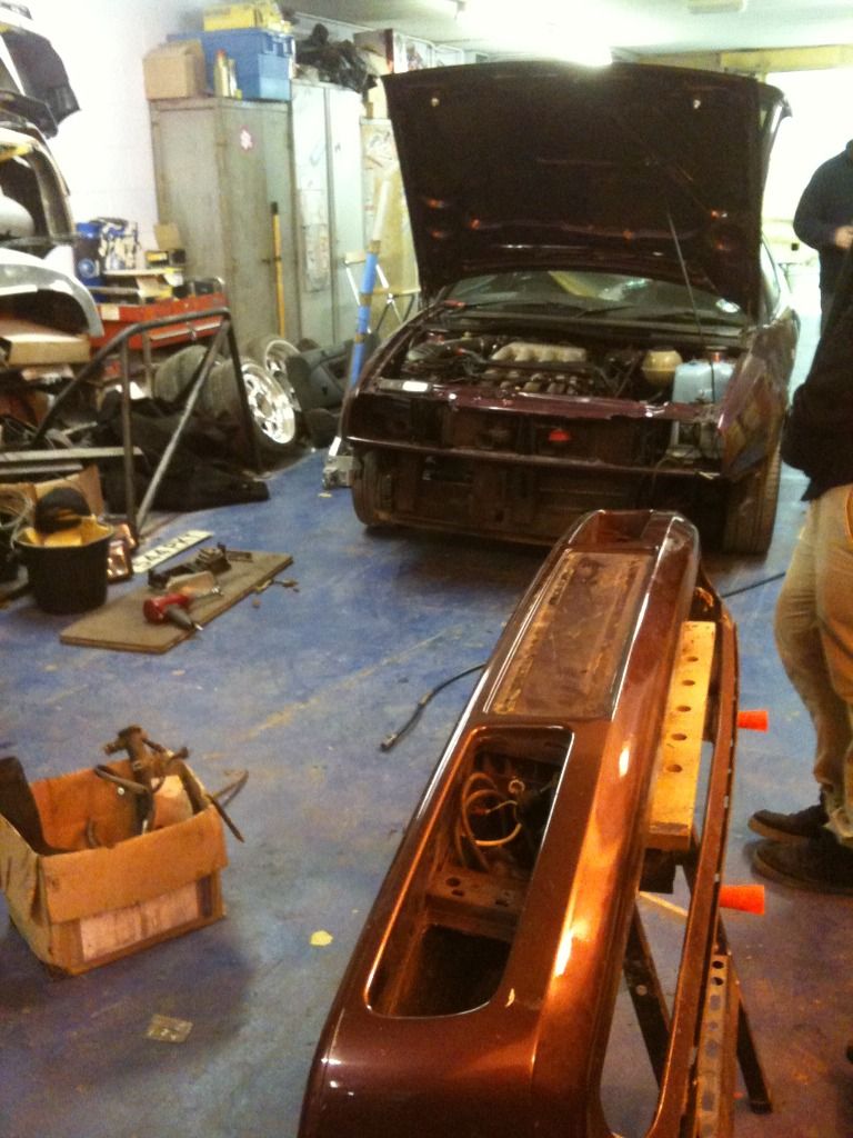

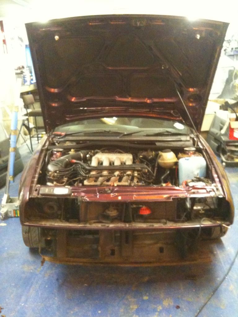

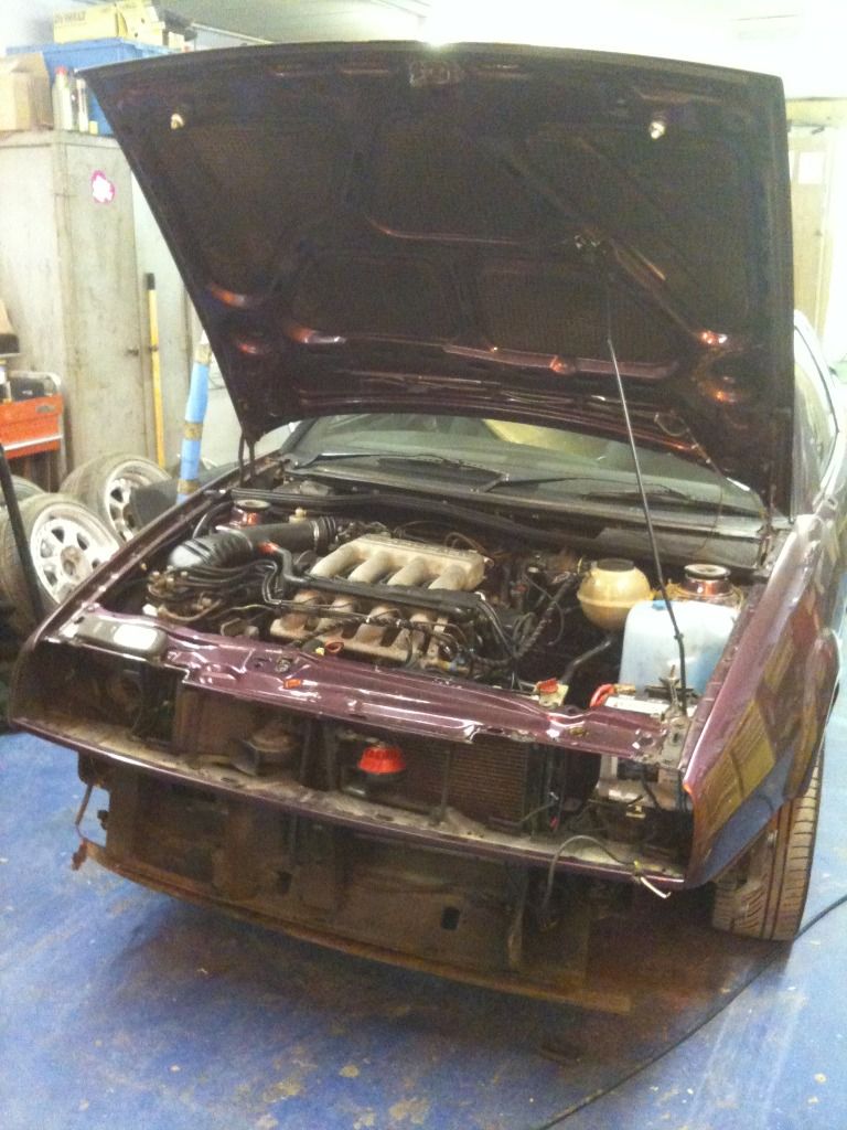

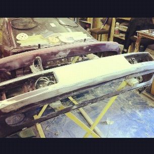

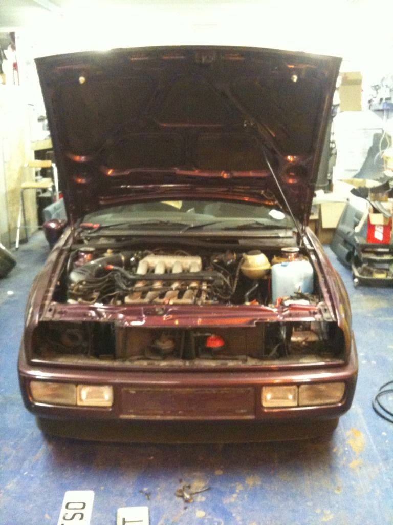

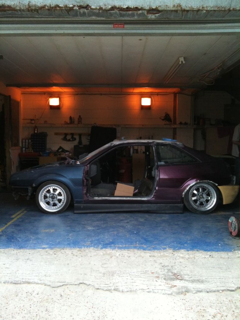

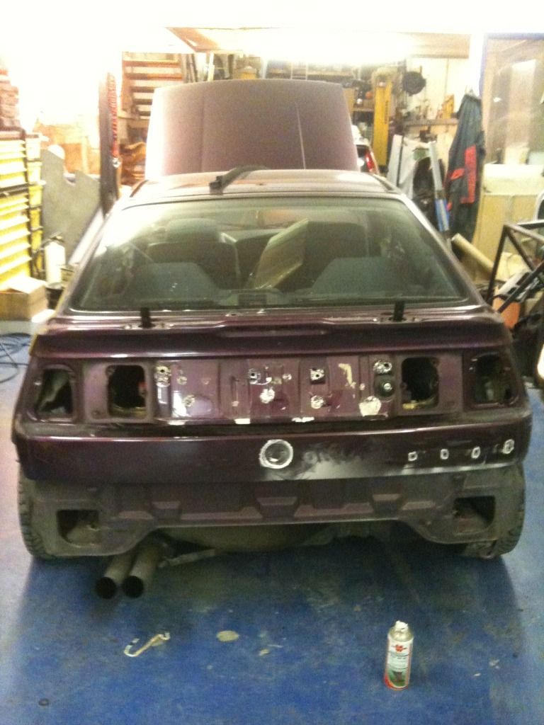

    spent the afternoon stripping the car down so the bodywork can be started, excuse the iphone pics, dont tend to carry a camera around with me at the shop!

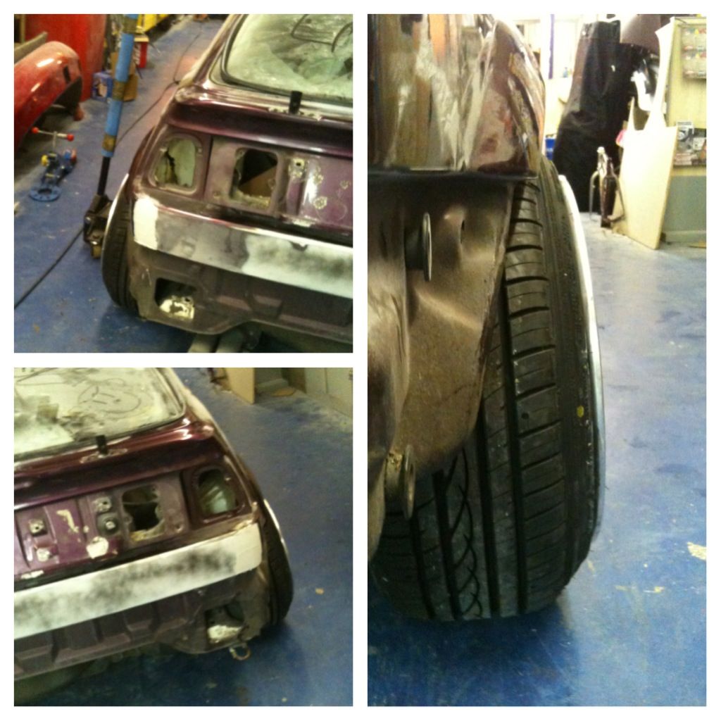

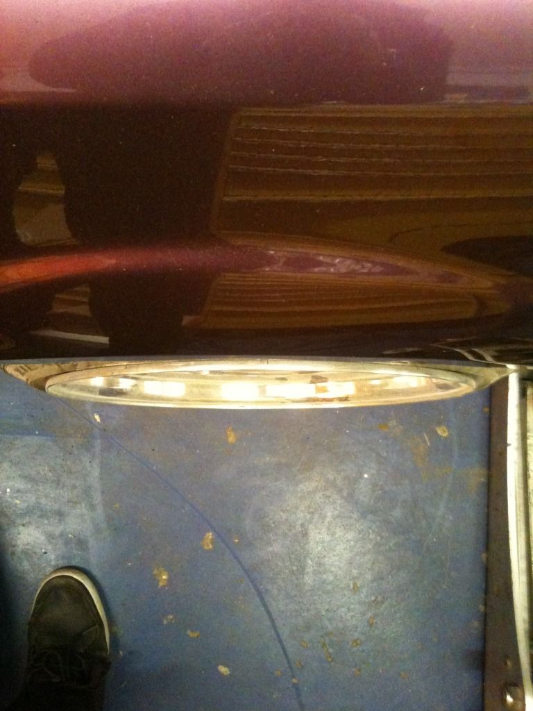

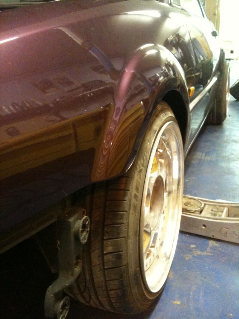

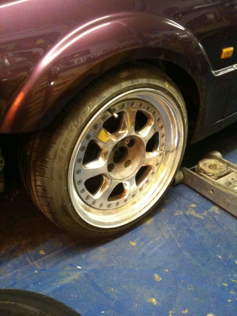

    also test fitted the wheels to see how much arch work is needed. the fronts are perfect, didnt want any poke so they tuck nicely to allow maximum drop once the air is fitted. the rears poke a fair bit which i expected, so going to build the arches round the wheels for a snug fit.

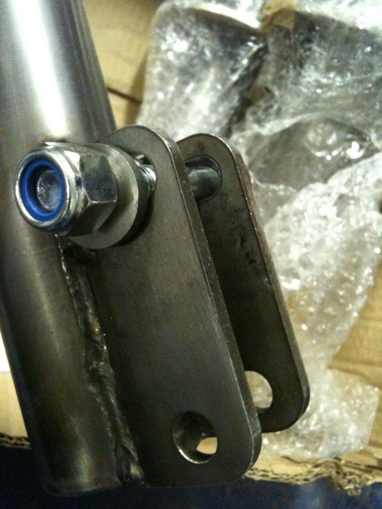

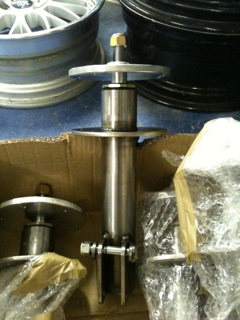

    my custom gaz struts came finally!
    ive had a notch put into the fronts for camber adjustment

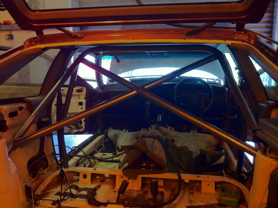

    custom cross bar half cage

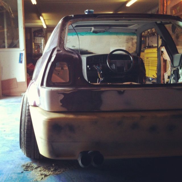

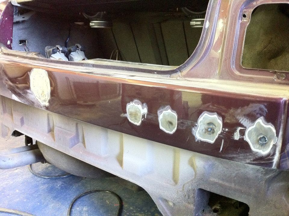

    rear badges
    rear wiper
    numberplate recess

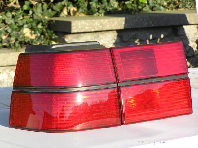

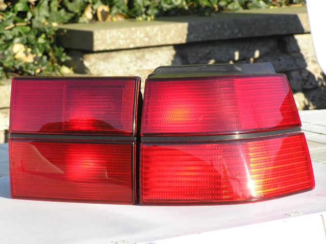

    also had a set of all red rears made

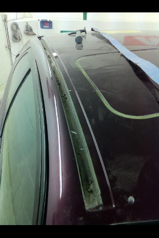

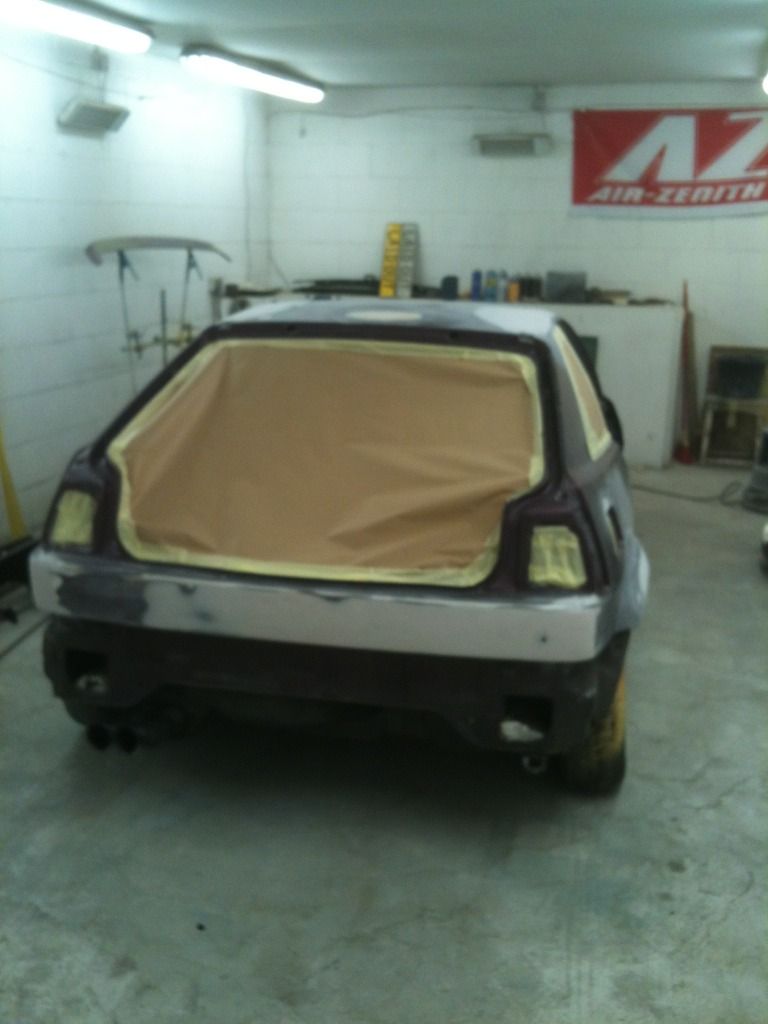

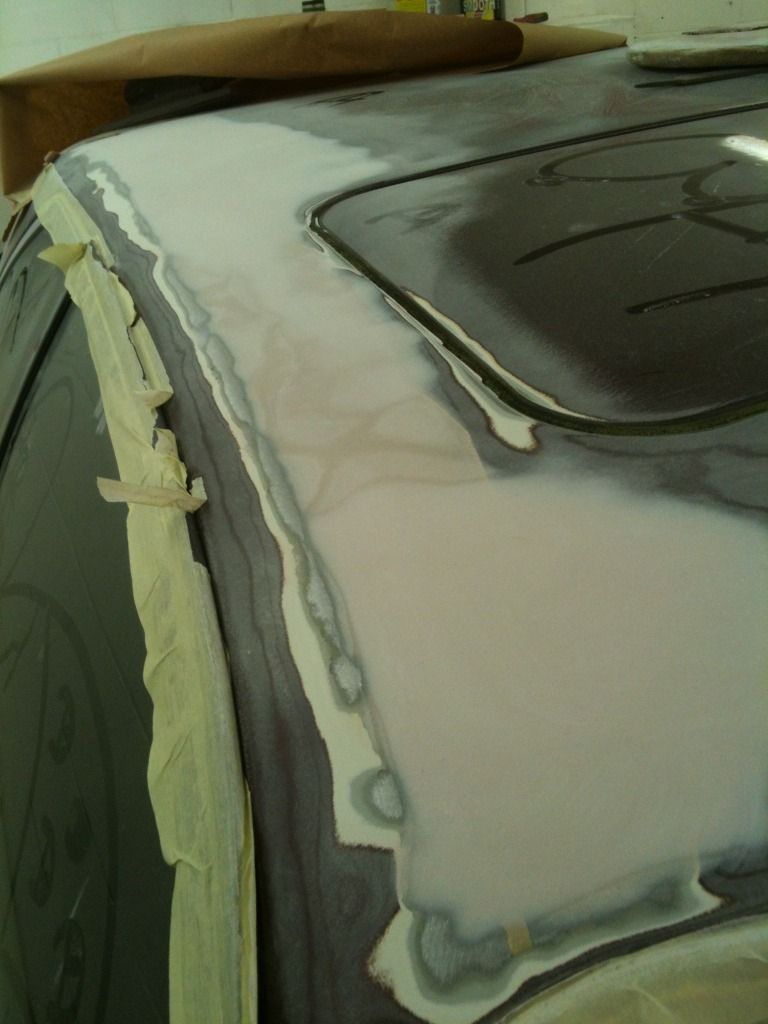

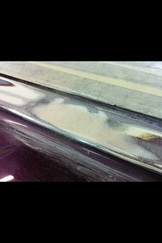

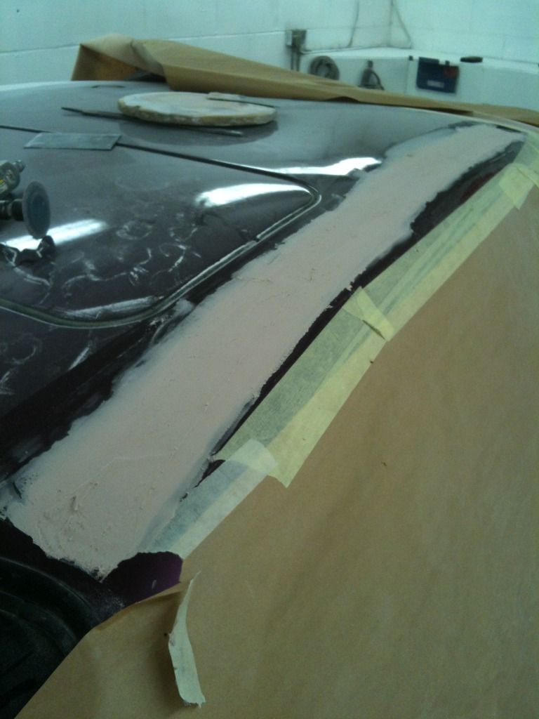

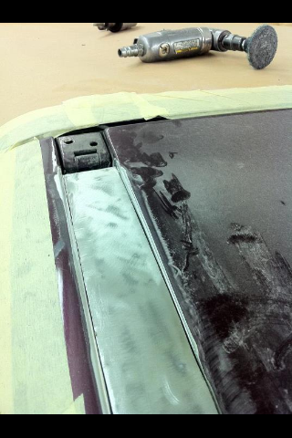

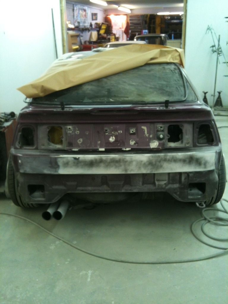

    decided to smooth the gutters off the roof and also found an awkward spot of rust at the top of the windscreen.
    smoothing the roof

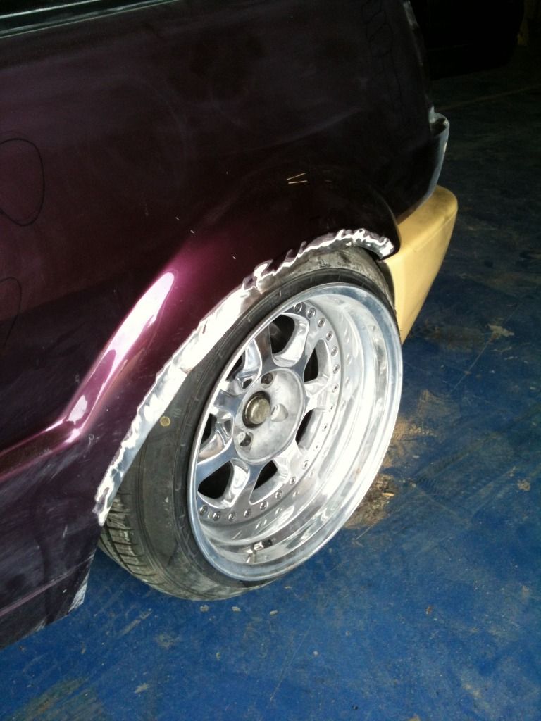

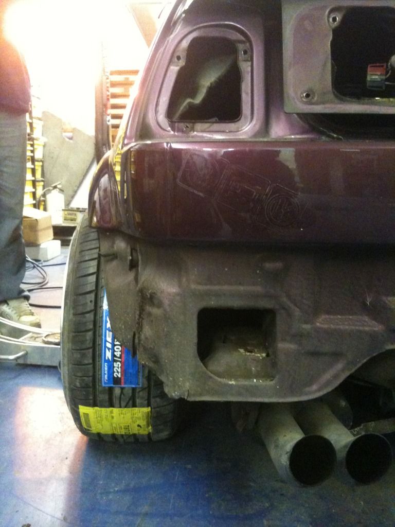

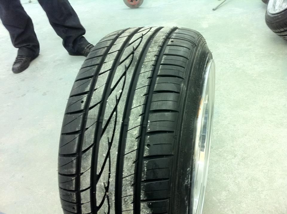

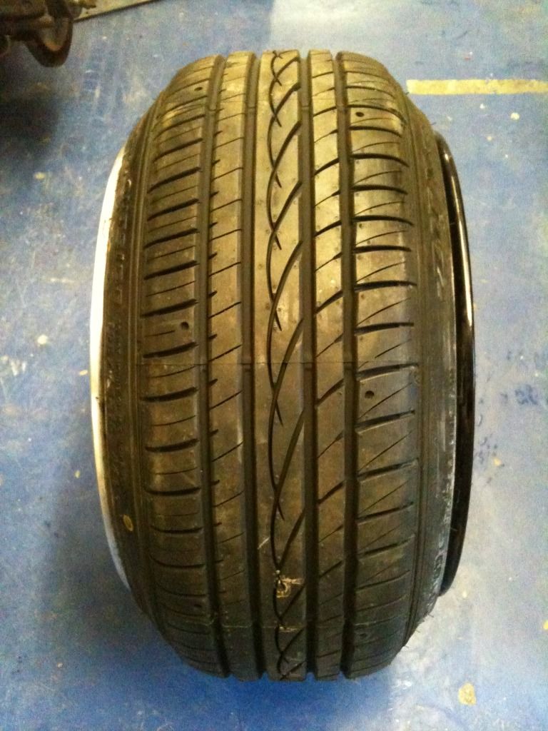

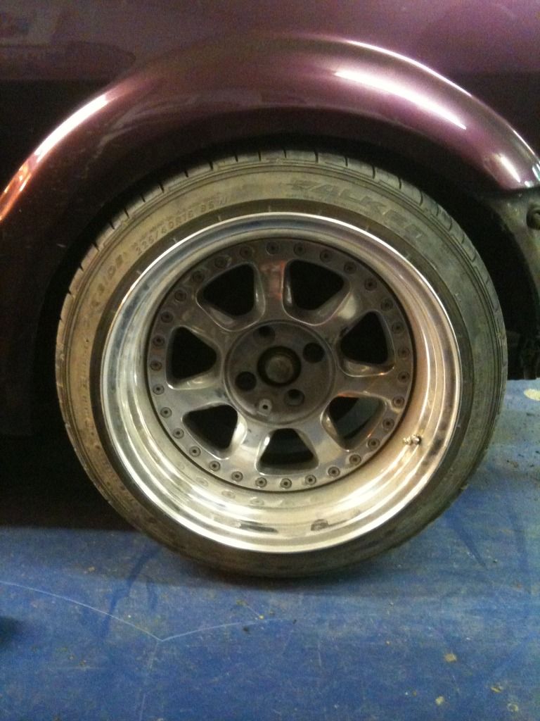

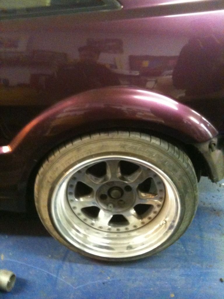

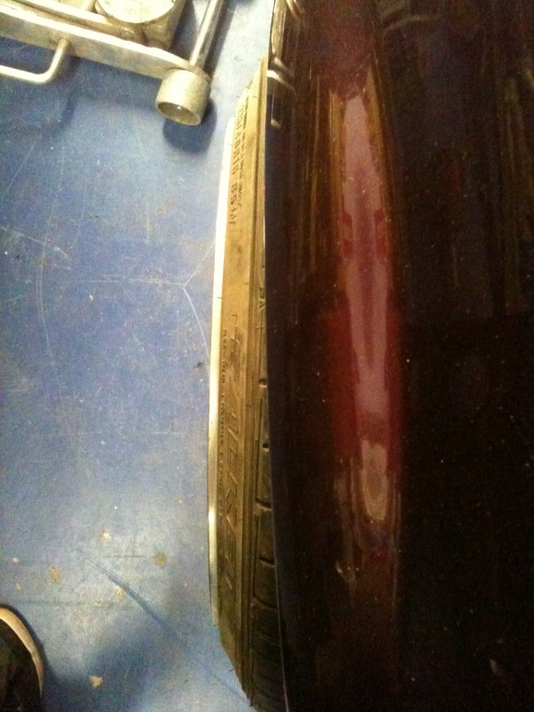

    i had problems with the fitting of my bastard wide rear wheels.

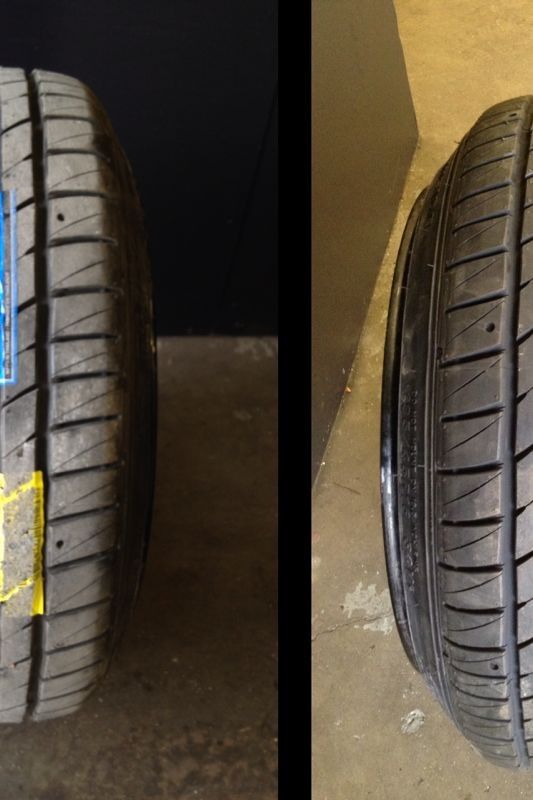

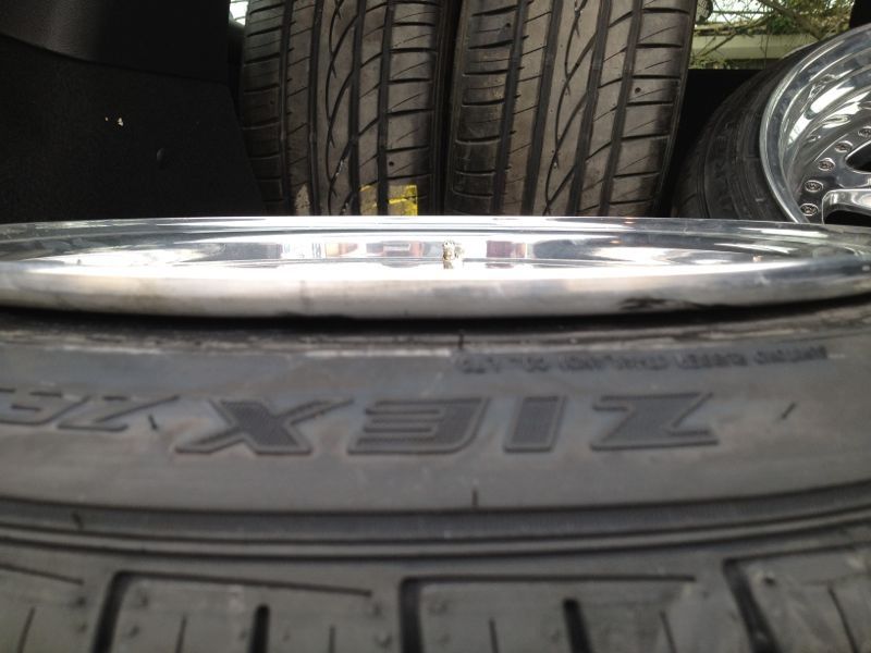

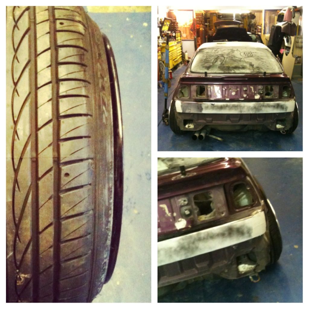

    to get everything tucked away under the arch i bought a set of 195/45 tyres which when fitted would solve all my arch clearance issues. 195/45 tyres and 10j wheels dont go. spent 2 hours trying to get them on using various stretching methods, but the tyres were just too skinny. im waiting on the tyre company to see if i can swap them for 205/45's which should work, still giving me the arch clearance i need.

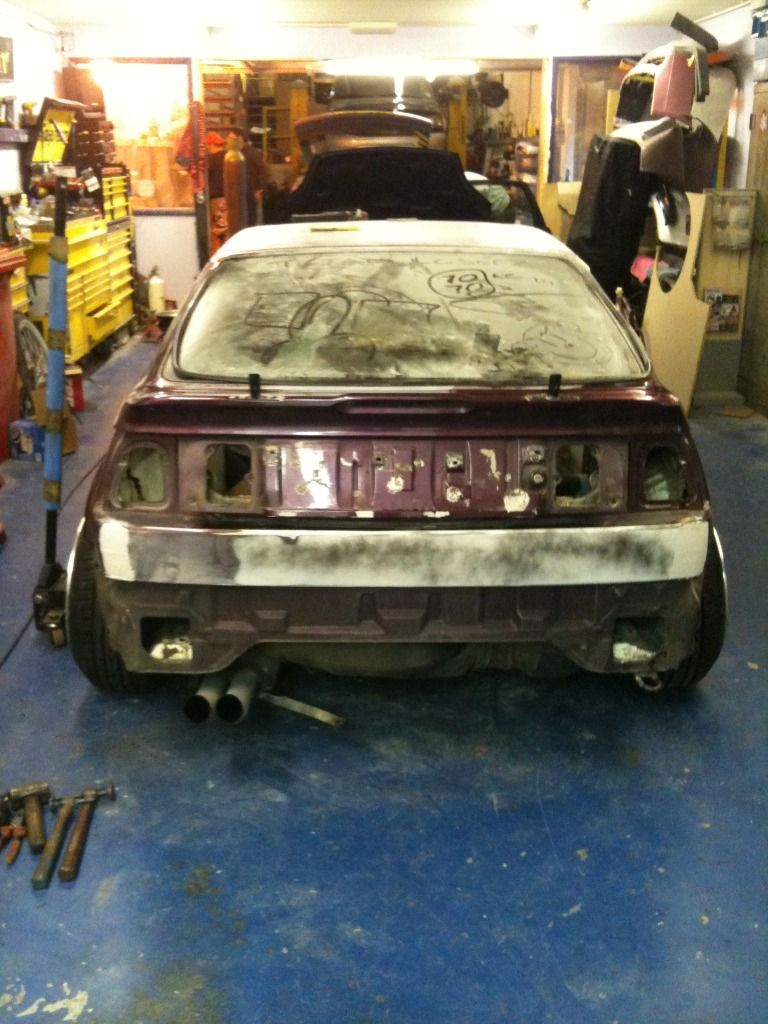

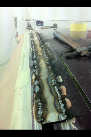

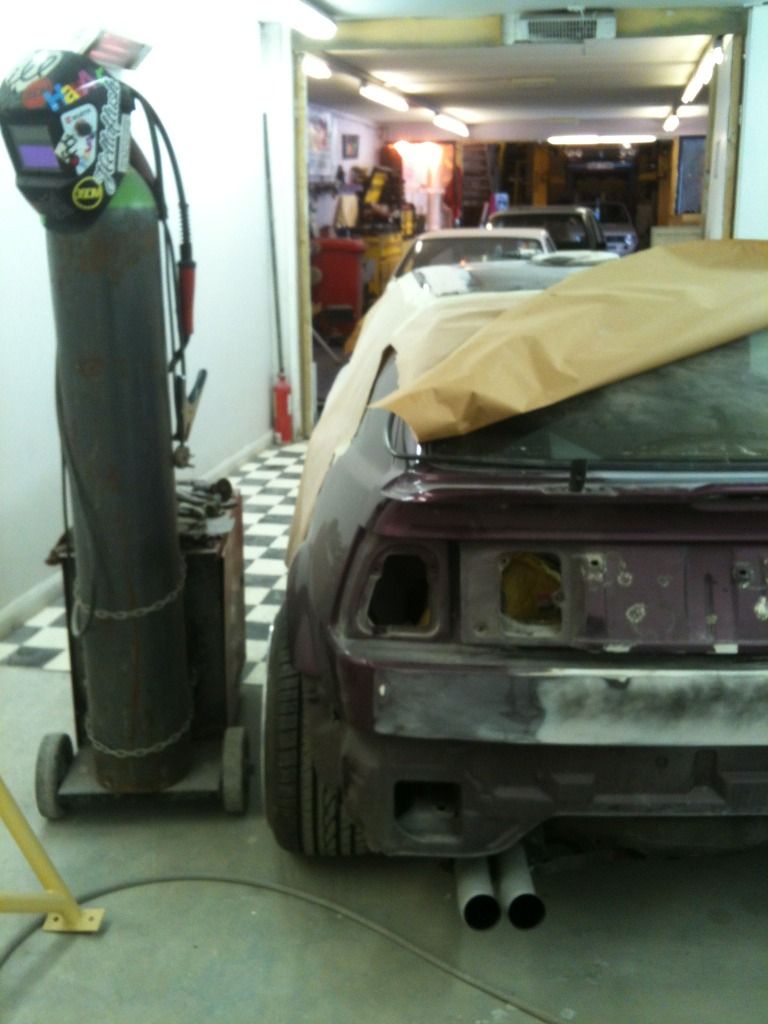

    couple of things have been done while im still waiting for paint. removed the seam weld on the back, welded up and smoothed out. also fitted 2 sets of camber shims to the rear giving me -3 degrees
    turns out, a 195/45 tyre does fit a 10j wheel.....just.
    paid a visit to faz at specialist tyres and within 20 mins they were on and looking insane.
    before 225/40, after 195/45

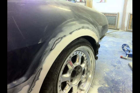

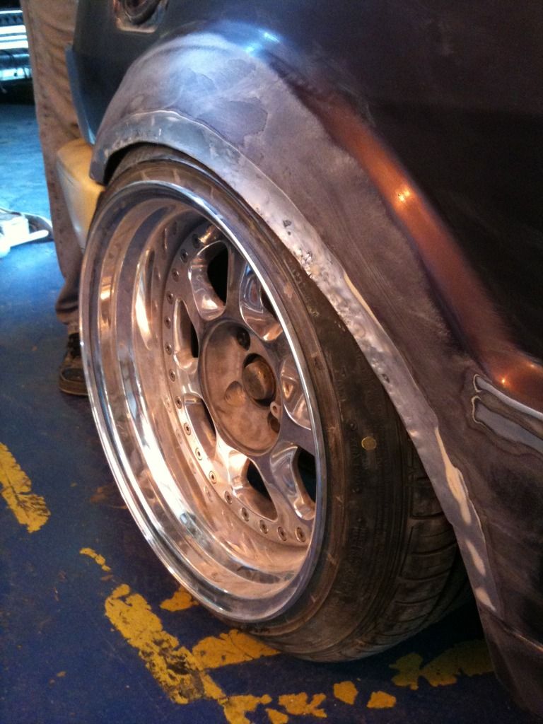

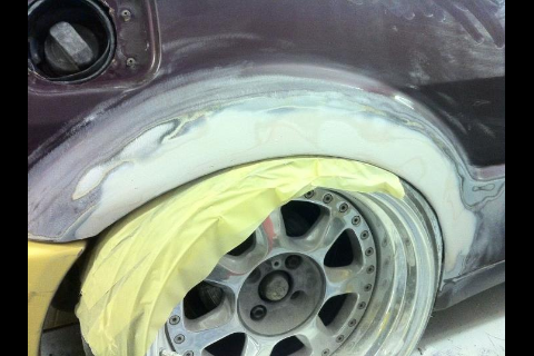

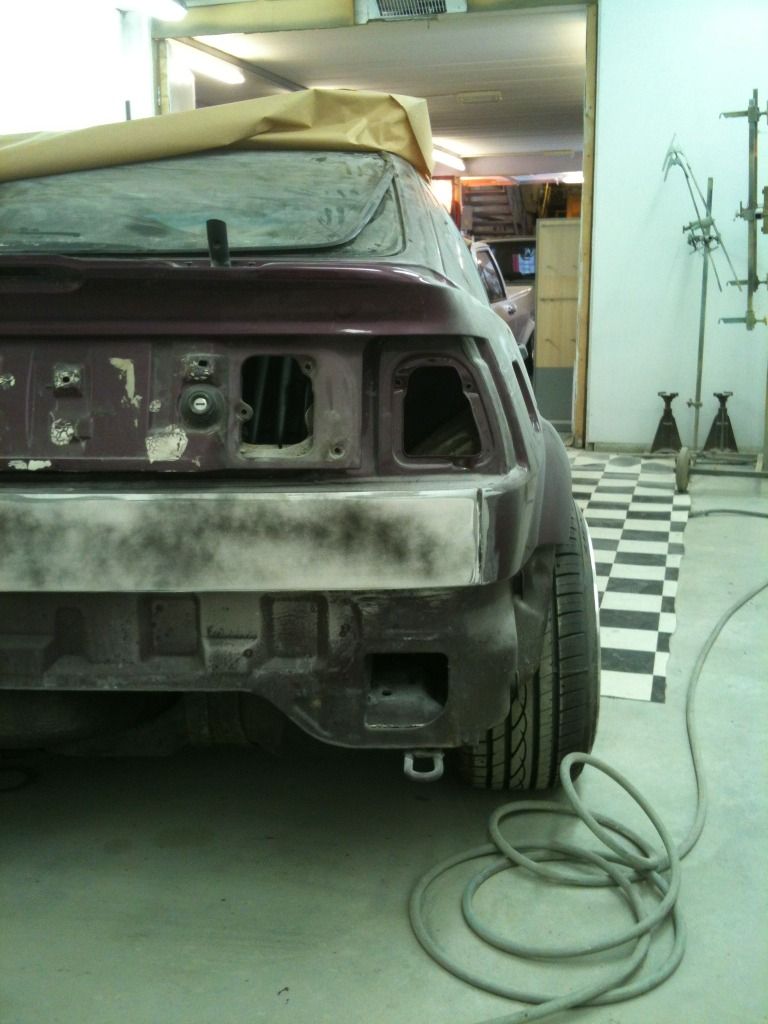

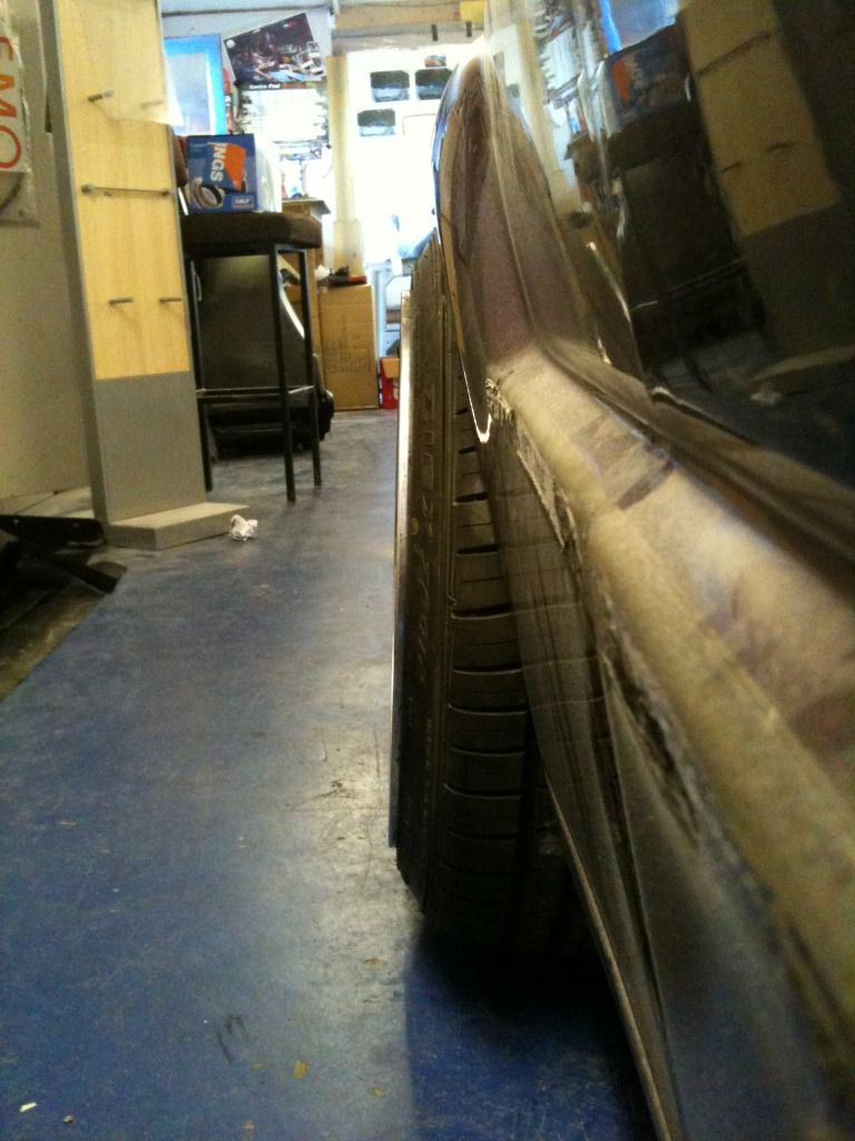

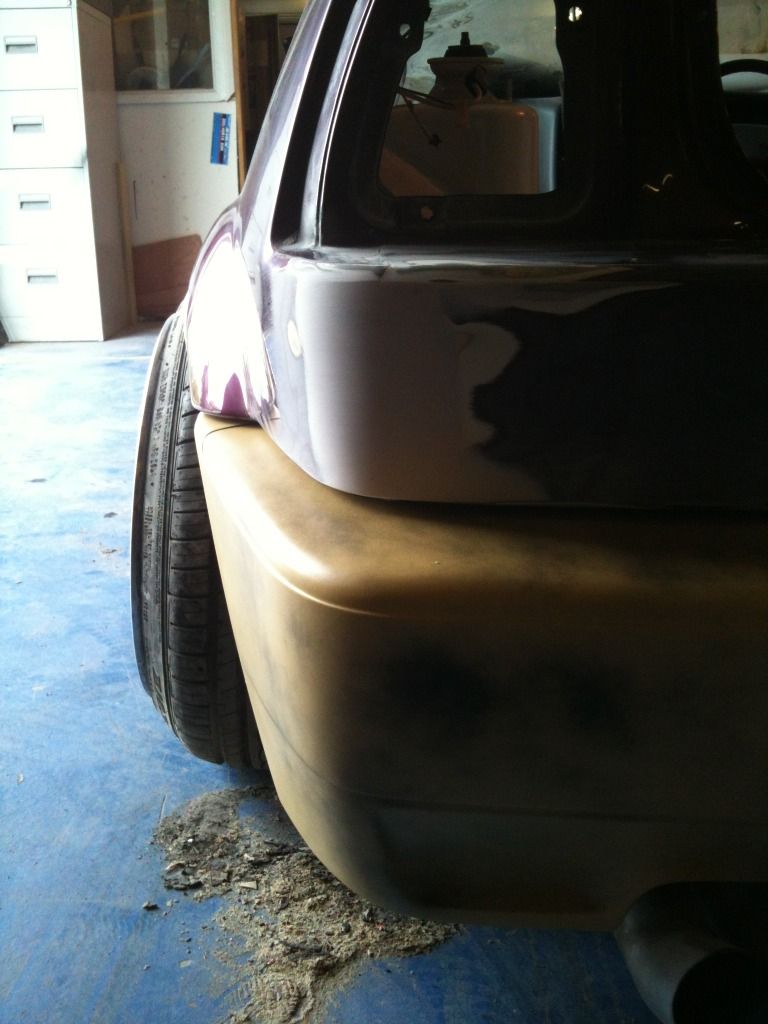

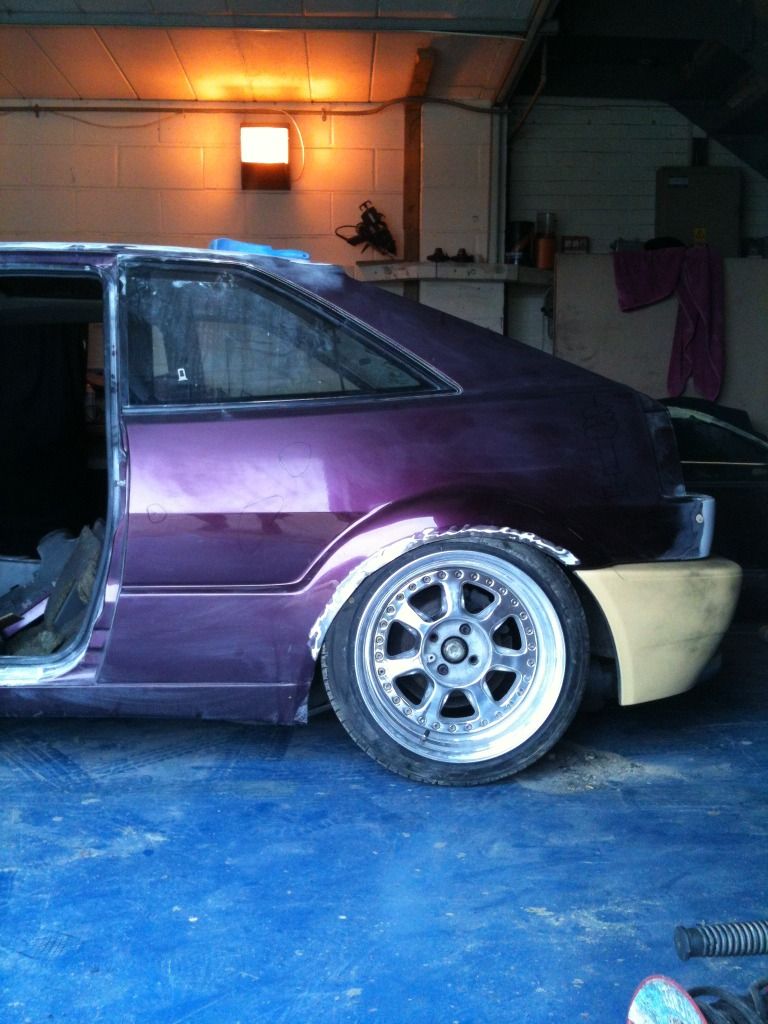

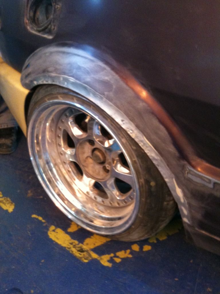

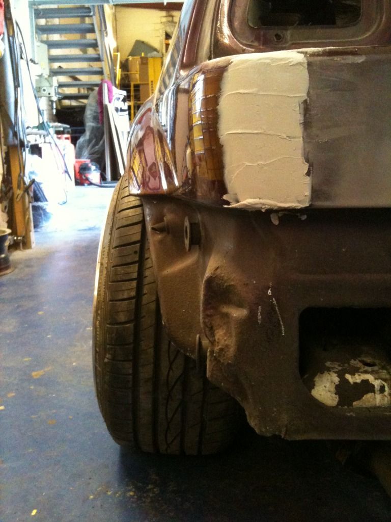

    been working on the rear arches rounding them off to get them wide enough for the wheels
    how it looks from the rear
    instagram edit (follow me @iheartrims)

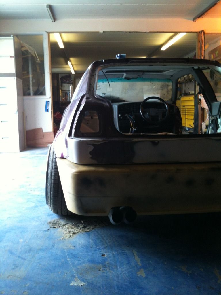

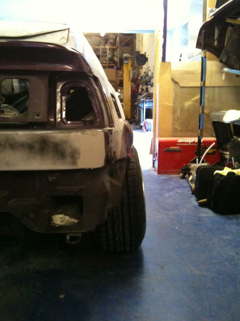

    fully down at the rear, will not phyically go any lower! had to relocate the brake lines as where the rear beam folds up they pinch on the bottom of the chassis. also fitted new indercator-less front wings
    front and rear arches are done. widened and rounded them off, look alot more meaty

              Too bad you got rid of the original shape the arches have..
              Those 195s on a 10 really look insane. Not sure if im a fan I have 205/40s on a 8 and 215/40s on 9'' rears, also Falken 912s. You sure a 205 wouldnt give you the clearance needed?

                  i didnt really like how the arches flattened off at the edge so wanted to follow the curve of them to the end. TBH im not a fan of the stretch, a 205 tyre should work, im trying to sell the 225's at the mo so as soon as i get the money for them ill switch the tyres.

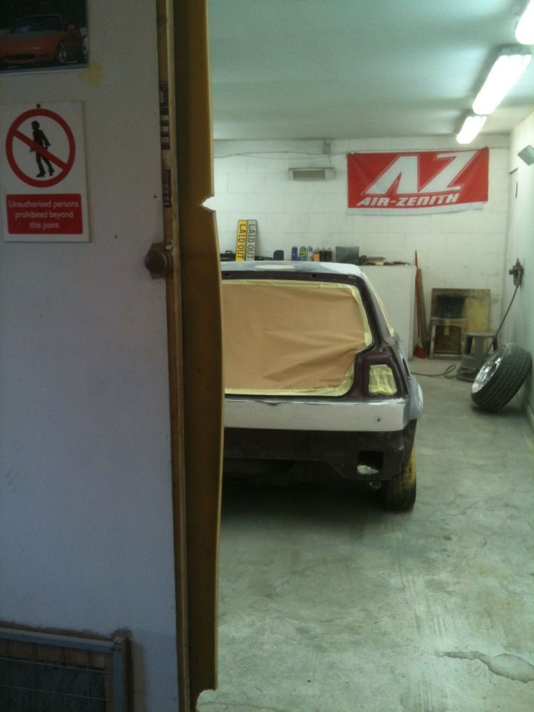

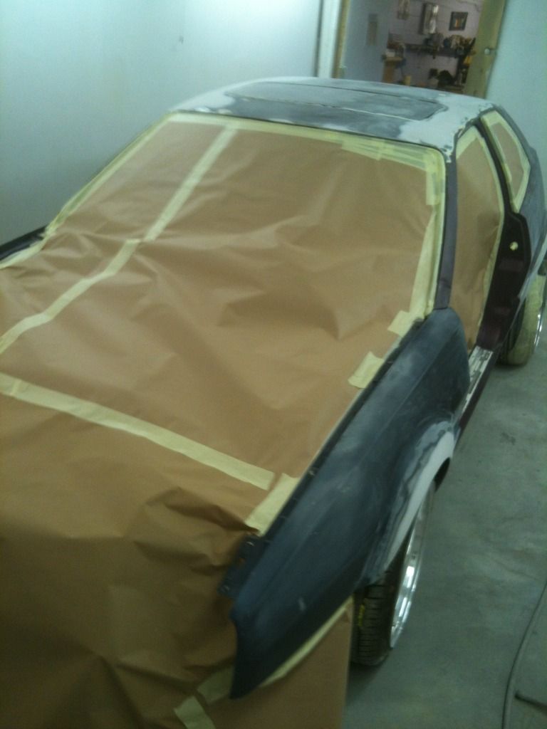

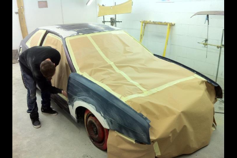

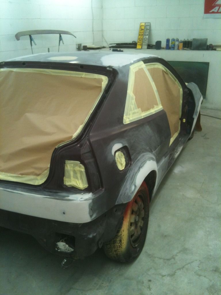

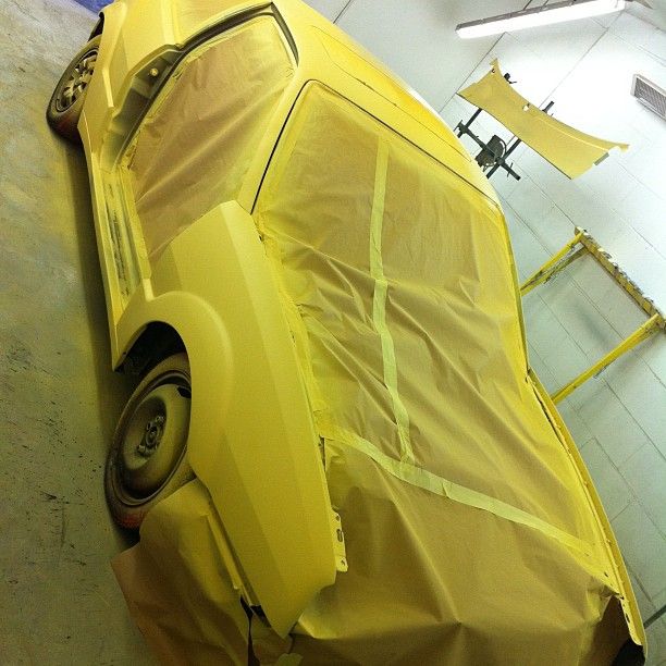

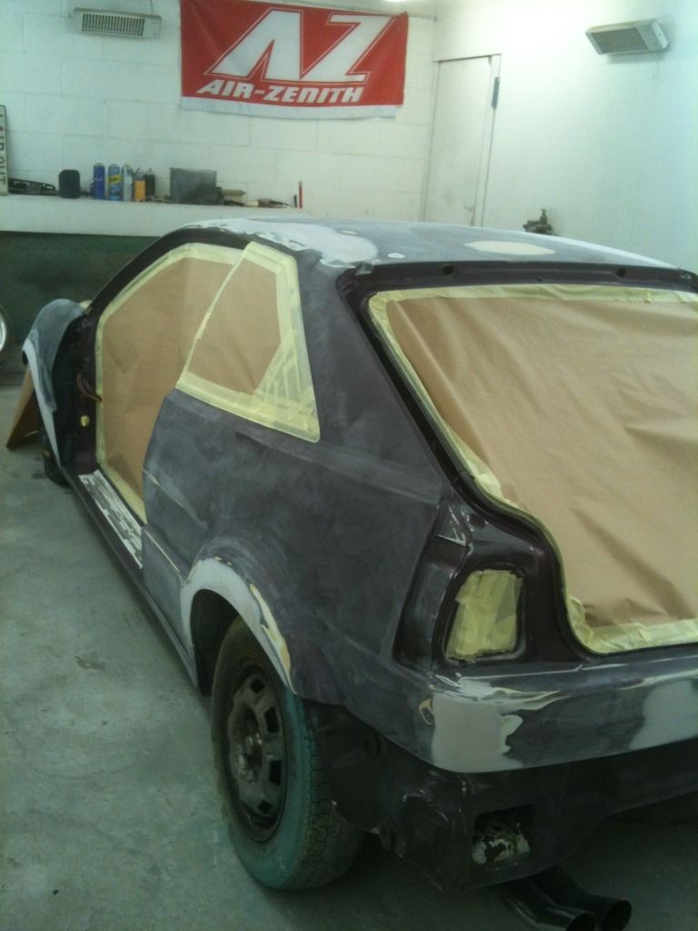

                    spent all day friday on the car prepping it for paint!
                    excuse the shite photos
                    car is sitting in yellow primer waiting to be painted tomorrow
